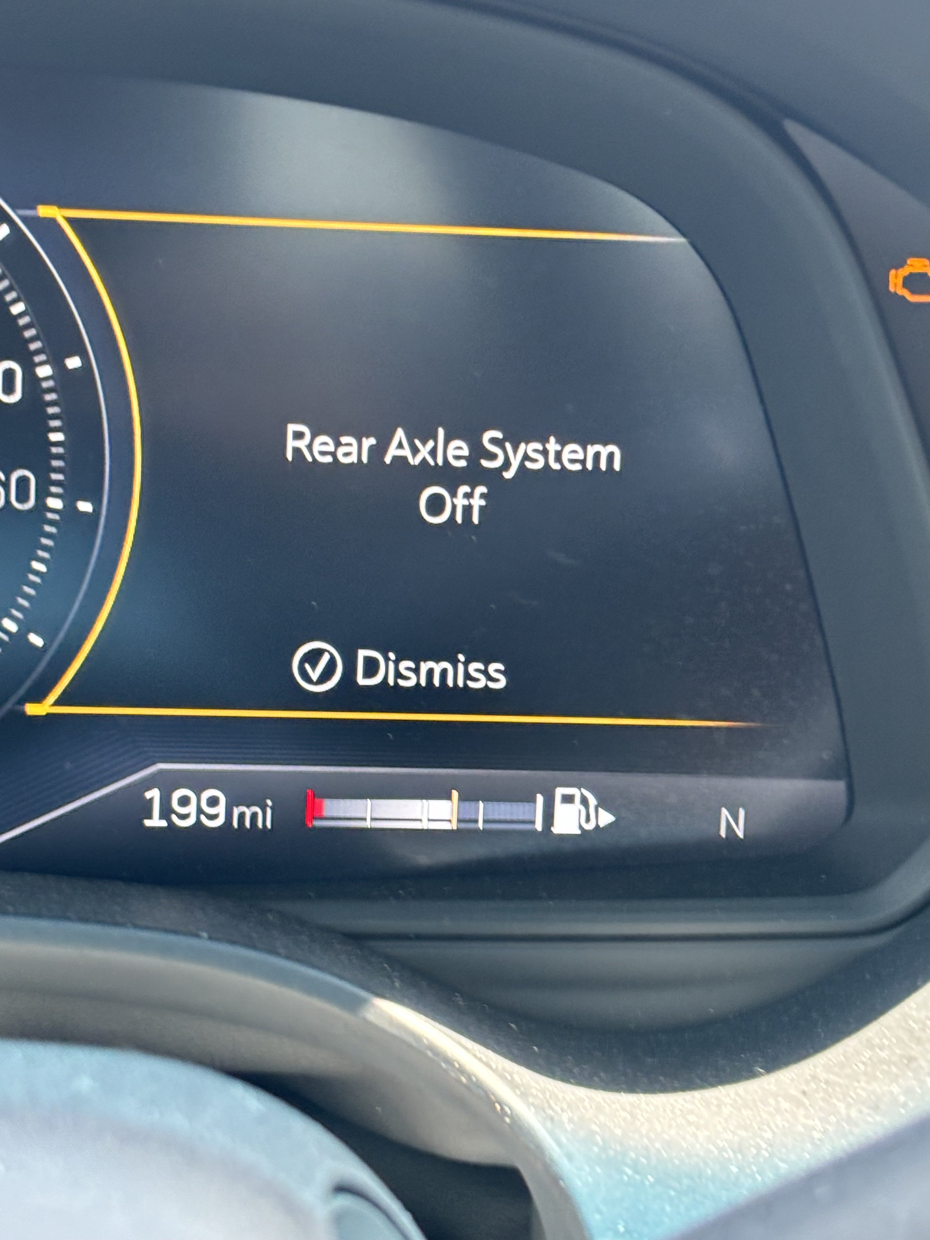

Anyone get this message after launching car? Have had this happen now twice. A10 2023 4BW with only 6,000 miles. Also get a flashing cel that goes out by itself.
Only thing I have seen is something about a wiring harness tsb that came out while back. Car is exactly a year old and haven’t had any issues at all with battery or anything else for that matter.
My traction/stability light was on as well then cleared itself along with cel. Must be something with eDiff and computer or something. Anyone else have this happen? Will take to dealer if it happens again.

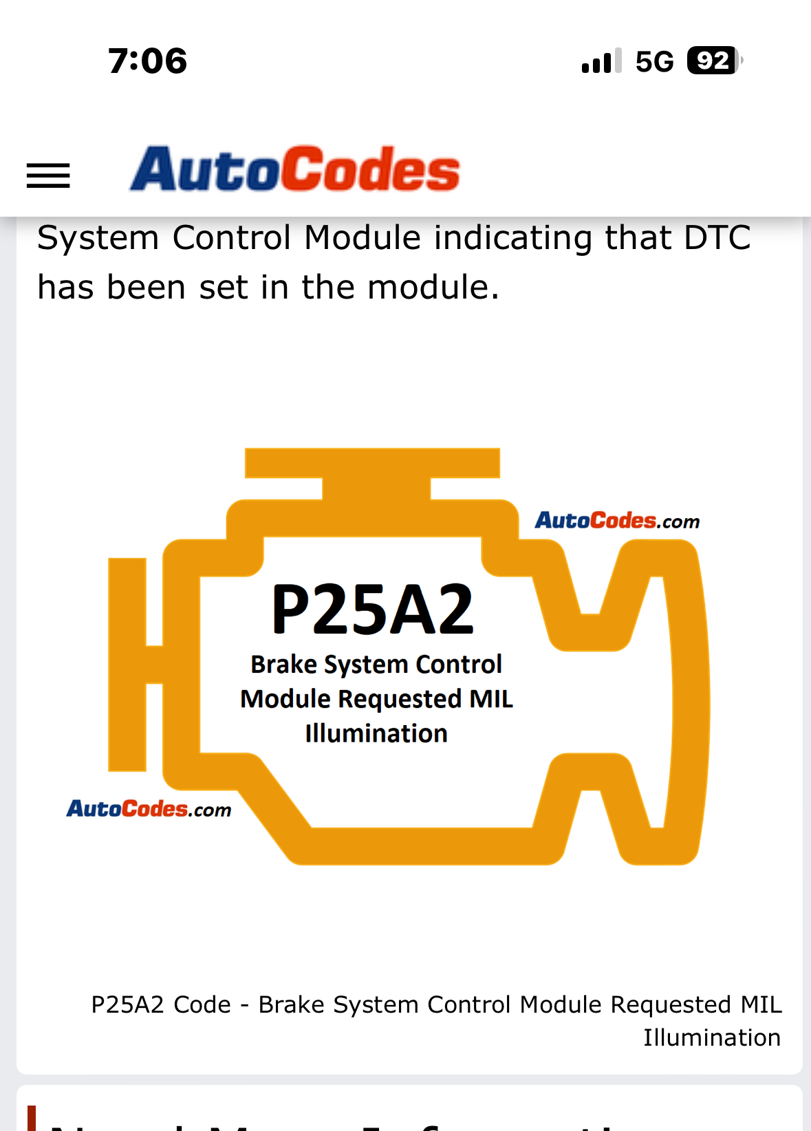

P25A2 looks like brake system control module.
What makes you think it could be from the plugs? The plugs were not gapped correctly out of the box like they claim. I gapped them down to .26 It was first plugs I have gapped but almost certain I did it correctly. Havent had any drivability issues. I even got the upgraded ignition coils and used lots of dialectic grease.
Just saw a TSB for this code and it’s for message service engine soon, which I think I may have also seen in the dash. The fix is a reprogram of brake system control module with latest software. I may have to take jb4 off and bring to dealer, or wait and see if it happens again.
