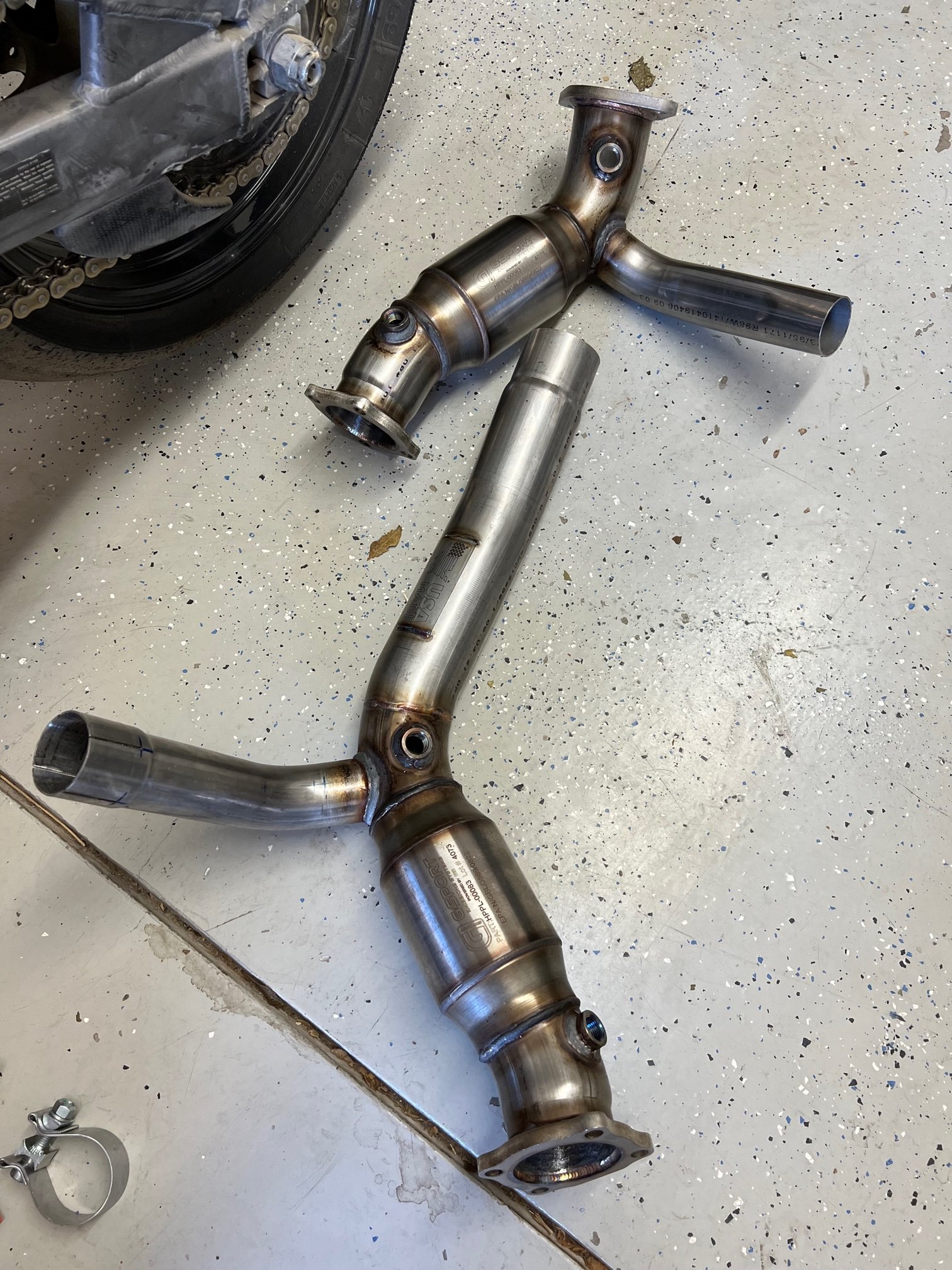

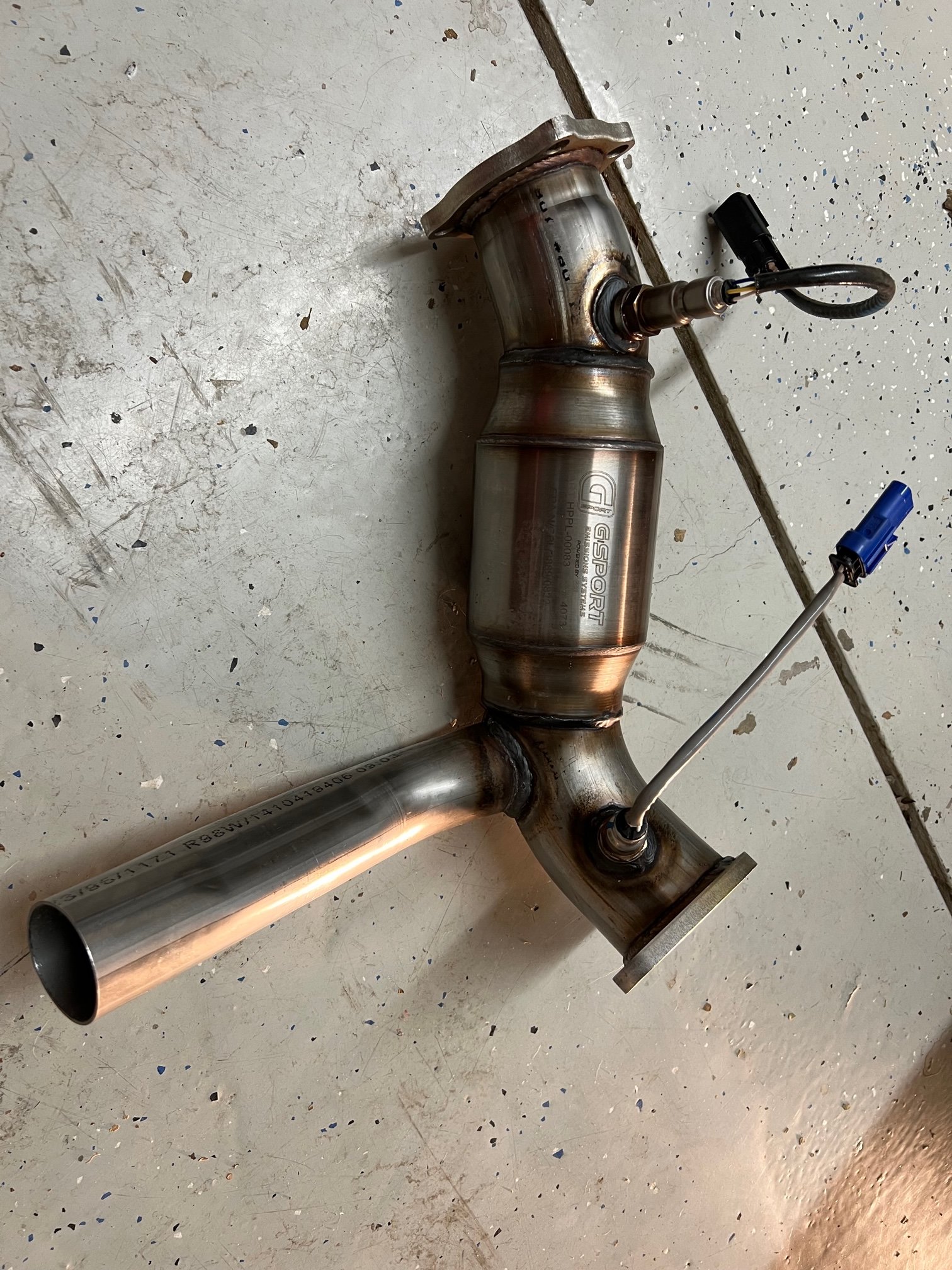

The smell was a small leak in the cross over pipe, I fixed this and the smell went away. The P0420 and P0430 mentioned above will still pop up now and then. They are easy to clear, but may just be something you have to live with if you do the down pipes, even catted, at least at this point.
Noted. Thanks for the response! Looking at getting the catted pipes down the road (you know... if/when the car is delivered) but doing my due diligence in the mean time.
I can tell you the sound is awesome. Love the compromise with the cats, they are both very quiet when cursing but rip when you open it up and give it the beans.
Yep, its super easy. I also got the DTC assassin so I can clear in a couple of seconds. Its just part of my routine every time I turn off the car.
So DTC won’t permanently clear?

Any benefit of adding a Crossover Pipe, to the Stock DownPipes?
For those of us who don't want to endure Code Resetting and the Aftermarket DP install?
@WONT TAP
There is no need for a crossover pipe when you're running OEM cats. Adding the crossover eliminates all rasp and drone when the cats are removed for off road competition of course.
The catalyst inefficiency DTCs P0420 and P0430 are caused by the ECM realizing the factory cats are no longer in place. The crossover pipe doesn't have any impact on this issue.
For the catted DP's... What if the bungs were spaced out about an inch to pull the secondary o2 out of the flow a bit? This could be enough to fool the ECM to think the cats are scrubbing better.
Lots of people have tried all sorts of fudging along these lines, but we haven't heard of anyone outsmarting the E99 ECM yet.
