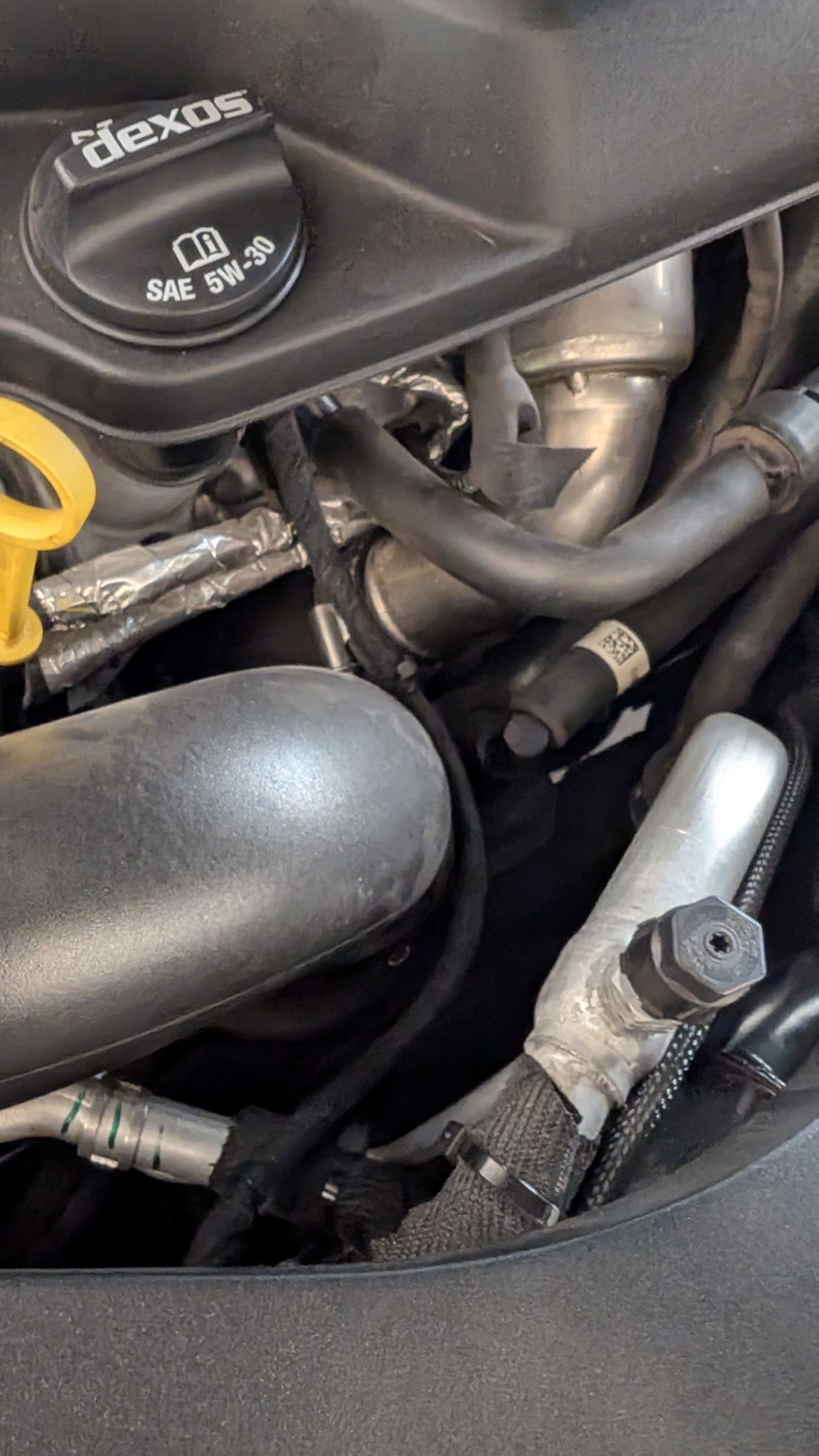

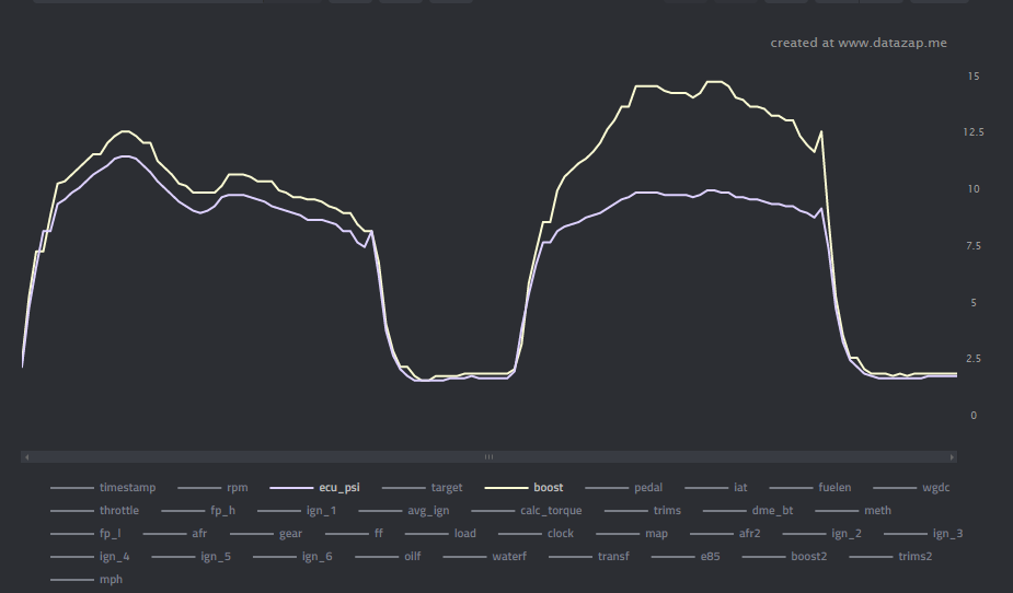

I installed mine about a week ago. Ran map 0 for a bit and kept an eye on it, then moved to map 1. Sent log to Terry to review yesterday, and it seemed ok, though it was only a part throttle log. I'll log a full throttle run when I get an opportunity (don't get to often) and see what that looks like. Until I can gap the plugs tighter, I will not move to map 2 and I am not looking forward to pulling the plugs. I have done that on the ATS-V and really don't like the process. Some potential for breaking fittings and creating another project.
What I don't like is that I can't monitor with my Torque app as only one device can run off the OBD port. I bought a splitter, but was getting wacked out readings and apparently you don't want to do split the port when running JB4. JB4's own monitoring does include fuel trims, but no missfires and knock that I like to keep an eye on. Fuel trims showing up in the JB4 gauges are not reflective of actual fuel trims by the way, as a function of its operation. Its idling at 23 to 35 (these are not actual trims) on JB4, but when disconnecting the jb4 and connecting my Torque app, fuel trims are 5 to 8 (actual trims). Something to keep in mind.
As far as performance....no comment on it yet. Haven't really pushed it at all yet. Feels completely stock in normal driving. I am not expecting a major difference on map 1.
