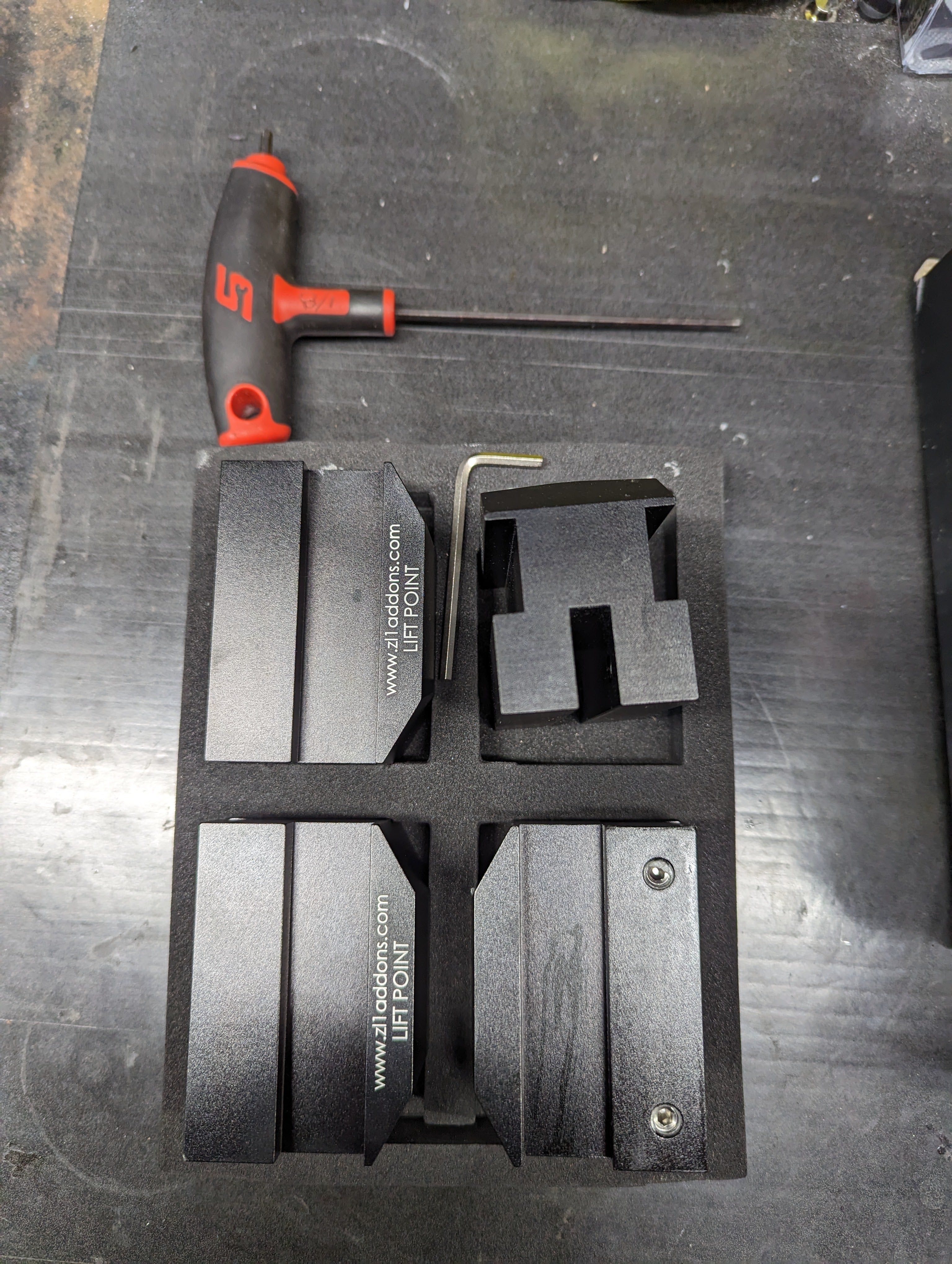

I use the ZL1 Addons CT5V stealth mounts. I did not cut the plastic since the mounts bottom out on the pinch weld. Not sure if this is ideal, but in the 5 or 6 times I've jacked up the car it seems to work fine.

Just bought the ct5v stealth mounts. Apparently there's a sale until midnight tonight, reg price 89.99 down to like 77.39.

this was all great info. Thanks @rubberduck for verifying they don't rub, I went with the Stealth versions. And thanks to @GTANotch88 a discount helped nudge me into buying these last night. I also bought the jack lock which seemed like a good thing to have lying around with a 15 year old HF jack.

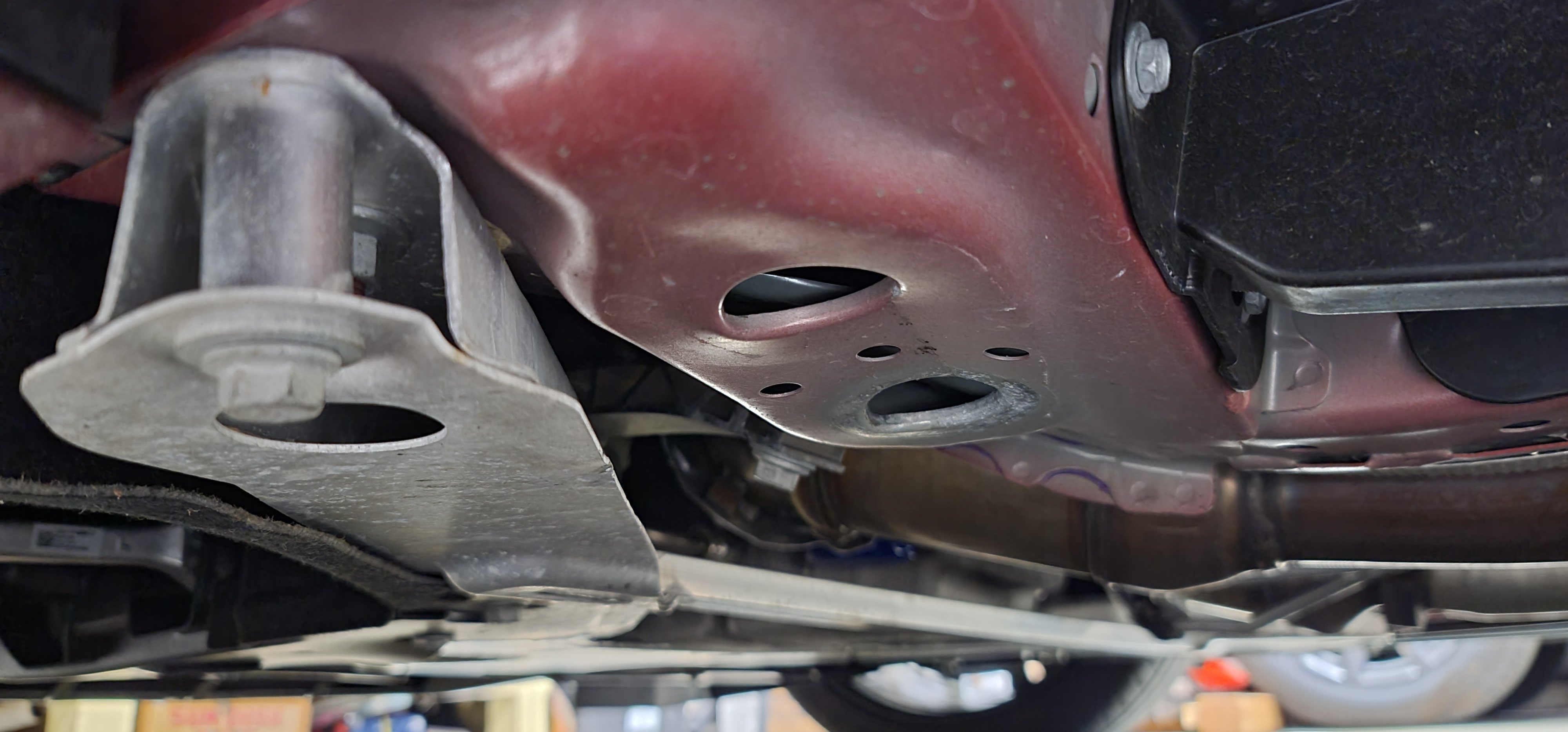

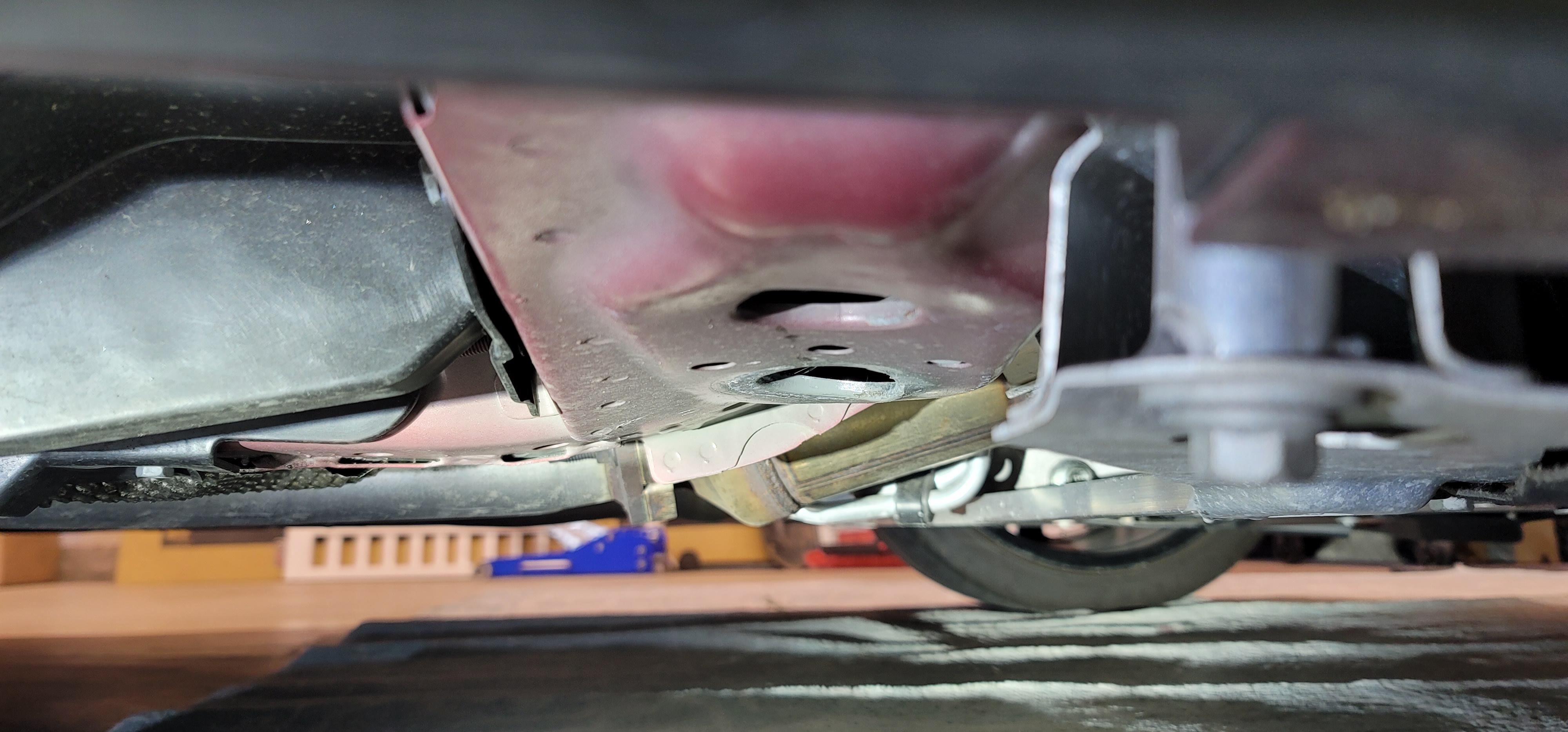

I got the stealth lifts today and went to look under the car and found a rubber hockey puck stuck to the driver side pinch weld. I just had the dealership changed the oil. Then I noticed the area where the 2 holes are completely bent. Both sides too.
I have never jacked it up, it's only been serviced by 1 dealer. I don't think they jack up a car when they do the PDI so it had to have been my local dealer.
Am I delusional or do these seem bent, and if so does this have any implications to the structural integrity?

That is definitely bent. My frame holes are perfectly flat, but does have that fine line going around both holes, I expect from the supporting device on the production line.

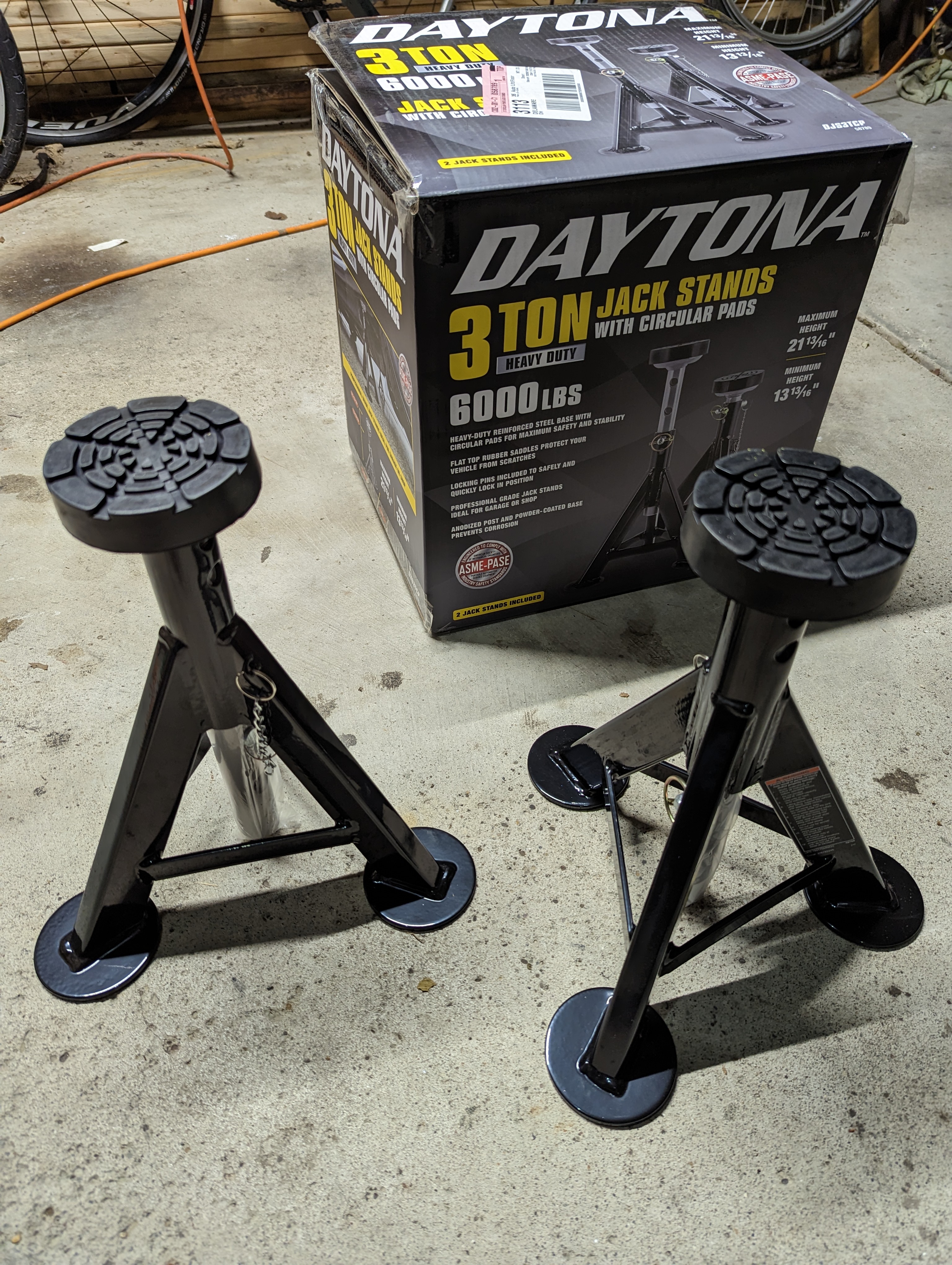

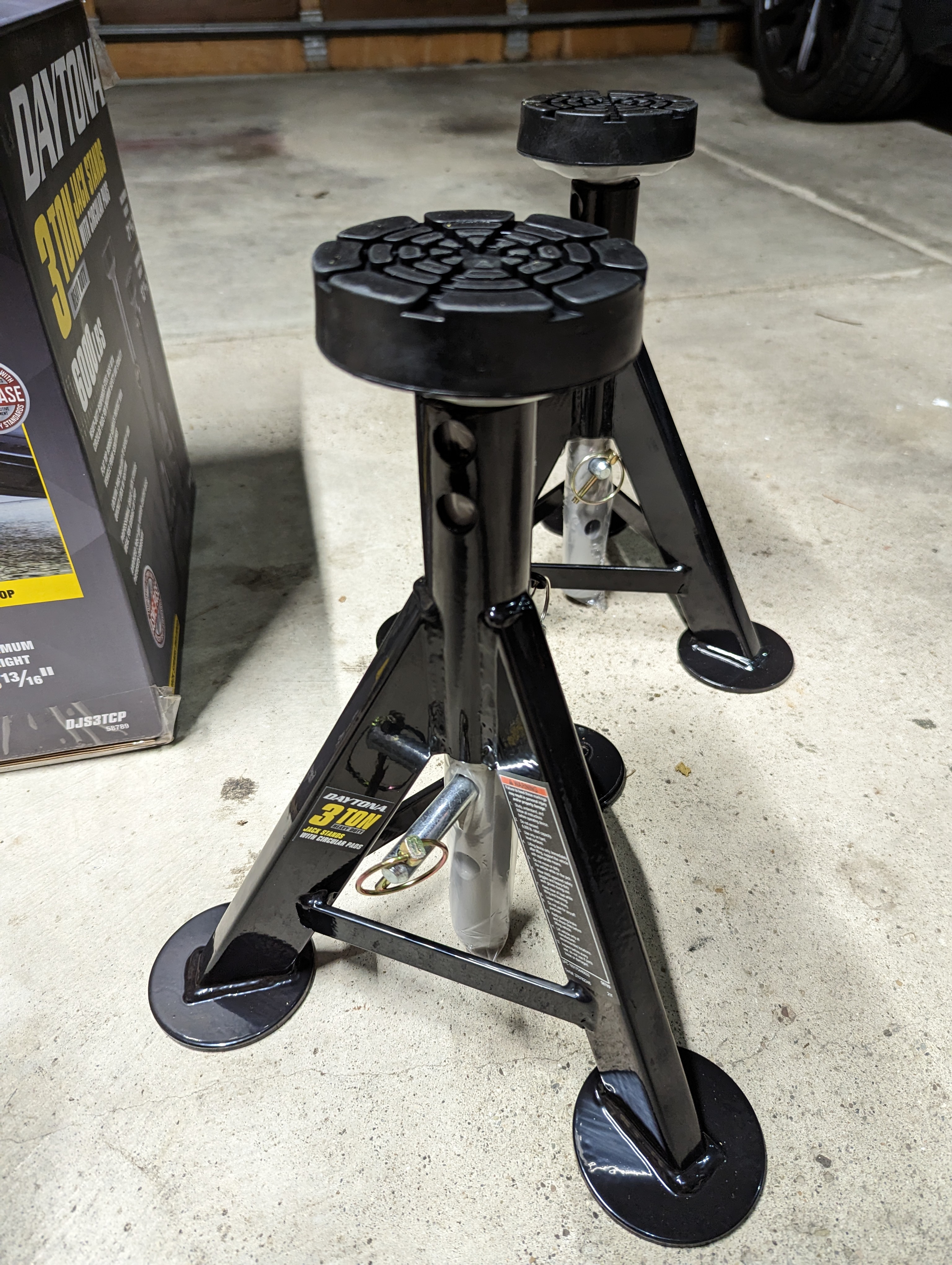

As for jack stands, I just bought these at Harbor Freight - $90 with a $10 coupon so still not cheap, but a lot less than some of those others. I think the frame hole insert the others use is probably not necessary because I can't see the car slipping off these with the weight of the car on them.
Ugh FM... I guess I have no recourse I can't prove anything, or does anyone have any recommendations as to how to go about rectifying this issue?
I did have the car towed once to the dealership when my coolant line cracked but I don't think they would have used those holes to hook on.
Those look like the esco jack stands...
Why is the that inner frame hole discolored? Almost looks like there's no paint on there.
My guess is they use those locations to move the car through the assembly line. I wonder if there is a adapter located there during the paint process?

Ordered the ZL1 addons lift points...they don't fit. They won't sit flush due to plastic rocker trim.
