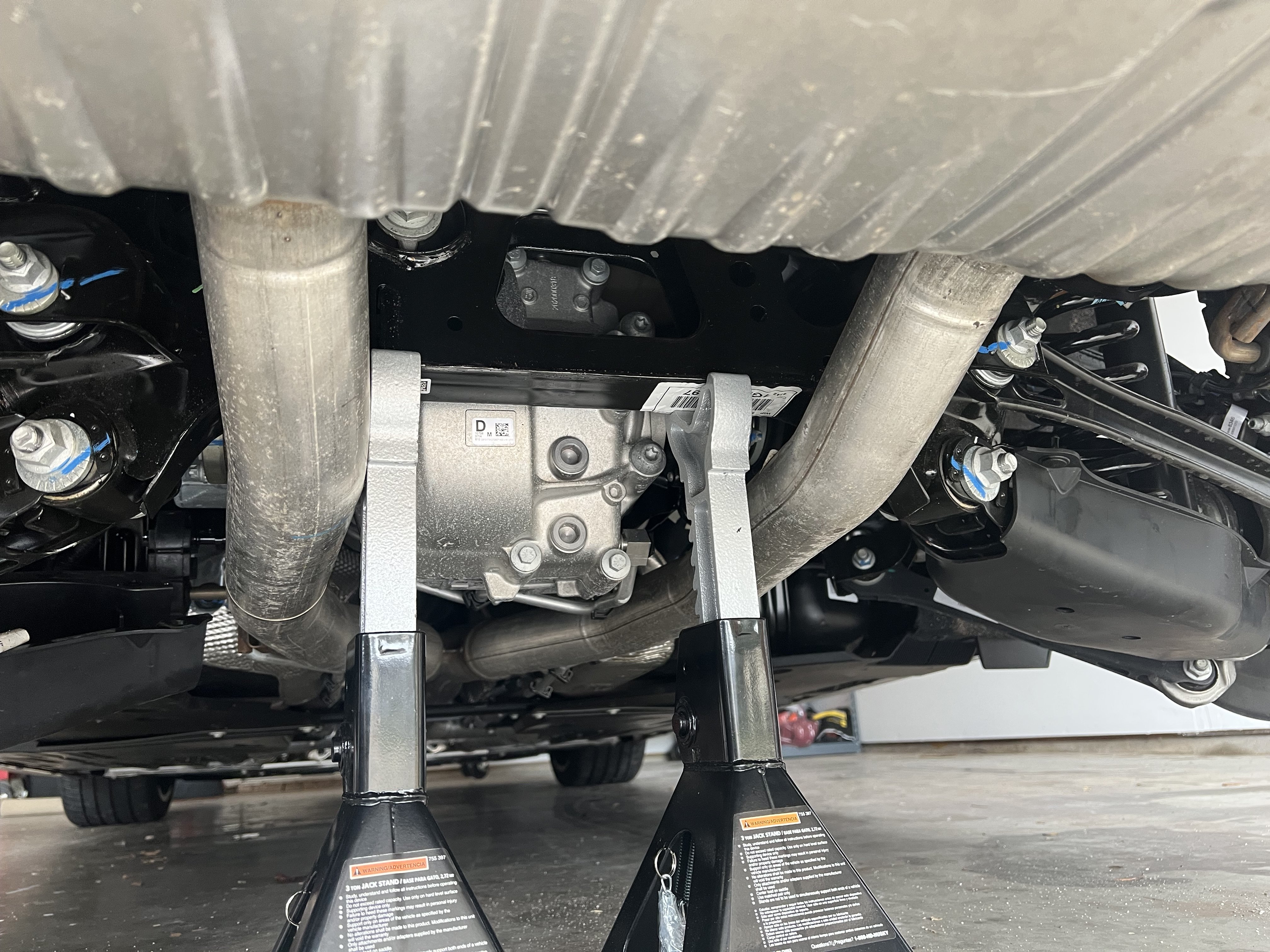

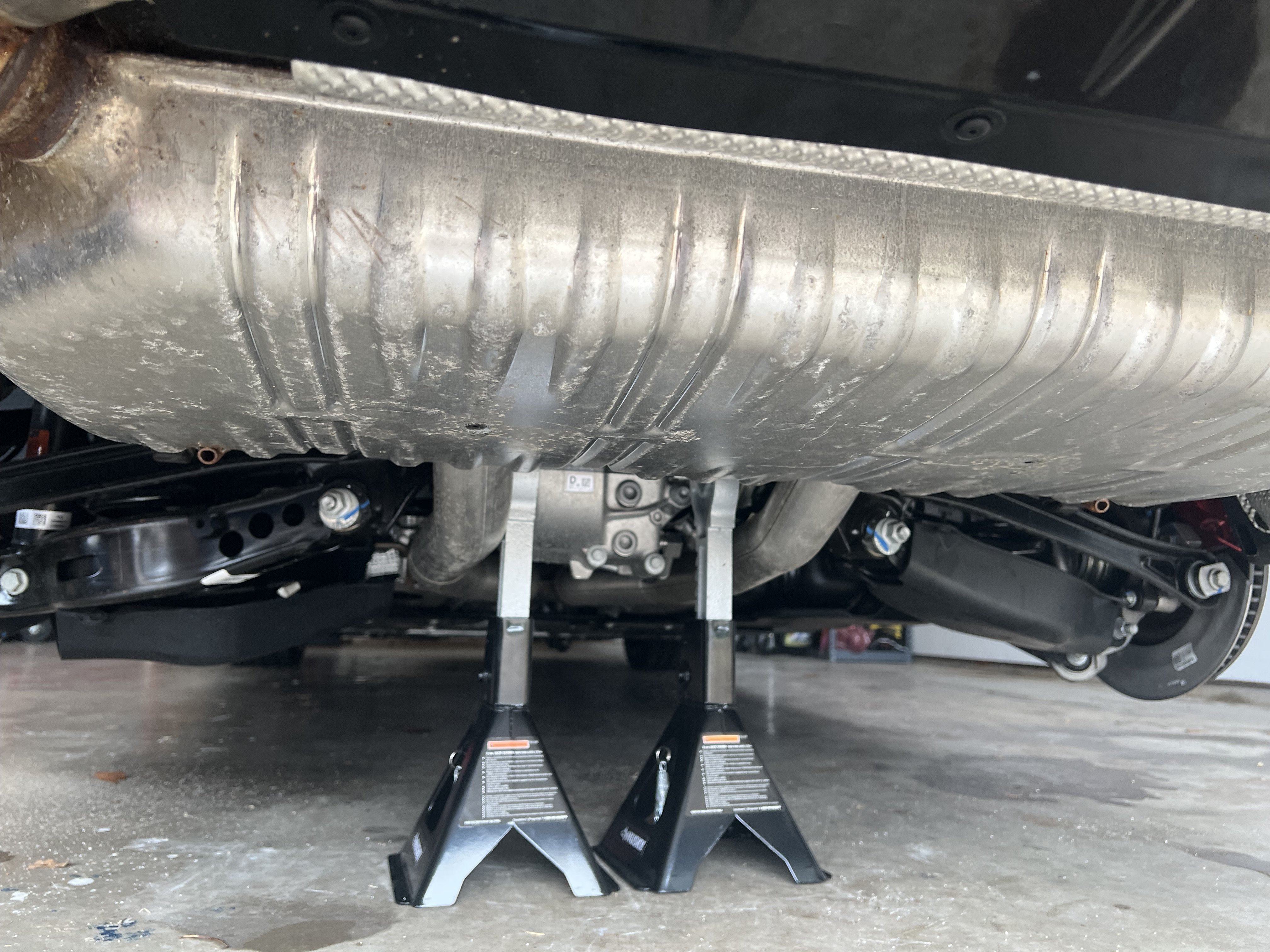

Yeah, that was me. If I needed to get all wheels up, I would've used the rear subframe at the rear of the diff after getting the front on stands. For oil changes I plan to use ramps going forward.
For tire rotations and brake work I will probably use the front jacking points and figure out an alternate place to put the stands since the jack will be in the way. I'm not sure where to place the stands yet but I'll figure it out. I will likely buy stands with a flat support area and look for a solid point on the front subframe, but I'm not 100% sure yet.
I have a long, low-profile jack, so I will likely lift the rear from the support behind the diff to place jackstands at the rear jacking points.

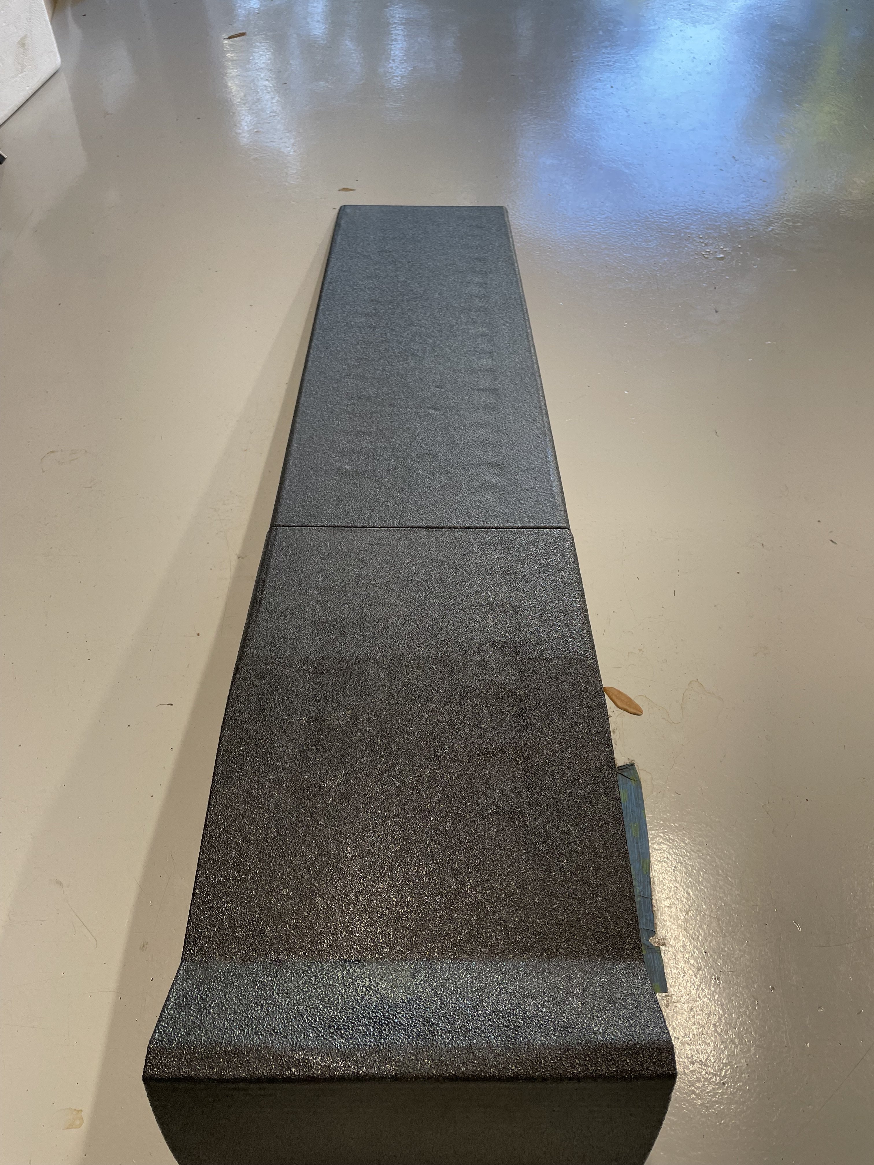

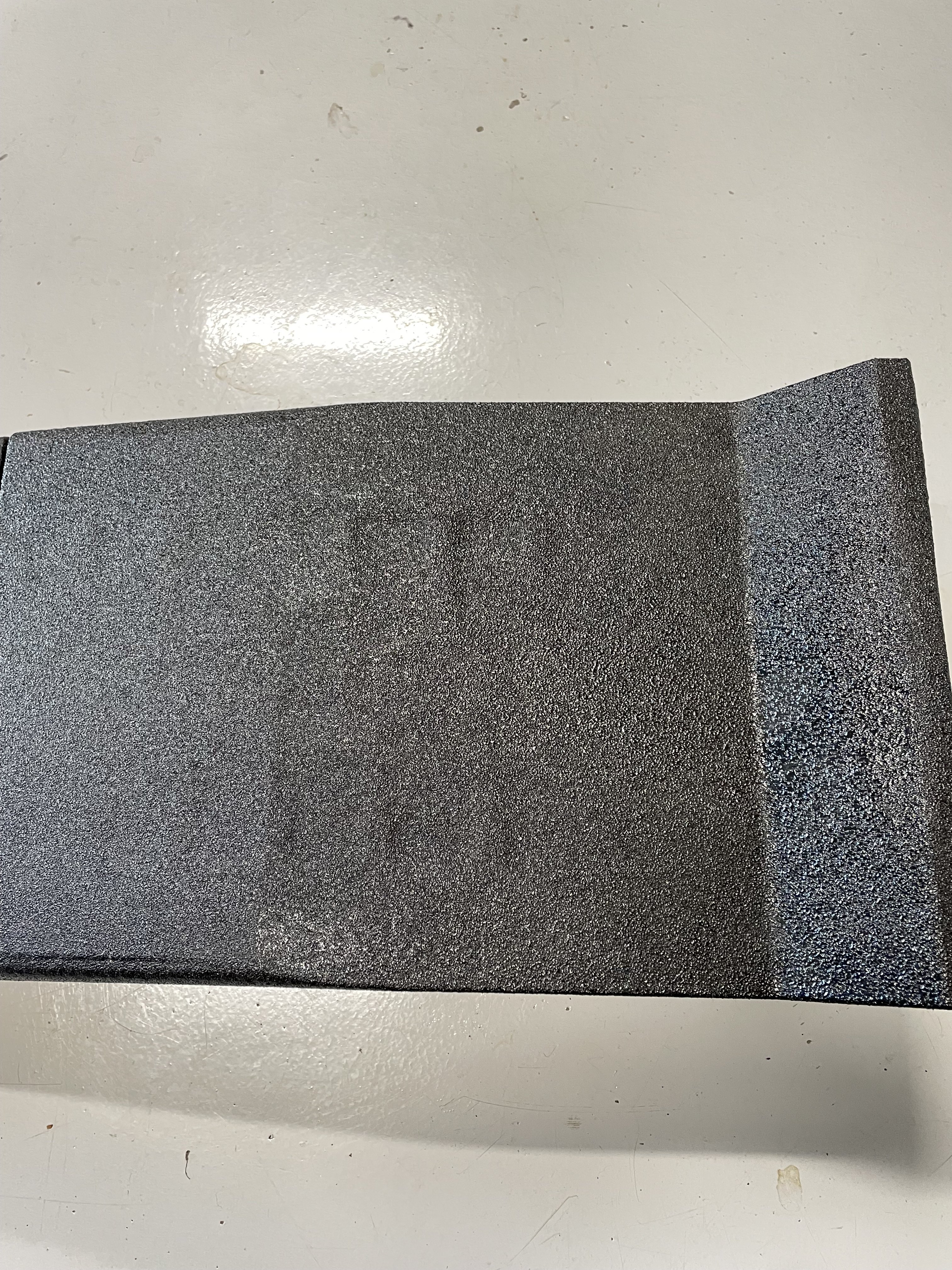

I ran across this video(s) building ramps out of wood on your own. Not expensive and the ability to move the ramp part out of the way makes it looks interesting as a feature on the more expensive type ramps. For our cars maybe a 2x10 instead of 2x8.

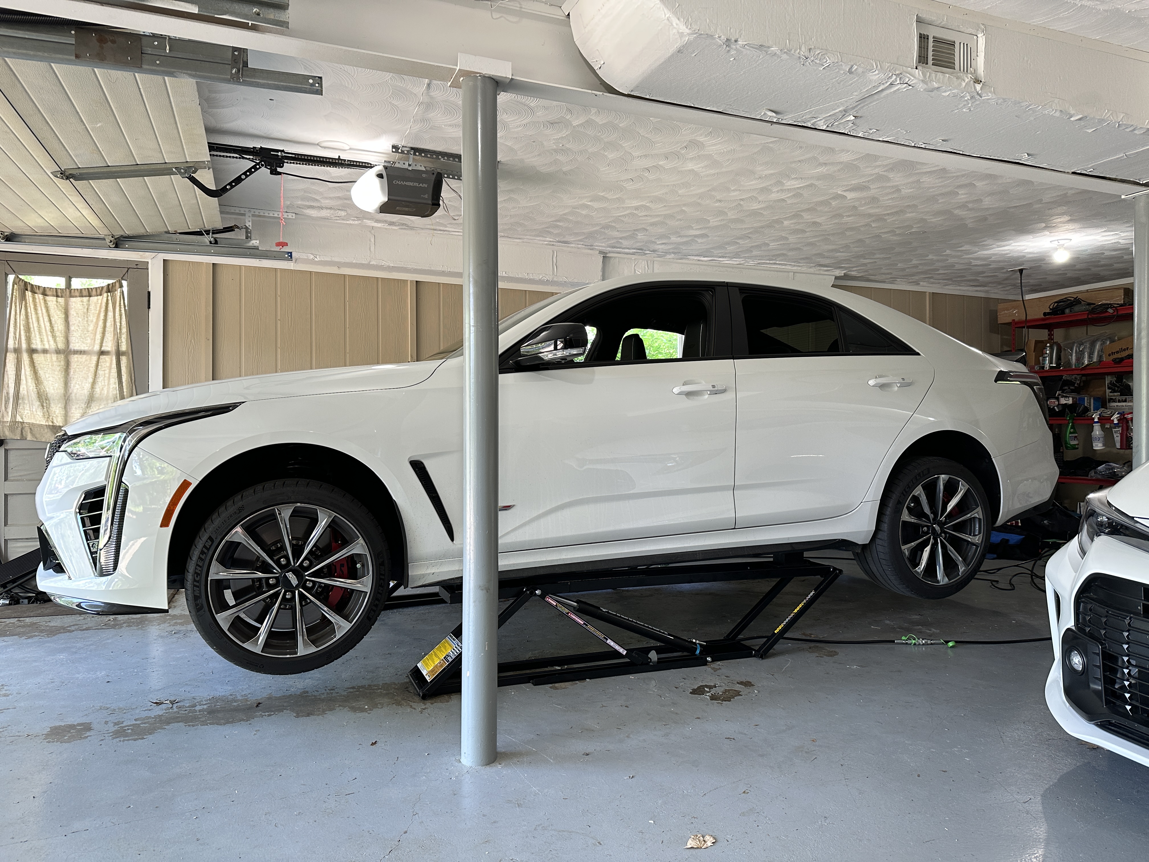

update:
I bought a QuickJack TLX 5000 during the Memorial Day sale. Finally got it set up and did the first test lift on my 4. I bought the 1.5 inch blocks separately just in case. I lifted via the front pinch weld with a 3 inch block on top of the 1.5 inch block and lifted by the rear brace jack point also with a 3 inch block and 1.5 inch block. I made sure that the blocks would be centered before fully lifting. Since the car has a front rake, I will likely use the 2 inch block on top of the 1.5 inch for the rear points next time so it’s level.
I also bought the puck with the cutout but it’s too big to be used for the front and will get caught on the side skirt and likely destroy it. It will fit fine on the rear, however.
The longest part of this is getting everything lined up properly. Though it’ll go quicker the more and more I do it. So far, so good.
You don’t need specific pucks or anything since the dense rubber blocks will work just fine. It’s no different than using a jackstand. If anything, this is safer and less damaging to the pinch welds because it’s being supported by dense rubber rather than the bare metal of jackstand heads. In addition, the blocks are supporting a larger surface area whereas a jackstand only supports a very small area.
I've got a 7000 TLX? for the 5 BW (still too short so turn it sideways.) To help you next time, just 4 short strips of scotch tape to mark alignment for the ends of the units under the side skirts. Will save you significant time in aligning the units each time.

You can put jackstands under the upper platform for extra security. In the never event that it would fail, the platform would just fall and rest on the jackstands underneath.
Im shaky on that thing for some reason? Oll schooolll jack and stands thing I guess. Sometimes, an analog guy in a digital world.
I understand. I too use jack stands as a backup but it really isn't needed. So long as you pay attention and ensure the cams are engaged in the locks, the hydraulic cylinders could fail and the locks will still hold the car in place.
I love my Race Ramps and have had for years and years! Lightweight and easy to store. Thanks for sharing as I may get the extra heavy duty ones for my truck as I think I pushed my regular 3000lb ones recently based on the tread marks left by my AT4 🤔… oops
