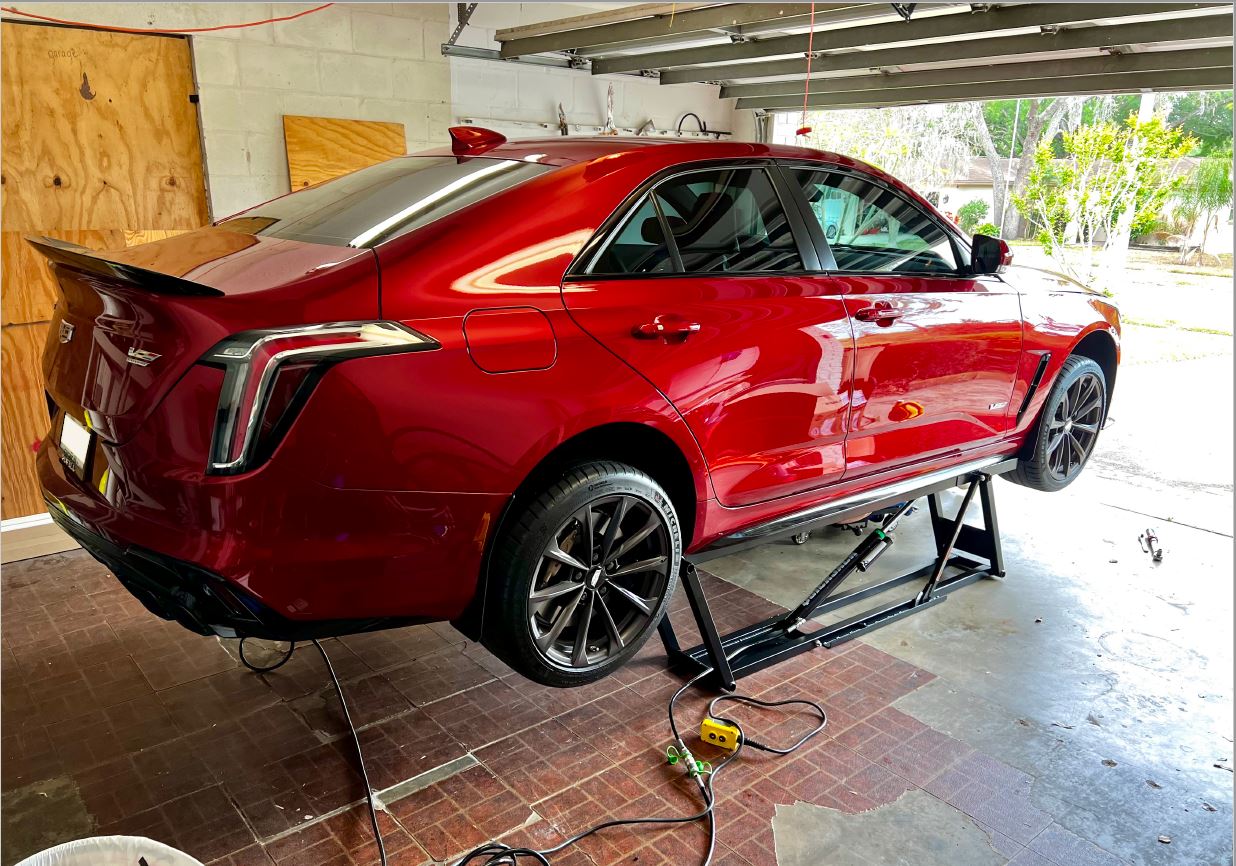

I could not get that quickjack pinch weld block to fit on the rear jacking point of the CT-4 BW. They also make a pinch weld puck, which I will try next.
I don’t think you have to have something sit flat recessed into rear cradle brace because it’s just under 3inch wide flanked by vertical metal sides. My 3inch wide hockey pucks lifted the brace at the outer vertcial sides of the brace just fine. The QJ 4in blocks would do fine as well. You don’t try to use the pinch well channel on the blocks for against the rear cradle brace did you?

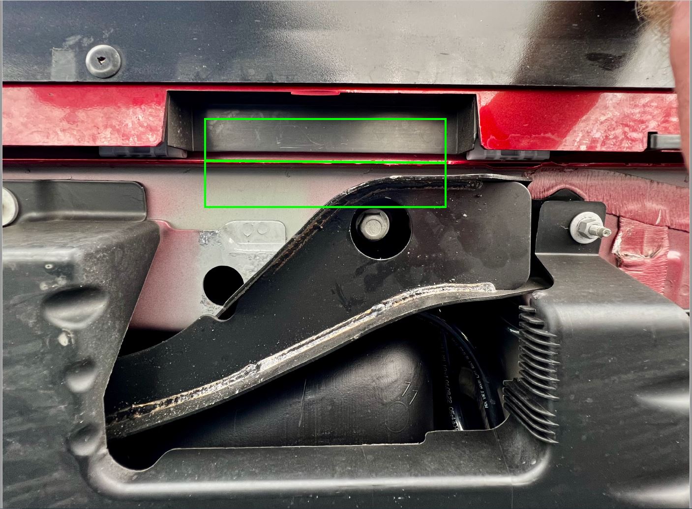

Was trying to use the quickjack pinch weld block where the green square is shown, but obviously that didn't work. It also wouldn't fit in any orientation on the rear cradle brace. The quickjack frame ended up supporting the rear cradle brace which worked fine. I think the pinch weld puck would fix the problem, but in the future I could just use the soild blocks or hockey pucks as you did.
Ah I see what you were trying to do. I agree, solid blocks or hockey pucks would work well for that rear cradle brace.
There is no way, I would trust that.....Just, my opine...^^^^
I'm not crawling under that. Just my opine. It's not a lift...Or race ramps. When it goes wrong? I hope it does not!!!! For me, no thank you.
Maintenance schedule on this item? I'm sure the caveats are there from the manufacture in small print. Maybe, fine print.

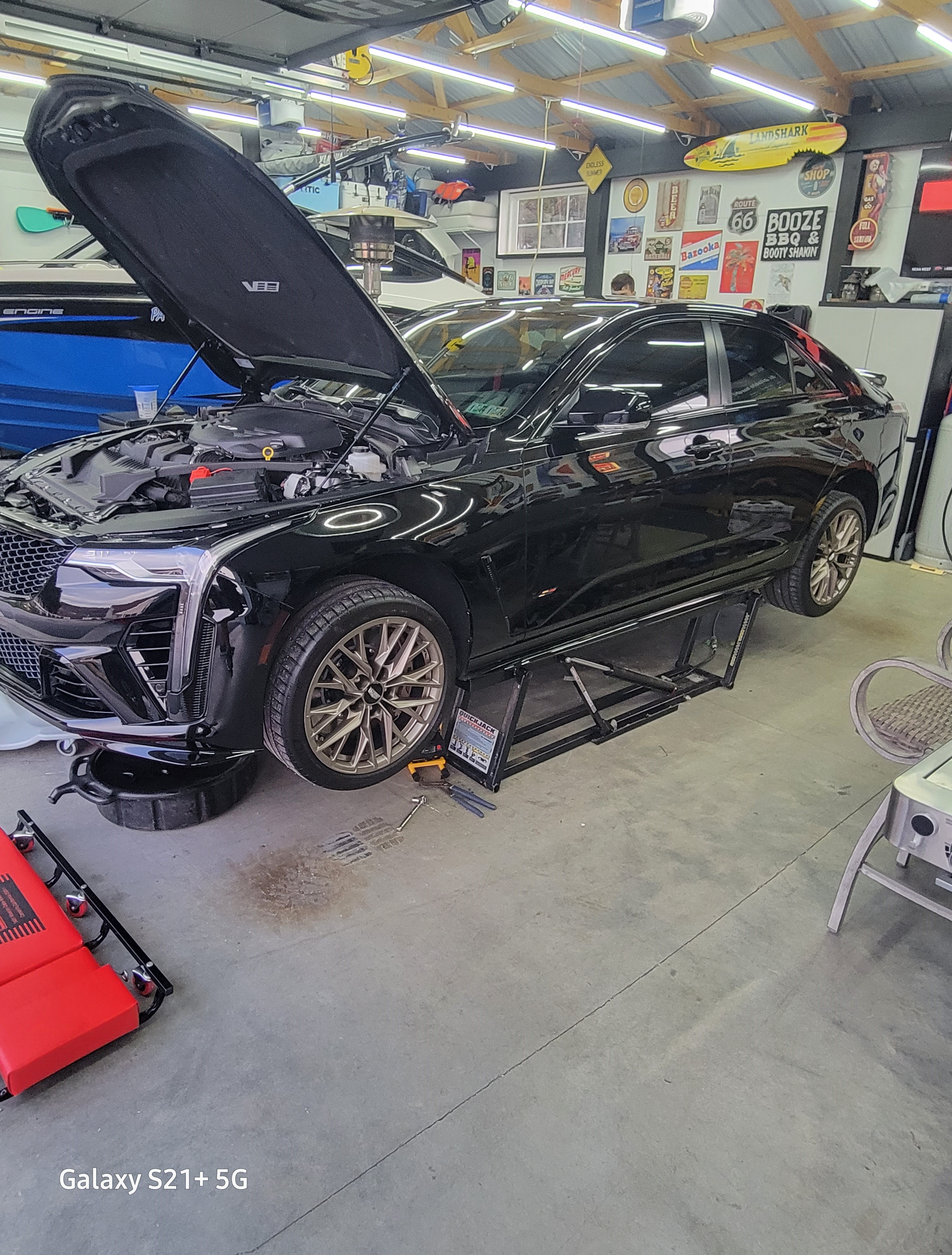

I've had everything on these. My Tundra is regularly on them for work, the BW, several of my friends cars. I fully trust these!!! As long as you're on the proper lift points they are solid. You can try to rock the car while its up, it doesn't budge. We've done trans swaps, lift kits, lowering springs, exhaust work, you name it. All the way to their original intent, detailing the car without killing my back. These are the EXT
7000's
I'm too old and out of shape to be laying on my back to do under carriage work. I need a full lift. My wife bought me a really nice creeper a few years back and its still in the box. I will probably just give it my brother to use at his auto body shop for one of the guys. I have to sit on the chair with wheels just to clean my wheels.
"youth is wasted on the young ".
QuickJacks are made by BendPak. Perhaps you have heard of them? It has mechanical up locks. Once it’s set, no way it’s coming down.
PTU uses ATF like most hydraulic lifts. MX is easy and simple.
I have had 20+ vehicles up on my sets. Everything from Civics to Diesel JL Rubicons.
There is a cross-tie brace that connects the two frames. It would be quite the challenge to push it over.

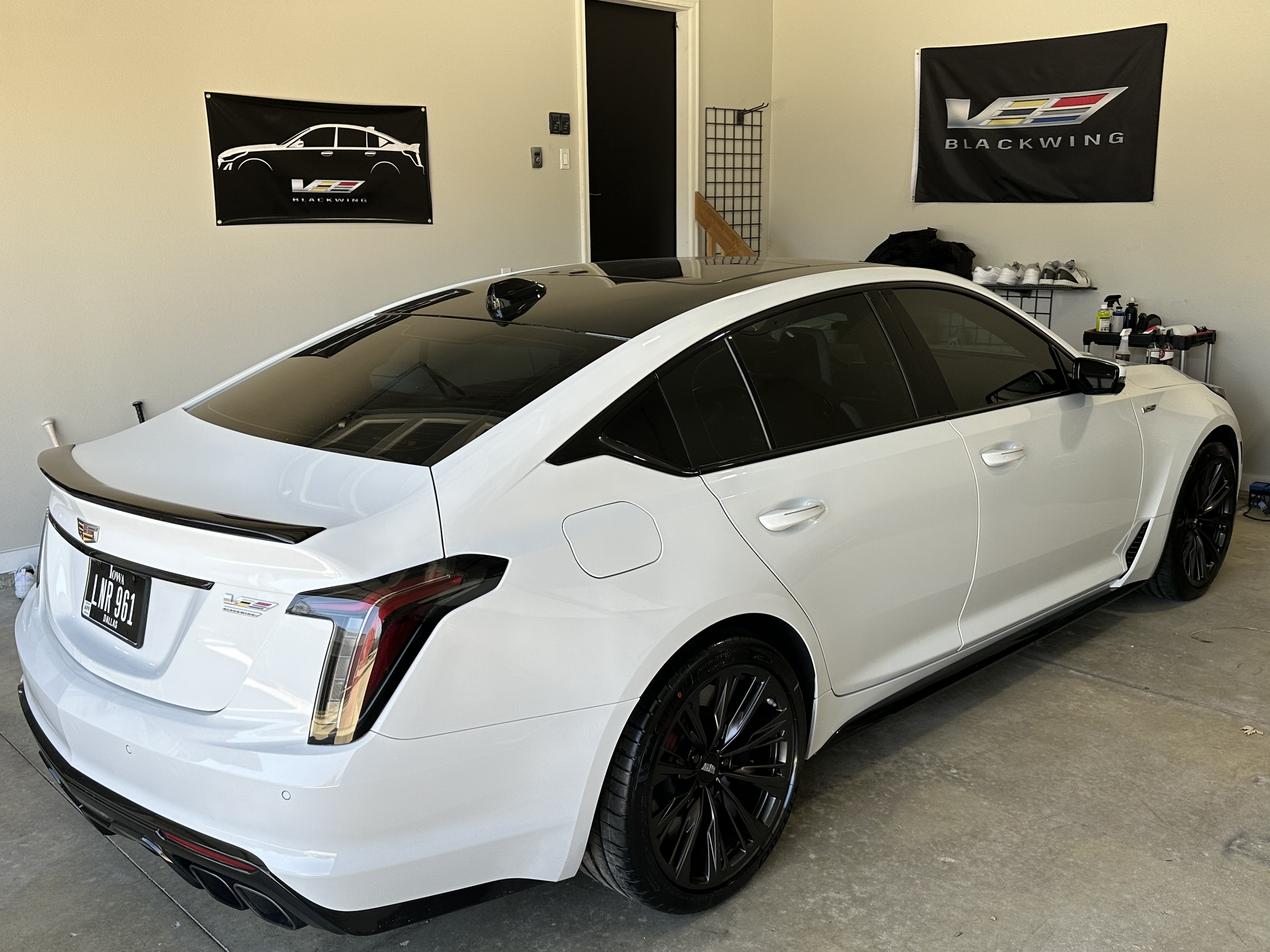

After reading this whole thread and struggling to find a shop that was available, I decided to just go ahead and DIY it in my garage. Like every other car I’ve worked on I used a hydraulic jack and a screw one for extra safety. All lifting was done on the pinch welds. Changed my tires back to stockers and put my winters away for the year :)
So I don’t think you need anything special at least for this type of job. YMMV but it went pretty well for me.
So I don’t think you need anything special at least for this type of job. YMMV but it went pretty well for me. View attachment 18236
Black roof looks sweet on white!
Thing is hot! I have all black on black and more black on inside.....I don't even like black!

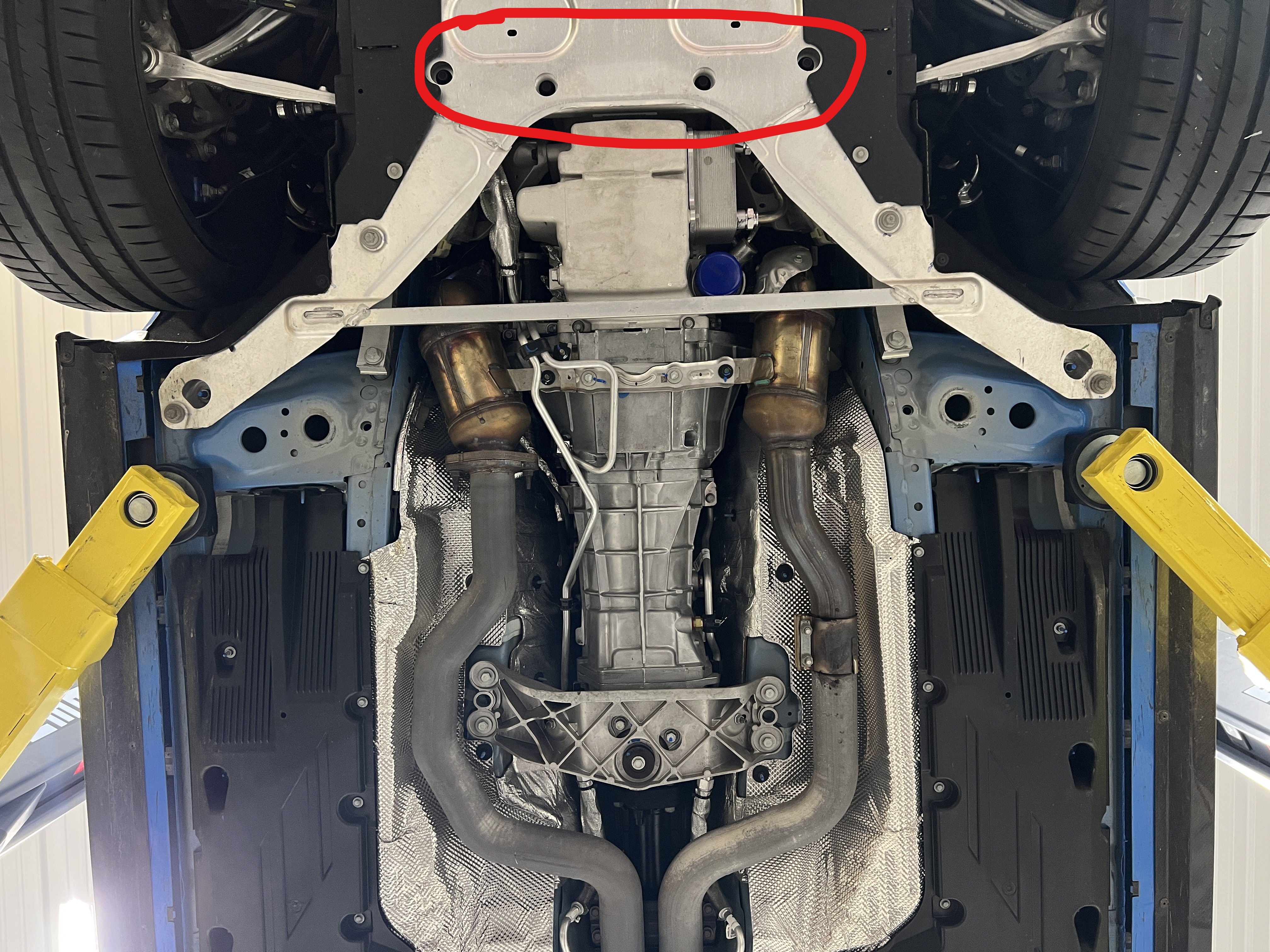

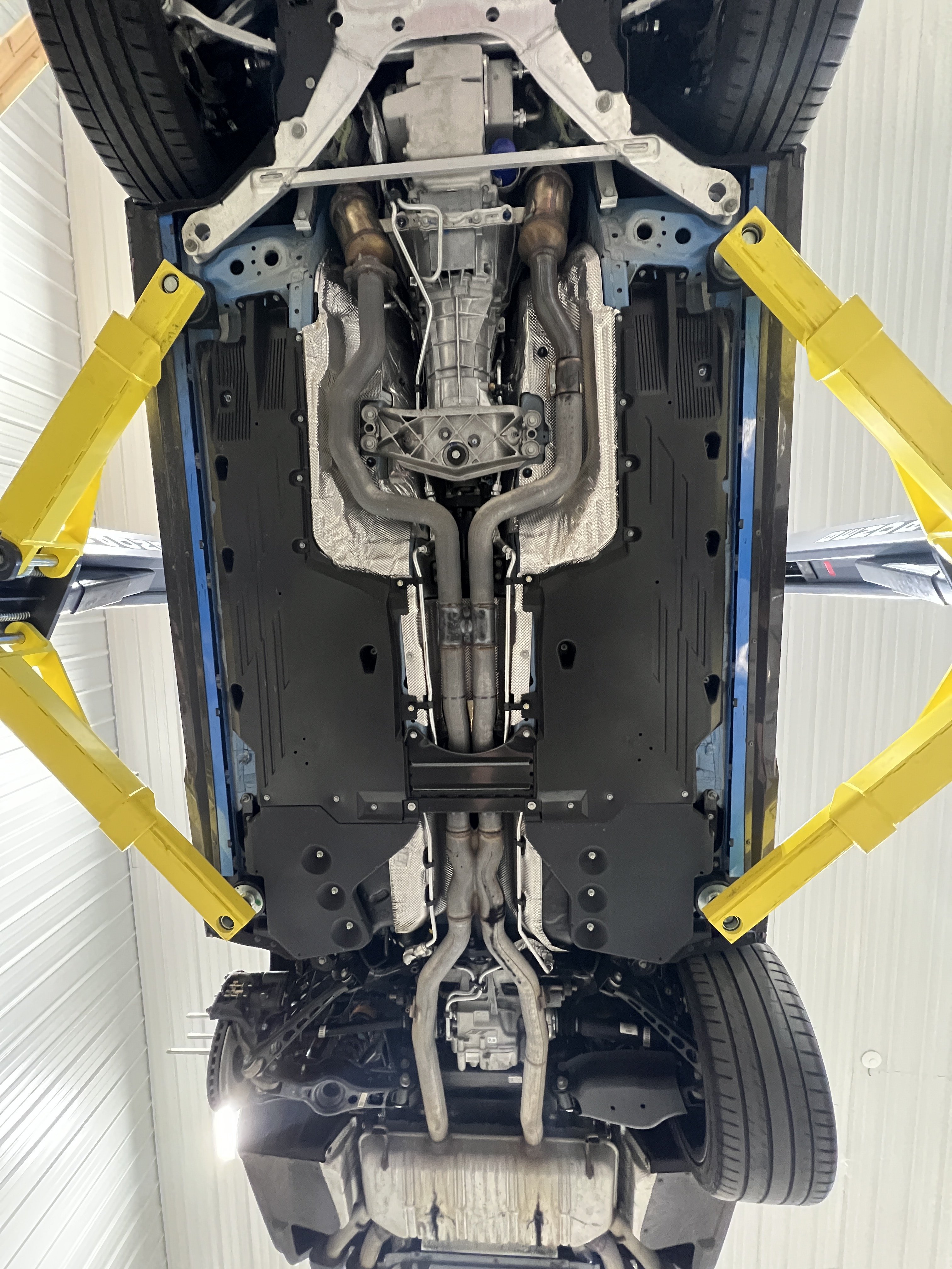

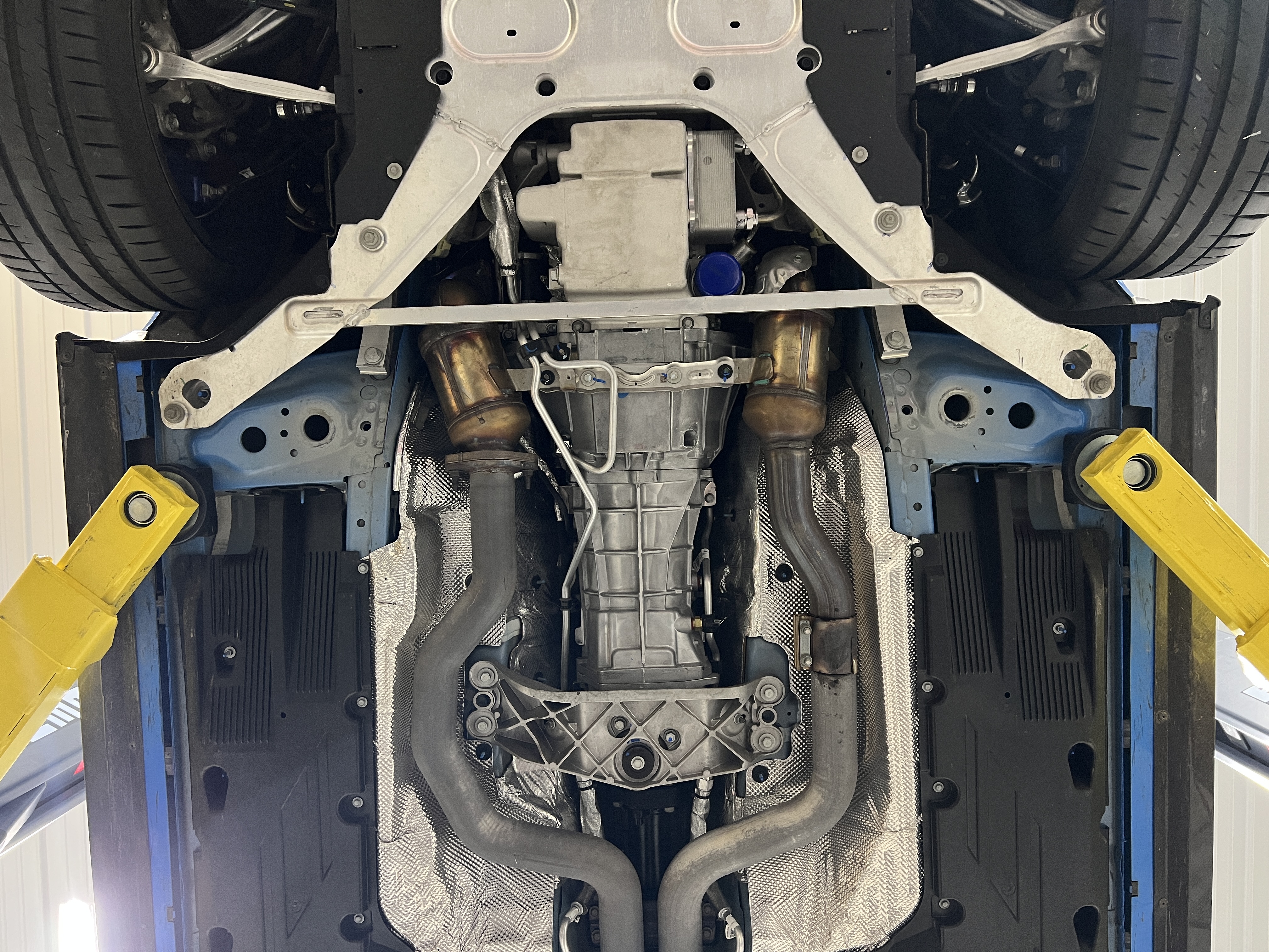

Unfortunately that block shown in the post doesn't exist on the 5BW. I looked under a number of 5's at the dealership (Lux, Sport, V) and they all have the front-center lifting point, BUT the 5BW has an aluminum(?) plate covering that entire area so there is no exposed lifting point. One of the above photos of a 5BW on a lift illustrates this. I have circled where the lifting point is on CT5's other than Blackwings.
