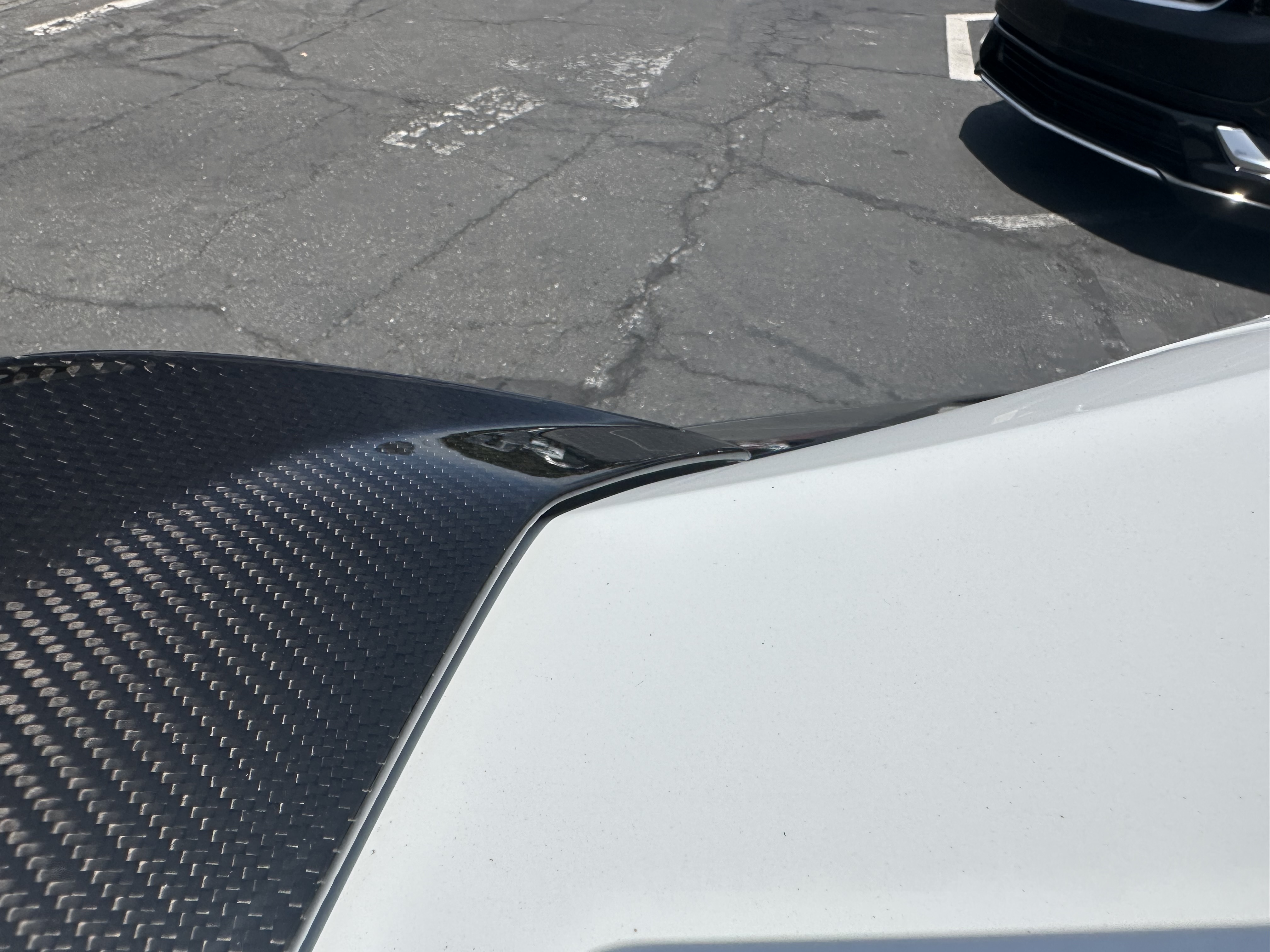

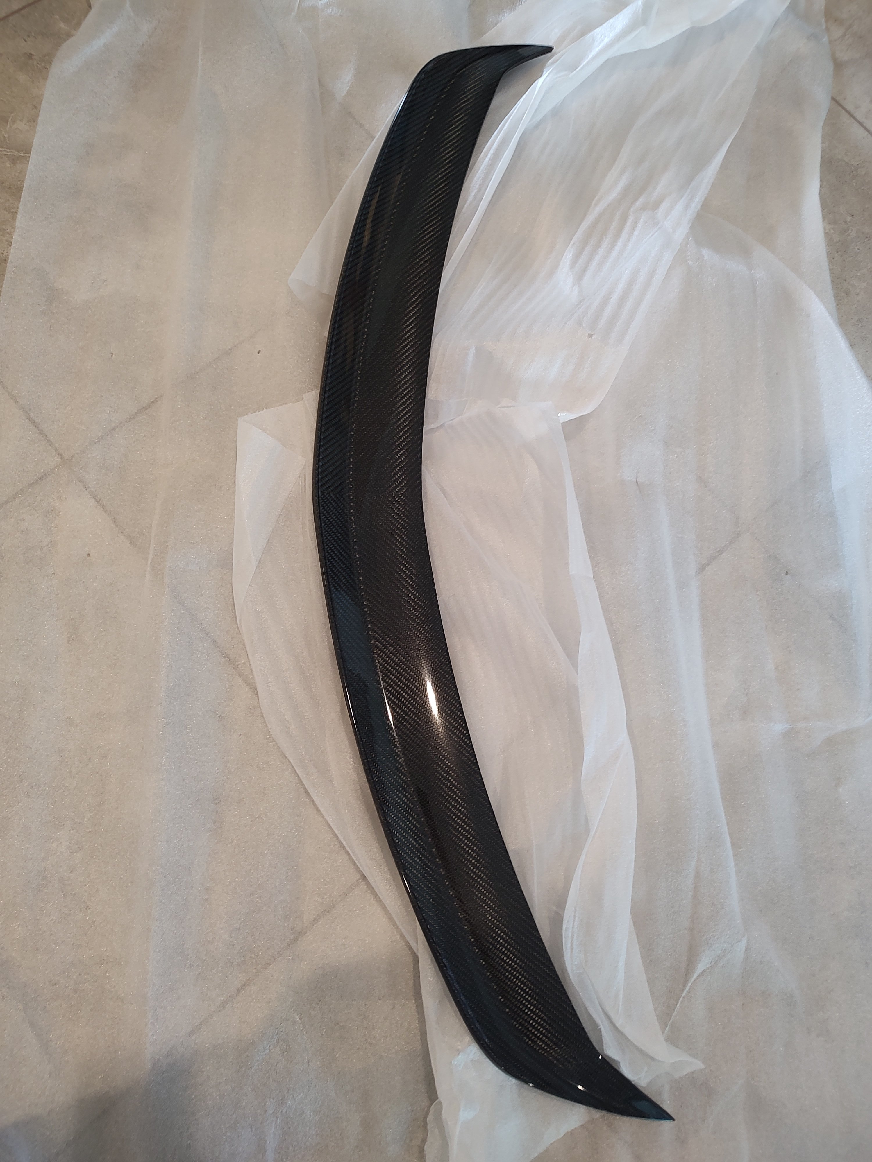

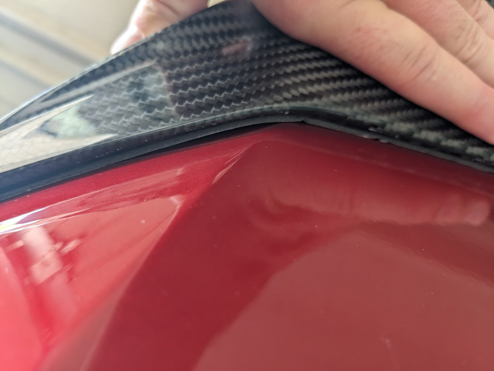

Okay so I drilled the holes and lay the spoiler on the car. Everything seems to fit nice except around the bend in the trunk on the front of both sides of the spoiler. Seems to be fine around the back. I heard how well this fit for everyone else and I am wondering if others had this experience. Please note I have no bolted the spoiler down yet or removed the film from the 3M tape so that may be contributing to this. I have looked at the holes and the studs seem to fall into place nicely so I don't think its an issue with the drill hole location. Also I did drill out oblong holes as well. I even tried this without the outside studs just to make sure and same thing.
Before I proceed I wanted to see if this was normal or not or if its alleviated once its bolted down or what. If it is normal I am wondering if it needs a little 3M extra tape in this location before I start bolting it down. The only other thing I can think of is either my spoiler is malformed or somehow my trunk lid is.

Nice work!
Once you tighten down the spoiler and allow the 3M tape to adhere it should suck right in. This is also why bolting down the outer studs is best for overall fitment.

Alright thanks. Now to the hard part of trying to figure out how to tighten those outer bolts since my arms can't fit in there.
@Likuid that is exactly what I experiened and what I was referring to here CT5-V - Finally: CT5-V Blackwing Reproduction Spoilers
No matter what I tried, I simply could not get the outside corners to adhere while only using the inside 4 studs. I considered taking mine off and redoing it but honestly couldn't be arsed. I ran a line of ultrablack rtv around it.

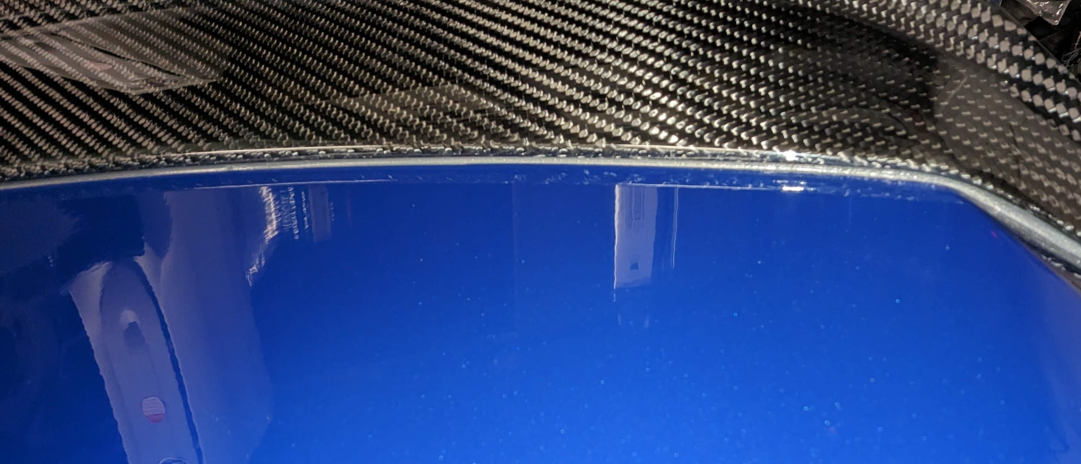

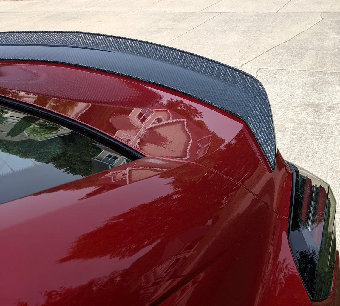

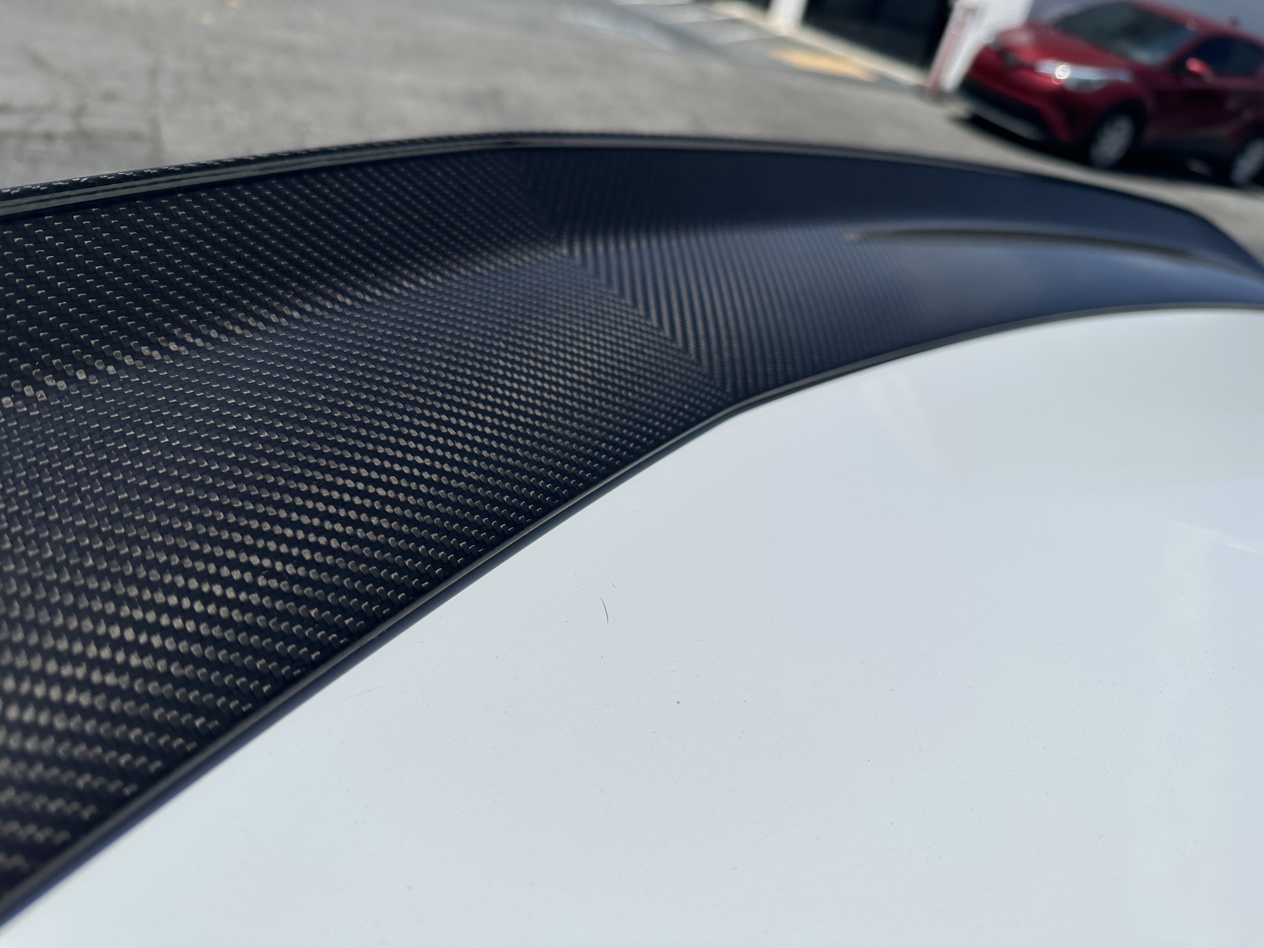

Hey fellas, just as a little PSA regarding the spoiler install. Gaps on these are normal. Here are some pics of the OEM carbon package spoiler installed on a 120th Blackwing. The OEM spoiler is not designed to actually contact the deck lid. Only the 3M tape contacts the trunk.

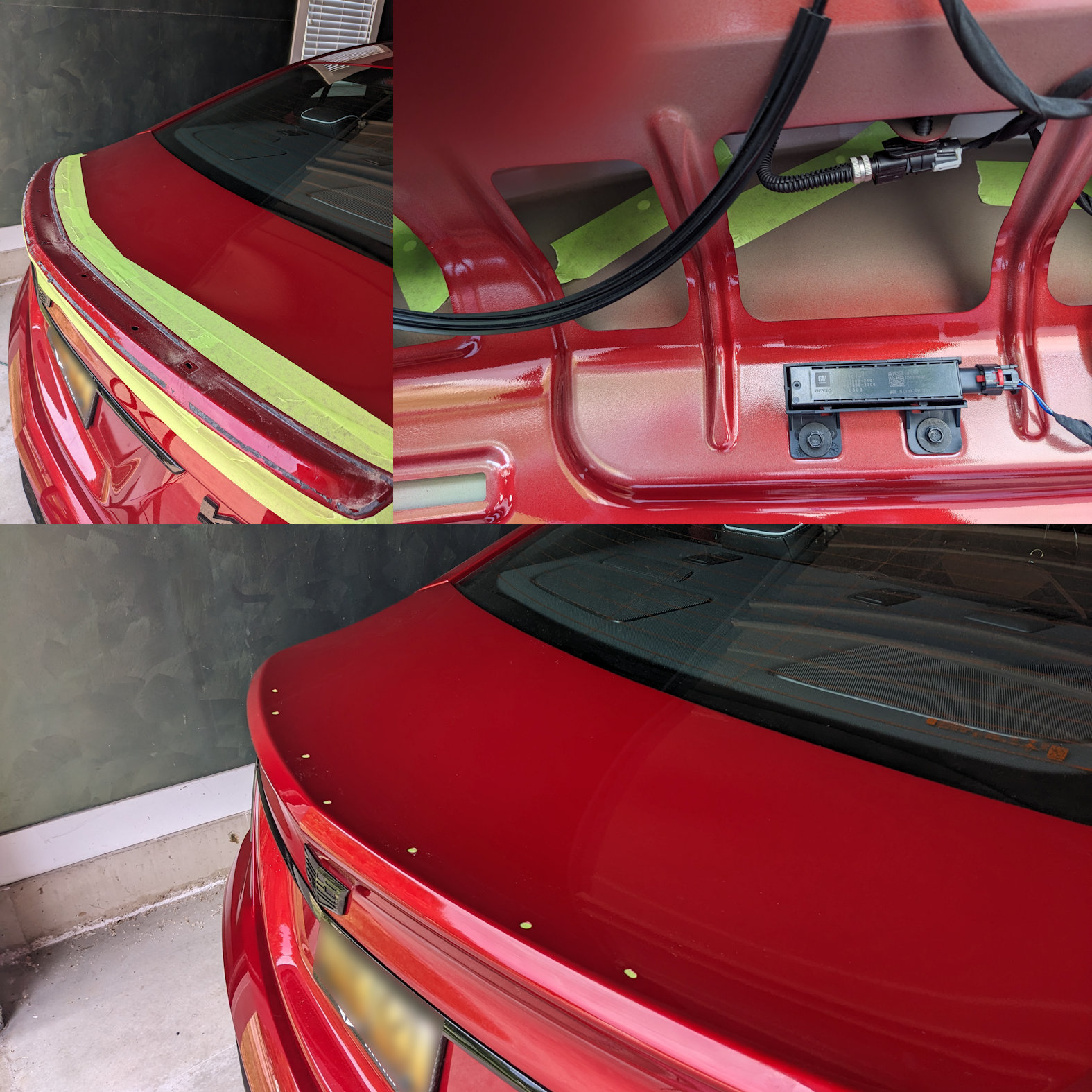

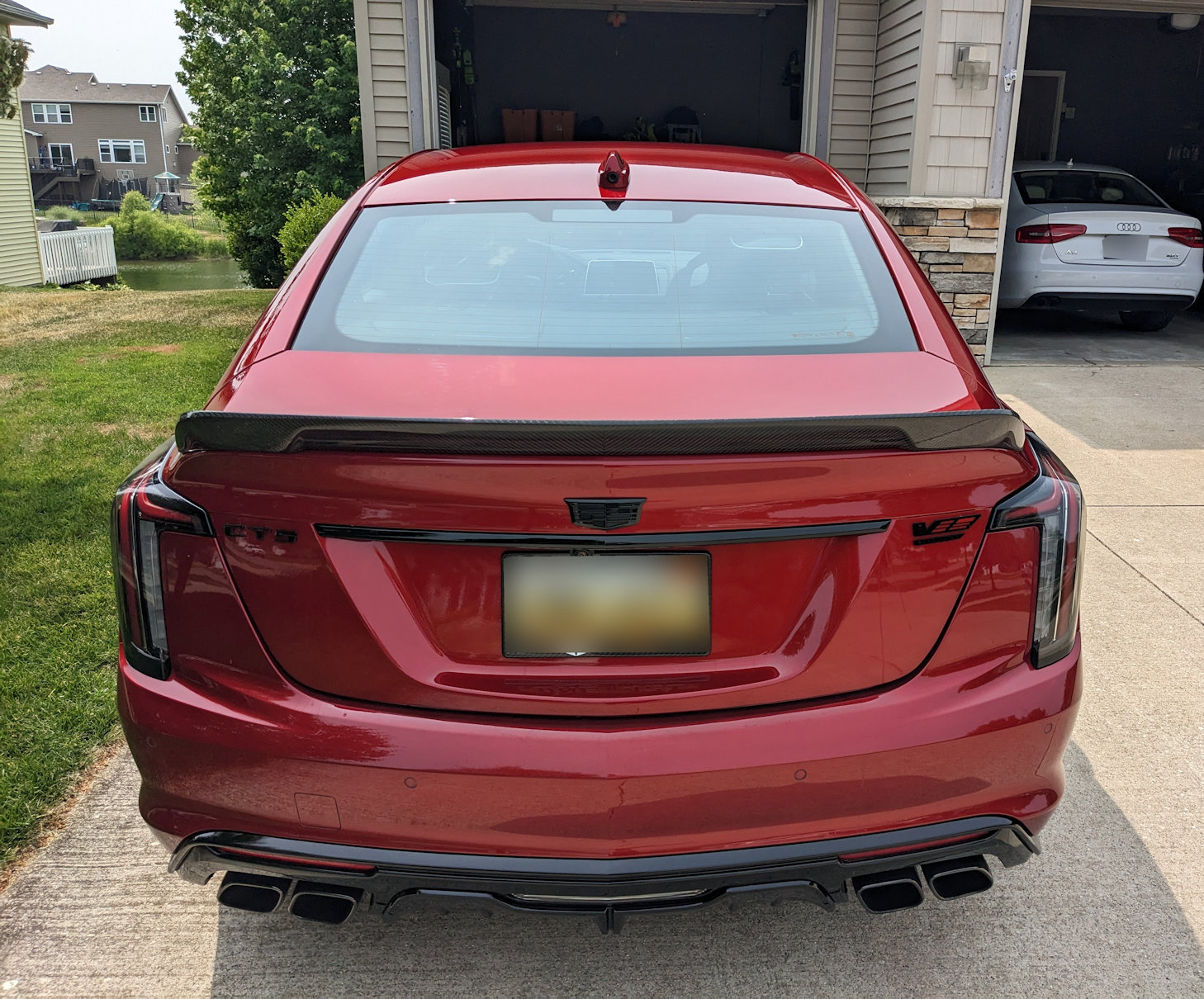

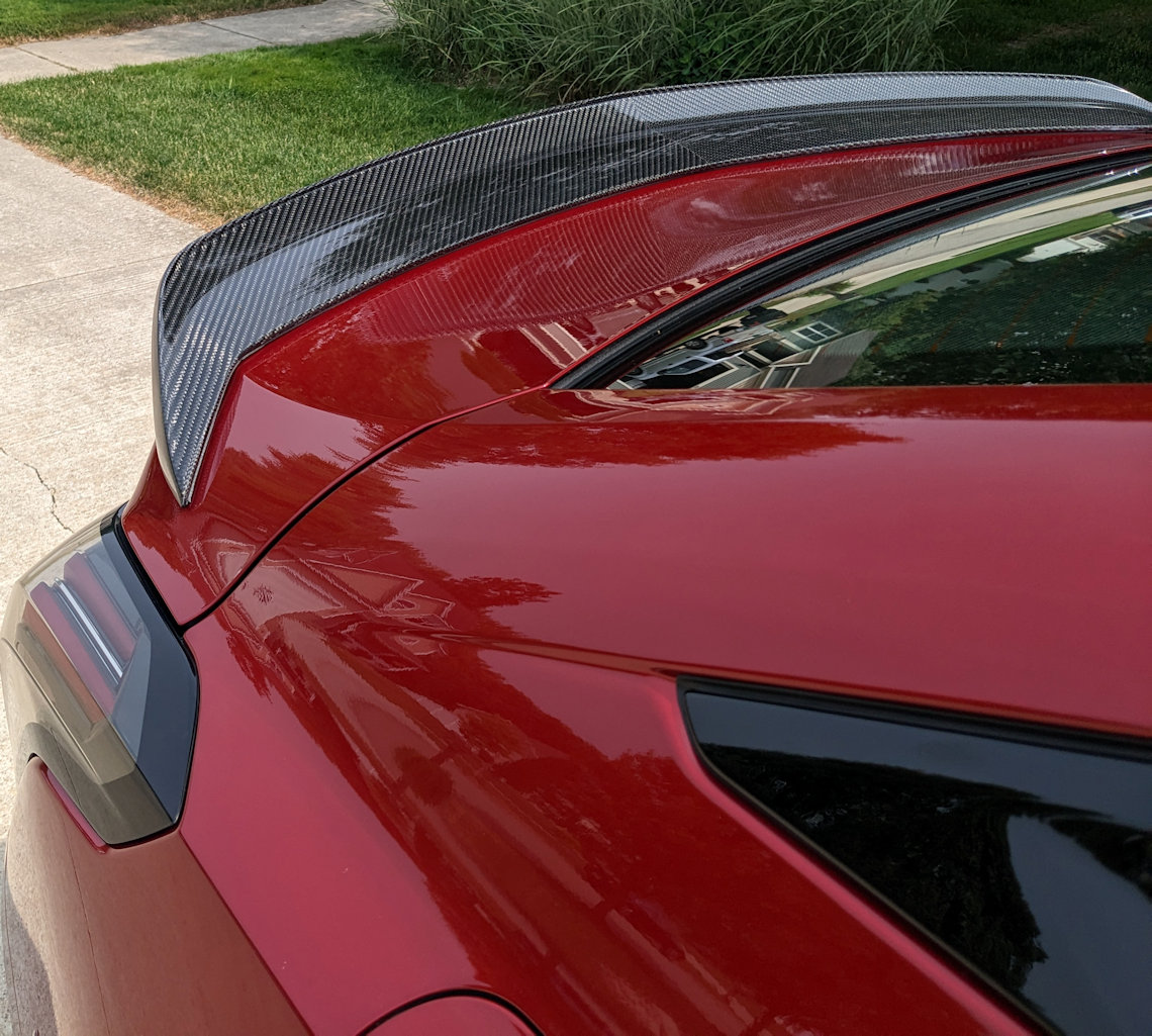

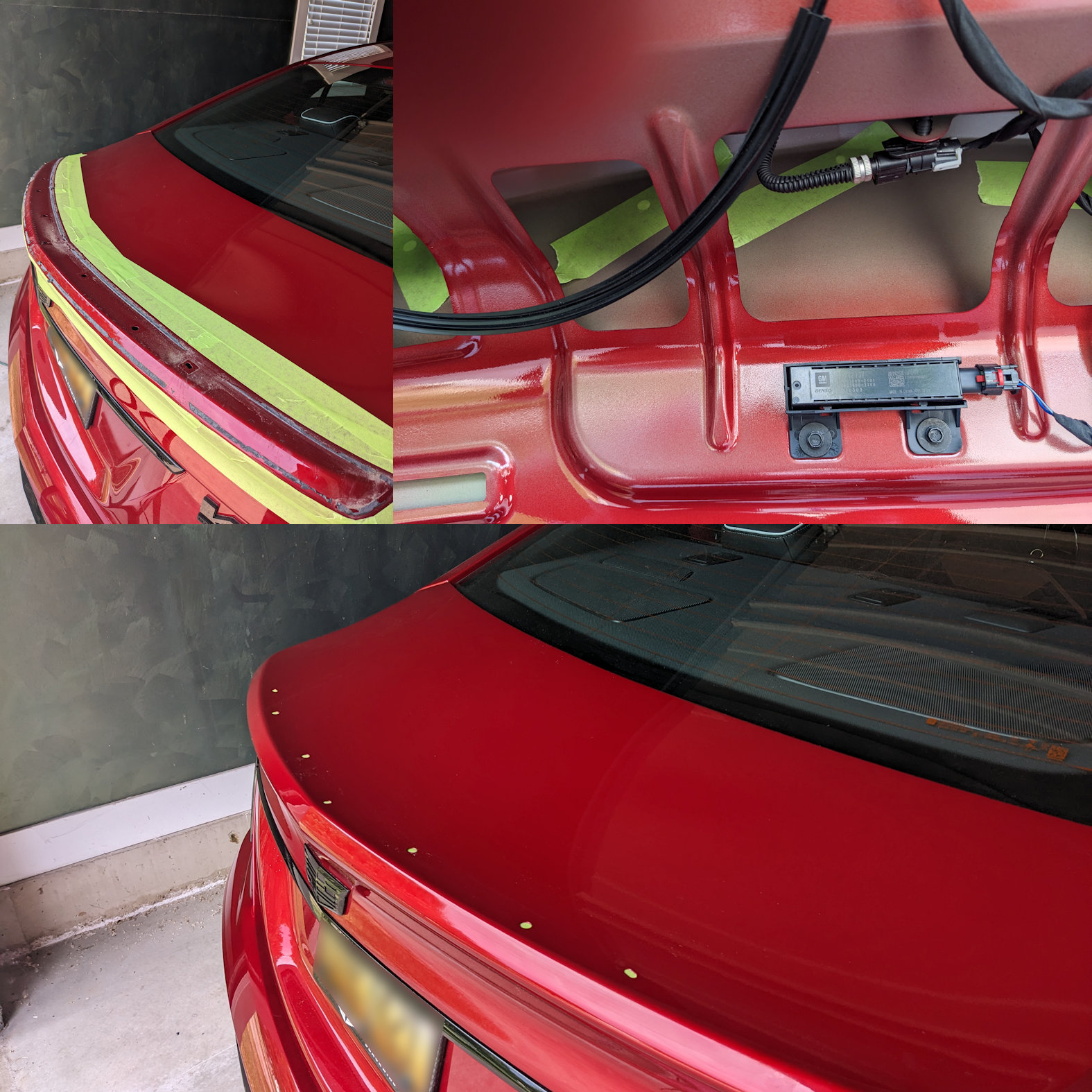

So, I finally finished the installation of my spoiler this weekend. I was hoping I would have some secret sauce for bolting down the outside future buyers to give you more confidence in doing this with exact tools and methods to easily install this. Unfortunately, that isn't exactly the case. UPDATE: Some users said the outside retainer clips work with this spoiler (information below). I highly suggest using those instead of trying to bolt them down yourself like I did.
I will alleviate some concerns. Marking and drilling the outer holes isn’t as big of a deal as it seems. Most of the process is not overly difficult…until it is. I won’t lie. The outer bolts are a huge pain in the butt if you do not use the Retainer Clips mentioned below, and I really found no tool I had or that I bought to be adequate for the job. Every time I thought a tool or method would work there was another wrench (no pun intended) thrown in my way.
To be clear I am happy with how everything turned out still. The spoiler fits well even though I couldn't find a definitive solution to torqueing down the outside nuts

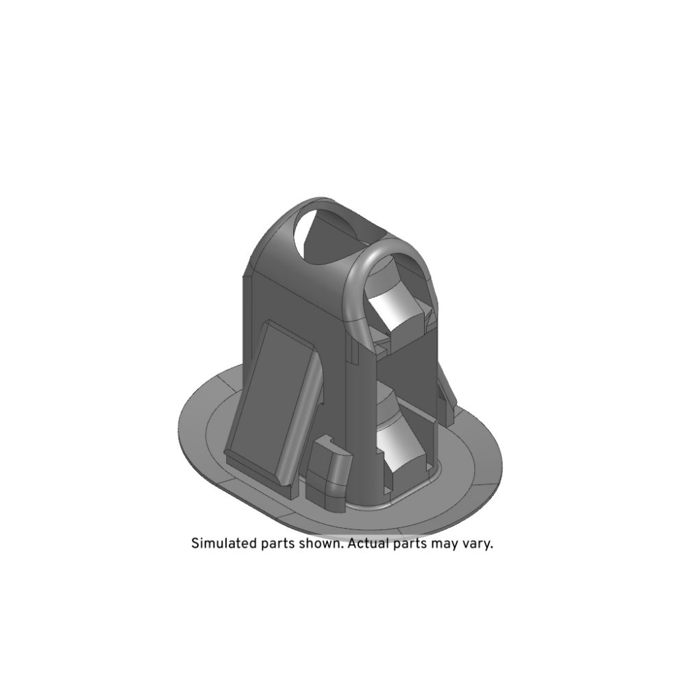

Retainer Clips
1000X1000
It is highly suggested you use the Retainer Clips for the outside spoiler bolts because it is very difficult to access this area of the trunk. You will need 2 of the White Rear End Spoiler Retainers (PN: 42786993). I did not use these myself because at the time it was not confirmed that they would work and I got tired of waiting for them on back order. I would suggest ordering these ASAP while you are waiting on your spoiler to arrive, because there may be a lead time on them.

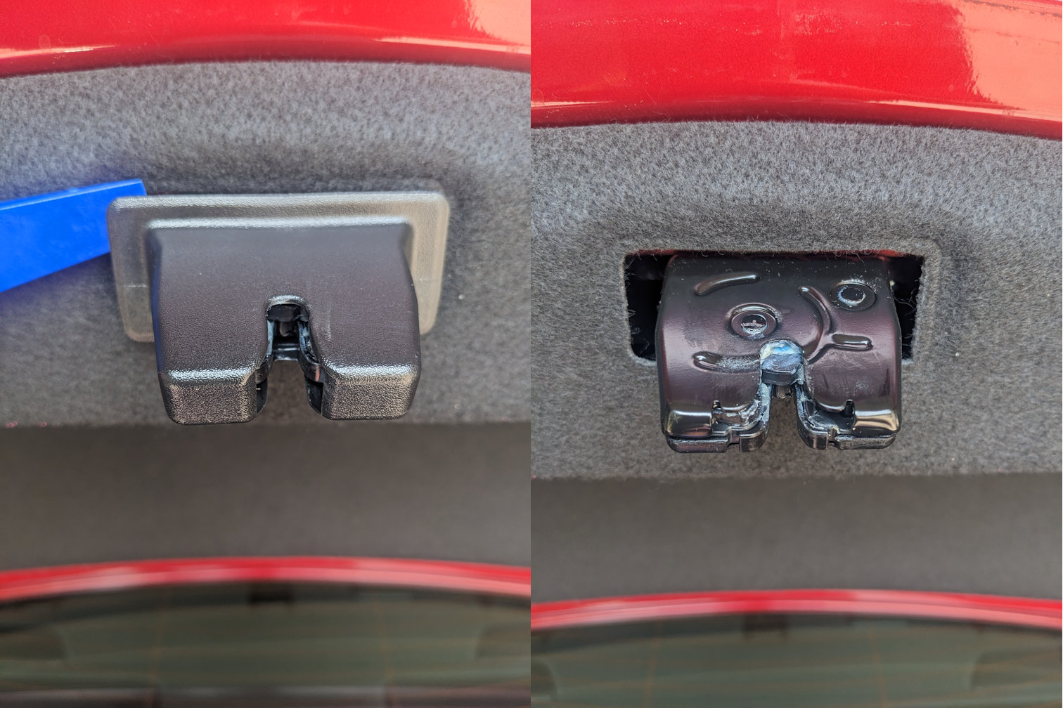

Removal of the Trunk Liner
I would suggest removing the trunk liner before removing the factory spoiler. It allows you to see what you are dealing with and begin to strategize the rest of your adventure installing the new spoiler.

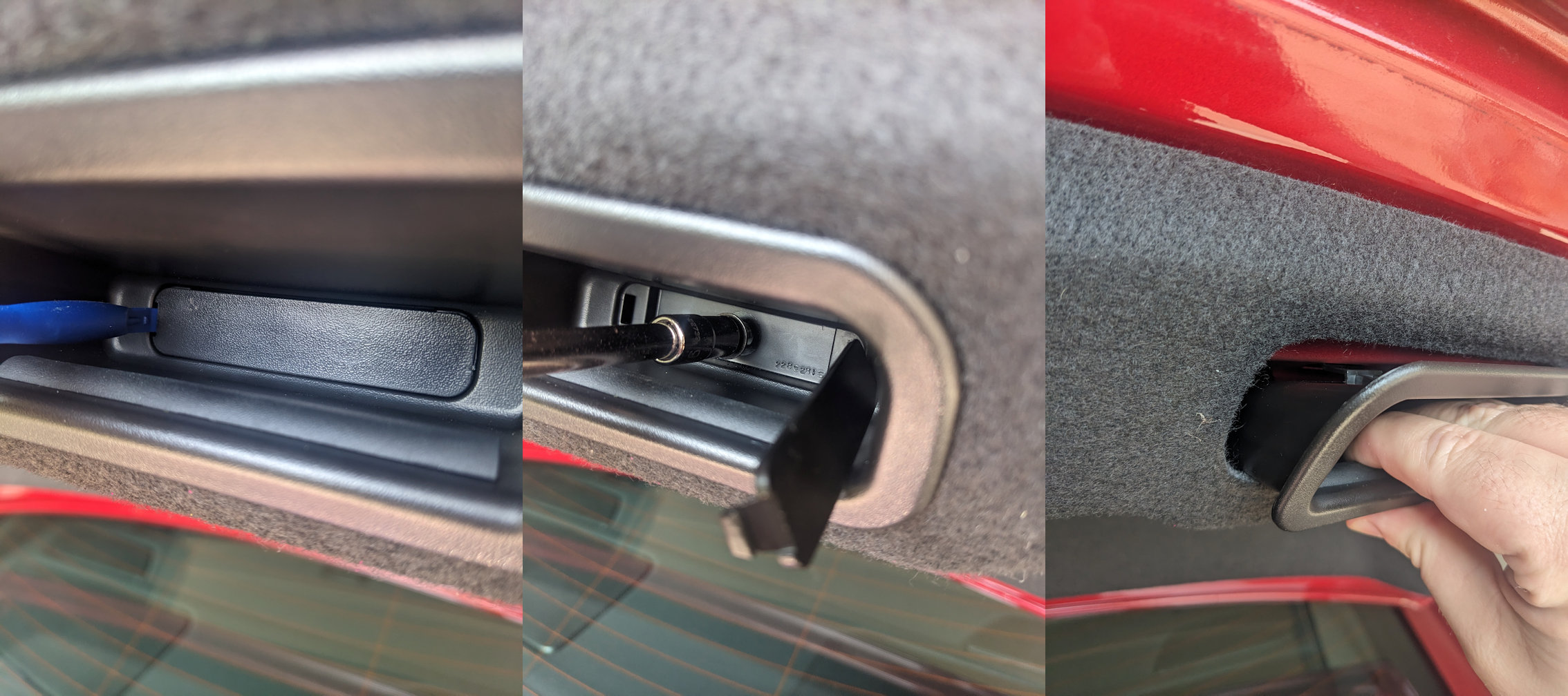

  • Remove the plastic over the latch.
    Use a plastic trim removal tool to pry it off. It comes off easily.
  • Remove the inner grab handle area.
    Use a small plastic time tool to pop off the inner cover and then use a socket wrench with an 3”+ extender to remove the black bolt under that cover. Then grab the handle and pull it out.

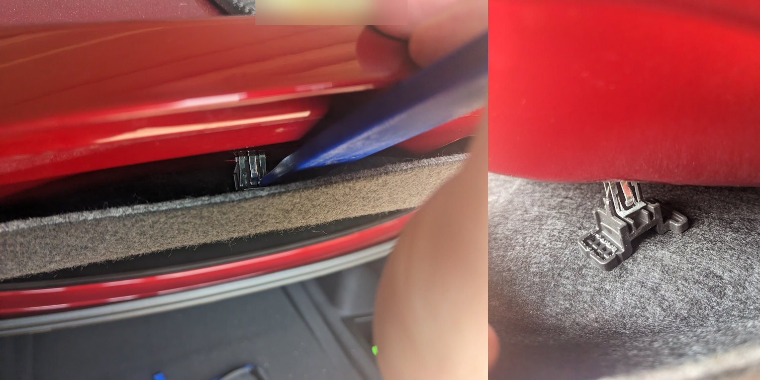

  • Removing the liner.
    I won’t lie this process can be a bit annoying. There and 9 clips holding the liner on. Its easiest to start with are the two at the front and then work your way back. The clips seem to require pressing the metal pieces from both sides to best unclip them from the trunk, however this isn’t always possible or easily done. Sometimes the clips will unclip while just pulling on the liner a bit, some seem to come off a bit easier if you can at least press one side of the metal piece while pulling. This is one of those things that’s hard to explain, but once you start messing with it you will understand. You will need to pull or pry back liner to get access to the clips. WARNING: These clips are just melted on to the liner and it’s possible for them to break off. I accidentally broke one of mine. However, I used Loctite General Epoxy to re-attach the one clip I broke off and it seemed to work just fine.

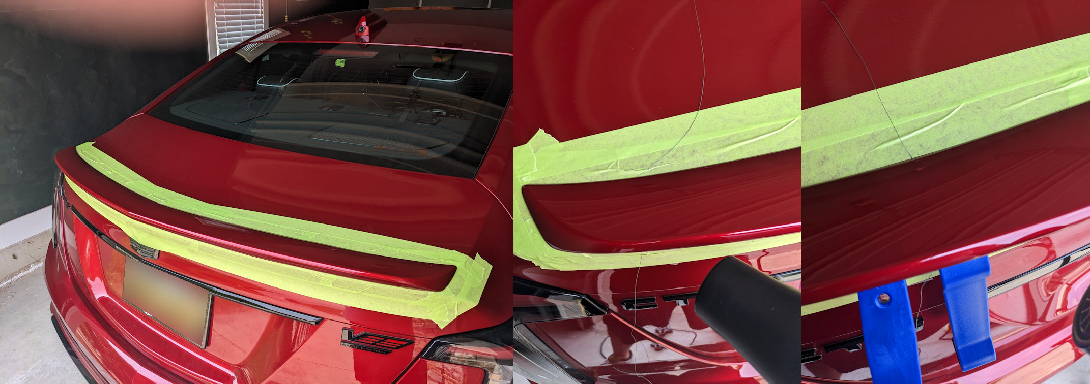

Removal of Factory Spoiler
The factory spoiler is pretty easy to remove with some fishing line, hair dryer and trim tools.
  • I completely masked off around the spoiler using 3M auto masking tape (but any painters tape should work as well).
  • Just start at one end of the spoiler heating it up with a hair dryer (do not use a heat gun as it may damage things with too much heat).
  • Then use some of the fishing line to kind of saw away at the trim tape hold the spoiler on. I did stop every few inches and heat up more of the spoiler around the edges.
  • Eventually you will hit one of the 3 alignment posts. You can see them if you look at the spoiler area underneath without the liner.
  • I heated up this area well and used different time tools to pry the spoiler up so I could then feed the fishing line under the spoiler to continue you on using the fishing line to cut away at the spoiler trim tape.
  • Do the same thing when you hit the middle post.
  • When you get to the 3rd post on the other end of the spoiler just take the fishing line out and start with it again at that end moving toward that post. Once you get there you should be able to pry off the spoiler.

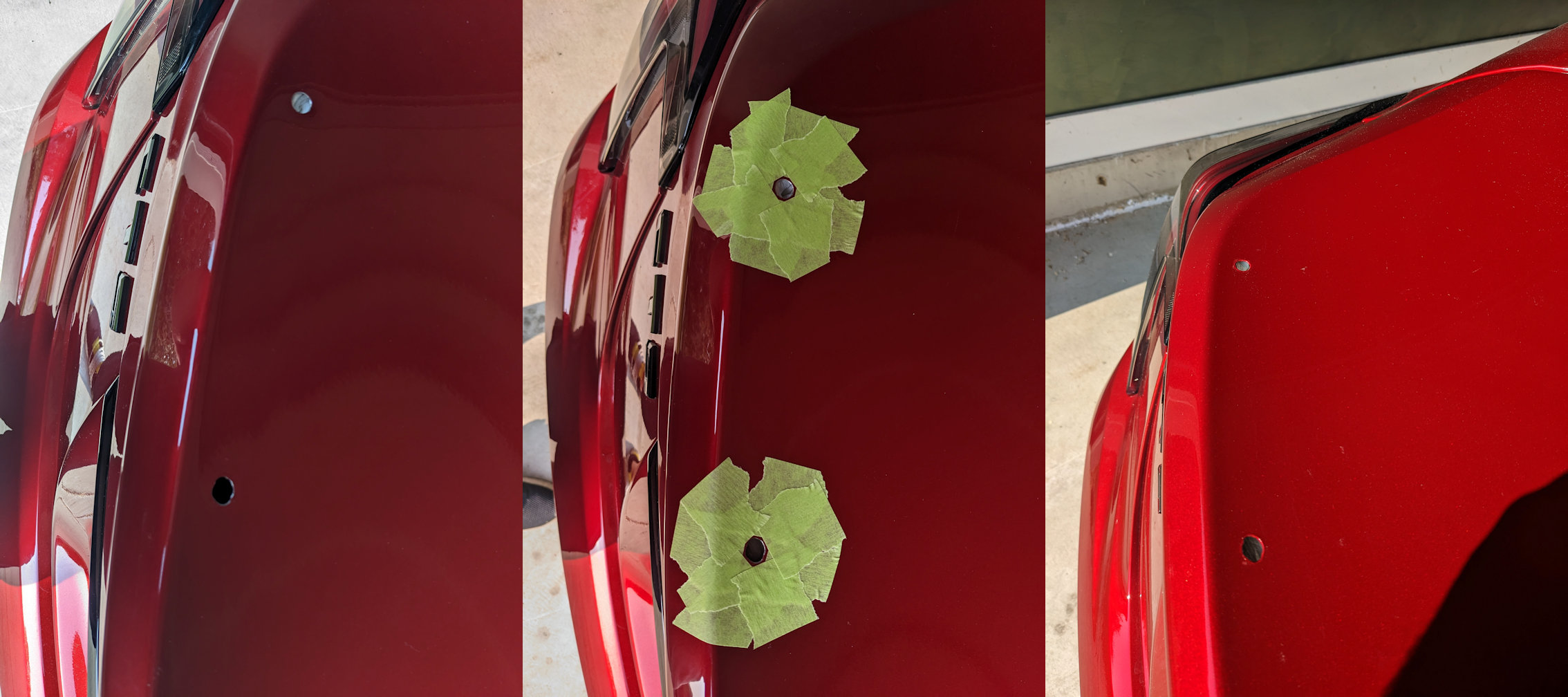

Drilling Holes
You will need to drill 2 new holes and open 2 existing holes up more. For this you will need a decent electric drill, a center punch, and a metric step bit (imperial may be fine as well). Sorry I did not take any photos of what I did to get the drill locations. I was concentrating on making sure everything was correct and forgot to take pictures.
  • First before we do any drilling, we will want to mask around every existing hole. Also, mask off a large area where the outer bolts will be touching the car as well. We do this so the bolts don’t scratch the existing paint.
  • The second important thing to do is wad some paper towel and stuff it under where you will be drilling. This is done to hopefully catch most of the metal bits. It probably won’t catch them all, but I will address getting the remaining bits out in the Tips & Tricks section.
  • Before drilling the outer holes, I opened the two oblong holes to 10mm using the step bit. It will be hard to keep the bit centered in these holes unfortunately so the holes will most likely not look pretty, but once the new spoiler is one no one will be seeing them.
  • Now using the 4 existing holes set the spoiler on the trunk the spoiler will pretty much sit exactly where it needs to be, and the outer 2 bolts will be sitting on the masking tape showing you exactly where they need to go.
  • You could mark this area with a pencil if you want, but what I did was rough mark them, and then put 3 more small squares of masking tape in that area. Then I put the spoiler back on and pressed down on the outside area.
  • When the spoiler was removed, I had 2 perfect little circles indented into the tape. I used these as my guides for the center punch.
  • I put the center punch in the exact middle of the circle in the masking take and gave them a whack (not too hard) with the hammer. I peeled up the masking tape to make sure a proper punch was made.
  • I removed the masking tape around both areas I will be drilling and re-taped around that area just for some extra protection in case the drill slipped or something. This left about a 12mm square opening in the tape around the indent from the center punch.
  • NO RETAINERS: Time to drill! Using a step bit, I drilled a 10mm hole in both sides of the trunk. Do not drill fast, take your time and go down one step at a time on the bit.
    USING RETAINERS: If you are using the retainer clips you must drill 15mm holes on the outside. Do not drill fast, take your time and go down one step at a time on the bit.
  • Once done drill I used a deburring tool to smooth out both the new outer holes and the oblong holes I drilled out.
  • Finally, I put on 2 coats of Rust Bullet (waiting 4 hours between coats).
  • 4 hours after the 2nd coat I put 2 coats of matching touch up paint. This is obviously completely optional since the holes will be covered anyways. If you don’t add any paint I might suggest doing 3 coats of Rust Bullet.
  • Once everything is complete, seat the spoiler into the 6 holes and make sure everything seems good (do NOT remove the film from the 3M trim tape on the spoiler yet). Please note, the spoiler may not lay perfectly flat around the top bends of the trunk, but you should see it be flush everywhere else.
  • Remove any remaining masking tape.

  • USING RETAINERS: Before lowering spoiler down. Push the 2 retainer clips into the outside 15mm holes until they click in.

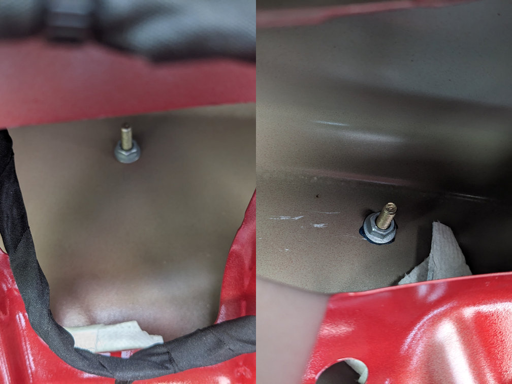

Issues with Outside Bolts when not using Retainer Clips
So before giving up trying to torque down the outside bolts I tried a few different things.
First I tried using THIS 8 inch extender. It could reach the bolt just fine, but the problem is because the bolt threads are so long I had to use a pretty deep socket to even consider torquing the nut down. There was just not enough room to get the longer socket over the bolt.
So, I realized I was going to need a pass-through extender. The only ones I could find are THESE, but they aren’t a pass-through extender that could accept a pass-through socket. They are a set of extenders that work on different sized hex nuts. The problem with these is they were about 2 inches too short to reach and they fell off too easily when I attempted to combine these with the other 8-inch extender. Stupid me was just testing it out to see if it would work before I packed any paper towel into the trunk and the extender will into the top of the trunk. It took a lot of backing the car up and slamming on brakes, along with shaking trunk, using endoscope camera and a wire cloths hanger made into a hook to get it out. It was a nightmare.
So, my final thought was buying THIS set of pass-through sockets from Home Depot. Honestly, I thought for sure this would be the solution. It was not. There was just not enough room to really get it to ratchet much at all. We were semi-successful on the first attempt, but honestly it wasn’t long enough to get any significant torque on it at all.
My guess is if I kept working at it I would have eventually found something that would work and maybe others on here have and they can share their solutions, but at this point I was happy with how the spoiler was sitting and was kind of exhausted so I called it good.
In my opinion the retainer clips they use for OEM are the way to go.
If someone has a definitive solution for bolting the outside down, I hope they post it for future buyers.
  • Time to drill! Using a step bit, I drilled a 10mm hole in both sides of the trunk. Do not drill fast, take your time and go down one step at a time on the bit.
  • Once everything is completely dry seat the spoiler into the 6 holes and make sure everything seems good. Please note, the spoiler may not perfectly light flat around the top bends of the trunk, but you should see it be flush everywhere else.

  • And now we are here...the absolute worst part of this installation. How the hell are you going to get those nuts on those outer bolts. I will just tell you what I did. My wife was able to fit her hand into that area and watching on the endoscope she first put some Loctite on the thread and then reached back in and was able to thread the nut on to the bolt. She threaded it all the way down as tight as she could.
  • Now is the time you expect me to tell you how to torque these nuts down. The short answer is, I didn’t, not really. I would have preferred to, but no method or tool we tried worked to allow us torque these screws down with any significance. After trying many things, we gave up. Basically, what we did was I squeezed the spoiler down to the trunk as much as I could as she manually tightened it down a little but more and then she slathered it with some Loctite and called it a day. I will talk about some of the reasons this is such a pain in another section.

  • Re-attach the trunk liner. It’s straight forward, just make sure you tuck under the hinge plastic covering first.
  • Re-attach plastic piece around latch and the hand grip (make sure you put screw back in).
  • And you are done! Site back and admire your new spoiler.
In my opinion the retainer clips they use for OEM would be the way to go assuming they work on the bolts provided with the spoiler. I would highly suggest @Terrance Sig investigate a solution like this and at least include it as an option.
If someone has a definitive solution, I hope they post it for future buyers.

I wonder If you had considered using those GM plastic inserts for the outside holes? I have not gotten a chance to try them out yet.
Can you confirm that the threads you use are the same as the OEM (I forgot to measure the OEM threads before I did the install). In that case the plastic clips would work. They are around $3 a piece and I’m surprised nobody has tried them yet. The part number was posted quite some time ago.
@Likuid that was THOROUGH my friend. Great job and the car looks good.
Yes, I was going to. I had them on order for over a month and no movement. So I decided to move forward without them.
I picked up the plastic inserts today but no car and no spoiler yet, sorry I won't be able to provide any timely feedback. Rotolo Chevrolet had 12 on hand, so check your Chevy dealers for the part, Local Caddy dealer was able to find out Chevy dealers that had them on hand. It was the 84448584 p/n.
Yes, I did the same today. Went to my local Chevy dealer and he located them for me. They will be here in 4 days! And to make things even better, my spoiler showed up today! Thank you Terrance! Beautiful work, can’t wait to install it. I was a little concerned looking at the box, and all the damage it had but, the packaging worked! Not a scratch on it!
