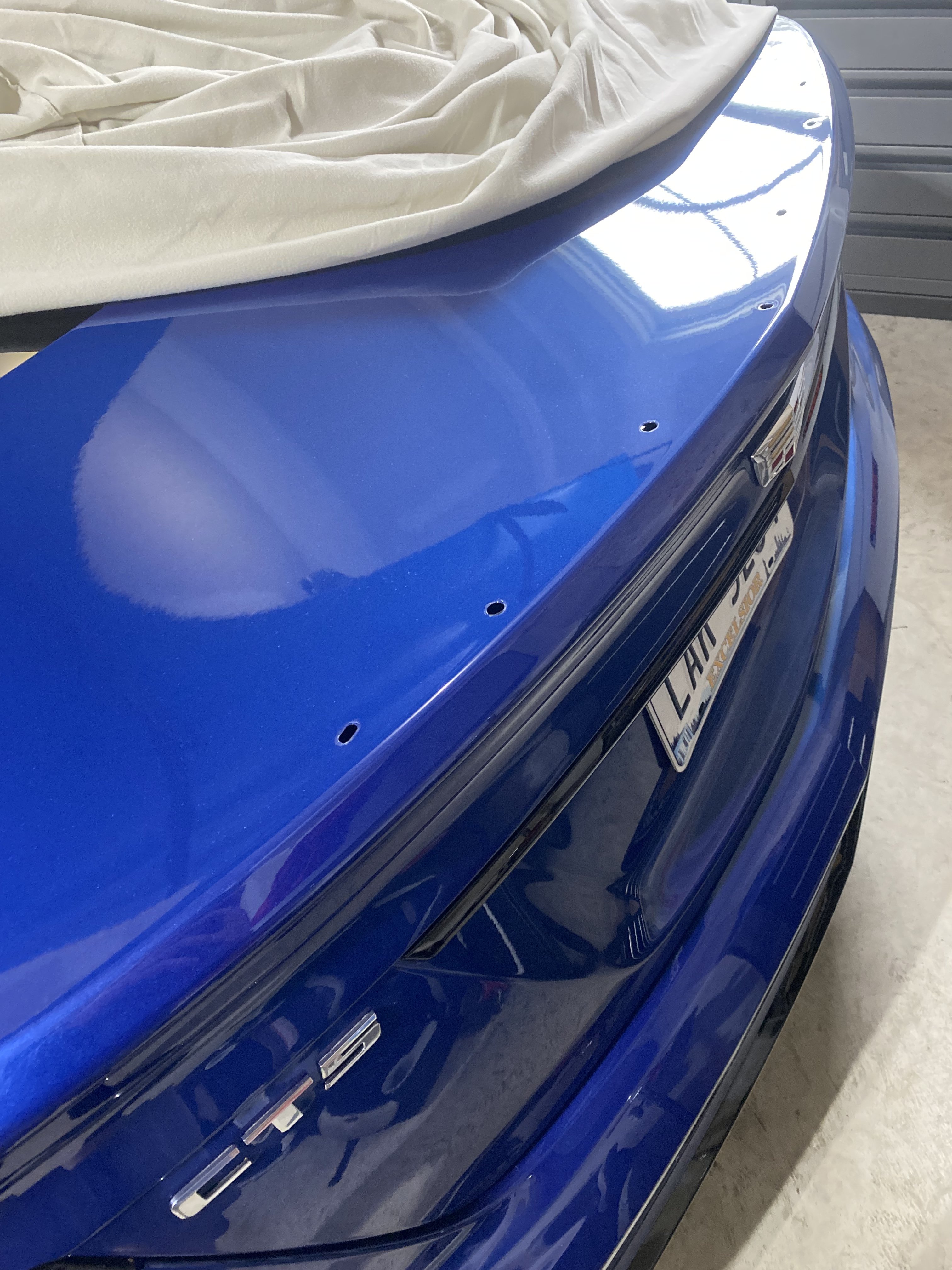

Hey guys, I’m gearing up to put some holes in my deck lid, but wanted some final thoughts before doing so. First, what’s the best approach in knowing exactly where to put the holes? Also, I saw someone mention retainer clips being a possible solution for the tight access. Is that a good approach or should I just make the regular bolt on happen?
Lastly, and not necessarily anything to do with this process, but did GM add extra holes to my trunk 🤔? I thought I’ve seen photos of two holes on each side of the center hole, I’m rocking three on each side.
There are 5 holes and 2 slots on a non-CF1 5BW. Post #263 has a PDF of the OEM install procedure. The two outer holes are the ones that need to be drilled.
If I was doing mine again, I’d 100% go with the OEM retainer clips for the outer holes. You have to drill a larger hole, but you will save yourself the practical impossibility of access to the outer bolts.
Lastly, and not necessarily anything to do with this process, but did GM add extra holes to my trunk 🤔? I thought I’ve seen photos of two holes on each side of the center hole, I’m rocking three on each side.View attachment 19231
This is really easy. The spoiler locates into the existing holes on the trunk. The outer two studs will land exactly where you need to drill. No template needed.

This is a very easy install since you already have 4 of 6 holes in the trunk. You cant mess it up.
