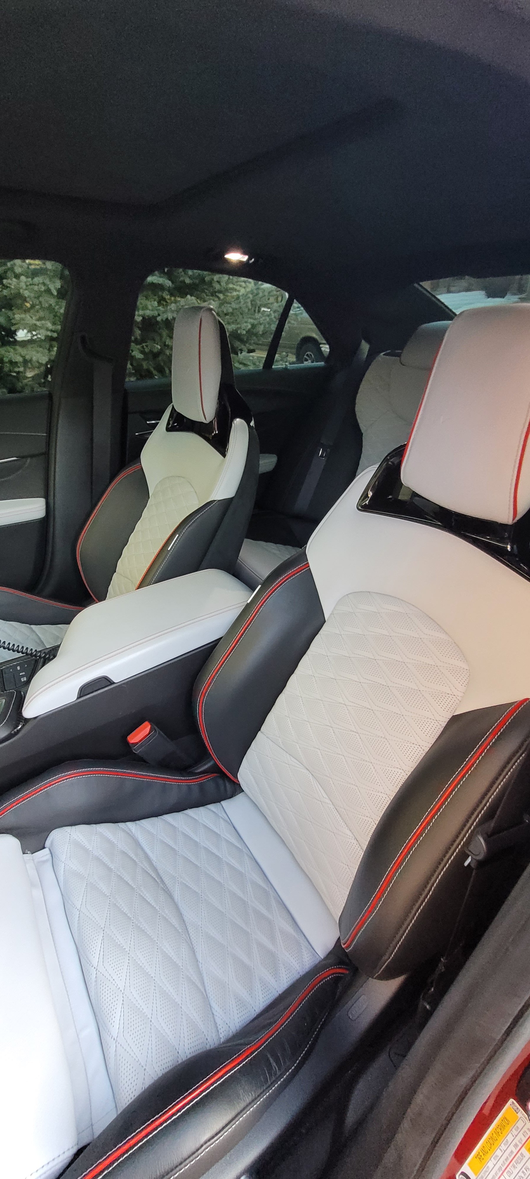

Thank you I'm not feeling super intelligent at the moment but glad to hear I'm not the only one haha! But man, do those seats make everything okay or what?!?
