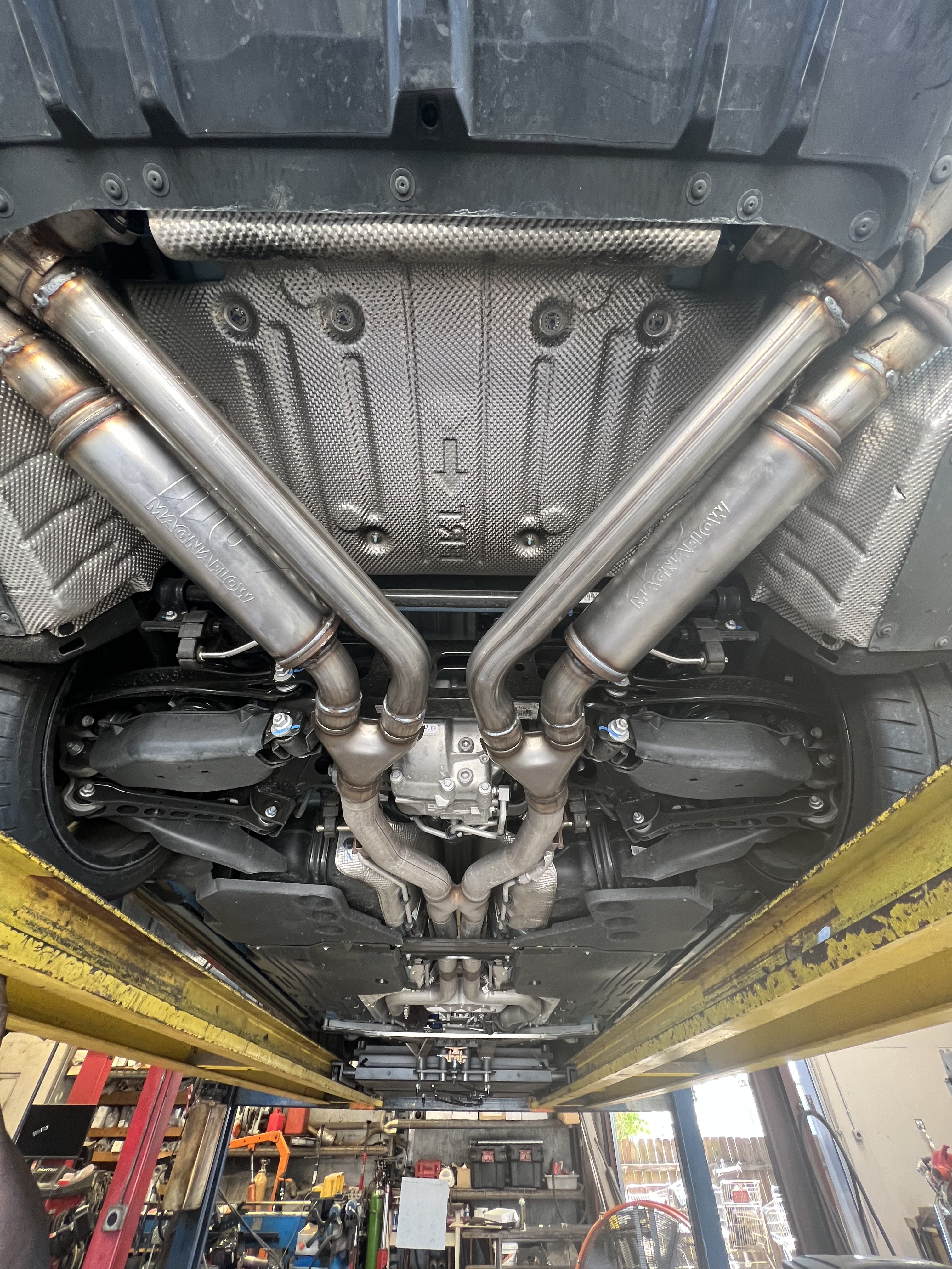

Boys. This. Is. It. Oh my god the exhaust note with valves open is pure bliss. Deeper, more punchy, pops and crackles are more like pops and burbles. Switch the valves closed and it’s damn near stock. It’s too quiet lol. Ill post a vid later when my wife can film me giving it some gas but for now here’s a pic of the setup. Valves open and you’ve got essentially a straight pipe. Valves closed and exhaust is shifted to the two magnaflows. No CEL, stock tips.

I like yours better than mine. Your true straight pipes seem more effective than the "bypass" built into my mufflers.
I'm surprised those tiny Magnaflows do much, but very happy it works. The shop admitted that when they cut my factory tips (with valves open) they accidentally cut off a tiny piece of the valve itself. Perhaps that's the source of the CEL ? It does not make sense to me why there is even a fault attached to the superfluous valves, but it also does not make sense why it's firing when the valves are working fine.

I think they're as effective as they are because they used 2.5" 409 stainless which is 0.25" smaller than the stock pipes. So instead of larger pipes going into a more congested muffler I have slightly smaller pipes going into a more free flowing muffler. End result is slightly louder than stock but still muffled with valves closed. And it's not a true straight pipe with valves open because there is still slightly more resistance to flow with the smaller diameter. Don't know the exact physics behind it but the shop has been in business for 50 years now and he said he's used this same setup on a few ZL1's with good results so I said take my money lol.
