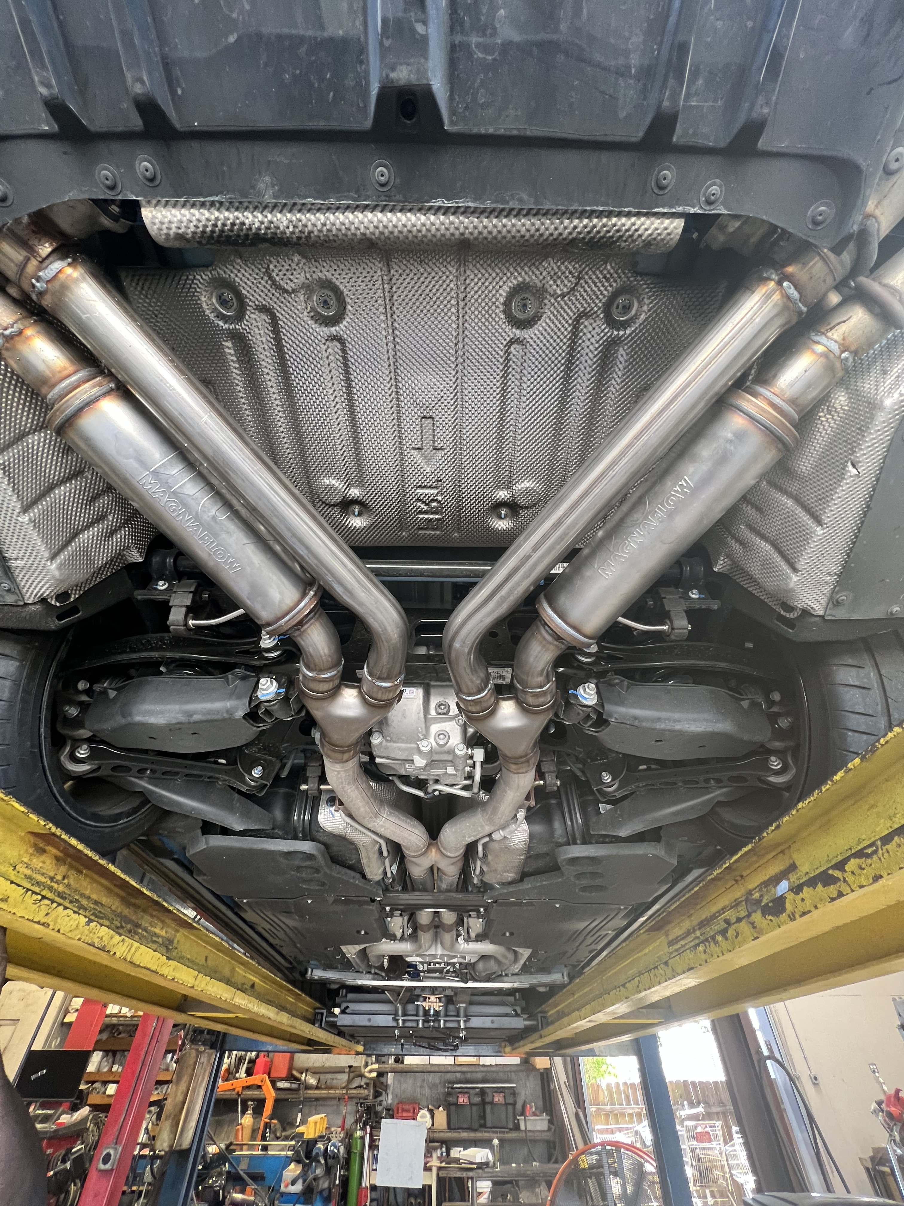

Yes, it would be of great resource to the forum to know the muffler part number.
Thanks again for doing this..would it be possible to ask the shop if they know the part numbers, or even the muffler length? With either of that my mechanic says he can order the bends and the mufflers and give this a shot for me. Thx in advance.

Thank you!At your service. Magnaflow 4” part #10416
We didn’t weigh it but I held both the new and old set and I’d say at least 50% lighter. The old muffler box is HEAVY.Also be interested to know the weight savings, love the sound.
That's what she said!I believe they said 14” long.

man this turned out looking awesome. Aren't the existing pipes 3"?Boys. This. Is. It. Oh my god the exhaust note with valves open is pure bliss. Deeper, more punchy, pops and crackles are more like pops and burbles. Switch the valves closed and it’s damn near stock. It’s too quiet lol. Ill post a vid later when my wife can film me giving it some gas but for now here’s a pic of the setup. Valves open and you’ve got essentially a straight pipe. Valves closed and exhaust is shifted to the two magnaflows. No CEL, stock tips.View attachment 20261
Is your Y pipe 2.5' or 3" in/outAt your service. Magnaflow 4” part #10416. I believe they said 14” long.
No clue to be honest. I just know that he said the new pipes would be a quarter of an inch smaller than the existing but overall would provide better airflow with the removal of the big muffler.Is your Y pipe 2.5' or 3" in/out
