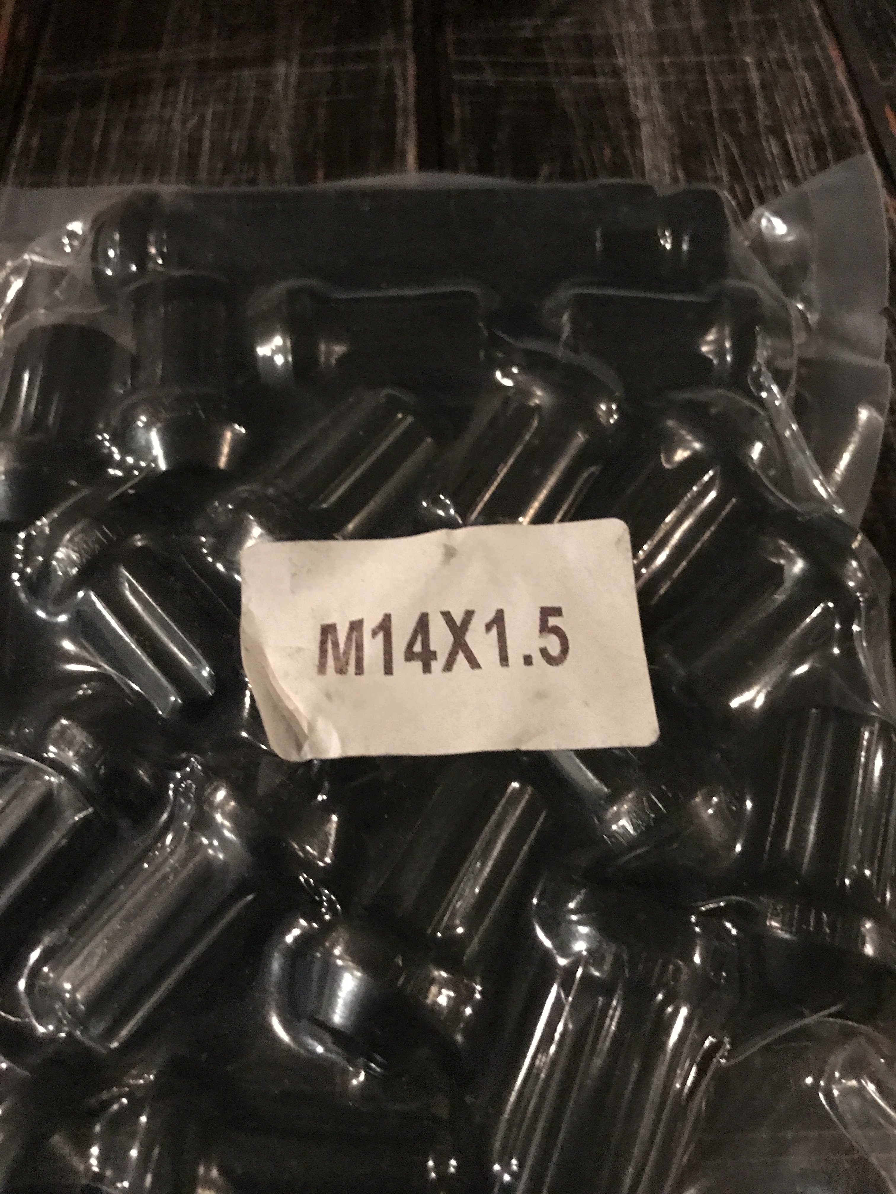

This is what was packaged on my aftermarket lug nuts

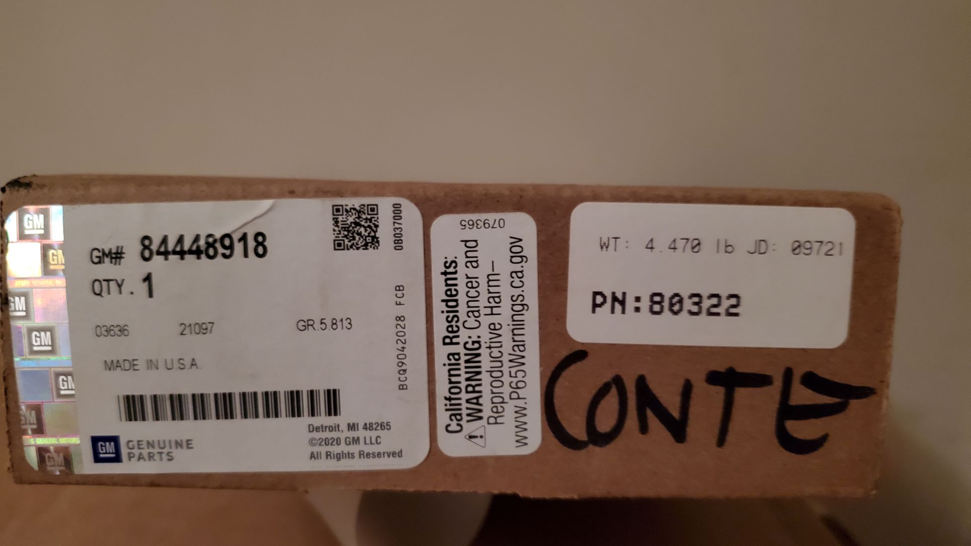

My dealer gave me the box from the black lug nuts that I included in my original build. P/N is 84448918 which all seem to come back as 14 x 1.5 on a google hits. Also, I found this thread on the one of C8 forums which indicates that these will fit the C8 vettes and C6 Camaros as well.
I don’t have my C8 any more to check but I wonder if the C8 studs are the same diameter. I know both use a larger 21mm socket to remove the lug nuts whereas the C7 and prior were 19mm.
I don't have one on hand, but the CT5 seems to need a 22mm socket for the lug nuts? 21mm is too small and 7/8 seems ever so slightly loose - can anyone confirm?

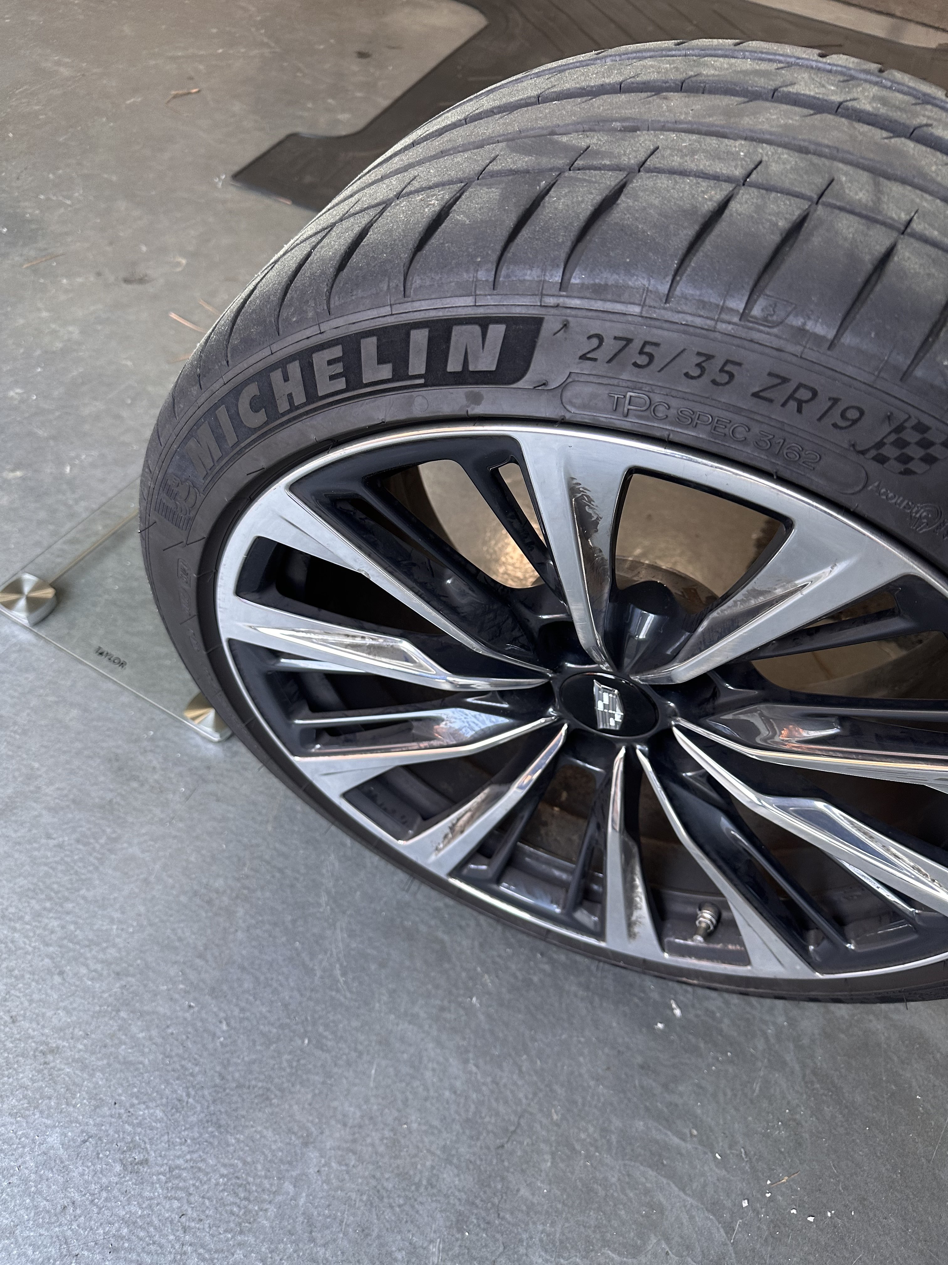

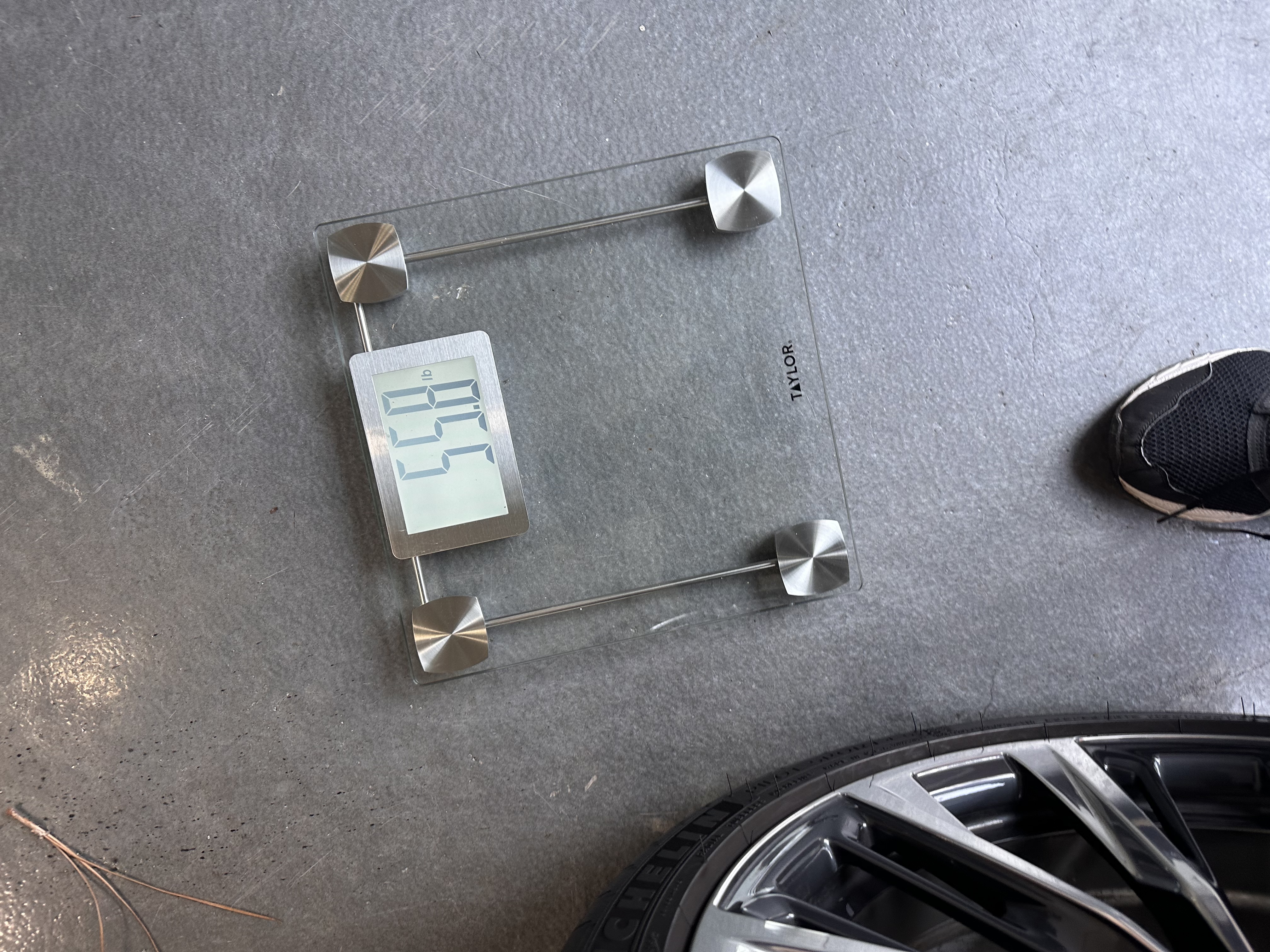

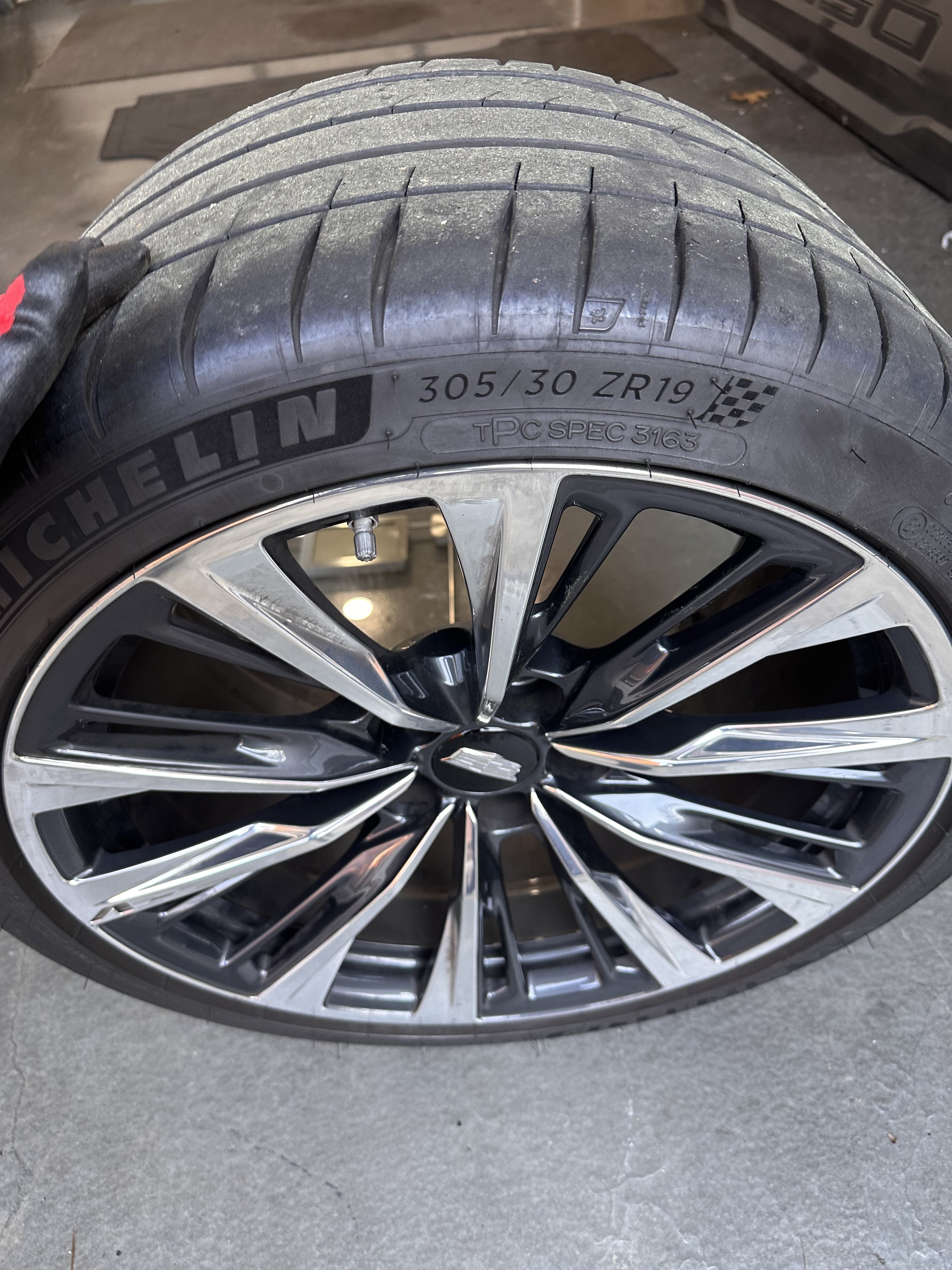

If anybody wanted to know the front wheels and tires weigh 56.6 and the rear 56.2.
That seems... Implausible. No offense, but the rears are significantly larger. How can they be 0.4lbs lighter?
It could be due to the difference in the thickness of the wheels where they mate to the hubs. 🤷‍♂️
How does a 11” wide wheel with a 305 tire weigh less than a 10” wheel with a 275 tire?
Also, which stock wheels are we talking about here?
Generally don’t go back and forth but I had time today.
Rears
Fronts
6/32-7/32s.
Hope this helps.
That is very helpful!
The oe tire sizes off tirerack with 9/32 when new weight 28 lbs for 275 front and 30lbs 305 rear.
Bathroom scales aren't always the most accurate but you get the idea.
I generally keep my car at a warehouse storage. They have doctors office scale, not sure how accurate those are but they weighed within .2 lbs.
I’m assuming the rears are just lighter wheels, less materials. I also assume tire rack has those weights incorrect. I know 5mm sidewall difference makes a difference for sure.
