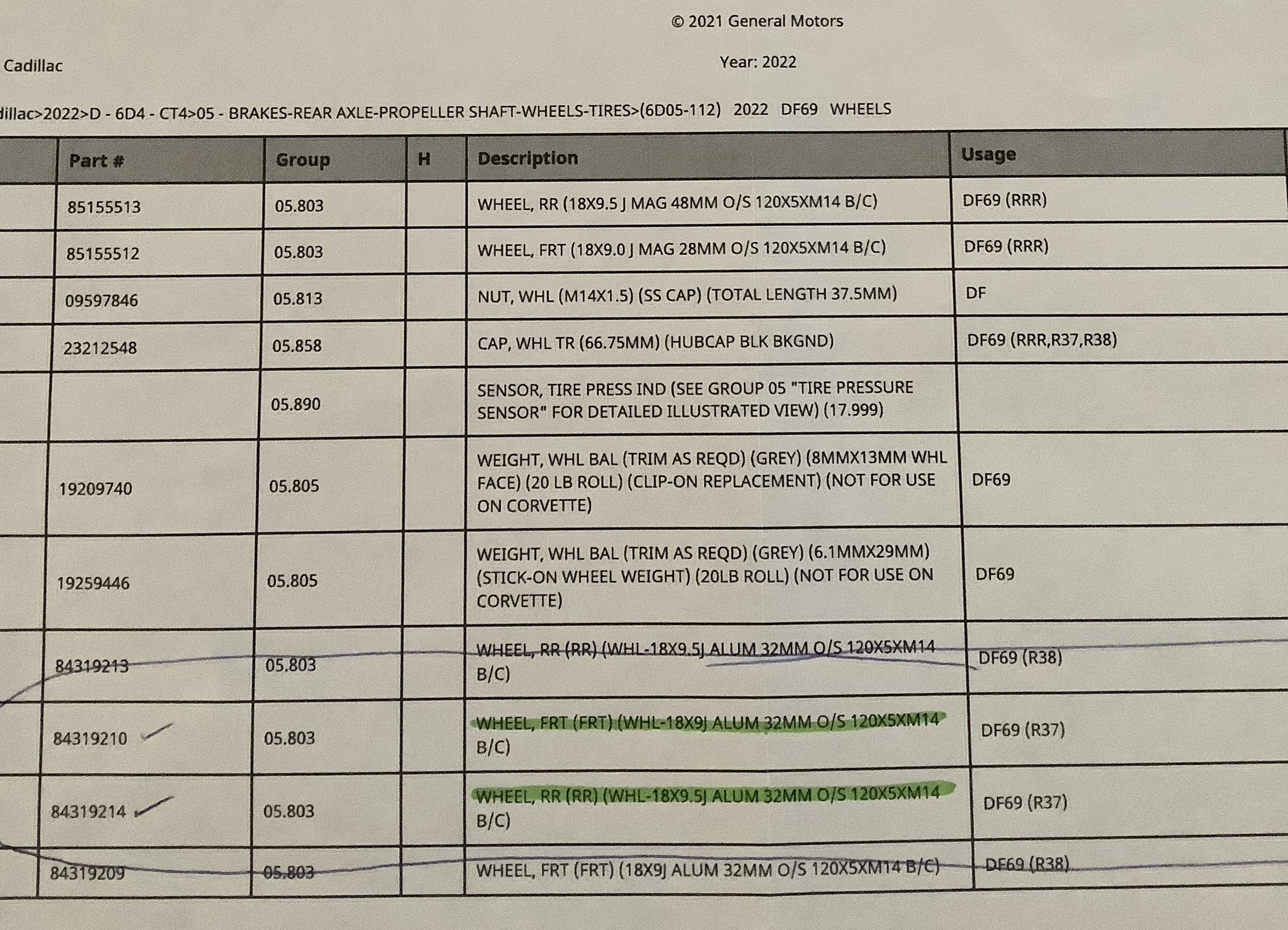

@Mirza Grebovic, regarding 4BW wheel specs, it appears the optional “RRR” tech bronze wheels or maybe the proposed Mg option match the ATS-V 28mm front offset and 48mm rear offset specs based on the attached dealer parts department photo. The R38 standard wheels and the R37 optional satin graphite wheels appear to be 32mm offset front and rear. My car was ordered with the R37 graphite option and has a TPW of 10/18. I live in MI and would like to get aftermarket wheels ordered ASAP. Is there some way of confirming what offset I need?
@Mirza Grebovic, regarding 4BW wheel specs, it appears the optional “RRR” tech bronze wheels or maybe the proposed Mg option match the ATS-V 28mm front offset and 48mm rear offset specs based on the attached dealer parts department photo. The R38 standard wheels and the R37 optional satin graphite wheels appear to be 32mm offset front and rear. My car was ordered with the R37 graphite option and has a TPW of 10/18. I live in MI and would like to get aftermarket wheels ordered ASAP. Is there some way of confirming what offset I need? View attachment 5354
They are all exactly the same specs so must be some print errors somewhere. I will check. The offsets are on the inside of the wheel as well and I posted soecs somewhere here in the forum.
Thanks Mirza, your help is appreciated. If anyone has their 4BW already and have looked at the inside of their wheels (satin graphite preferably) for offset specs please let us know.
The 4 blackwing wheel specs are (no matter if bronze or any other rpo all three rpos same)
Front: 18x9x28-J
Rear: 18x9.5x48-J
Ats-v sedan exact same size and offsets.
Ct5-v blackwing
Front: 19x10x20-J
Rear:19x11x50-J
