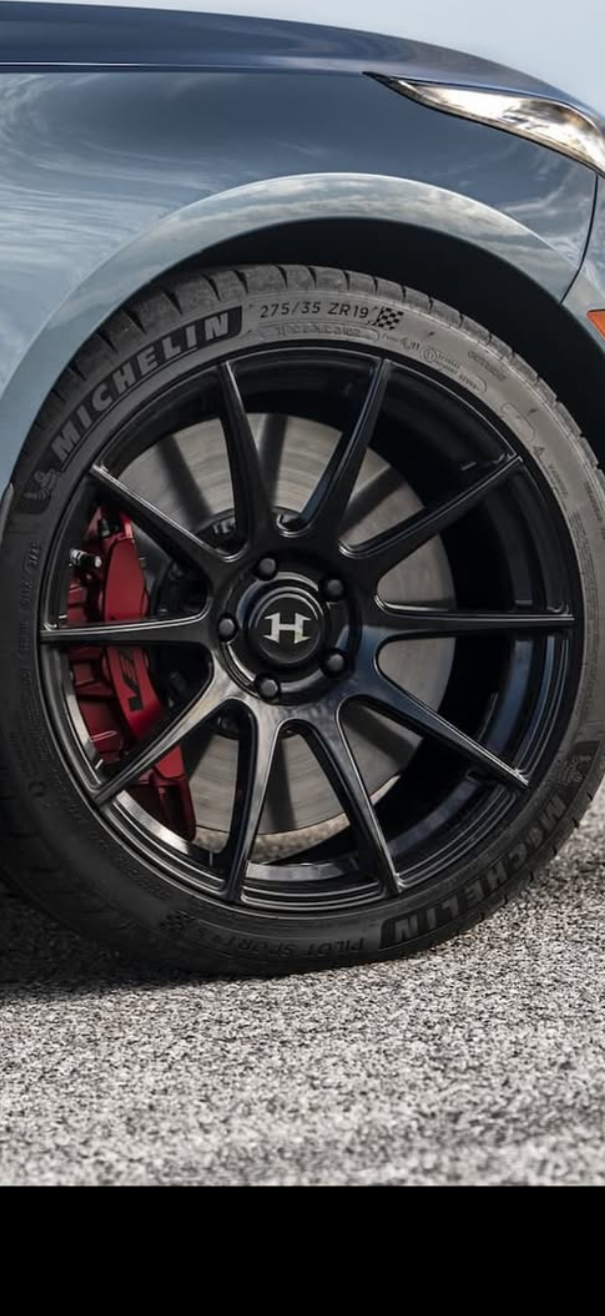

Does anyone know where I can find rims like these? I see Apex offers them but I'm looking for a more aggressive offset. Below are the specs I'm thinking, looking for full forged. Also open to other recommendations based on what you all are running, looking to put them on a radiant red color blackwing.
19x10 ET20
19x11.5 ET48

I've done a pretty exhaustive search in the past and I think you might have to go with custom wheels to get the desired sizes and offsets. I couldn't find much in the way of off-the-shelf wheels other than Apex and maybe Vossen or Velgen I get them confused.
This has been discussed a few times before. Because of the big brakes and large offsets makes it difficult to achieve the deep dish style it sounds like the OP is after.
