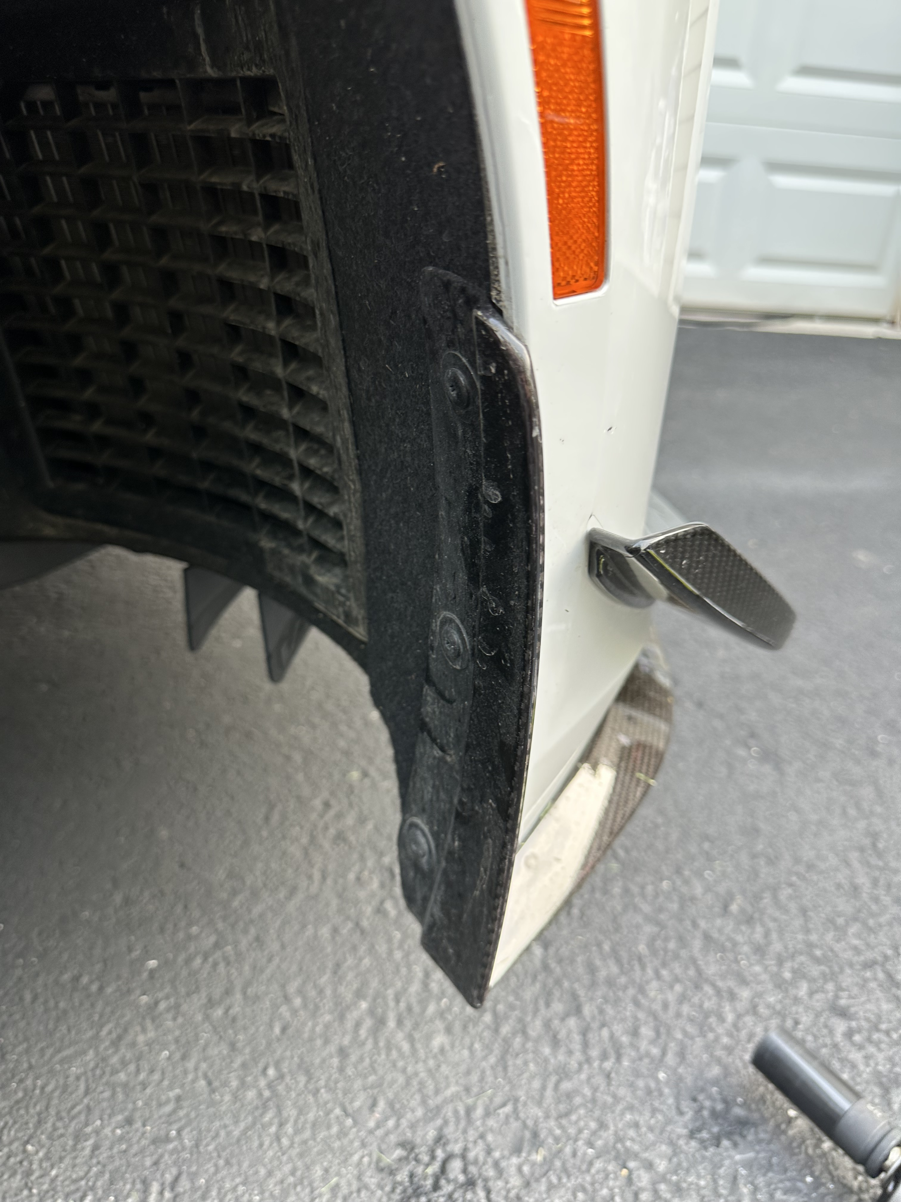

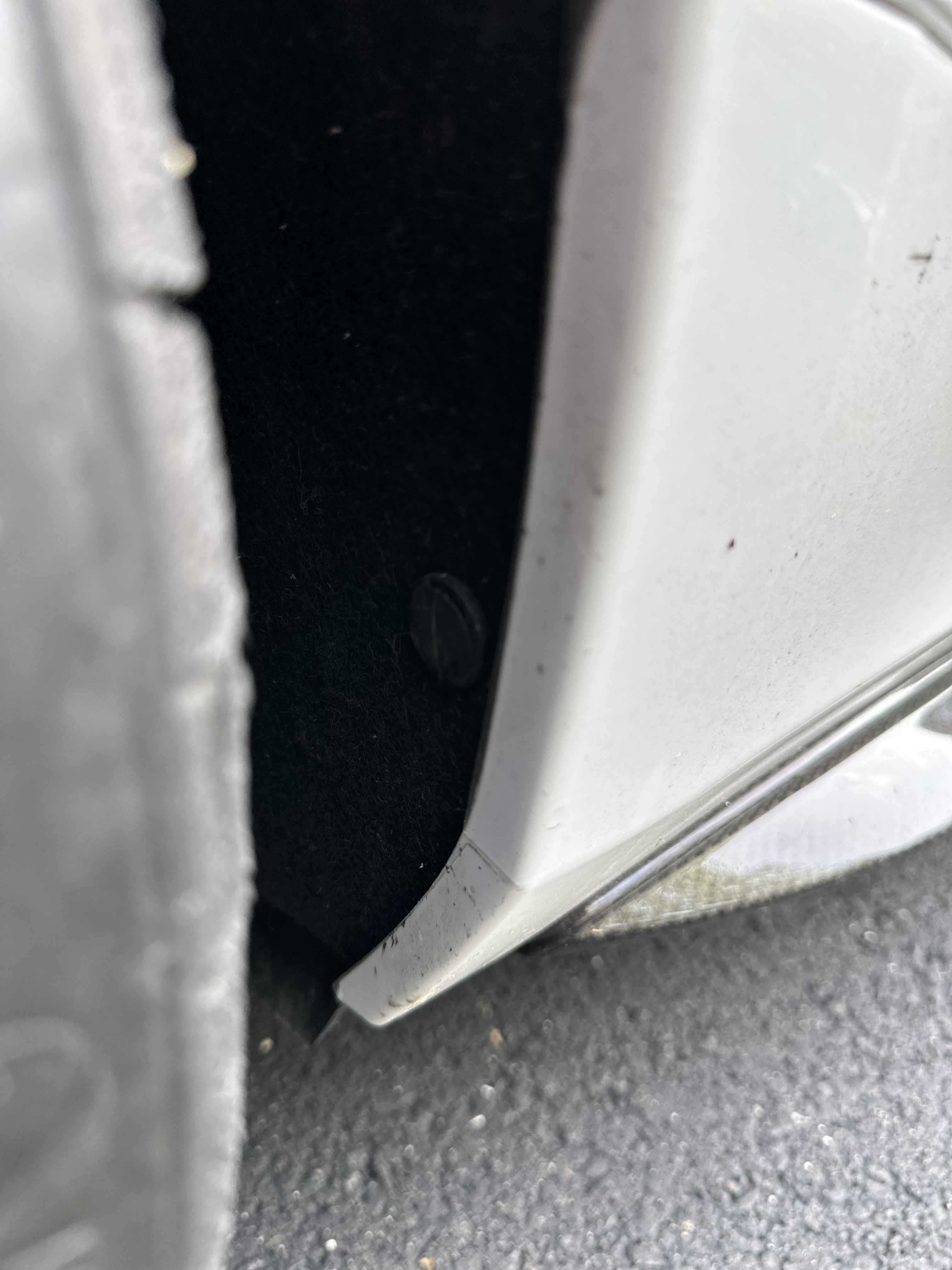

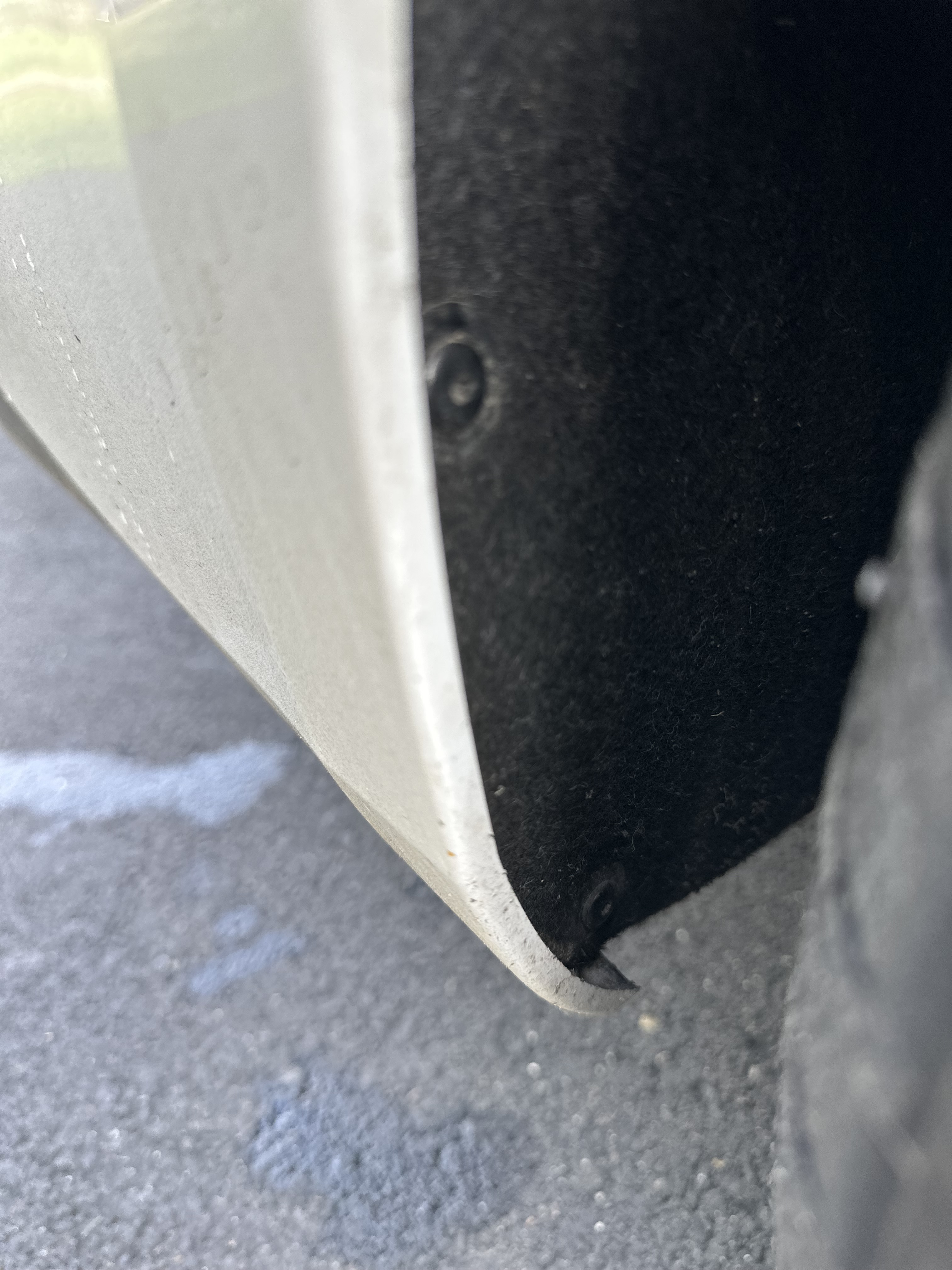

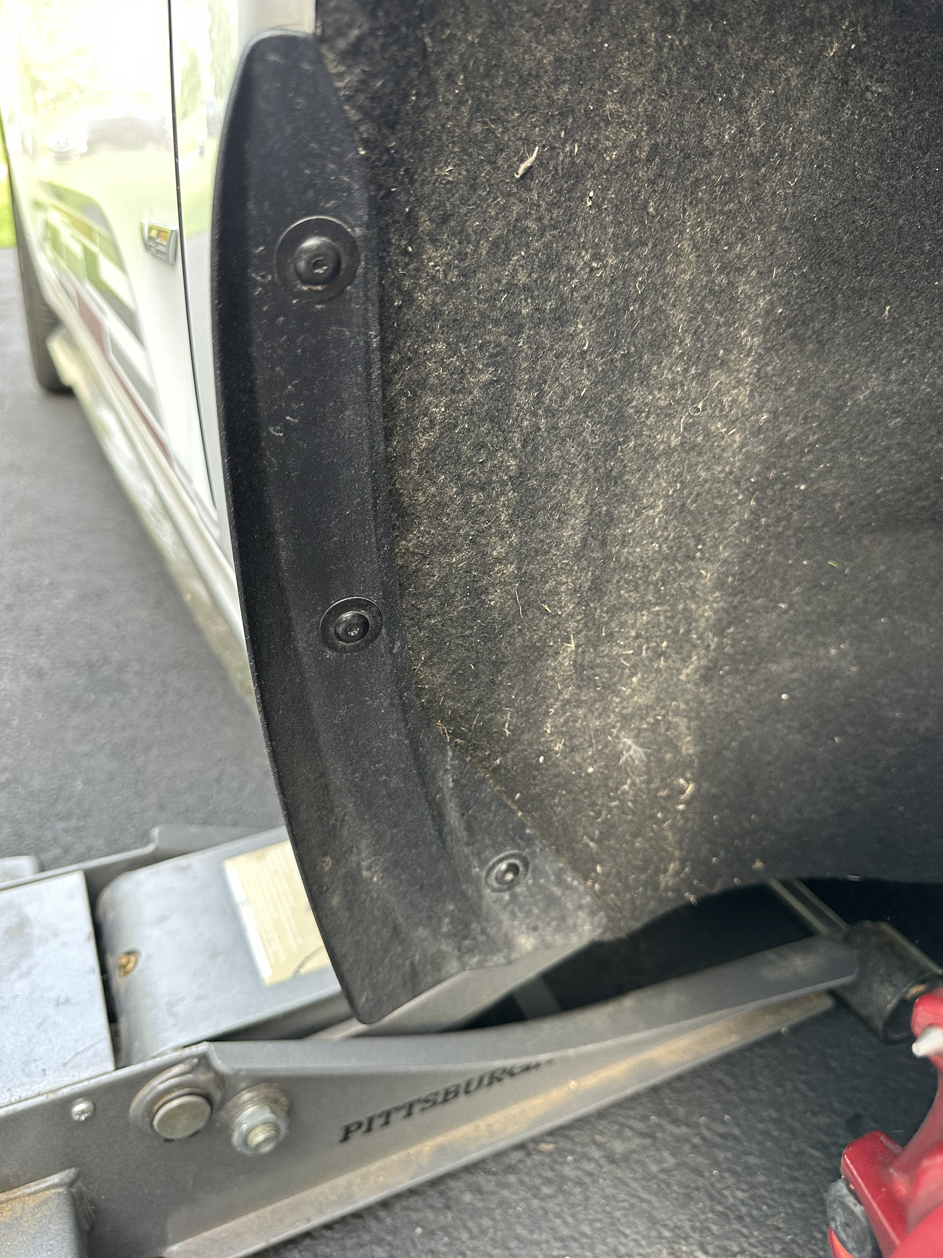

Final point - In the front wheel well there is a small Carbon Fiber piece and an abs piece. Can we get a vendor to build a full arc in Carbon Fiber or ABS? If we can get such a fender extender in Carbon Fiber, is a wider tire we possible then?
What about in the rear wheel well?

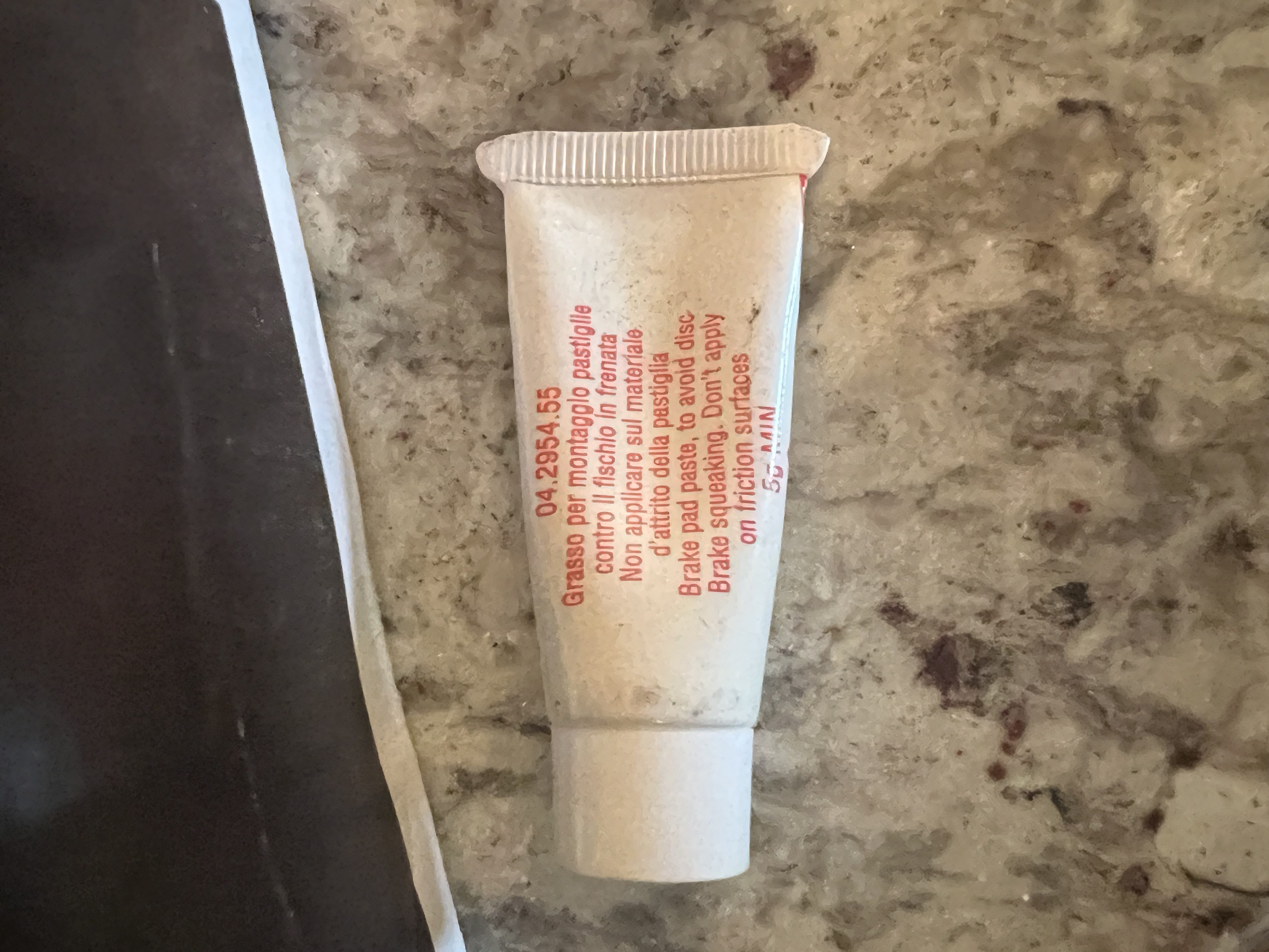

@jodakid69 i was going to bring these with me to VIR to give you, but since I won’t be making it, if you message me your address I’ll ship it to you.
