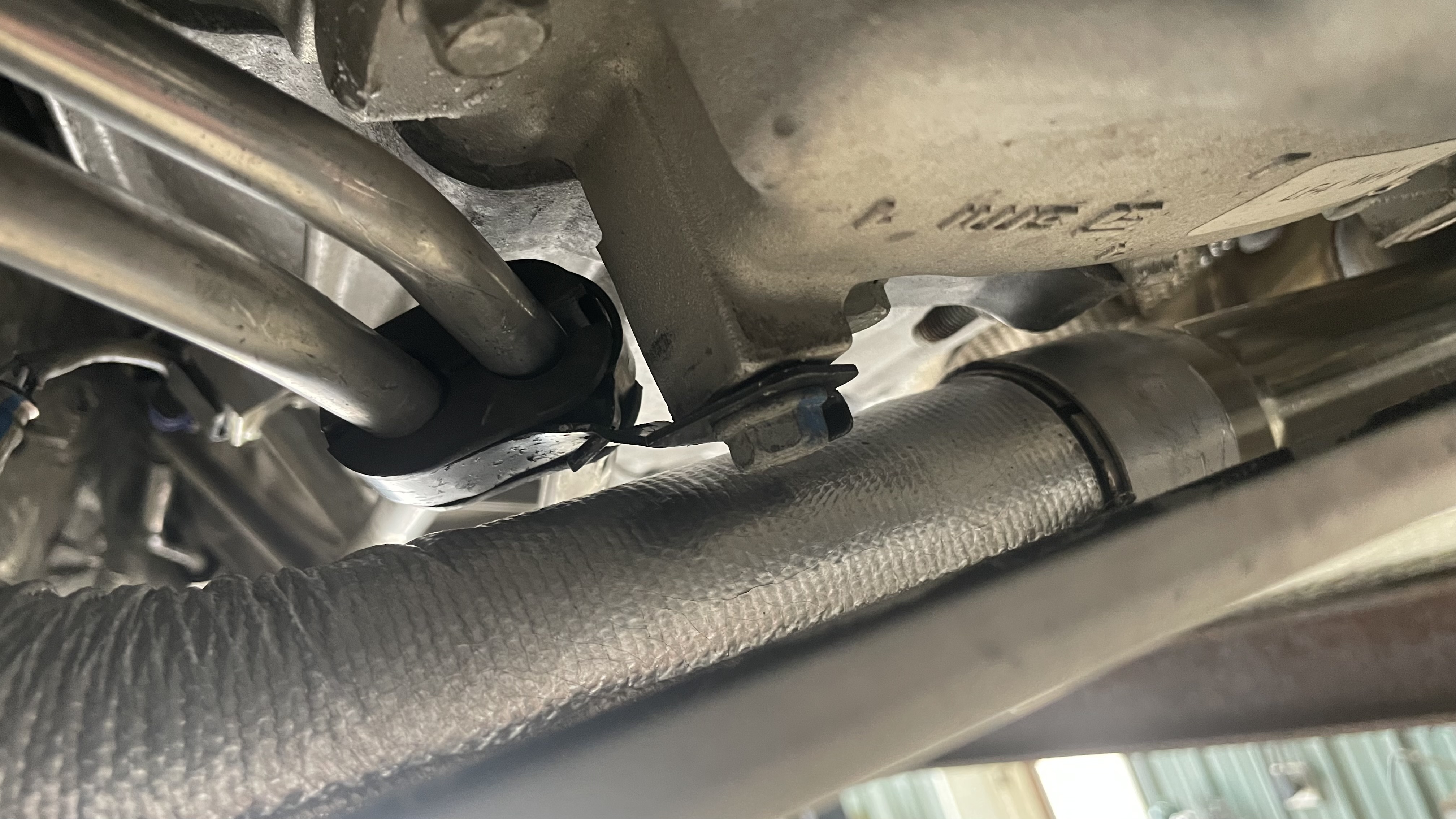

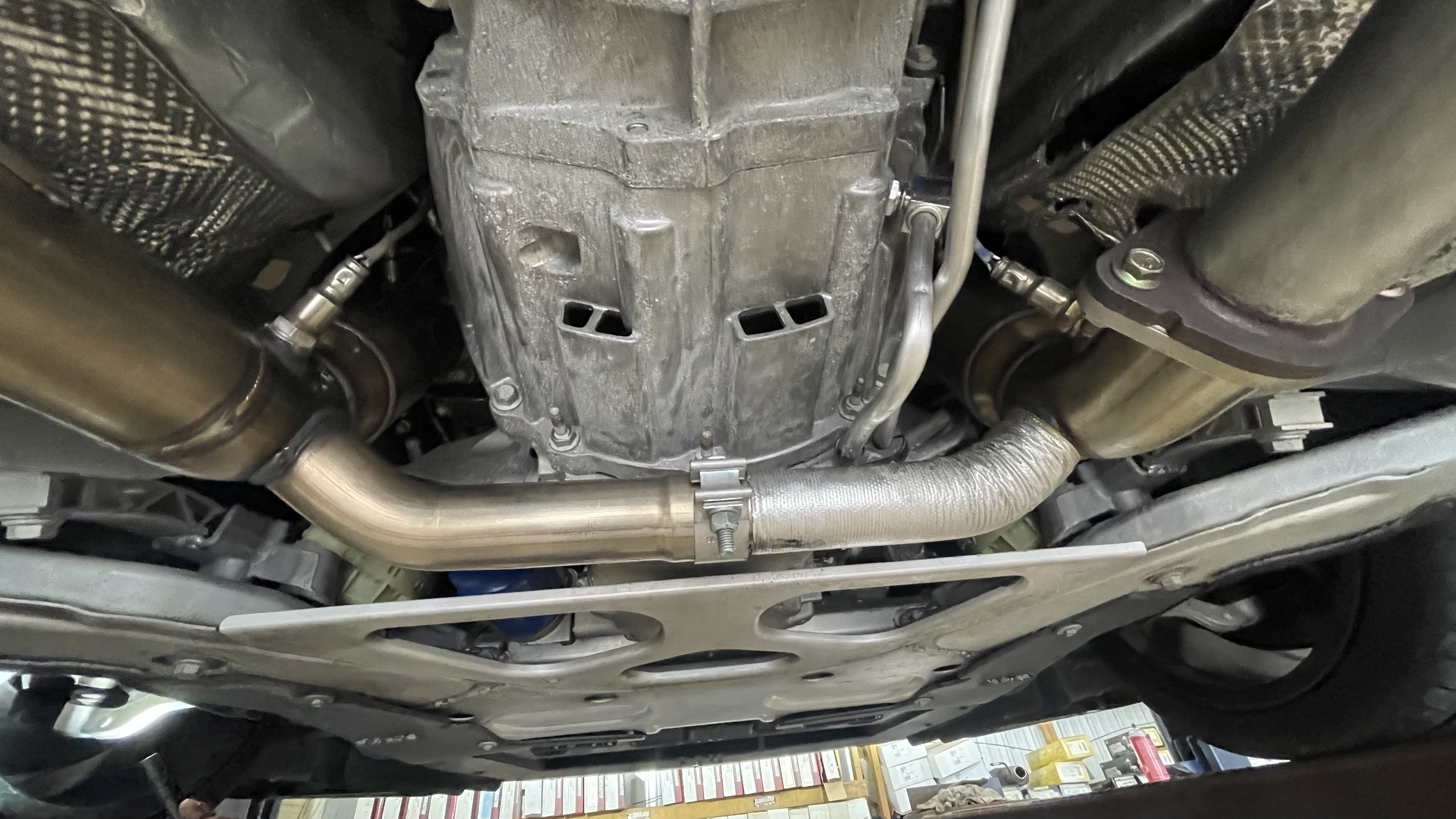

Just wanted to show others that the DP is close but has clearance.
Just curious... why is only one side wrapped? Not saying you did anything wrong, just genuinely intrigued.
We recommend wrapping the crossover pipe where it goes under the transmission lines. There is no need to wrap on the other side in our opinion.
my thoughts were that it offered additional heat protection to the transmission lines that had to be bent slightly to clear. I just followed the directions sir!
