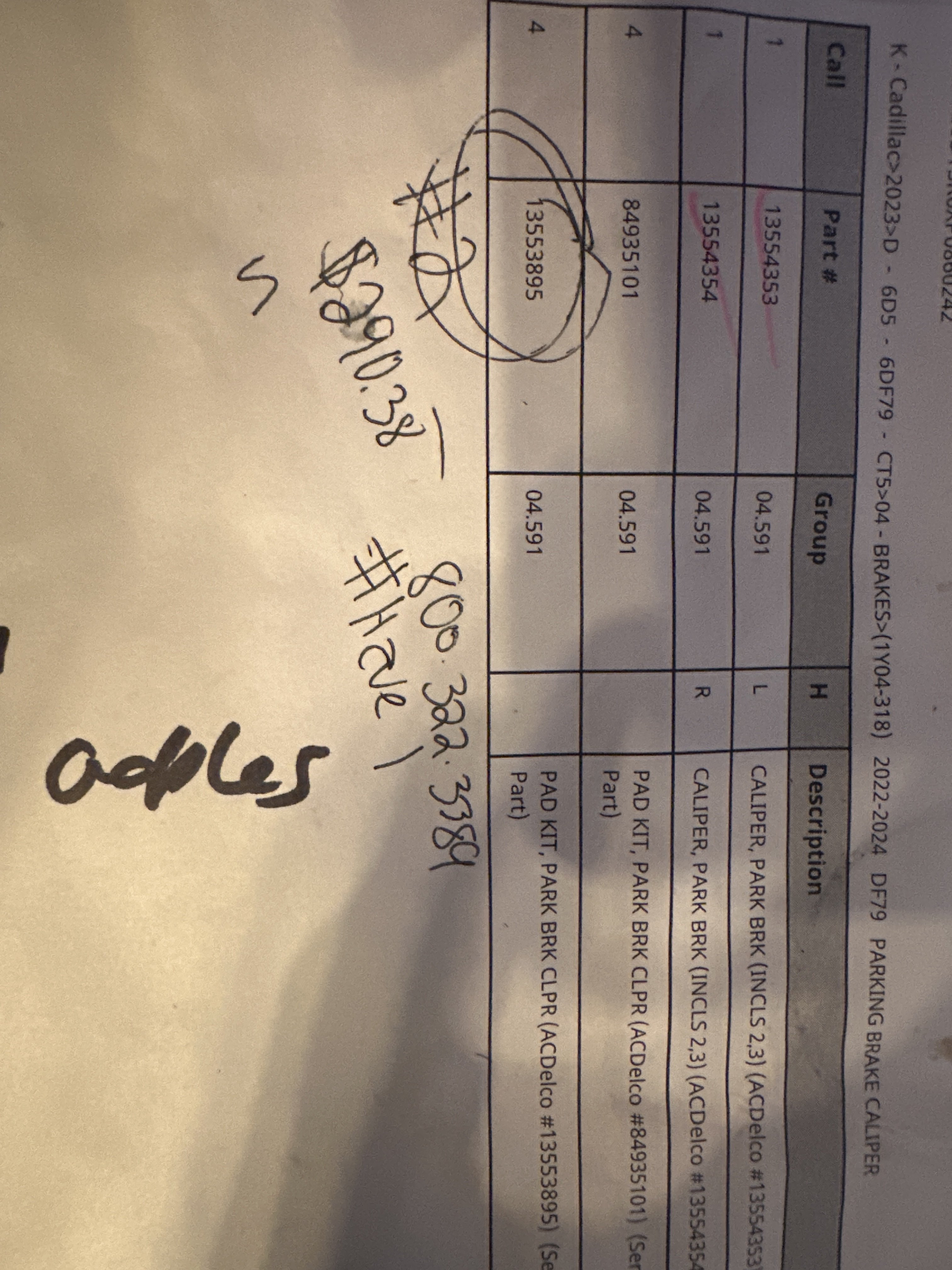

Also managed to get a printout from the dealer with a diagram. It had different parking brake pads than the ones listed above which I thought was odd. I actually think they may be the pads for the CCBs that are thinner.
The other number 84935101 is just for the irons that is thicker. That’s the setup I have now and the CCB rotor won’t clear that pads. Need another 4.5mm to clear them.
