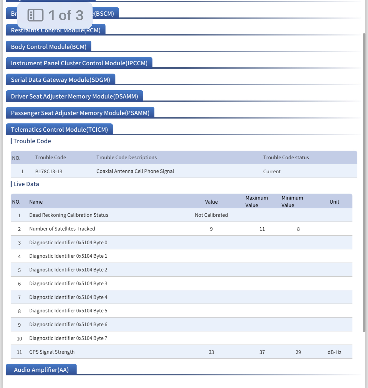

Ran the CT5 today, no CEL or anything unusual. Did a function check, PDR, SiriusXM, CarPlay, WiFi connectivity to my home LAN. All fine.
Ran a scan report; all was well besides the cellular TCM coax error code (which was expected and was the same in my Suburban). All GPS live data points were perfect.
Tomorrow, I’m going to remove the brown coax and rerun the tests. I know folks had some concerns with functionality, feel free to add some checks and I’ll run them tomorrow.
