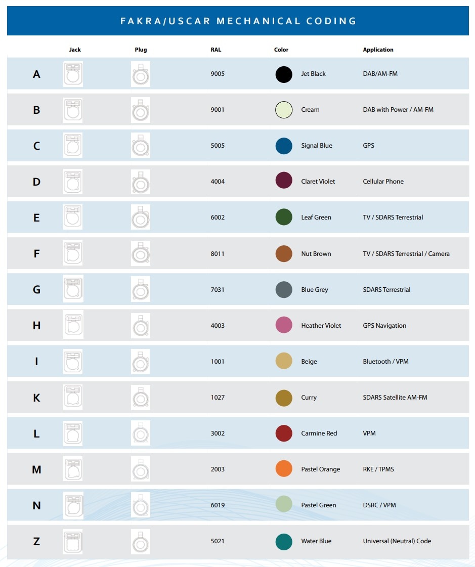

Not sure if this will work for gen 3 and gen 4 cars or just one or the other. Per the Reddit thread, results are mixed. Some people say it works, some say they still have signal. Will report back with results and/or amended parts list for the CTS-V3/ATS-V. I can't do the CT4-V/CT5-V so someone else will have to contribute.
As shown above, the Fakra connectors are fundamentally interchangeable, but have different key configurations, preventing you from improperly plugging connectors together. The type Z connector, however, has no keys and can plug into any other connector type.

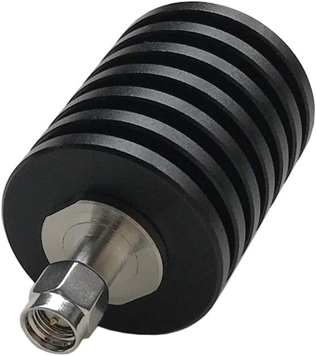

When I was looking into neutering onstar in my 2nd gen CTS-V I considered using a 50Ω terminator but I was worried that the little ones couldn't handle the power so I got a 10W "dummy load" like this:
In the end I figured out the cellular modem (and GPS) was on a daughter card and I could just remove a jumper to disable it, keeping bluetooth. I did the same thing to my Z06.

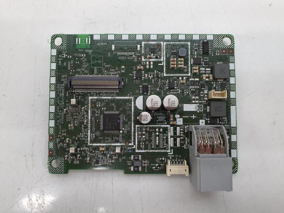

The chevy bolt conversion to physical sim look interesting. I think moving the jumpers (0Ω resistors) makes the swap between internal (esim) and physical sim. My guess is if you just moved the jumpers and did not install a sim socket (or sim) onstar would be disabled.
The GM part number for a 2023 CT5 telematics module appears to be 86519090. That module has FCC id BEJTTAG11NE. Looking at the internal pictures I see what looks like an unpopulated sim socket near the top of the board:
It's too bad the resolution of the picture is so bad, it's difficult to see if this board has the same jumper setup as the bolt version...
