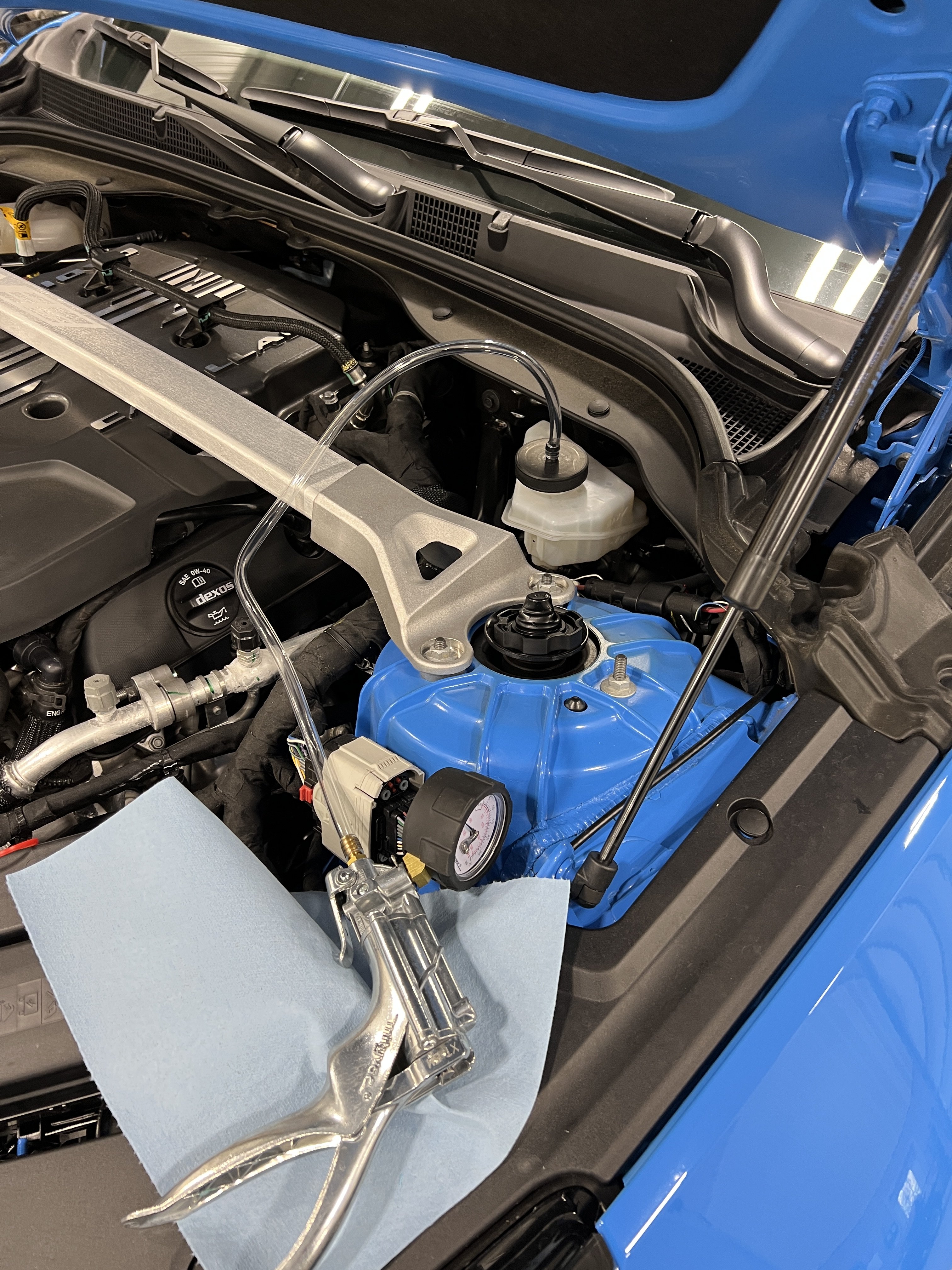

I'm not a huge fan of the Motive method. I have had a few caps fail or not fully seat and wind up with brake fluid all over the engine bay.
I prefer using the MityVac.

Second on not a fan of the Motive. Could not get the cap to seal at all. I think this is more a fault of the design of the GM reservoir. The three tabs just don't provide enough clamping force to create enough of a seal. I just un-plugged the battery and got my dad to help me do it the old fashioned way when I flushed the system.

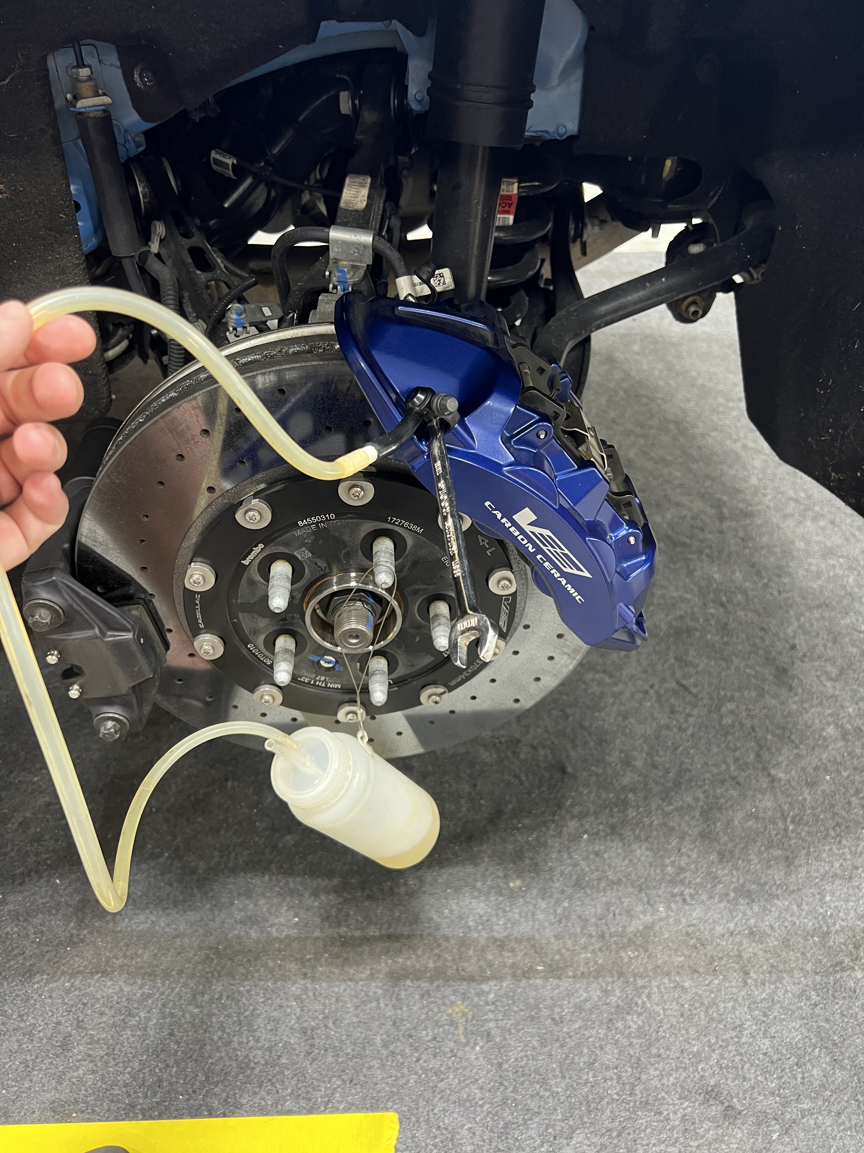

Rear, then the diagonal front, then other rear, then other front. I don’t believe it matters which rear you start with. Also, inner bleeder then outer on the caliper.

Motive sells upgraded anodized metal caps for most applications. You really need to push down firmly before trying to twist. I've done dozens of fluid changes and never have had a single issue, just efficient changes with minimal effort on my part.
I've found that pushing fluid through the system is better at removing air than trying to draw a vacuum. On my KTM's the only way to bleed to clutch is positive pressure. You'll never get the air out using negative pressure or even the old school open/close pumping.

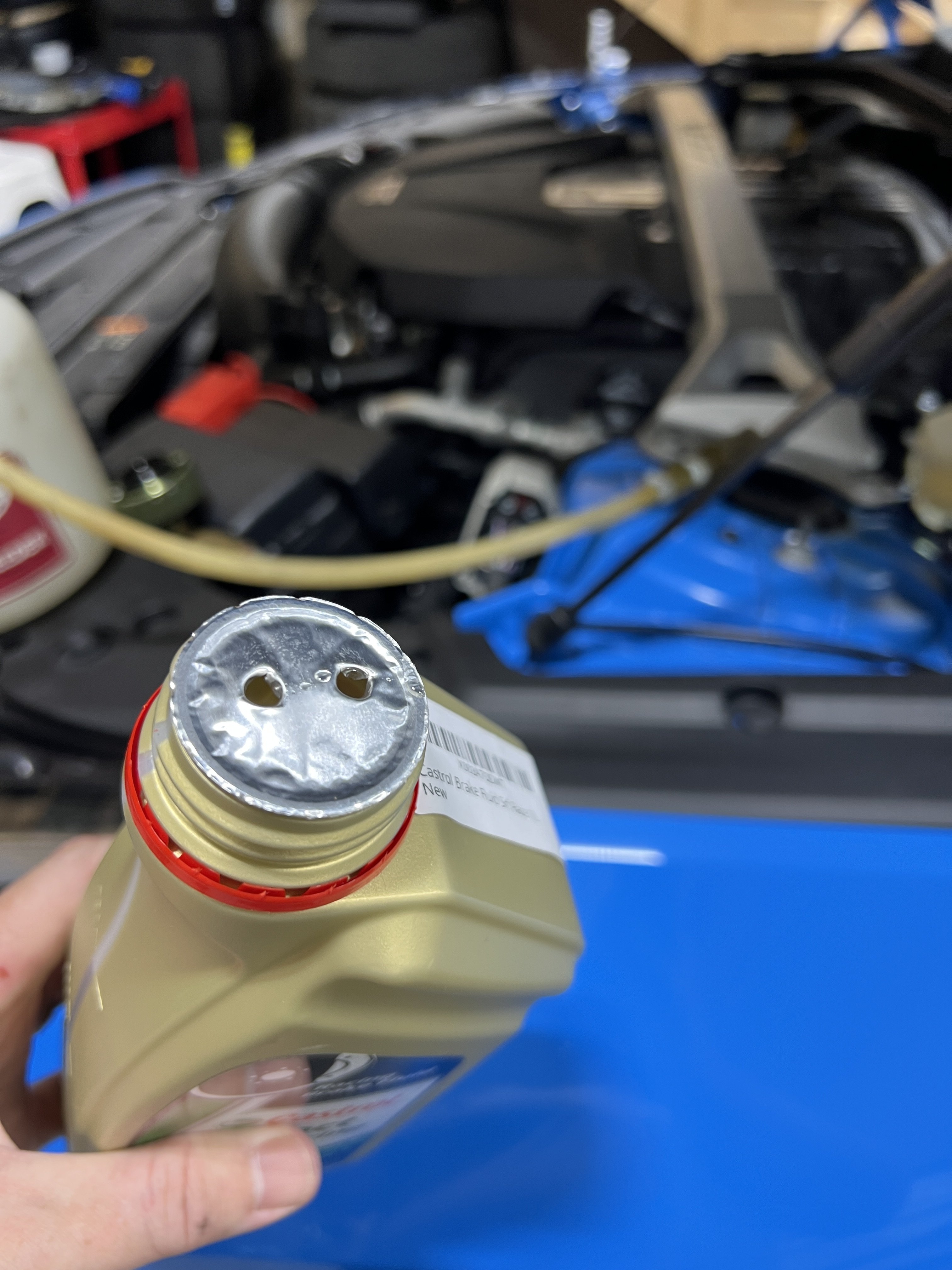

Also, you have to add fluid really slowly to the master cylinder. It’s easier if you just punch two holes in the foil on the cap rather than remove it.

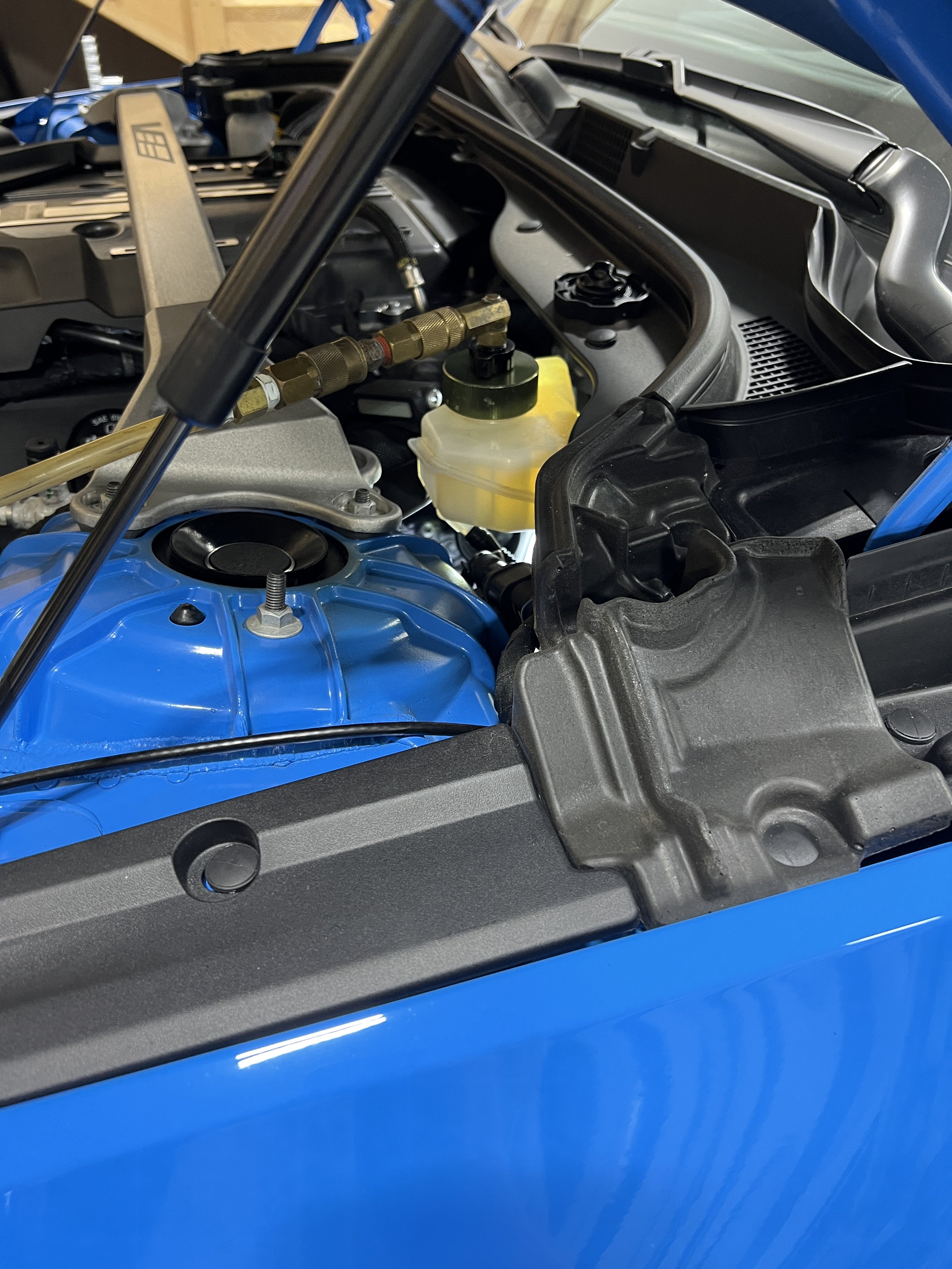

Put a small light behind the master cylinder so it’s easier to see the fluid level. It’s right about 250 ml from the max to the min markers on the reservoir. I like to just crack open a bleeder on the rear and drain to to min, fill it up, drain it to min, and then bleed like normal. That way you’re mostly fresh fluid in the reservoir.
Bleeder screw torque is 13 lb ft, except the front on CCB cars which are 14 lb ft. 11mm socket/wrench for the bleeder.

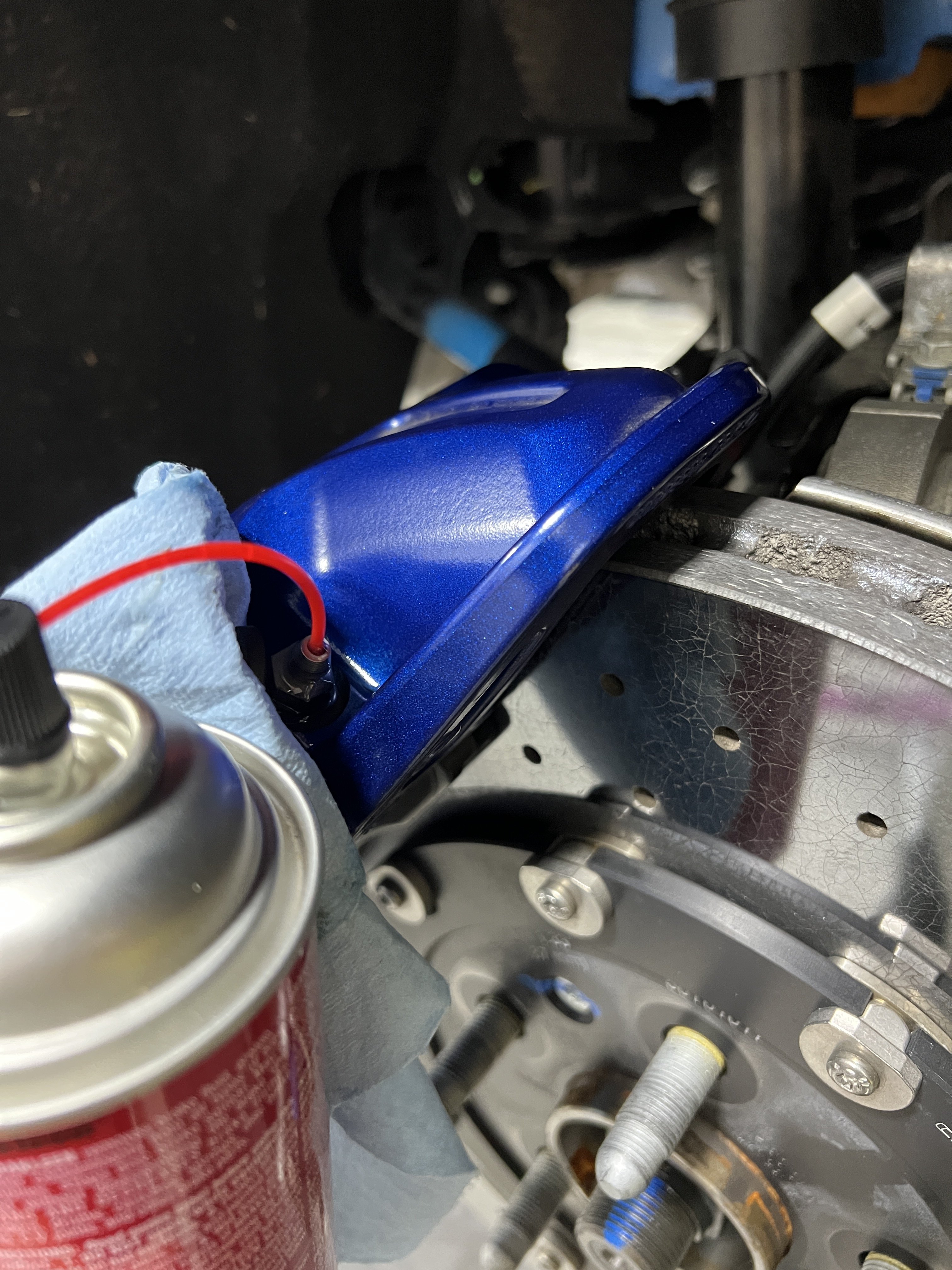

Finally, after you’re done use some brakleen to spray the area around the bleeder and then use the straw and cover with a rag to blow any fluid out of the bleeder. If you don’t and go to the track there’s a good chance it’ll run out of the bleeder and mess up the paint on the calipers.

On all my other cars, I used my bleeder bottle with the magnet on it. imagine my 'doh' moment when I tried to get the bottle to stick to the rotor.
