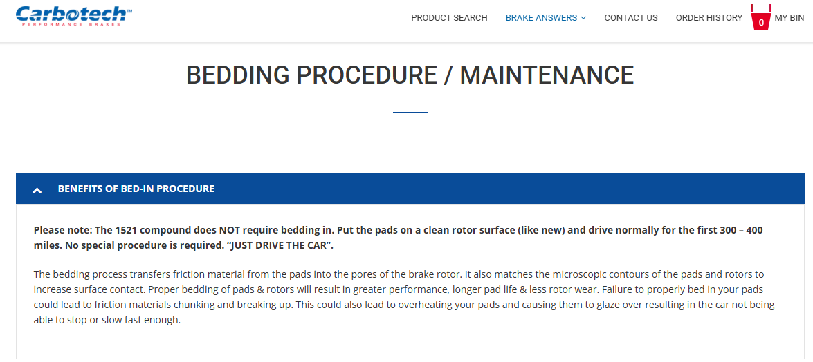

You needed to properly bed the pads and you didn’t, so deposits built up unevenly that causes the vibration when you brake. You don’t baby brakes when you bed them. You get to speed and apply the brakes hard from 70 or so to 20, then let off but do not stop. Do it again and again and increase the speed. About 5 to 7 applications like this will bed the brakes, and when you drive..,use the brakes and don’t dab dab them. As said ceramic rotors do not warp. Smash those brakes.
