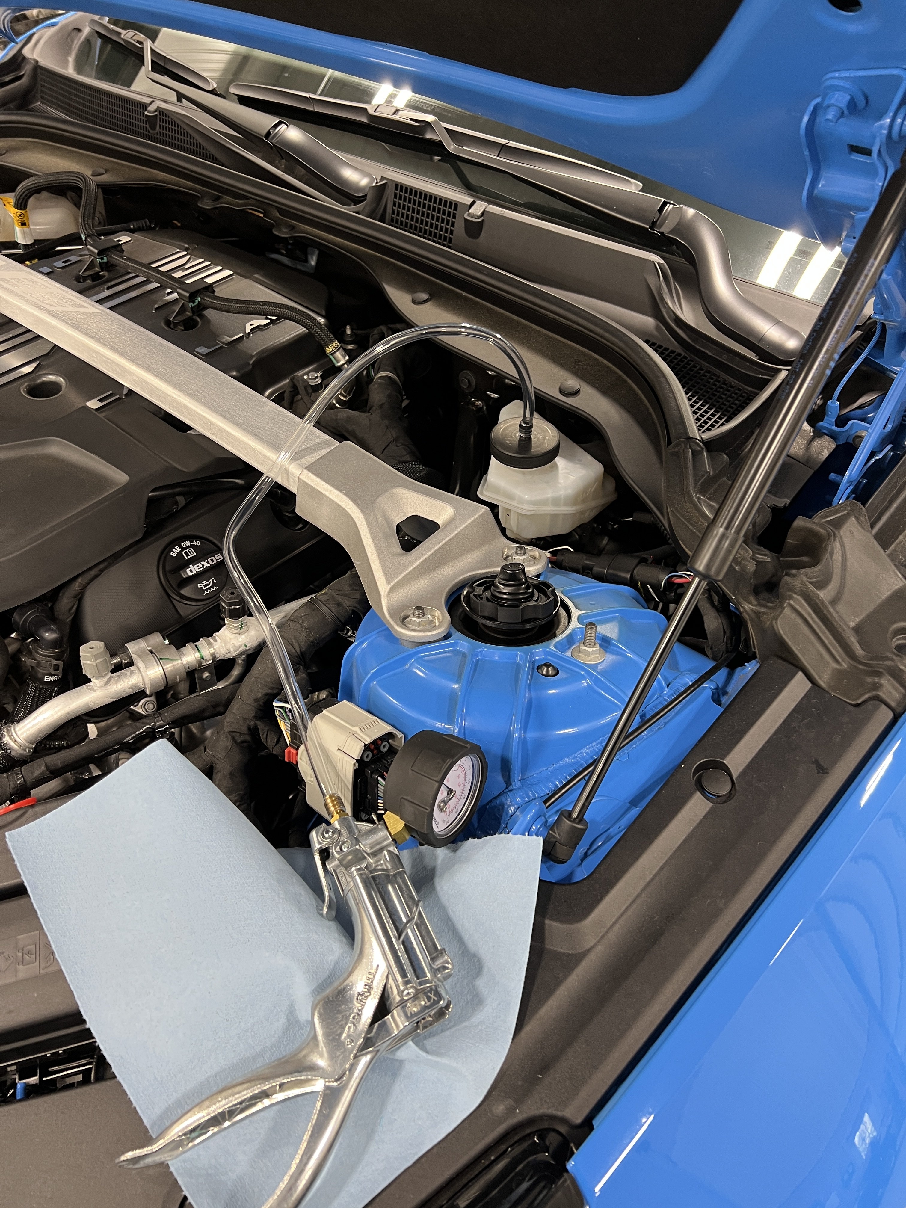

I think a Mityvac will work, but I use a Motive Products power bleeder. The difference between this and the GM recommended tool is the GM tool uses a bladder the keeps the fluid out of contact of the pressure air. I get why this is important (particularly if you're using shop air), but I start with a very clean powder bleeder, new fluid, and I'm careful about working in a clean environment. I clean the bleeder with denatured alcohol when done and make sure its spotless before I start.
Link below for the tool I use, but I don't know if any of the adaptors I have will work (haven't checked) but will report when I do.

Thanks. I used a Motive in the past, but switched after a few incidents where the master was over-pressurized and the fluid wound up all over the floor.
So, with the addition of removing the battery cable, brake service should be like all the others I have done. I’ll give it a shot before my next track event (Daytona on 4/20).
I also did the disconnect the battery and use a motive to flush my brake fluid.

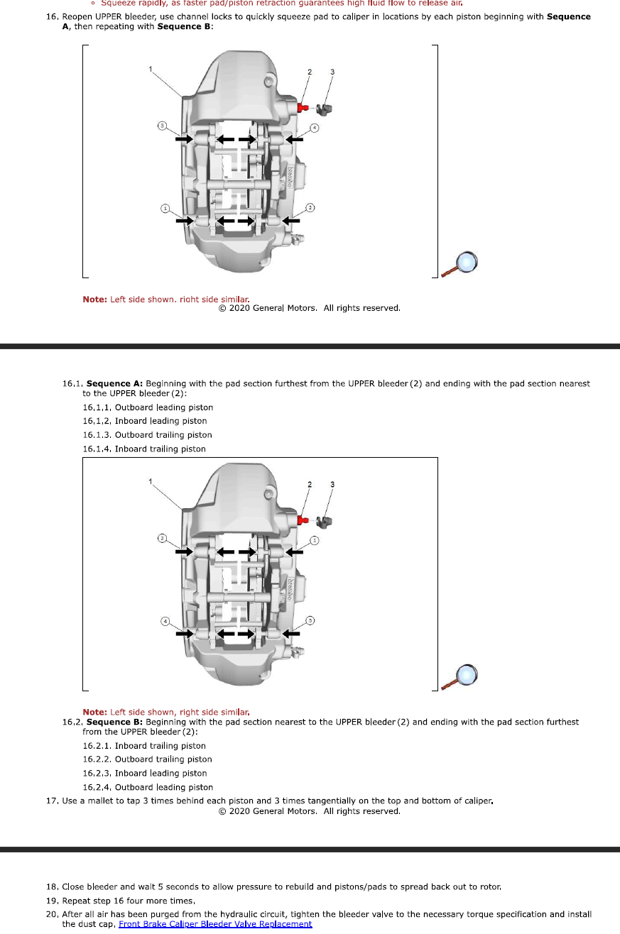

The brake bleed procedure in the C8 service manual is really bonkers too. It has you doing a normal bleed with pressure and then doing it by compressing with a vice grip specific pistons on each caliper in a specific order - then repeating the process four times.
Some of what is mentioned here is absolutely shocking and ridiculous. And I thought zee Germans were the authority on over engineering and needless labor techniques.
This sort of information makes me cringe at doing regular maintenance that I thought I had mastered a 100 times over. What's next, do I have to pat my head 3 times while rubbing my stomach in a bidirectional motion before or after I change the pads?

BTW, this is a subset of the C8 bleed procedure I was referring to:

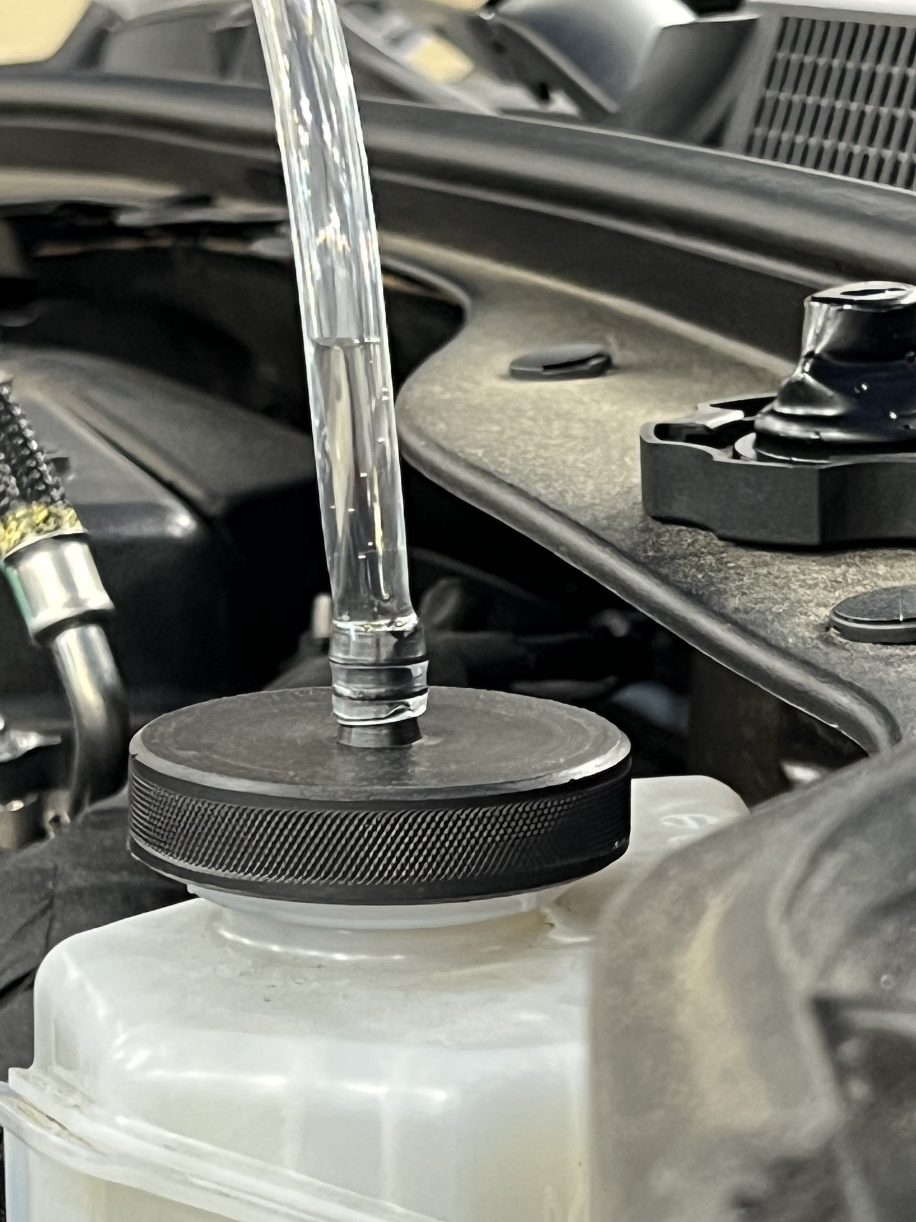

You could try it and see. Ideally you should be using a pressure bleeder like a Motive.
Yea I had one in the past, but lost it at some point. I will likely buy another one anyway. Is the cap 0108/0118?
