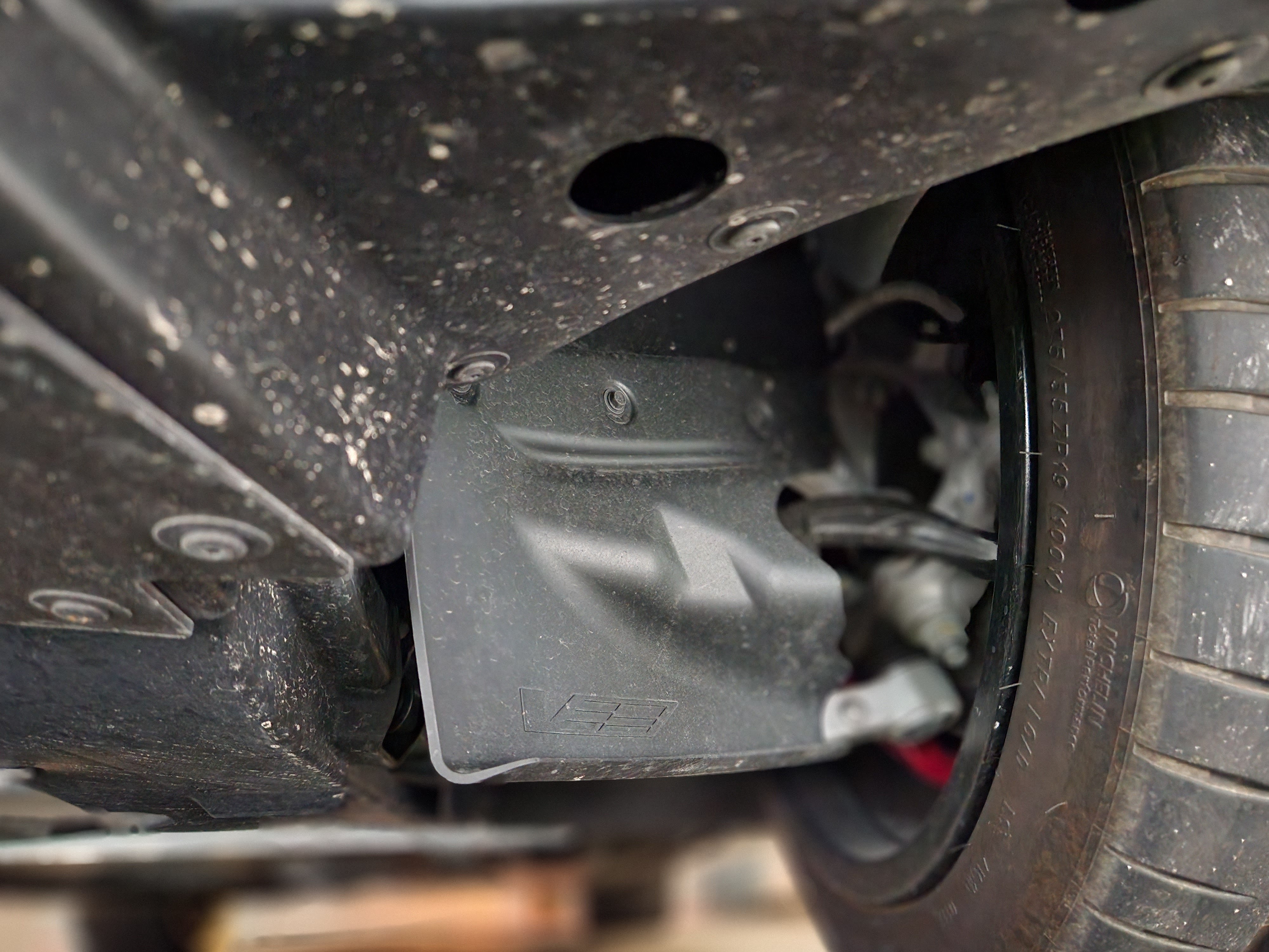

Actually do you have picture of the underside just in front of the wheel and behind the splitter? Either sideHere is the front wheel air deflector on my car which has CF1/CF2 as well as CCBs.

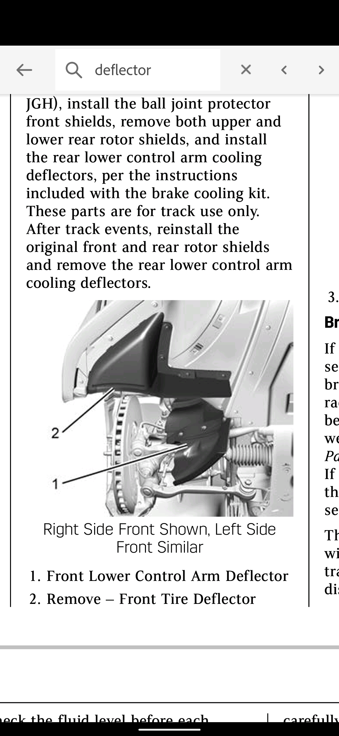

I'm the same as @Ergoc5...ccb, no cf and my 5bw came with the tire deflectors (but I was confused as you can see from my recent post prior Post in thread 'Brake ducts missing?' Brake ducts missing?)It's #2 in this picture
How did u install it? And does it make a difference?Here is the front wheel air deflector on my car which has CF1/CF2 as well as CCBs.
The ducts are permanently attached for the CCBs. You have to remove the rubber debris deflector before track driving to get air across the ducts for the CCBs.How did u install it? And does it make a difference?
