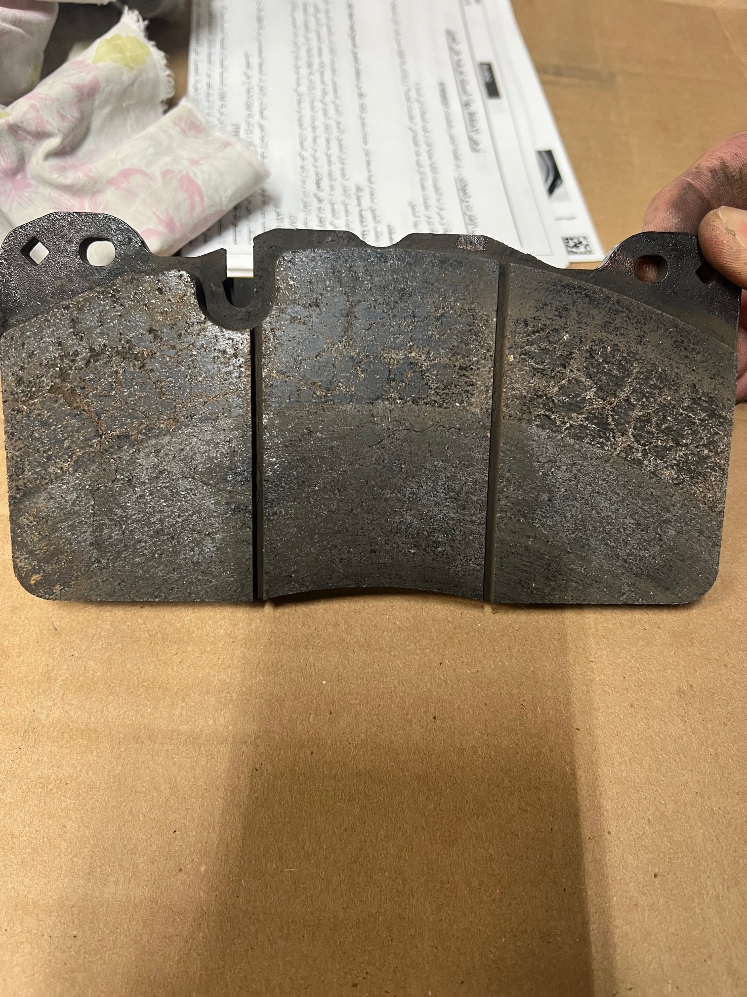

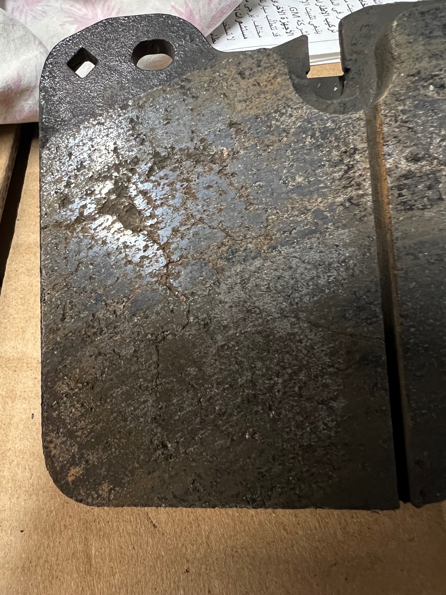

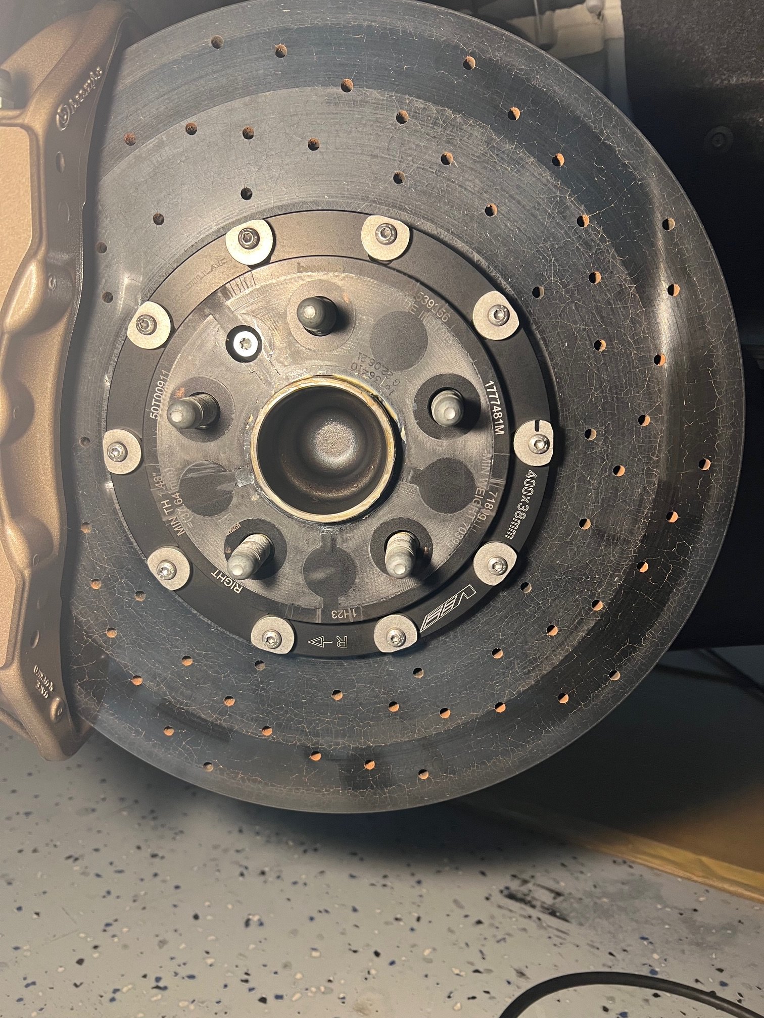

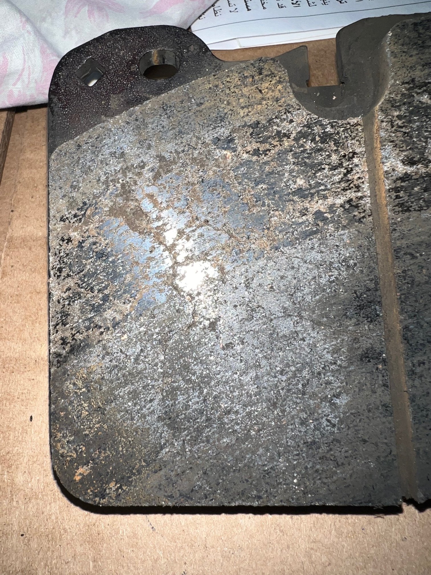

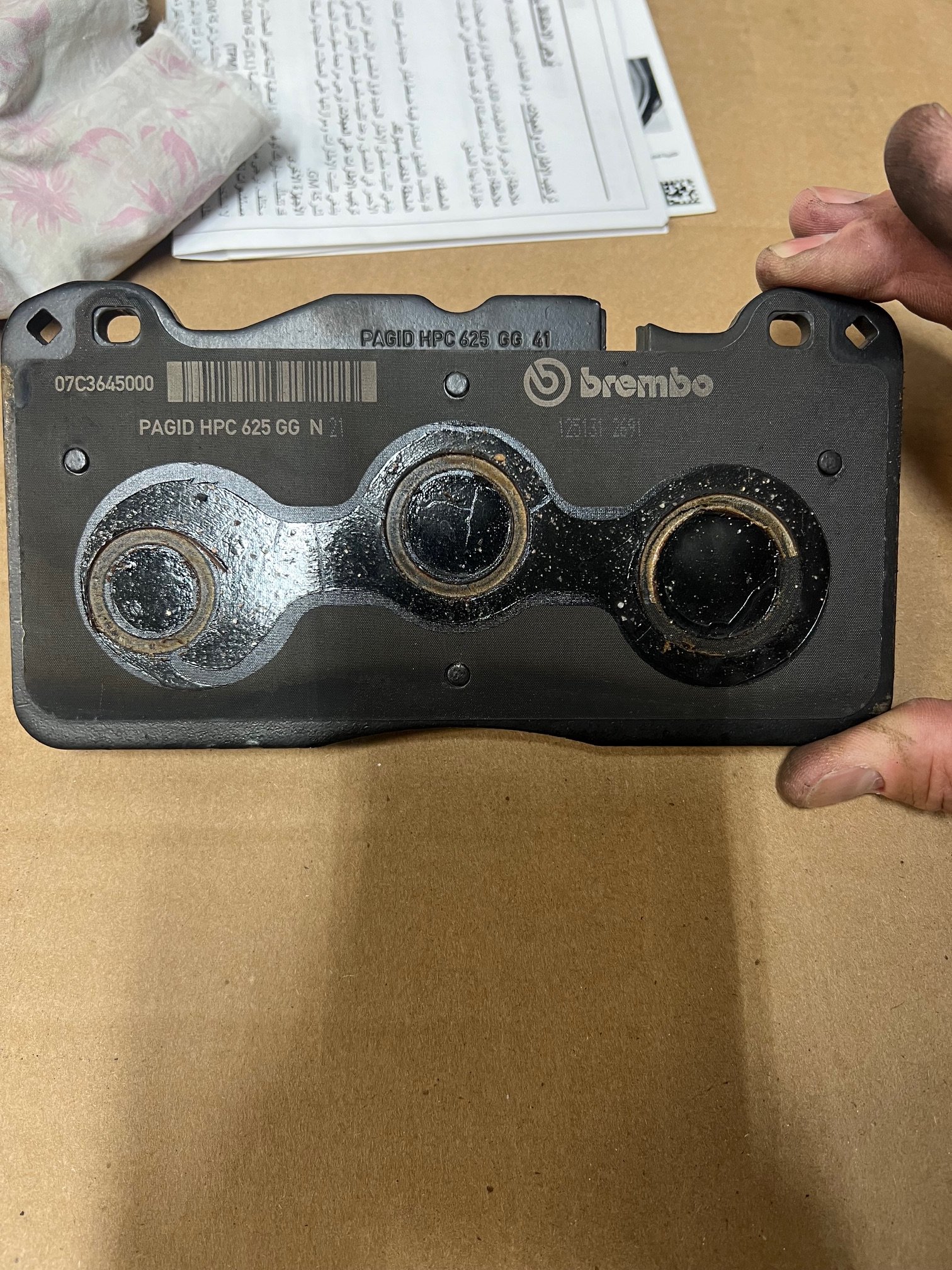

I haven't really posted but been looking for posts on 5BW CCB posts and replacement pads for track. Long story short my issues are:
  • 4600 Miles
  • Factory ceramic pads – not yet replaced
  • Pads have about ¼ of life left
  • Tracked twice at CoTA – about 200 miles
  • Second tracking event put Cup2’s so got better handling and speed
  • Brake temps reached 450 degrees
  • Flushed brake fluid twice with the second round of Motul 660 before 2nd tracking event
  • The brake is soft compared to how the car was before I tracked it
After both rounds, the rotors have a glaze on the outer sides of both fronts, but it wears off with normal street wear. The pads are stressed, with a ½ of the pad glazed and cracked. The rears are normal. I have uploaded photos for review and comment. I called Brembo USA and they were not much help, but to say the factory pads are for low dust and street, not track. They stated that track use is not what they were designed for, but they do not have any replacement pads. Further, I cannot find anyone who sells replacement pads for CCB.
Has anyone else experienced a similar problem? I also thought about going to steels but struggling to get a complete purchase list, and if there are any codes that will need to be reset. Any help is appreciated, as I plan to track again-the car is so fun on the track.

Several track days on my car. It eventually had misfire and cat codes. First, the bank 1 catalytic converter was replaced. Then, soon after, the same misfire and cat codes came back. This time it was troubleshot to to a bad spark plug on bank 1. All bank 1 spark plugs were replaced. 5k+ miles later and it runs like a raped ape (knock on wood).
I have CCBs and 21k miles. I have ~1/4 pads left. Cadillac engineers and Brembo reps recommended pad replacement once the wear indicator comes on. The risk there is it may trigger after the first lap of a track day which is not ideal.. I also don't want to risk scoring the carbon rotor so will probably change them out before my next track day. I'm bracing myself for CCB rotor replacement ~40-50k miles. My CCB pads are wearing evenly. Others have reported their rear pads go first due to traction control kicking in and out. I experience ignition cutout more often than TCS. :)
I agree with @poor-sha use stock on brakes. We bought these cars for a reason - they perform incredibly well out of the box.
