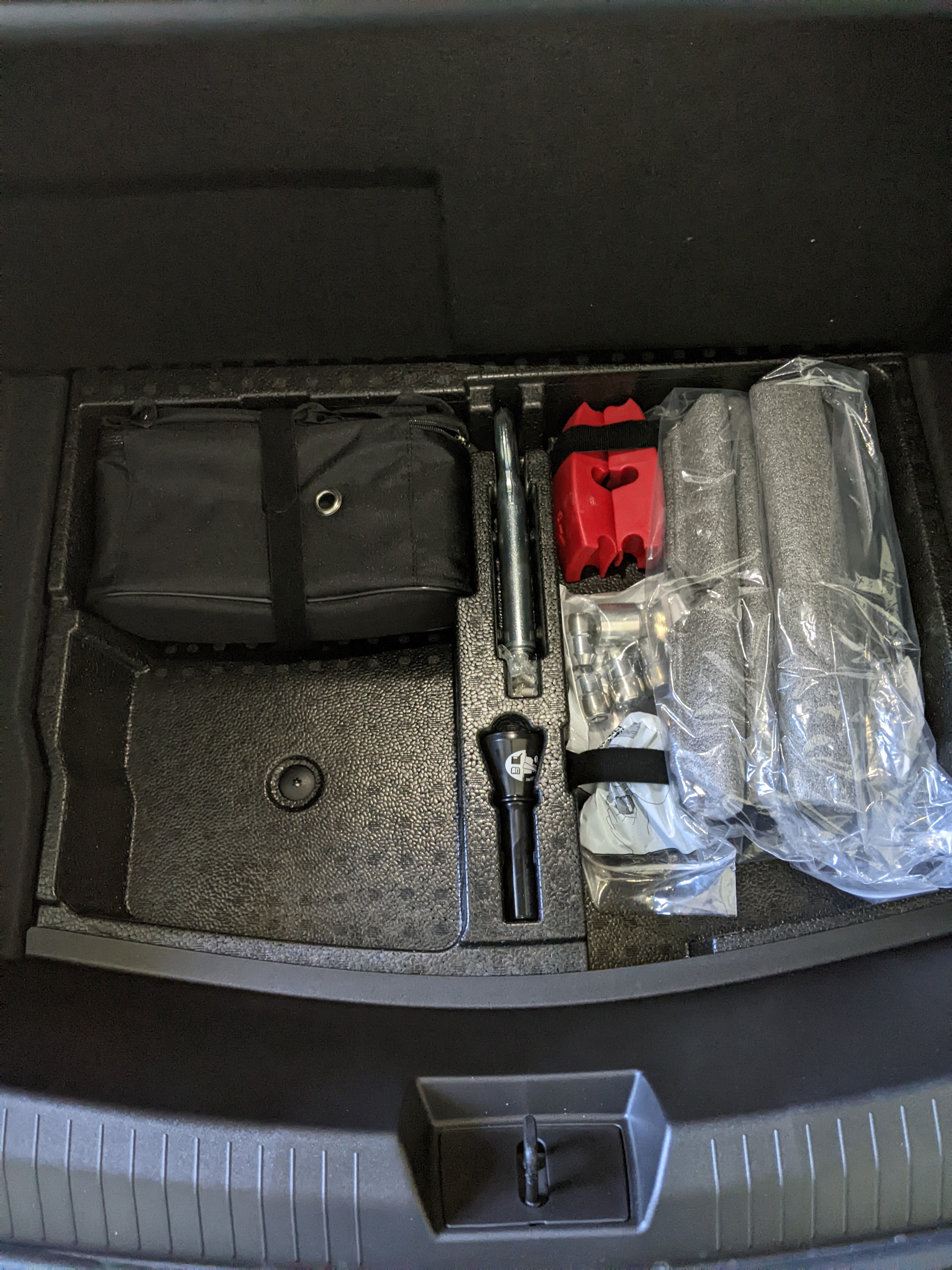

I wonder what those two velcro spots in the right compartment are actually intended for - only BW have the shipping blocks, but I saw pictures of the same straps on regular CT5s, so assuming it is not for them. Nitros? Fire Extinguisher? Costco Vodka bottle?
I like all those options! But probably not what GM intended?

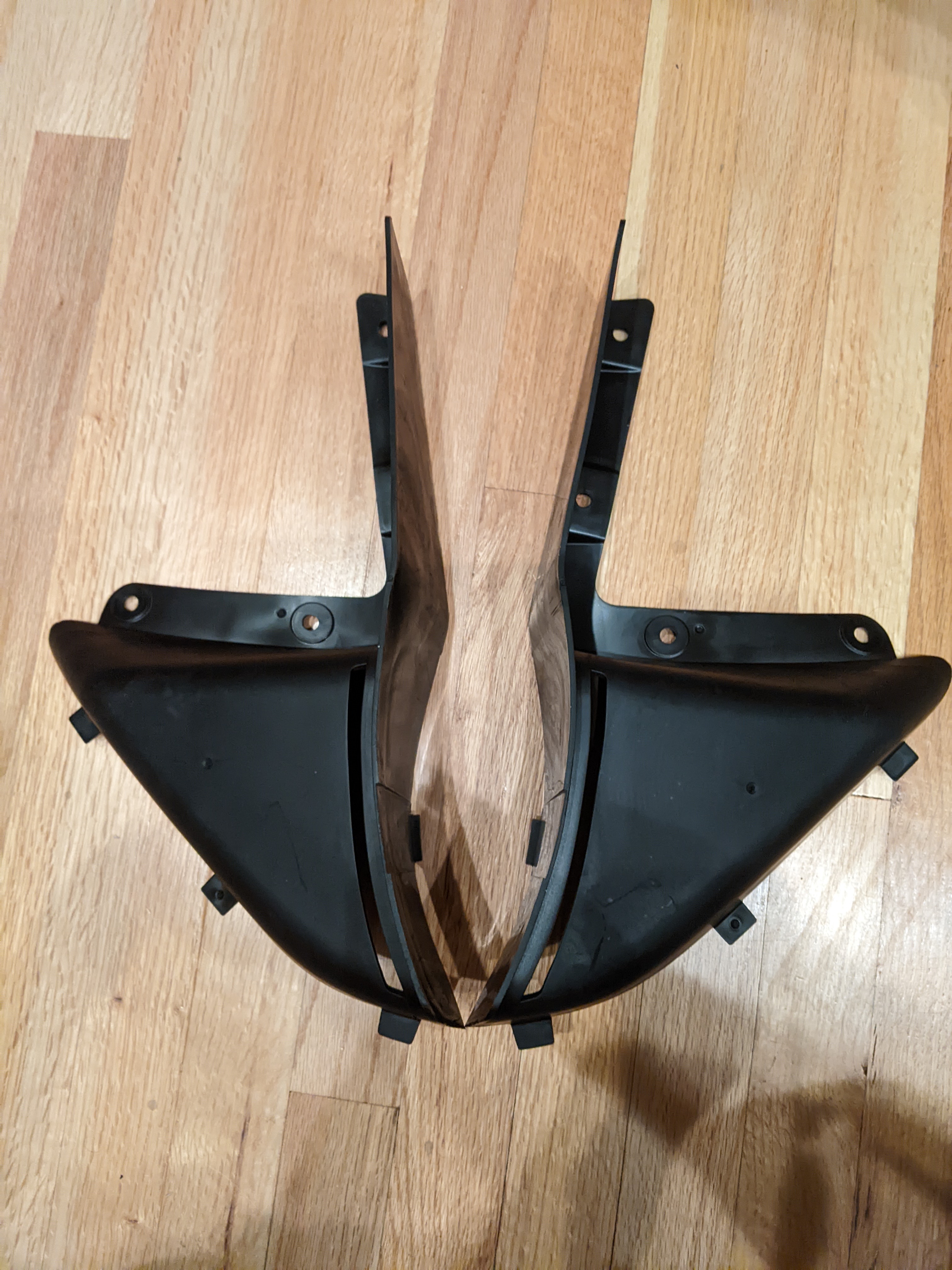

Any idea what these are? no p/n on them..
Still trying to figure out if the ball joint/control arm protectors are supposed to be installed.
I also have this package F Protector Pkg 84806233 with two pieces that look like they go behind the front wheels? Anyone install these?

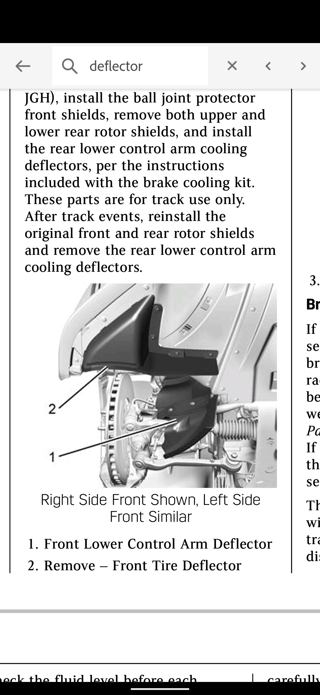

Those look like front wheel deflectors. The manual says to remove those and install the ball joint protectors for track use.

I use the PDF, so I can search stuff.
Honestly, if you have CCB, you don't need to do anything for the rear. The steel brakes have a deflector and different rotor shields to install for the track.
Those front tire deflectors are supposed to be on for street use.
Those front tire deflectors are supposed to be on for street use.View attachment 10632
Yes other side is like a scoop..It's like flexible molded rubber piece as opposed to TPS plastic

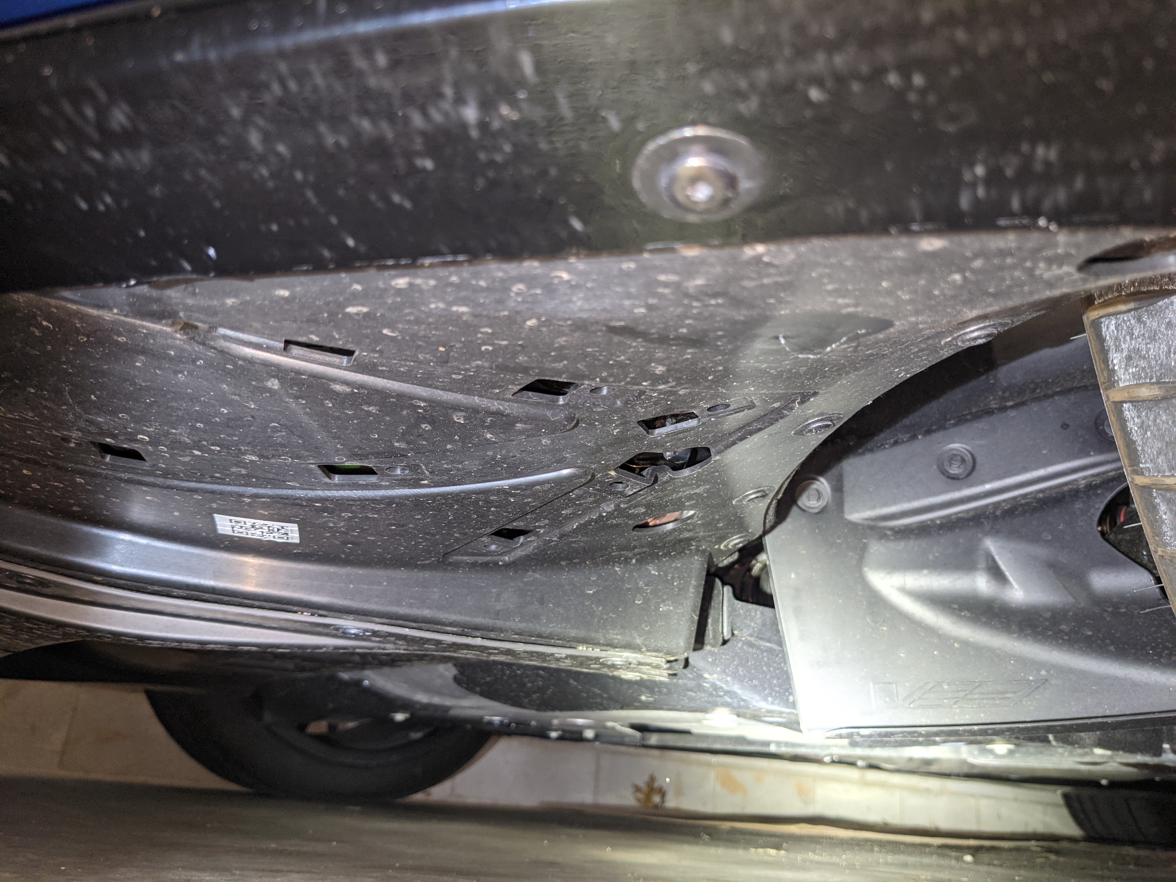

Front tire deflector is supposed to go here, but my dealer said they didn't get anything of the sort, so I am currently missing them.

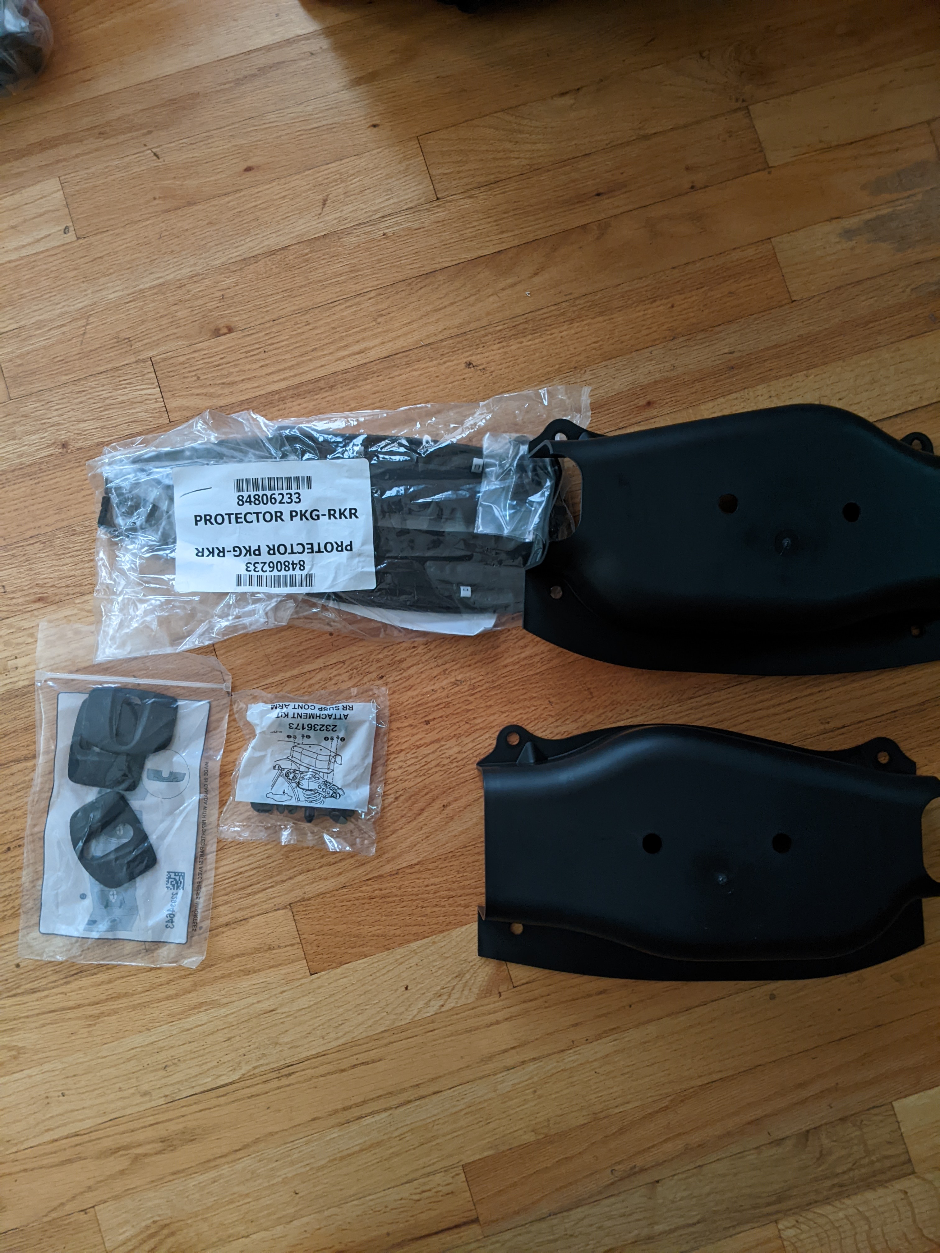

The large pieces in the picture are rear ball joint protectors I think ...not sure what the RKR protection package (848062333) was for. The small plastic pieces on the lower left are the door striker trim surrounds which I installed. I still don't know what to do with the other pieces lol....maybe it's a dealer question.

I can't keep track of whose cars have carbon fiber and not. Does anyone with non-carbon fiber exterior and non-carbon brakes have the front wheel deflector? I have neither carbon option and I don't have the deflector.
@Mirza Grebovic , do all 5BW get the tire deflectors?

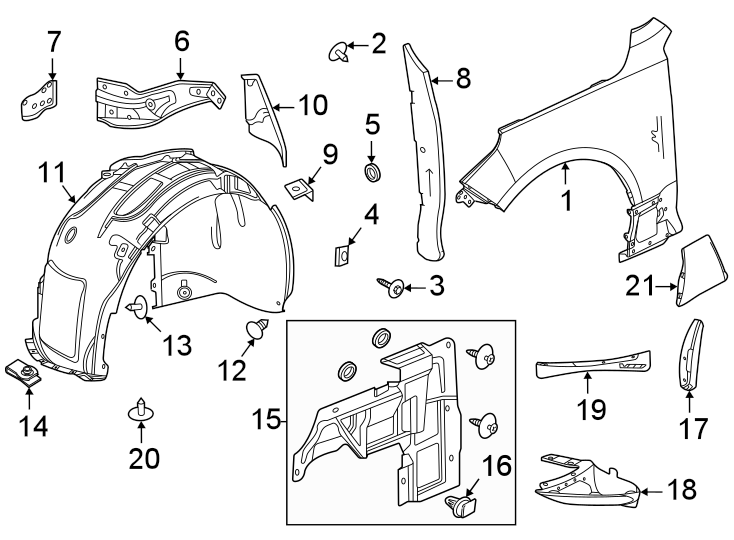

I have CCBs but no CF....as per Mirza the non CF car should have this piece ...the CF cars may have a different strake...maybe some of the CF guys can show their pics..
#18 in the view below
