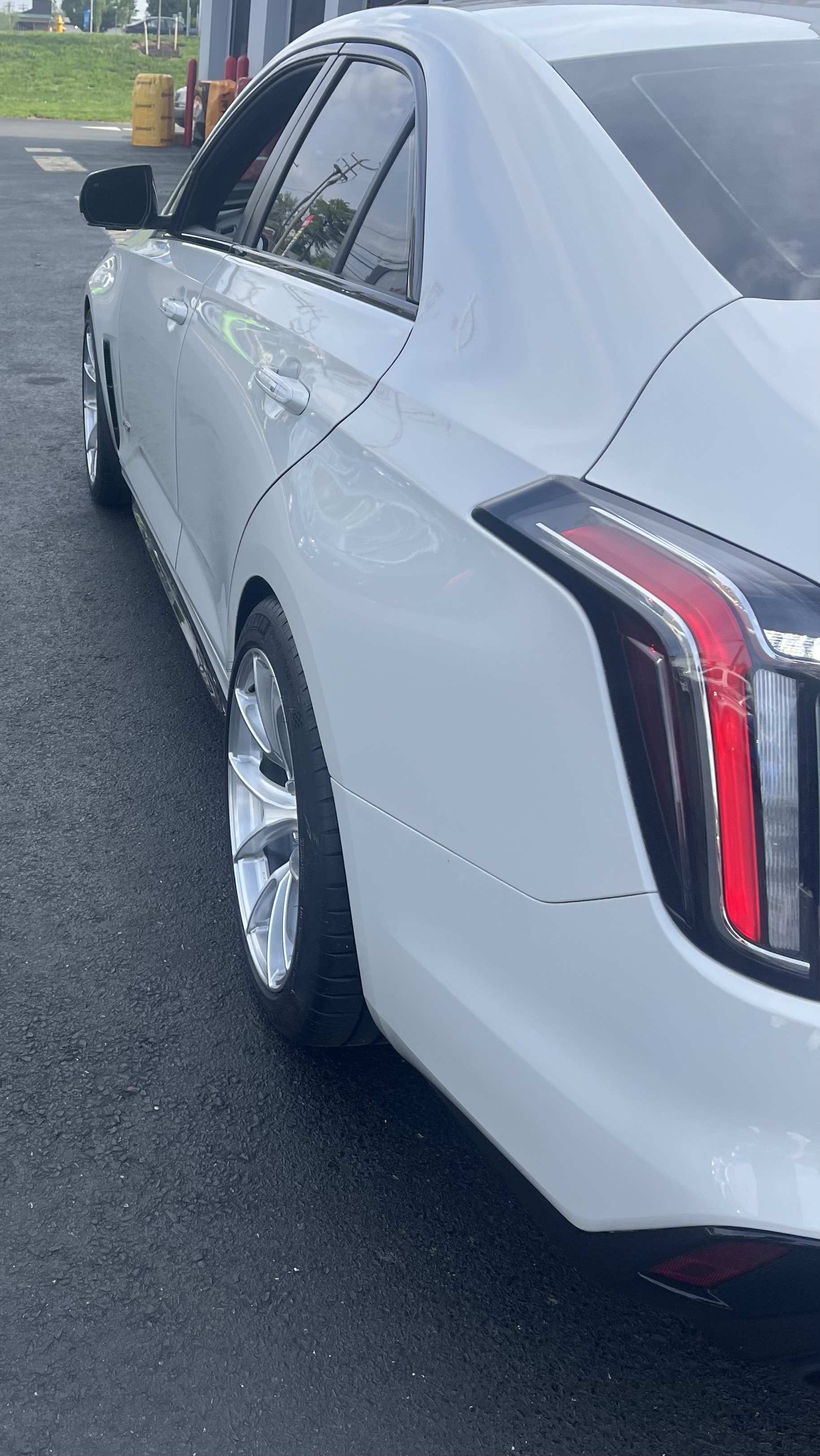

Personally, I wouldn't want any more than the 9.5 ET35 with stock tire has. Looking at it, the tread is within the wheel well lip but the sidewall bulges past it slightly.
Thanks mate, is yours the 18x10.5 et40 or the 18x10 et42?
18x10.5 et40
From the pic, those are also the original tires FYI. I'm anticipating replacement this summer and plan to step up in size a little.

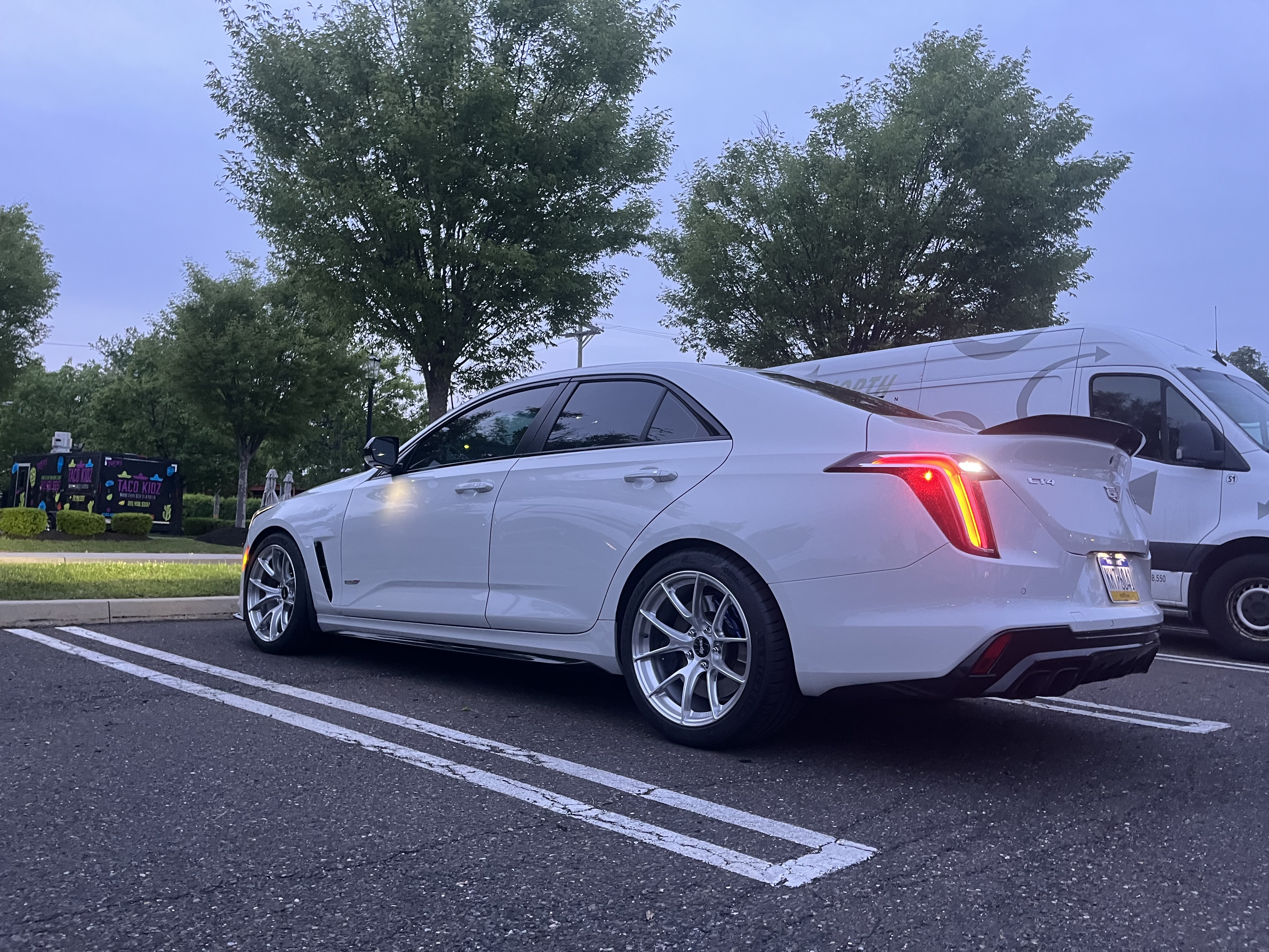

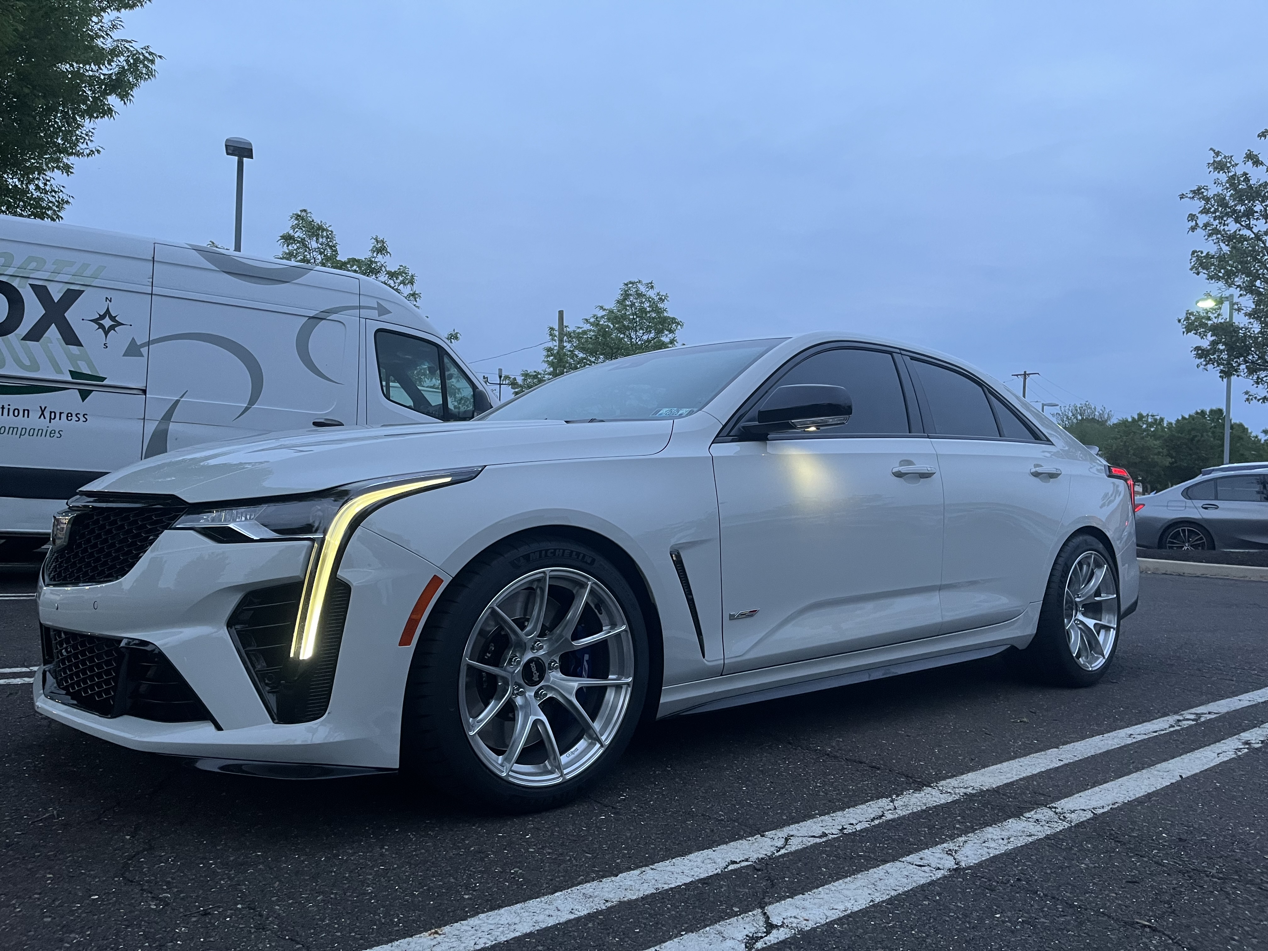

Been following this thread for a while, a lot of useful information throughout. Waiting on swift lowering springs to come in.

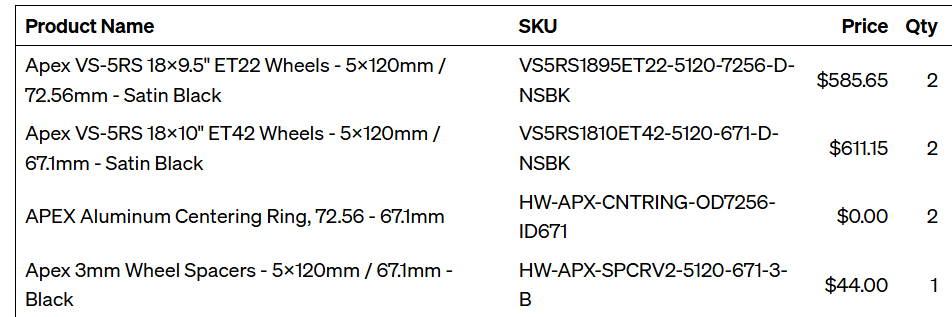

VS-5RS.
18x9.5" ET22 - 265/35ZR18
18x10.5" ET40 - 285/35ZR18

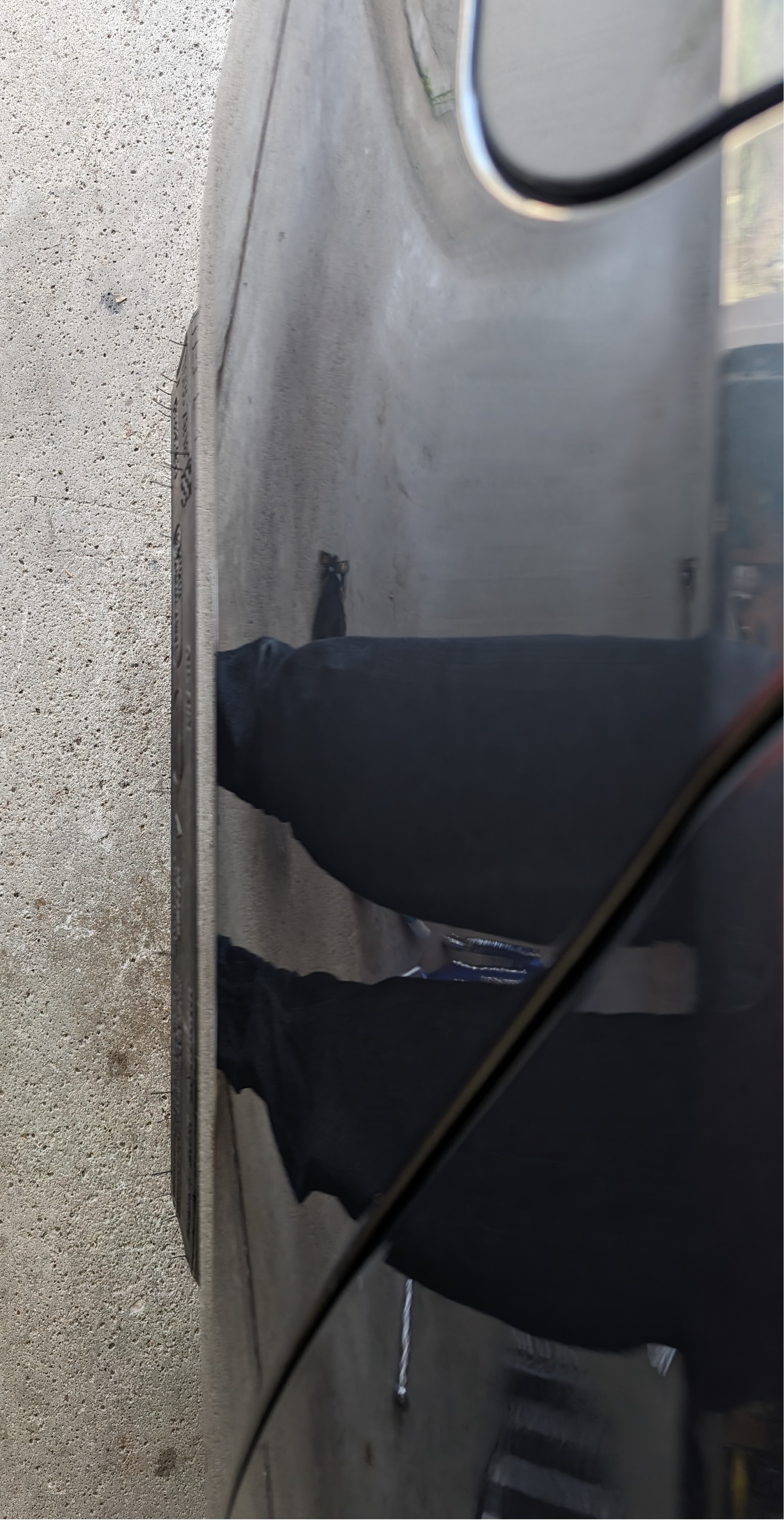

Can you by chance post a couple of pics from the back? Specifically looking to see how far these 10.5 stick out… and whether or not 7-8mm of poke is very visible. Thanks!
Yeah of course, but this is the only one from that day and it's not great.

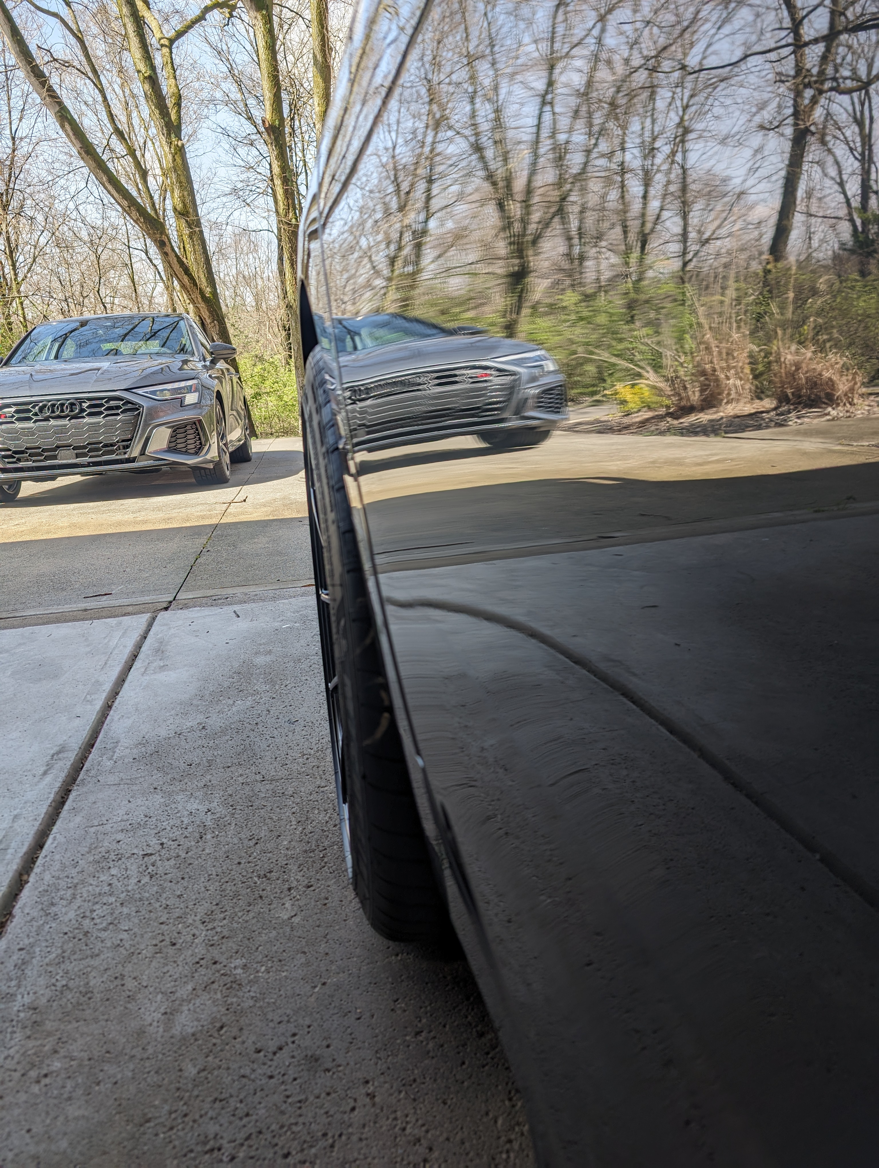

Has anyone tried an 18x11 +44 rear wheel?
Hard to tell the poke with the 10.5" +40mm, but the 11 inch wheel only sticks out about 2mm further.
I test fit the OE 5BW wheels (19x11 ET50) on my 4BW and there was a little bit of poke. 6mm further outboard would not be something I would want unless you ran some crazy negative camber.
Interesting. People running the 18x10.5 +40mm offset are technically poking 3.5mm roughly more than the ct5vbw 19x11 +50mm rear wheels and they dont look bad.
With the 5BW wheels on my 4BW, the edge of the rim was basically flush with the rear fender lip but the tire (with it's rim protecting sidewall) poked. With a 295/30 it would be better. The popular Apex 19x10.5 ET45 sits 1mm further in than the 11" ET50 but that's still not quite enough to my eyes.
FYI for a point of comparison, BC Forged specs an ET55 with a 10.5" rear fitment for the 4BW. I think somewhere in between 45 and 55 is the sweet spot for a 10.5 to run a 285 or 295 tire but I am very particular when building custom wheels so take my opinion for what it's worth (nothing!).
