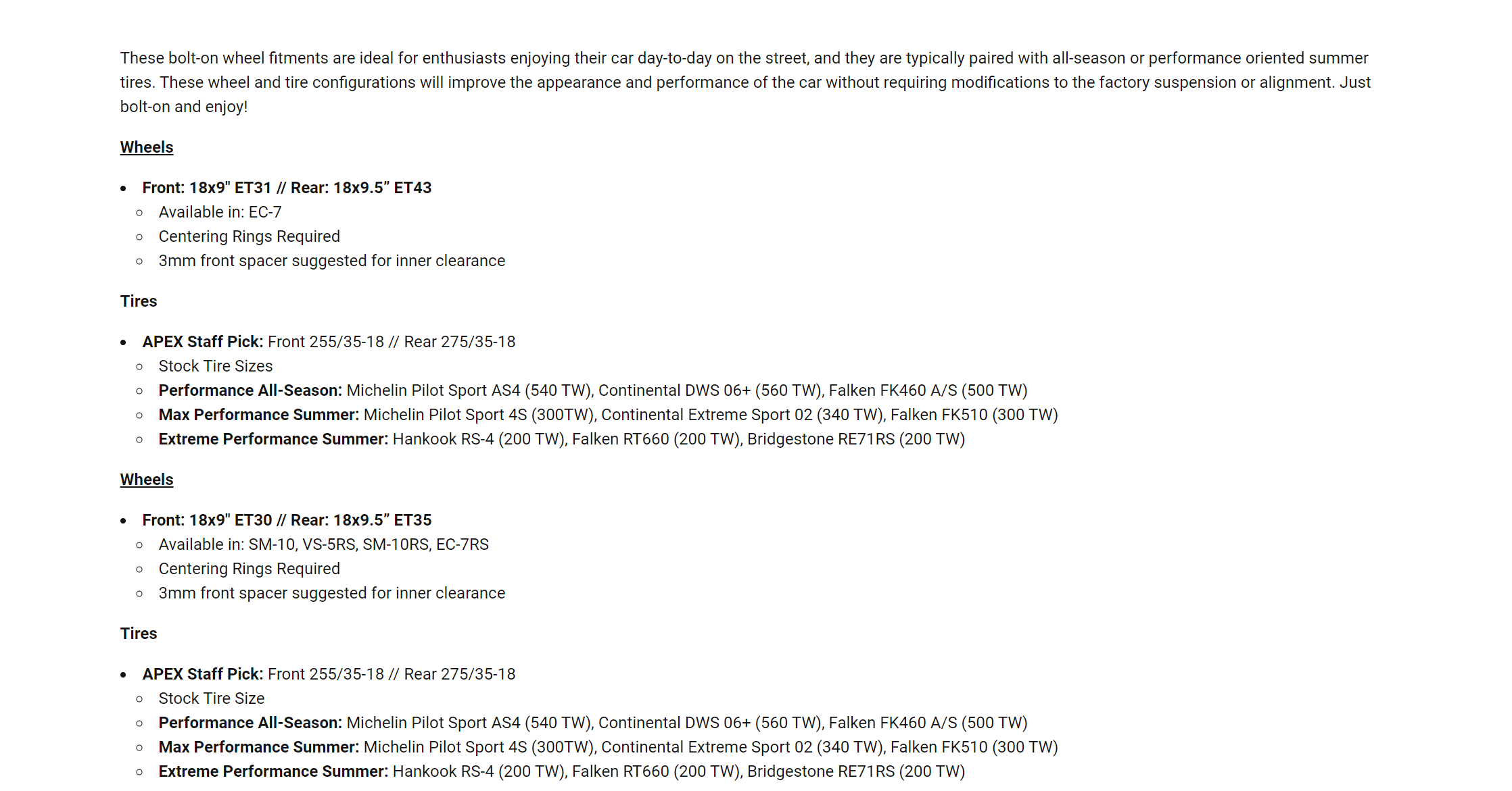

Just wanted to confirm that I am reading this fitment guide correctly before I buy
Can the CT4 BW run the OEM summer tires on wheels that are .5" wider with no issues? I would go with stock size wheels if there are any drawbacks or potential for wheel rub up front. Very interested in a set of VS-5RS in brushed clear for my summer tires, any help would be greatly appreciated.

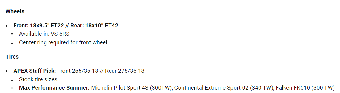

Yes. 255 and 275 (factory tire sizes) tires will fit on 9.5 and 10 inch wheels, respectively.

Both of these setups mirror the factory 9inch fronts and 9.5inch rears. The ET35's will sit 8mm further out and more flush with the rear fender in comparison.
I don't have 4VBW factory offsets on hand to compare.

Thank you very much. I also sent an email to Apex and Corey confirmed that the 18x10 ET42 will fit the CT4 BW rears.

Just to confirm in case anyone else is curious, because I believe we already spoke directly over email, but yes the 18x9.5" ET22 front, 18x10" ET42 rear setup is a direct fit with the factory tires and can only improve the handling, since you are getting a little more of that tire onto the ground.

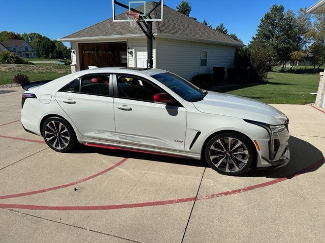

For reference, this car is running 18x9" ET30 front and 18x10" ET42 rear with the OEM tires.
