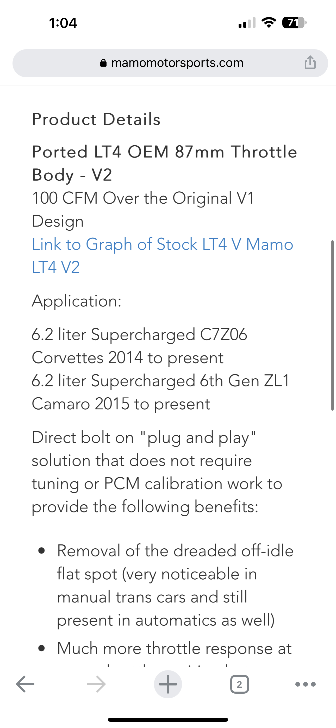

As good as that TB was/is, my V2 design flows significantly more air and that LT4 blower is making good use of it (it really needs more air at that power level).
Stock TB's flow right around 940 CFM.....my V1 flowed right at 1000 CFM (with solid gains in the lower and middle throttle angles which increased responsiveness and tip in reducing/eliminating the dreaded of idle lag).
My new V2 design flows 1100 CFM.....a tremendous increase in airflow over stock and a significant gain over my proven V1 design.
Better yet it also comes with just as large a gain in airspeed as well and that's the winning hand when you can design a throttle body (or a cylinder head or an intake manifold) that significantly improves both. Your practically force feeding the engine with a higher volume of air moving at a much greater rate of speed.

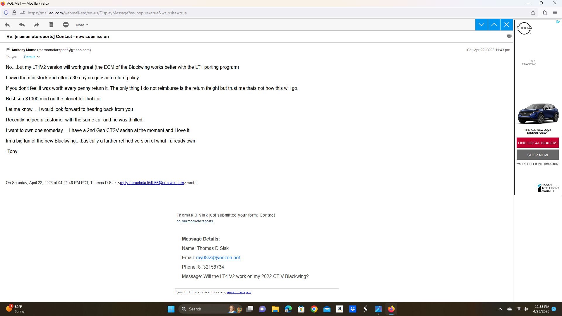

Basically he said there was a slight chance the LT4 version would throw a code because it flows more air than the LT1 version. He based this on his experience with the CTS-V3.
We talked for about 15 minutes. After explaining the Kong TB doesn't throw codes, he suggested the LT4 version and said if it caused any issues he would swap at no charge.
Super nice guy. Happy to be doing business with him. Ordered the part last night and he already shipped it this morning.
I have HP Tuners and a Autel scanner. So I am going to install and send him logs.
a larger TB will not throw codes.
That's what I gather also. I appreciated the fact that he didn't just say, 'yeah, it'll work fine'. He wanted to take a few minutes and have a conversation.

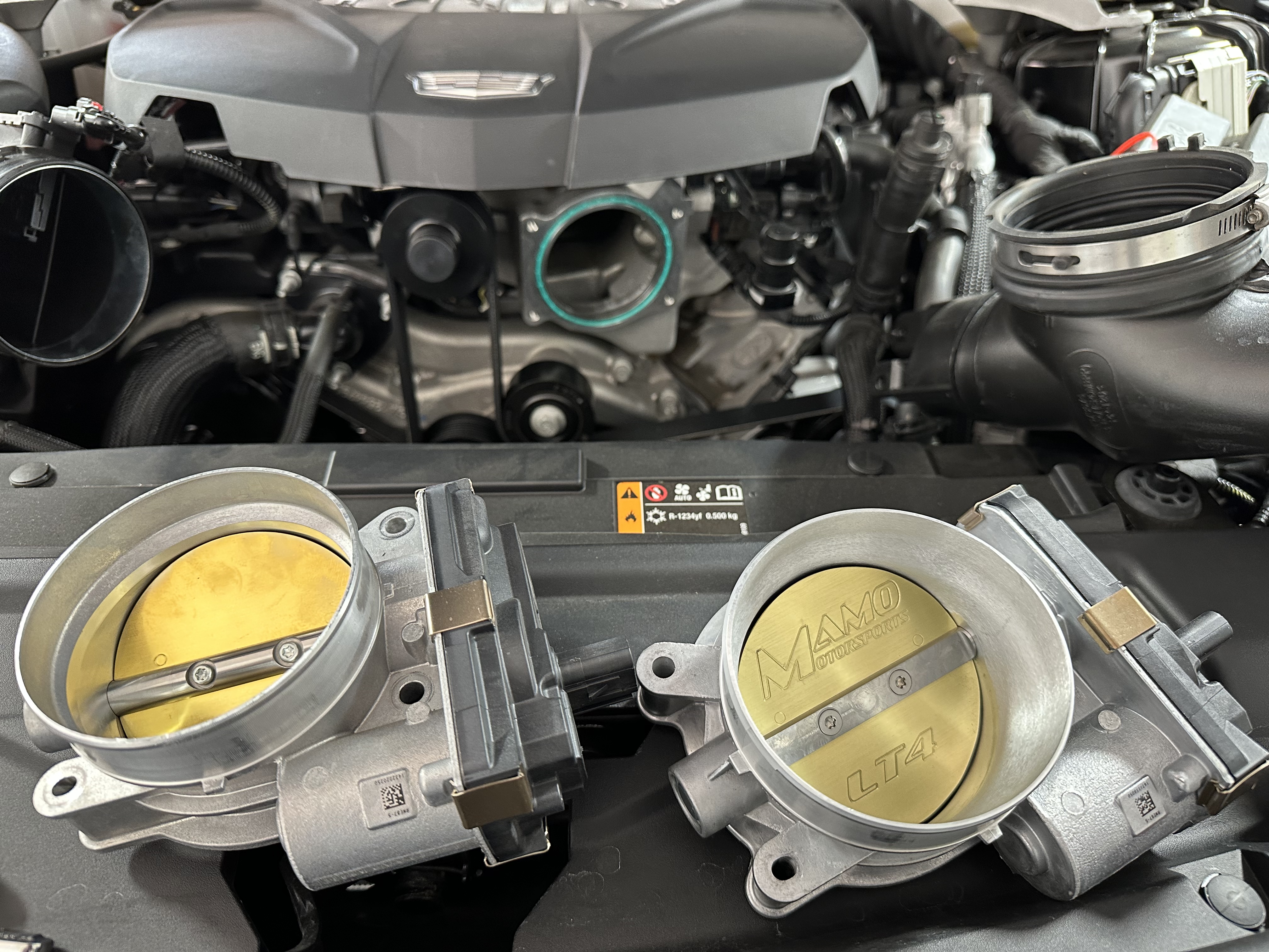

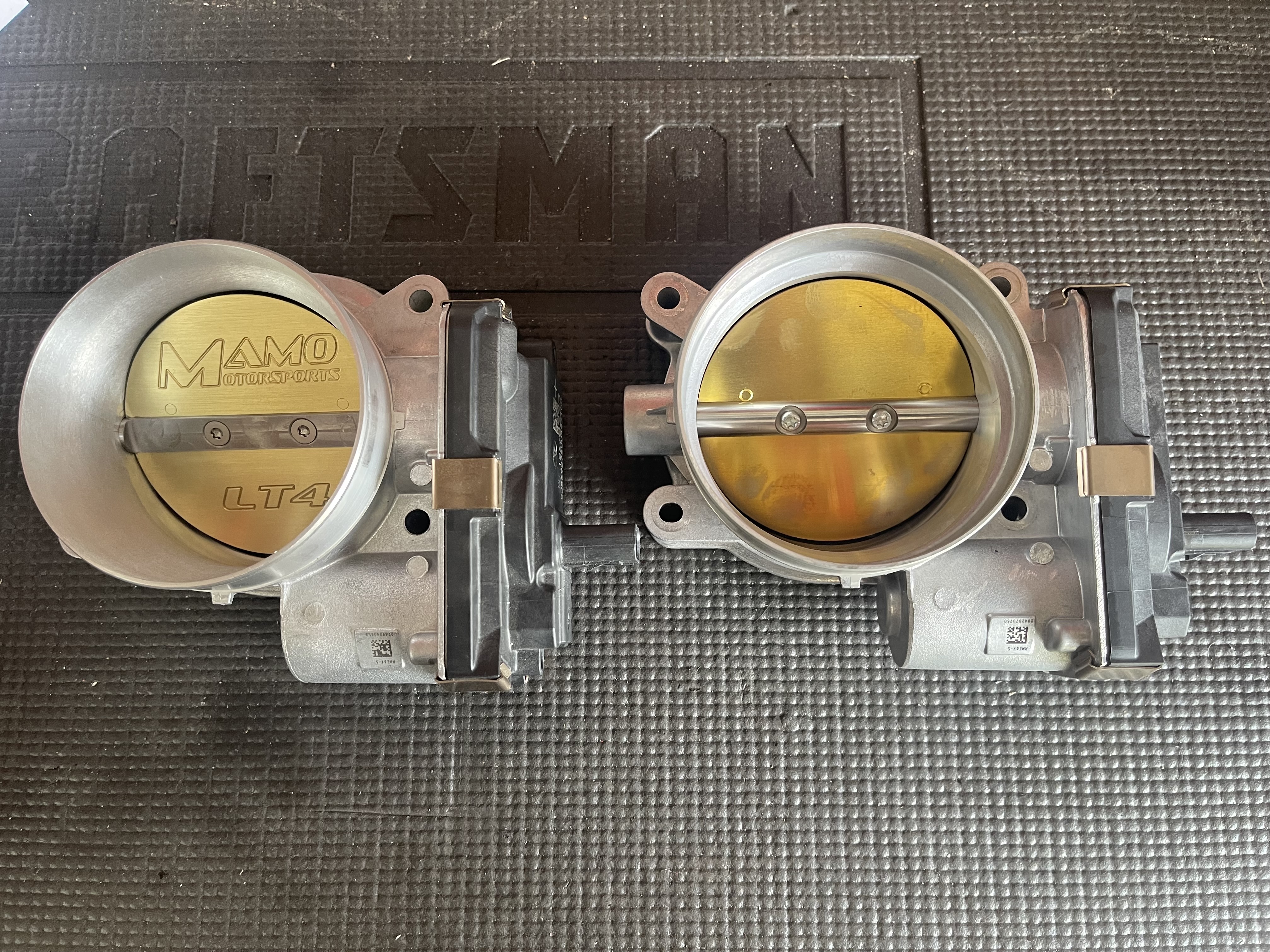

TB installed. Took 20 minutes and a 7mm and 10mm socket.
I removed the airbox tube just to give room to access the bottom right bolt.
Two start cycles and about 10 miles so far. No codes. Used my reader...readiness is still set.

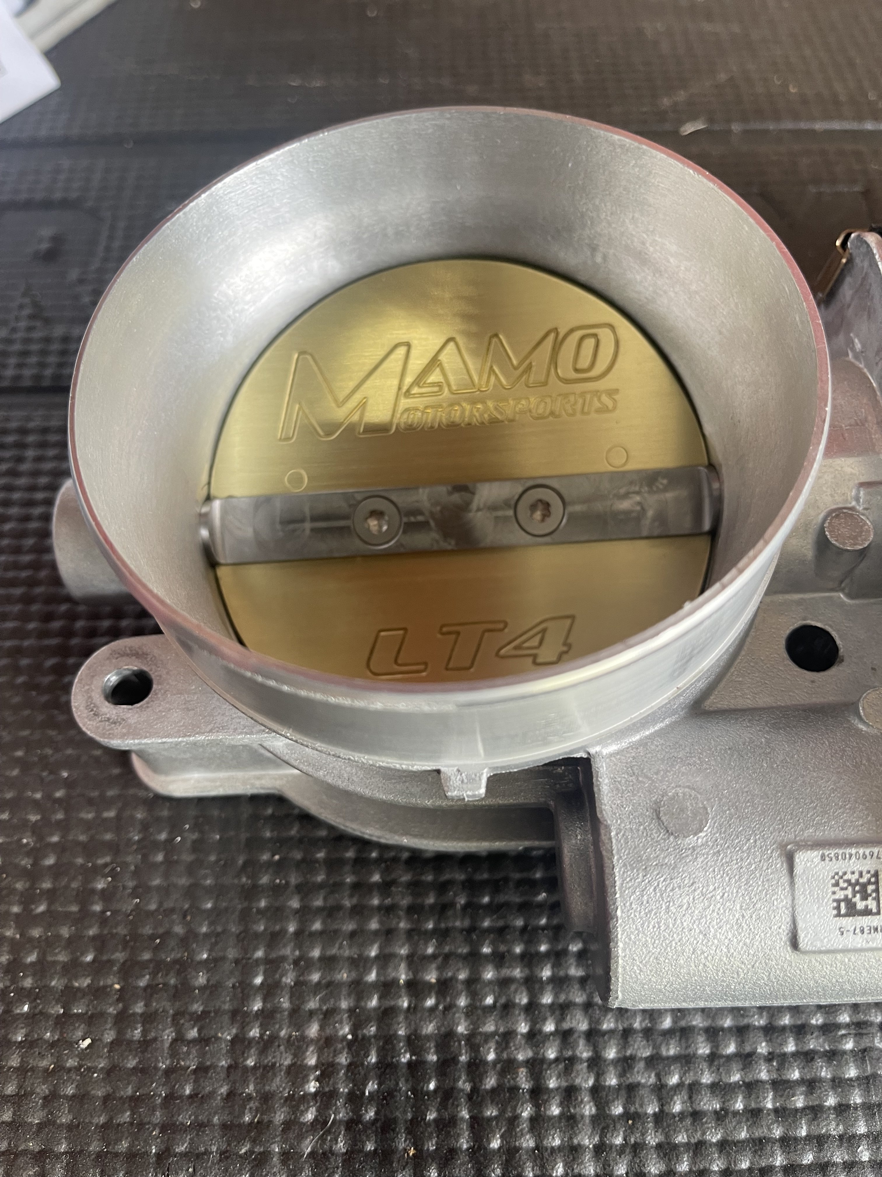

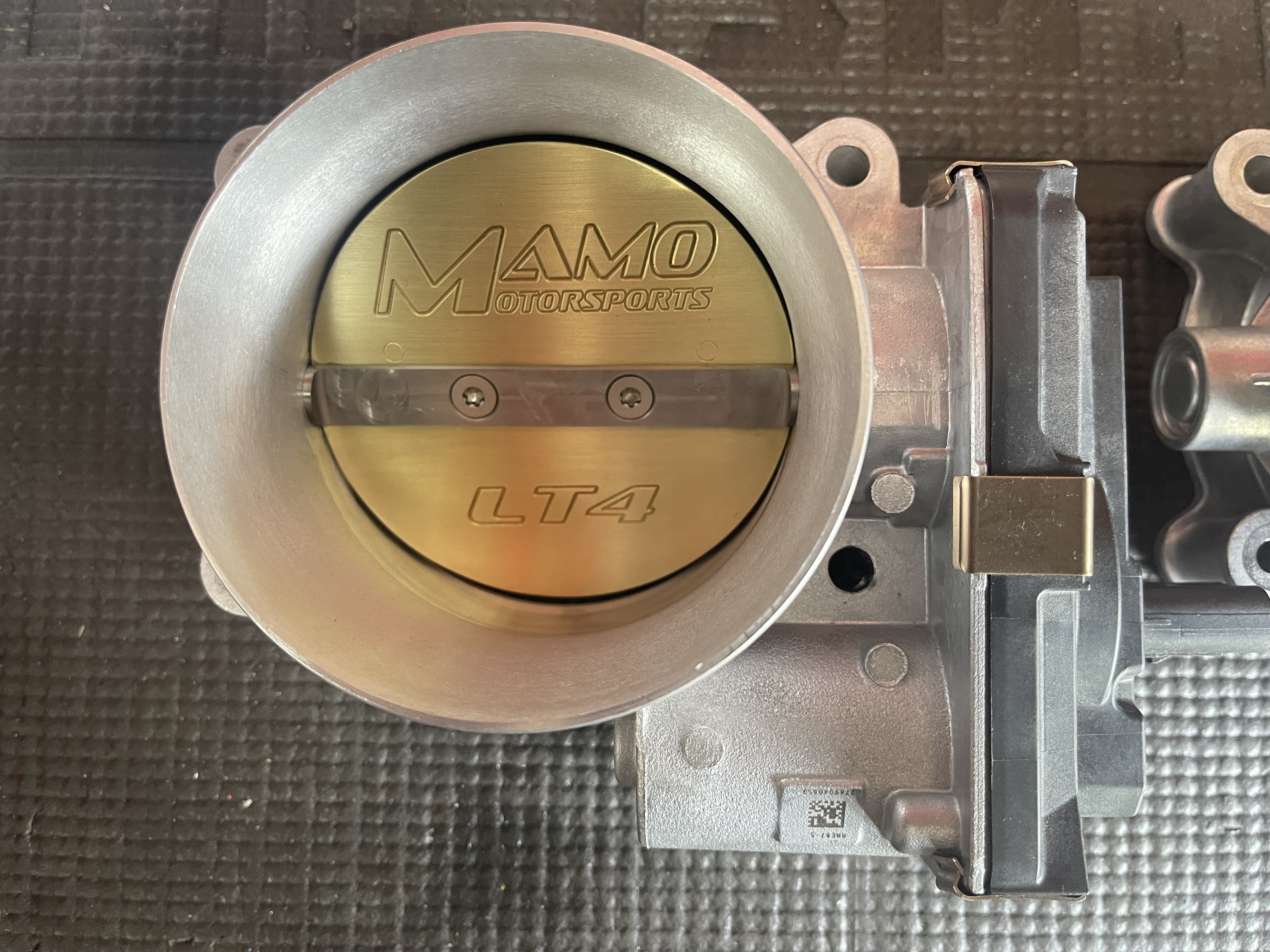

Nicely ported unit. He did lip, interior ridge, backside, TB plate and the bar/screws.
