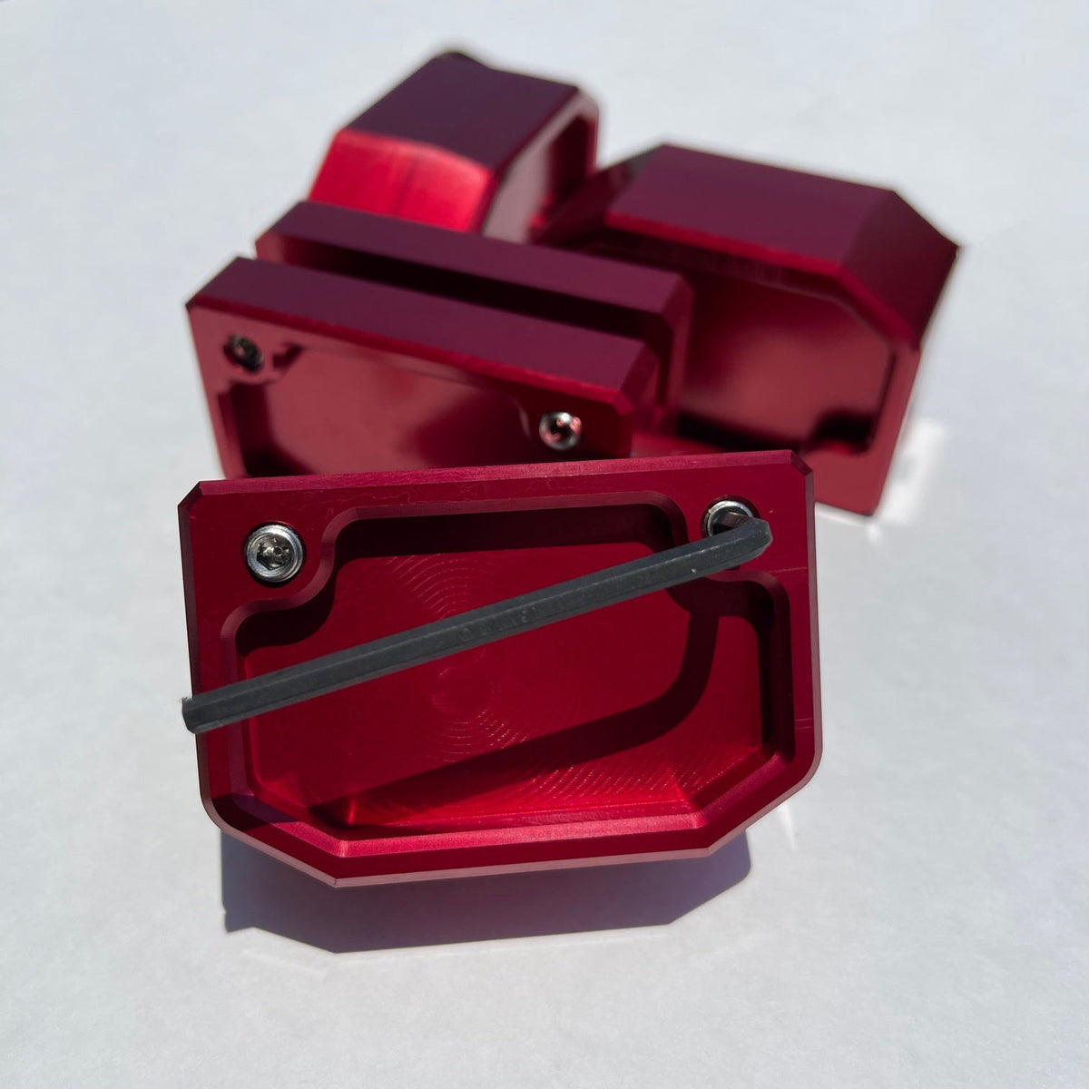

I use the ZL1 Addons CT5V stealth mounts. I did not cut the plastic since the mounts bottom out on the pinch weld. Not sure if this is ideal, but in the 5 or 6 times I've jacked up the car it seems to work fine.
Interestingly, the picture shown on the ZL1 website does show that the plastic flexes quite a lot
That pic is from my installation of them. The plastic does indeed flex, but it's not even pinched in between the pad and the chassis. The pad bottoms out on the weld. I've jacked up the car a few times with no issues.
With the ZL1 add on pads, you just leave them on the car with the set screws? Hmmm that makes me a bit hesitant
Yes, just make sure pinchwelds are bottomed into pad. I dabbed RTV over ends of set screws where they contact pinchweld after anti-seized threads of set screws. They won't go anywhere. I've driven off with magnetic pads and they stayed let alone screwed on pads.

Thanks I finally got through using the sales line...I basically wanted to figure out what fit best with this car. Mine has CF side skirts and I was concerned that the stealth version would not have enough clearance up front. Considering the magpuck as well but wasn't sure about the 2" vs 3" version. I am thinking these are worth it over the rubber versions.
