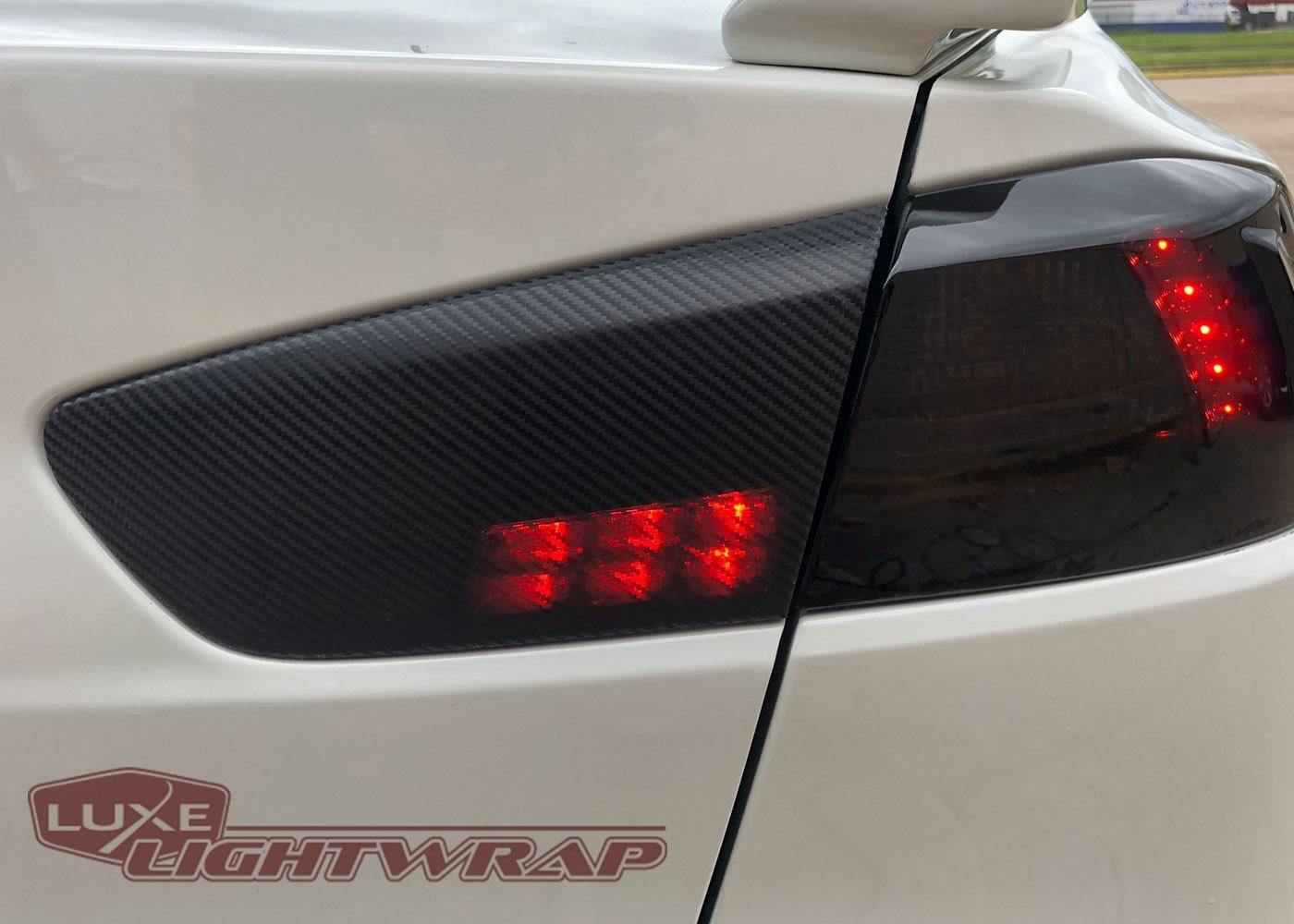

I have a ct4 and ct5 extra screen with those dumb plastic panels, I plan on doing a carbon fiber skin assuming I don't have to scrap or molest all of them together to make it fit. If all goes well, I'd likely be selling the spares to highest bid to offset all the extra stuff I'm doing. It comes off quite easy, the hard part will be getting the center home button to look ok. I either have to overlay carbon on that to make it flush with the rest of the panel, which would loose it's illuminated home icon, or leave it black and non raised. I'm not sure which will look worse tbh
Or wrap the button separately with this "carbon fiber tint" and the home icon should(maybe) show through.
