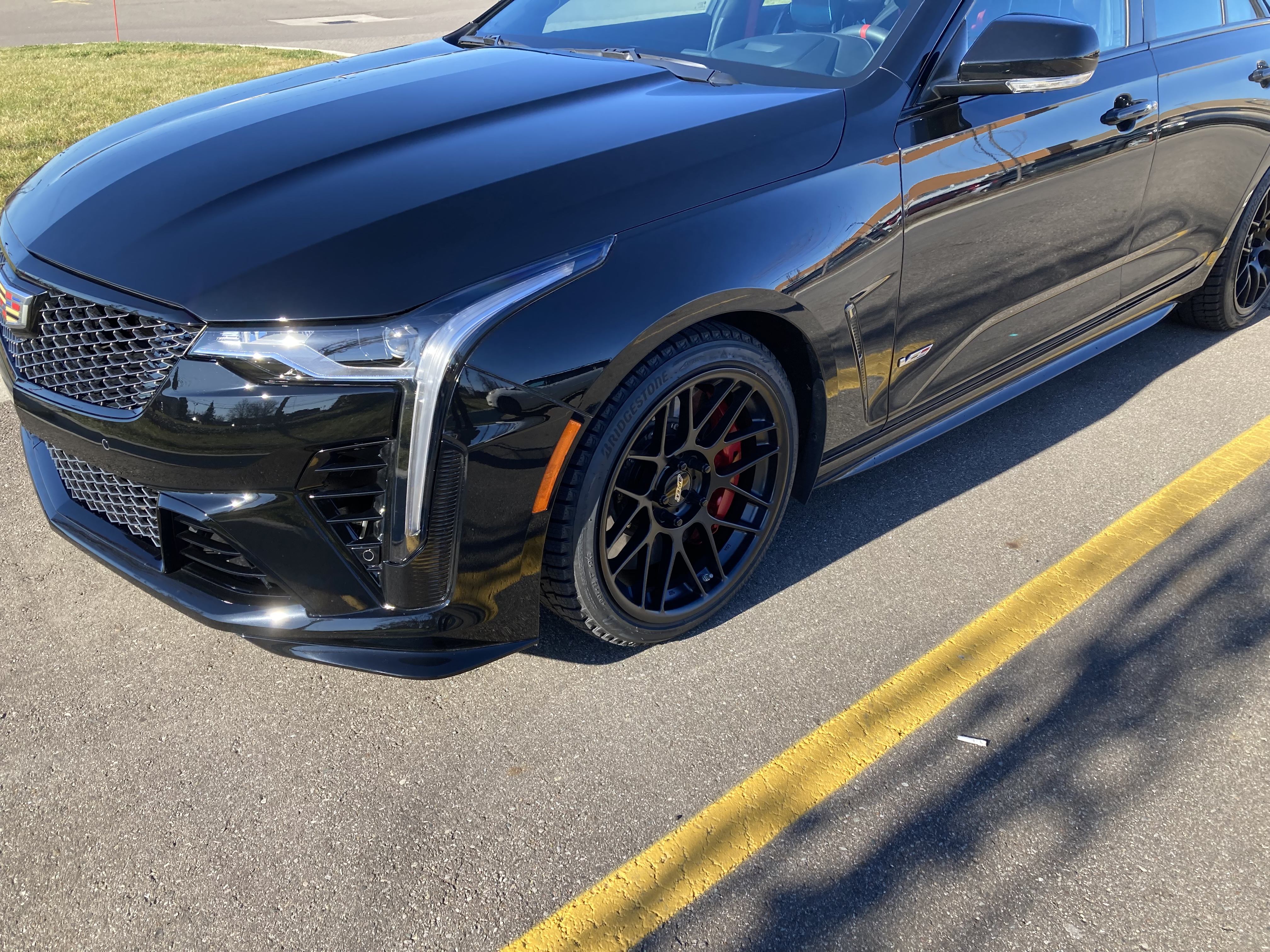

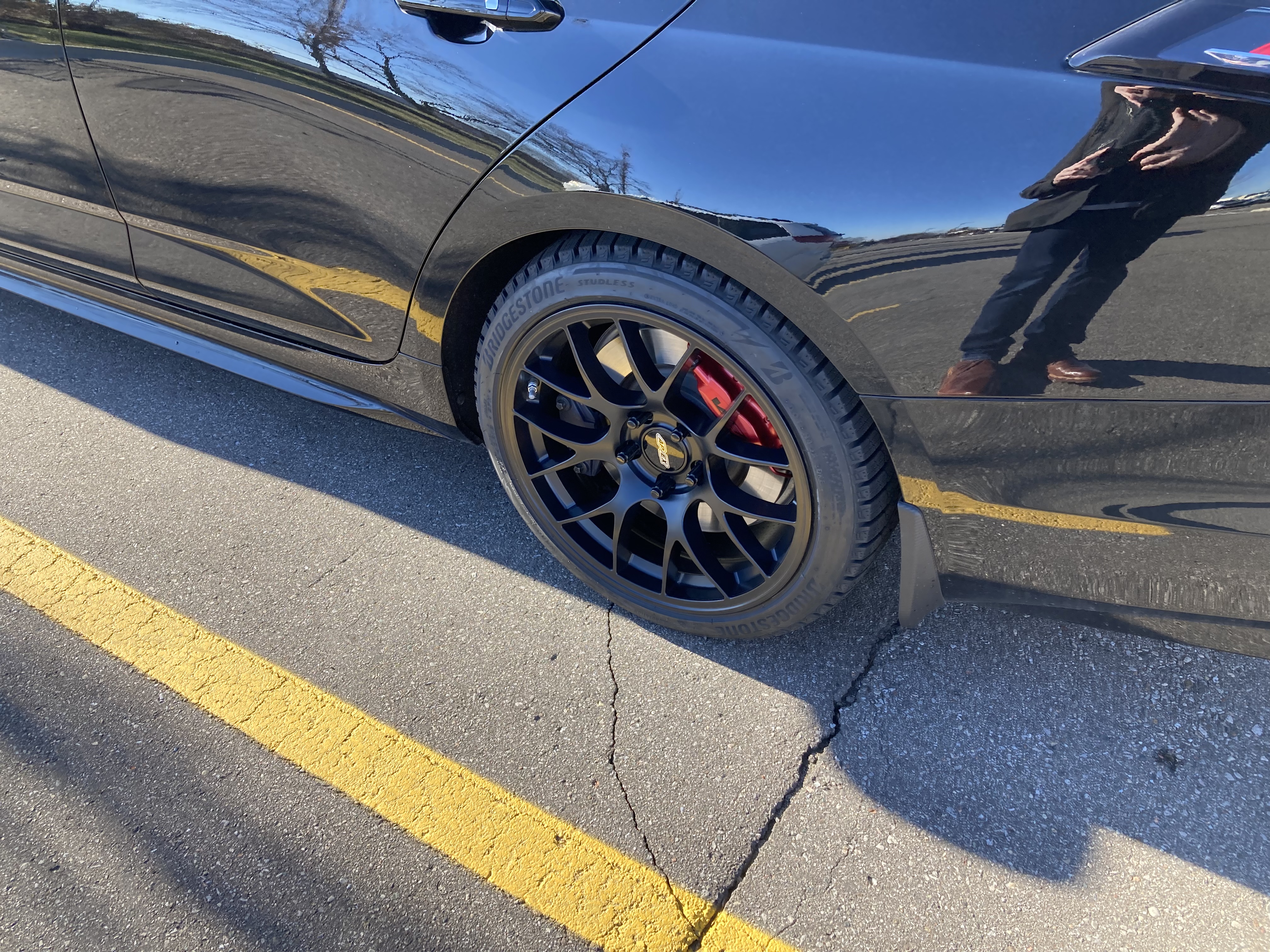

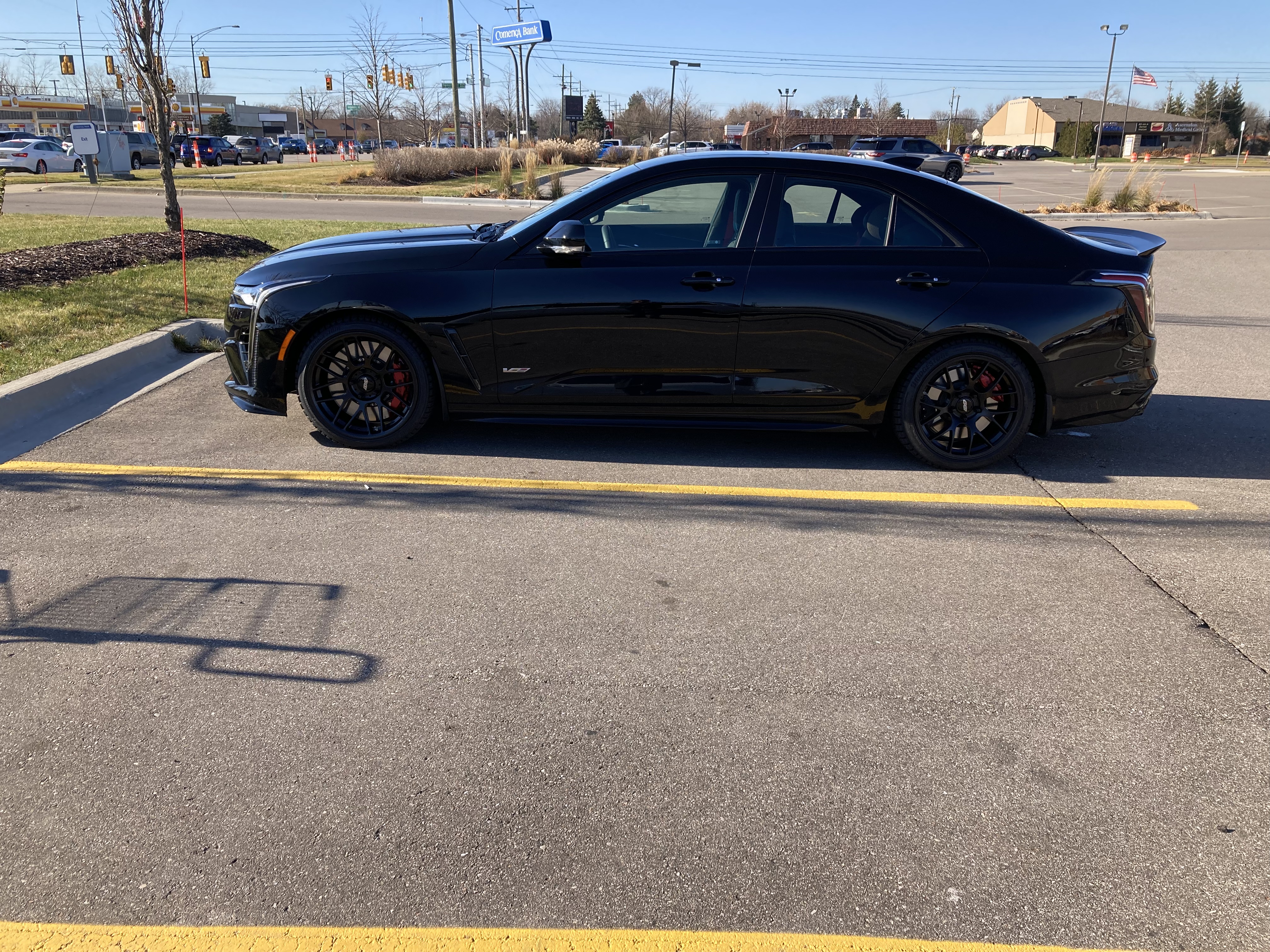

Thanks Novakin for sharing your 4BW setup.
I copied most of it and suggest following his wheel suggestion as is. I tried something different and had to revert back to his suggestion.
Tires I am running Blizzaks 225 40 18 in front and 245 40 18 in rear.

Are your wheels a different spec from Novakin's? Your front wheels in particular look totally different.
Maybe it's just me, but are those the same wheel style? They're close, no doubt, but I think it's a different wheel entirely.
Yes fronts are different.
I thought I would be “smart” and pick a different wheel. I liked the Arc 8 and that was a bad choice. Arc 8 fits the front 18x9. Arc 8 18x9 doesn’t fit over rear caliper. I have Arc 8 in the front and Arc 7 in the rear.
Summary follow Novakin suggestion and don’t try to get smart

What about the EC8 18x9.5 or 18x10?
I'm thinking ARC-8 18x9.5 ET58 with a spacer...
I looked at spacer for the 9 wide Arc8 and needed 5MM. Only had 5 turns of lug nut and decided to fix issue with wheel instead of studs and spacer. I personally prefer to stay away from spacer when I can.

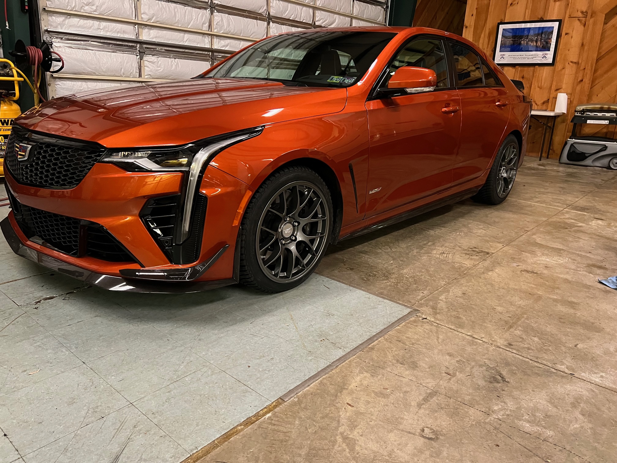

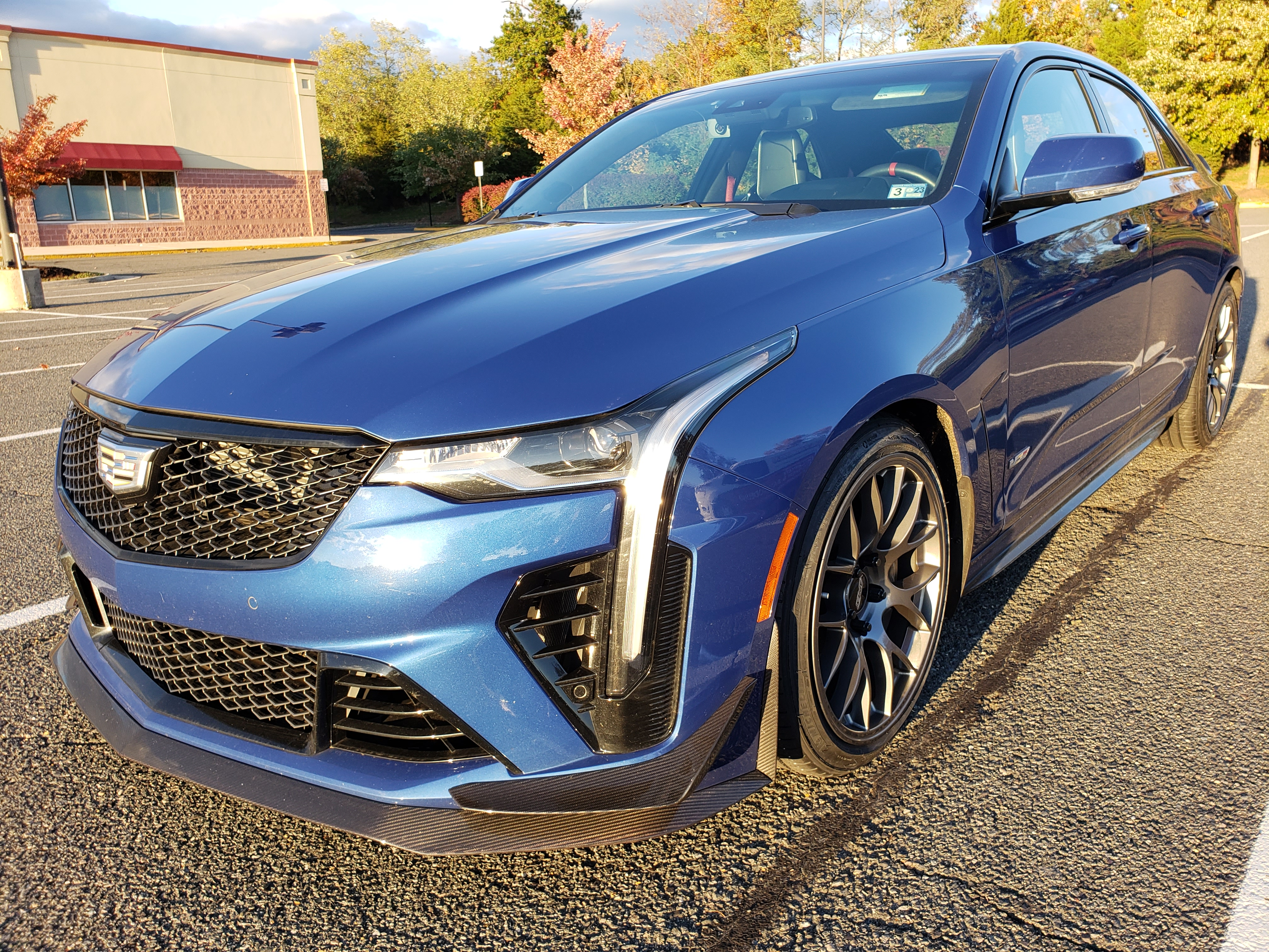

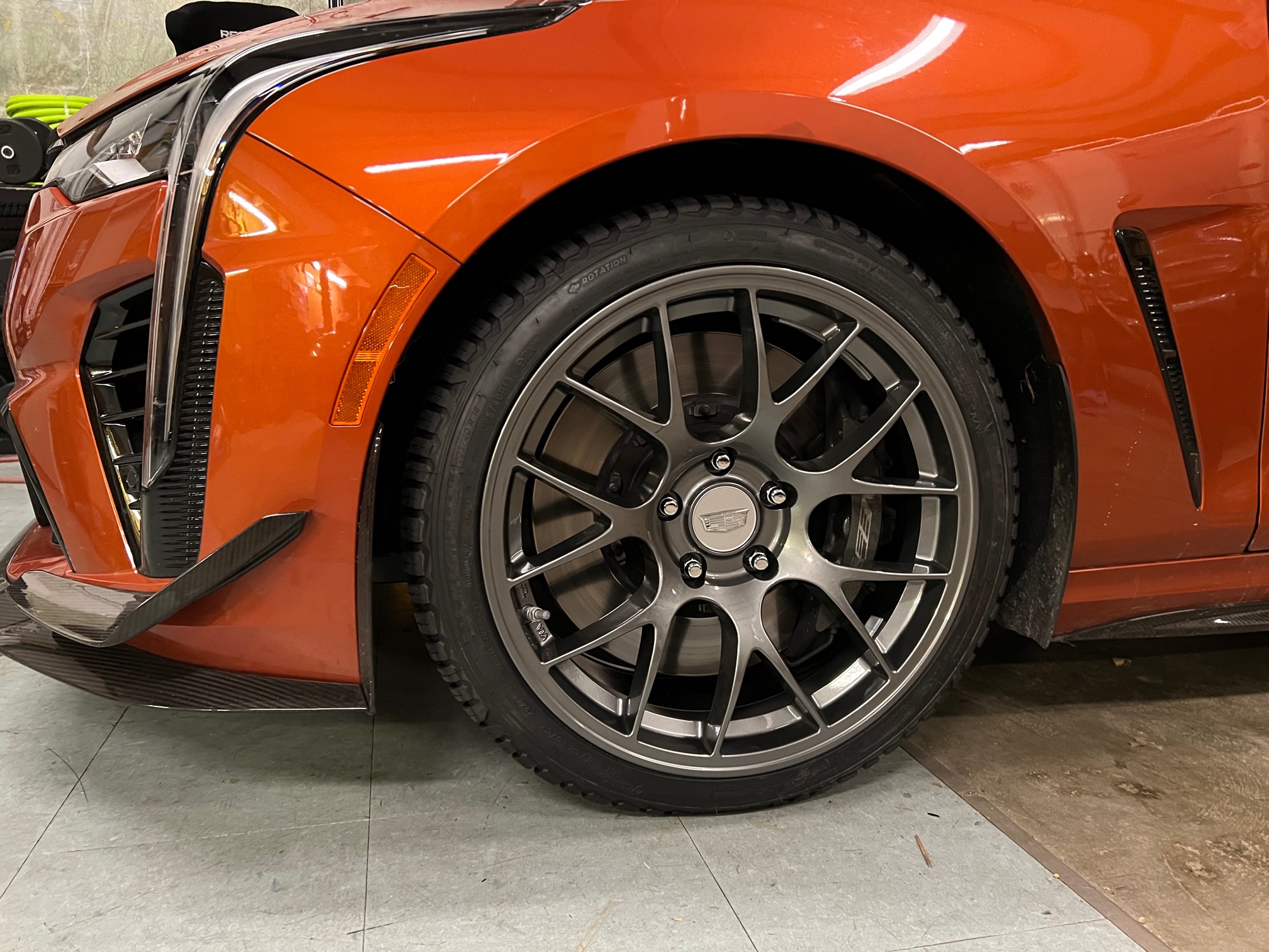

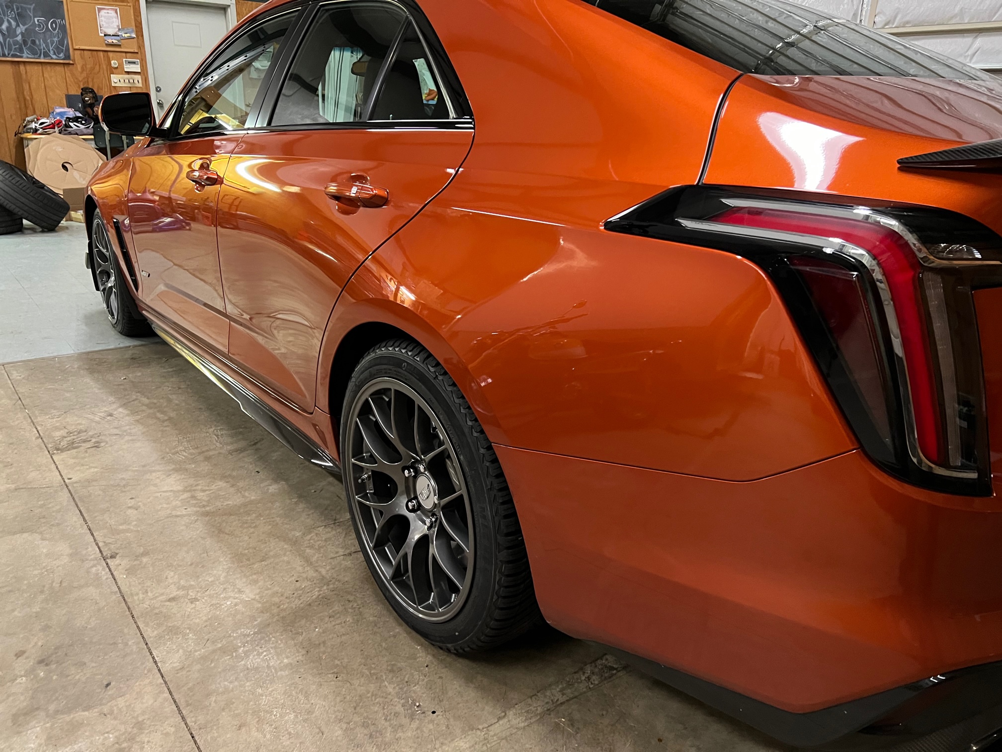

My newly installed winter sneakers for here in eastern Pennsylvania. As previously discussed on this thread, Apex rims (18x9 and 18X9.5, ask for Corey, he's been dealing with a few of us BW owners), Apex 3mm spacer up front, Apex centering rings, Michelin CrossClimate 2, and Gorilla lug nuts. The Michelins are 225/40/18 and 245/40/18. Narrower than our OE summers but the same diameter/circumference. Exactly how ya want 'em. Gobs of stick in the cold wet (which is most of the time) and are reported to perform admirably in the snow, in case I get surprised halfway through a workday. For real shit weather (a handful of days, maybe 3? 4?) I have a Subaru Crosstrek booted with the Michelin X-Ice.

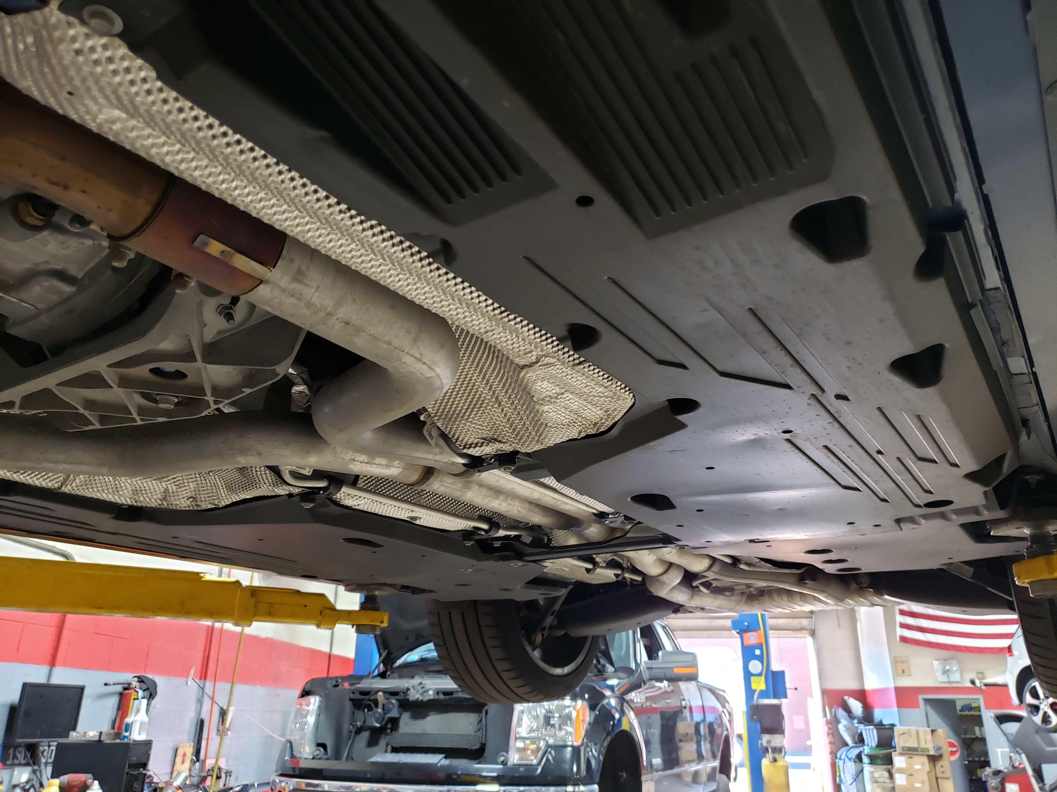

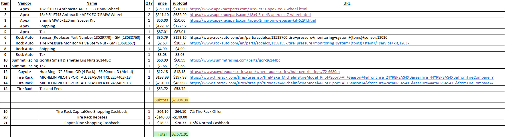

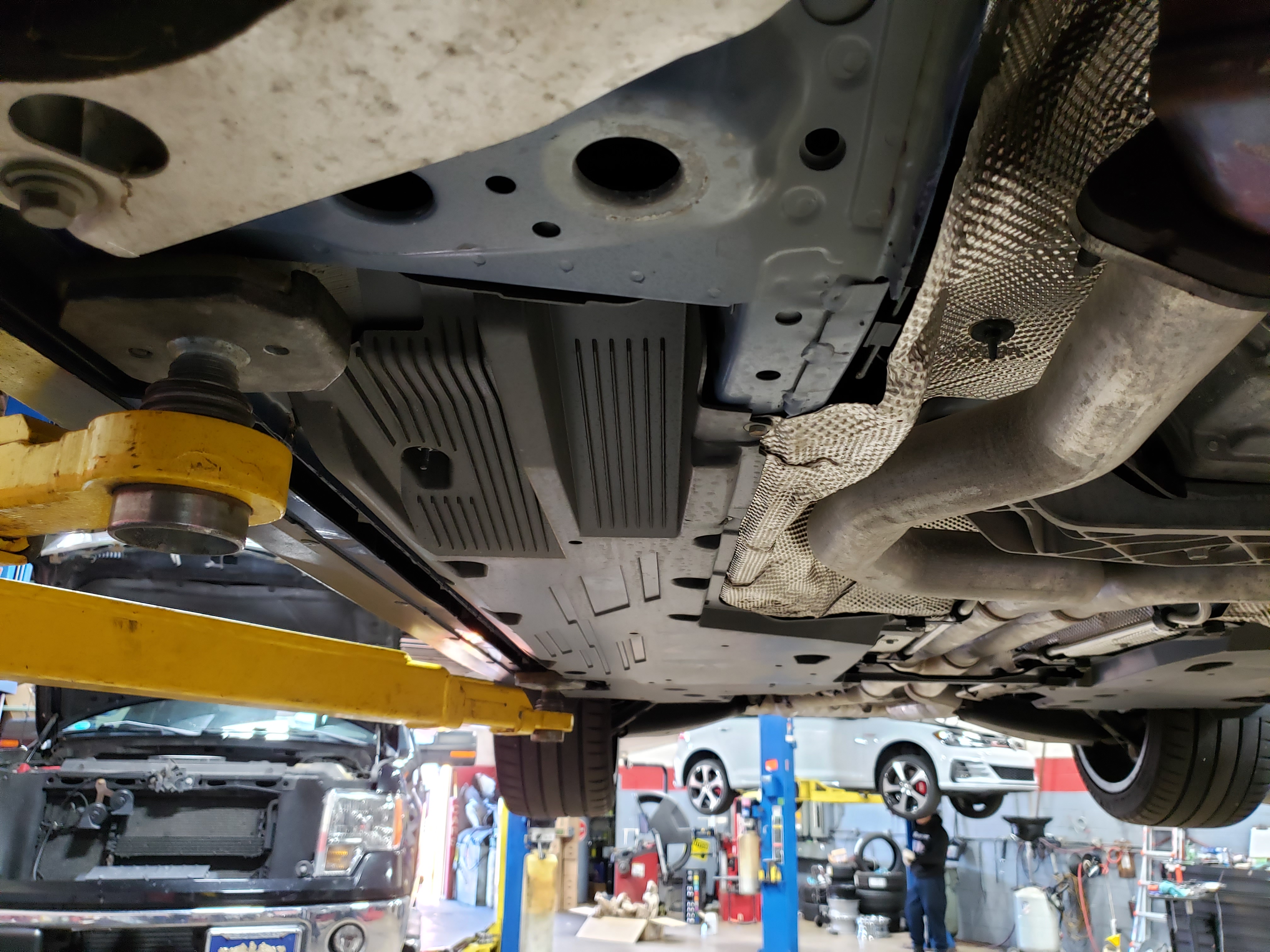

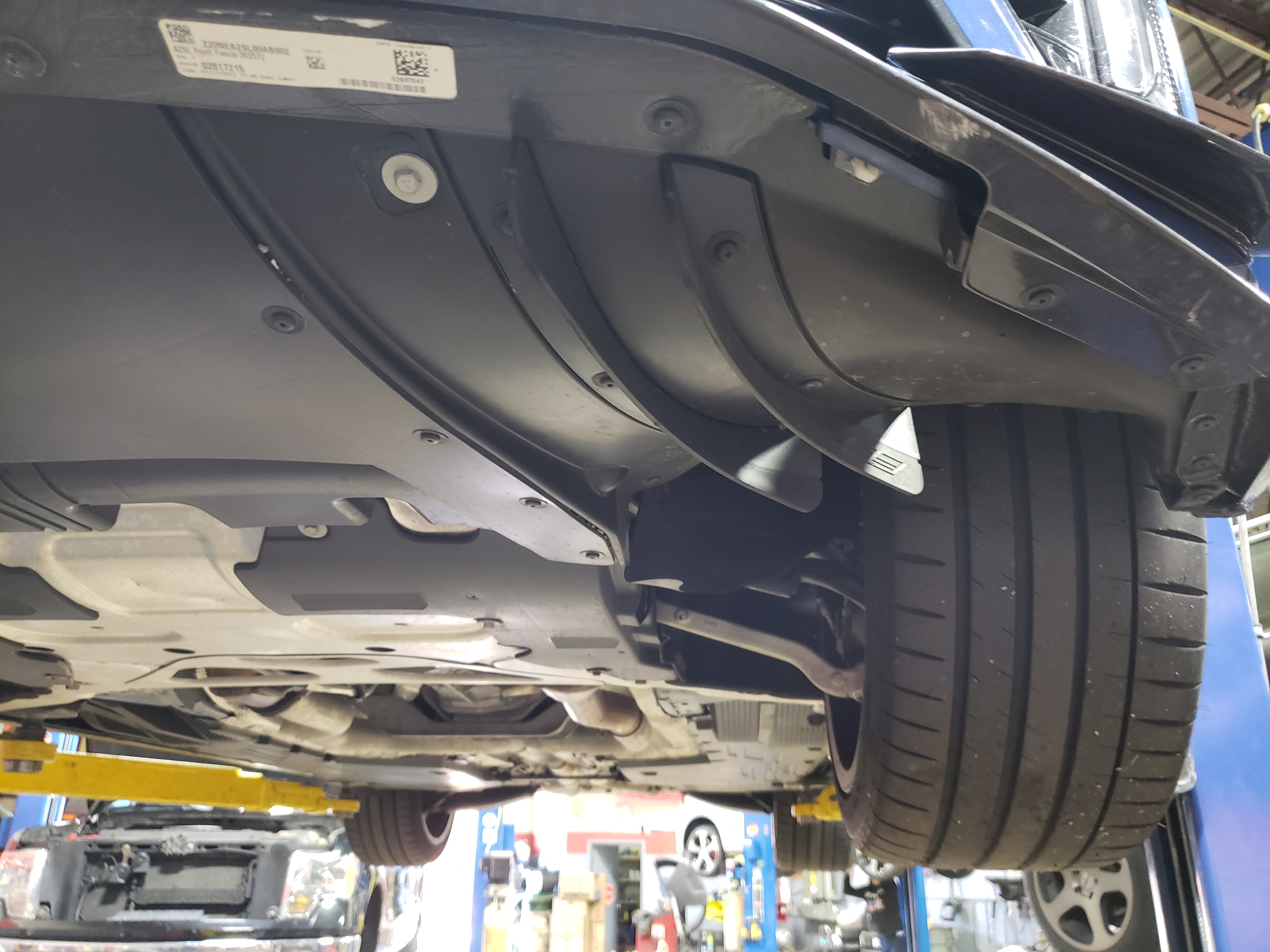

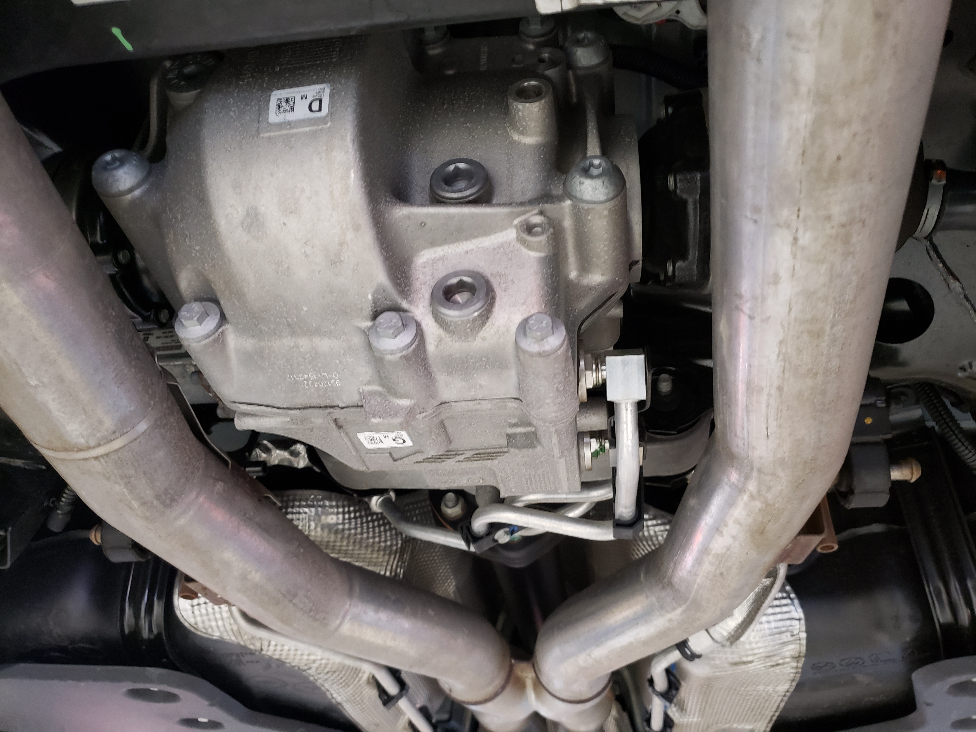

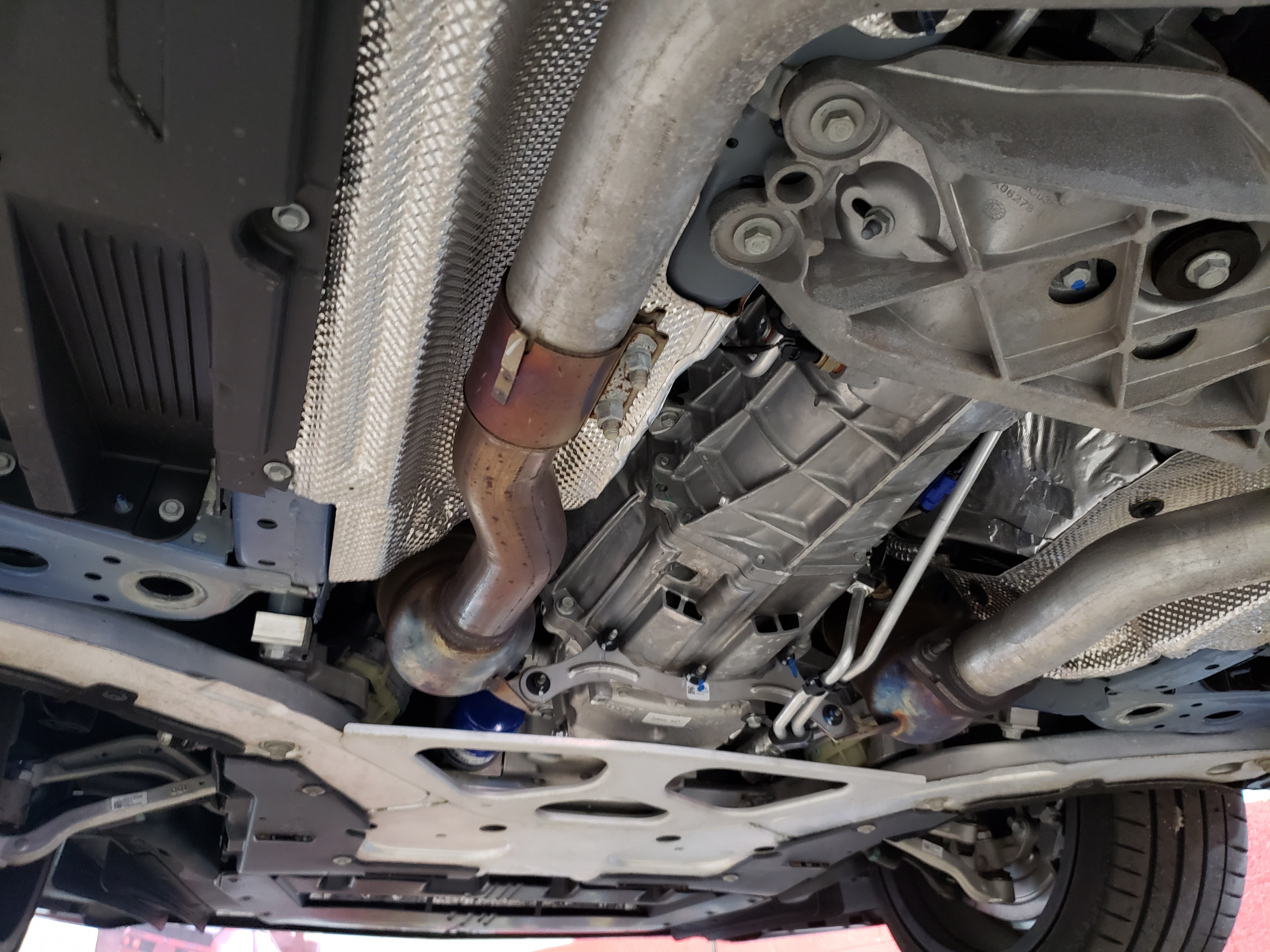

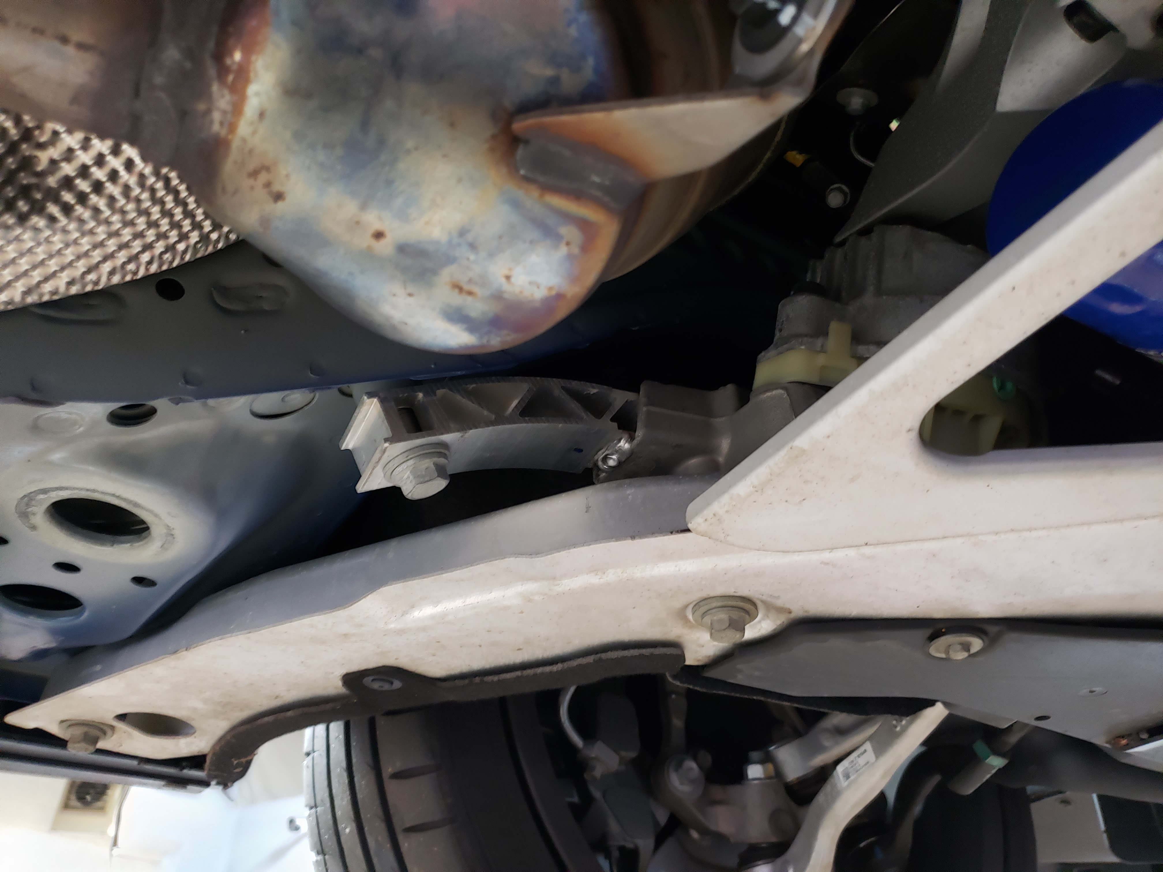

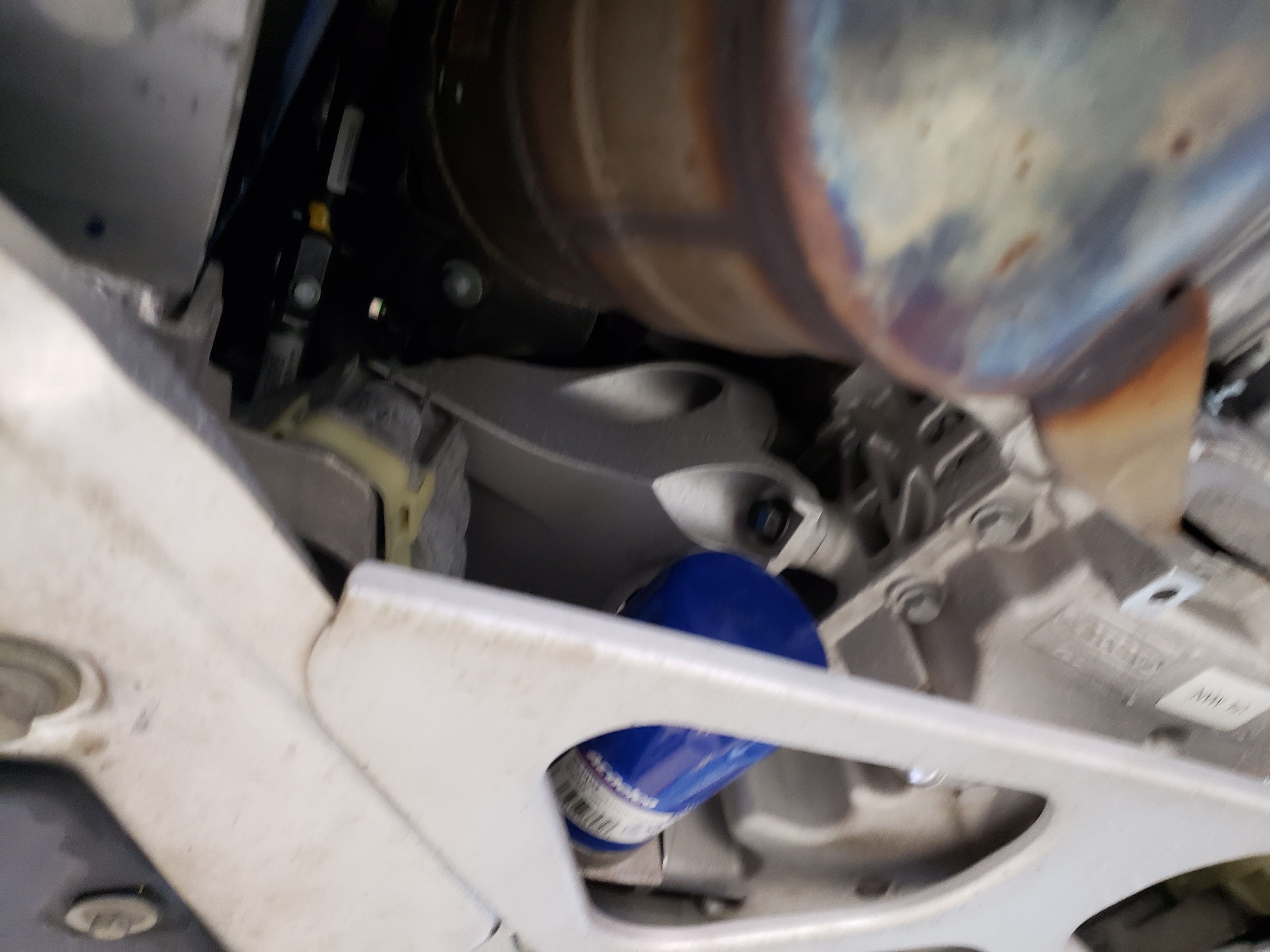

Mine came out to $2600 after rebates and cashback offers for a full set of Apex Wheels, 225/245 Michelin AS4s, and required accessories.
My local shop did the install and balancing for $120, and even threw the car up on a lift and let me take some pictures :).
I selected the Relearn TPMS on the dash cluster, and have had zero issues.
