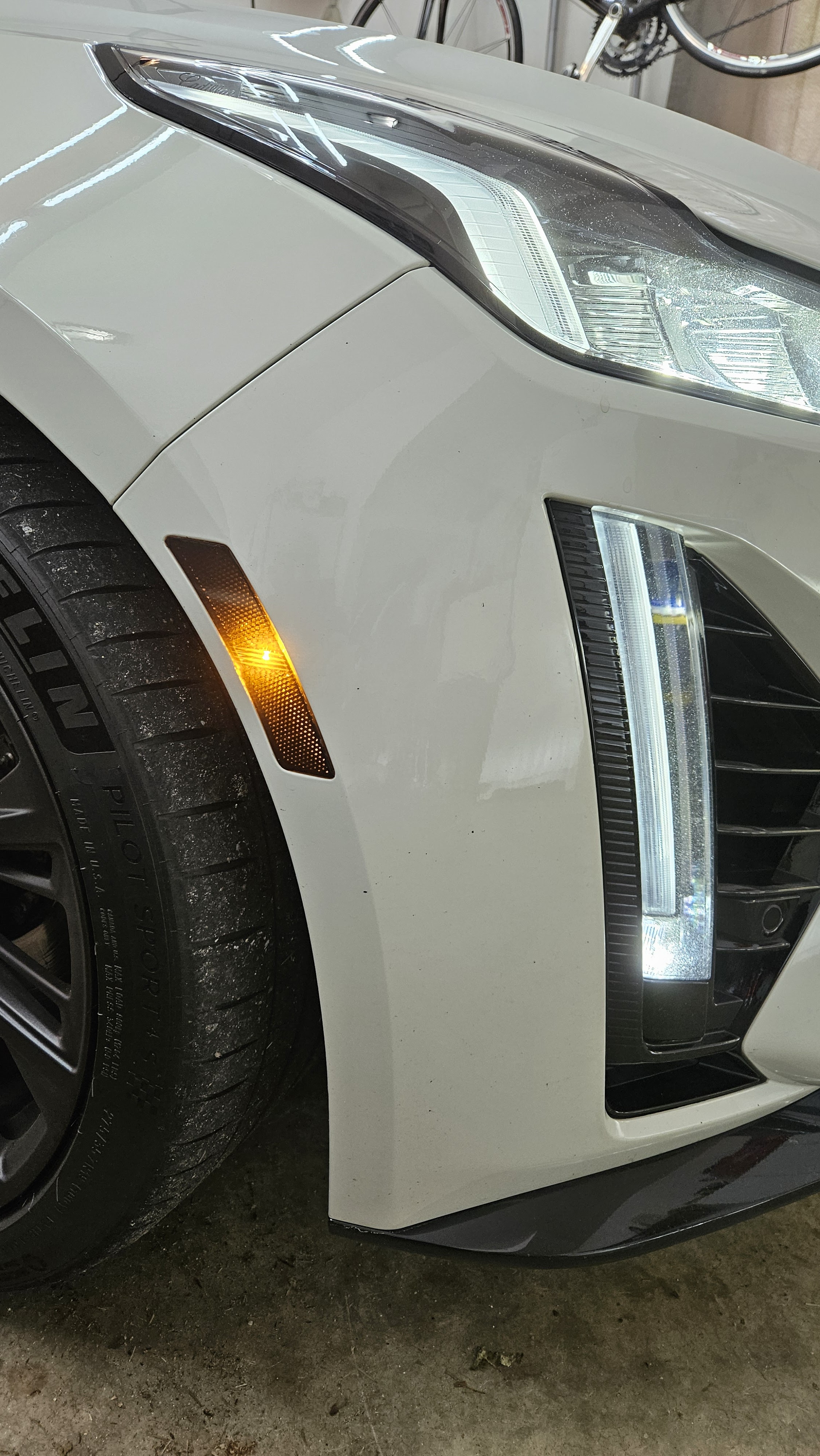

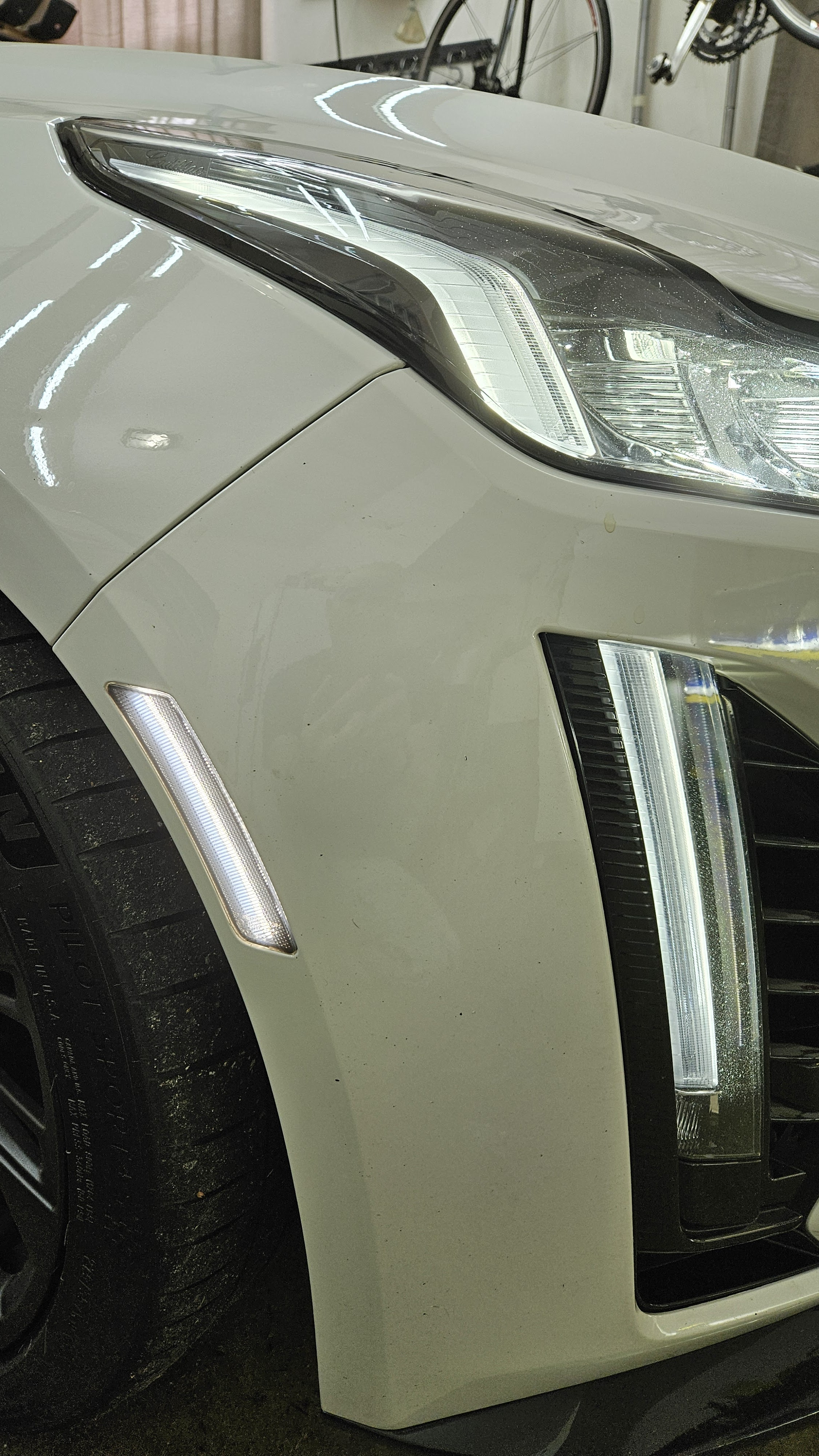

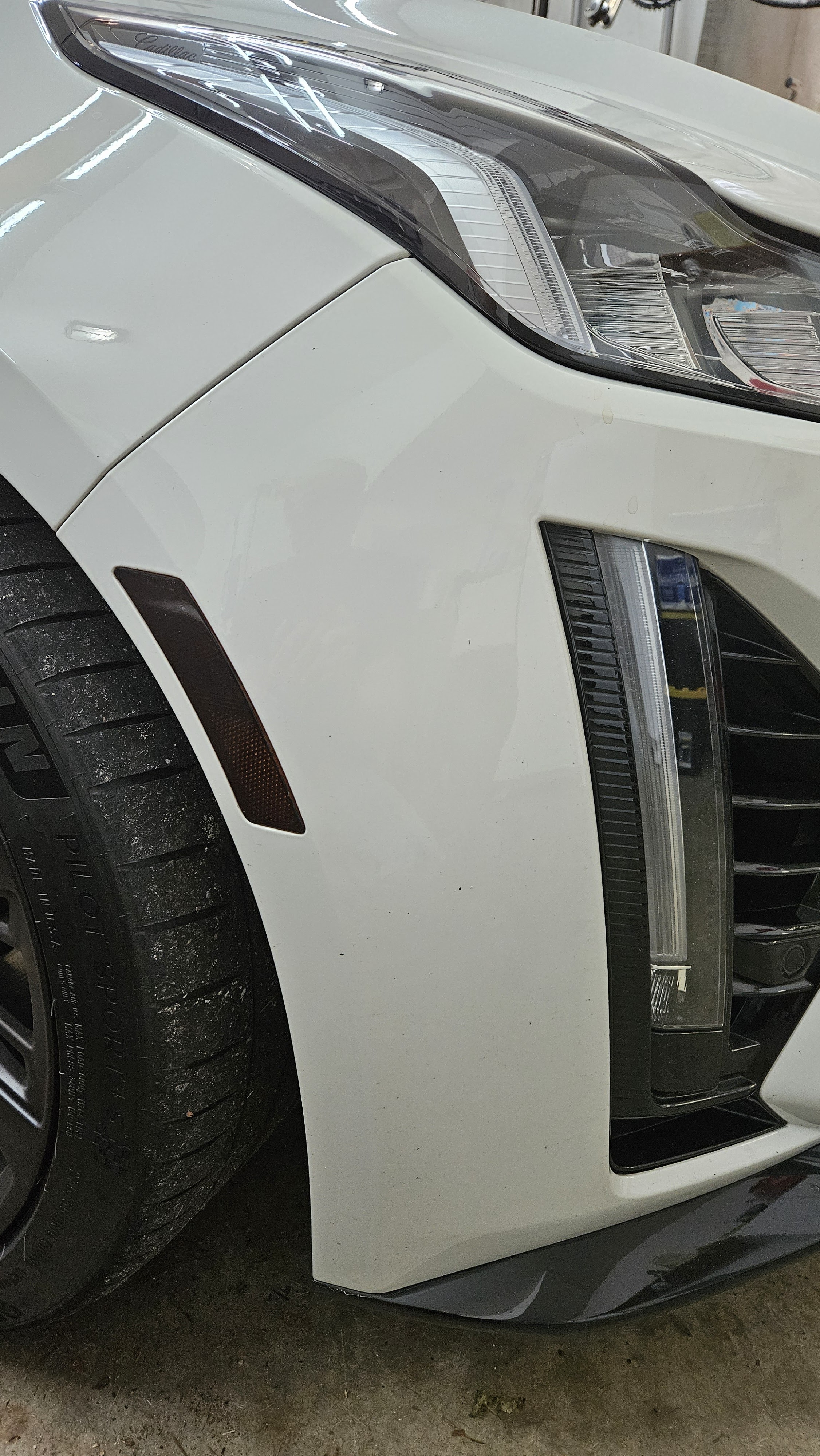

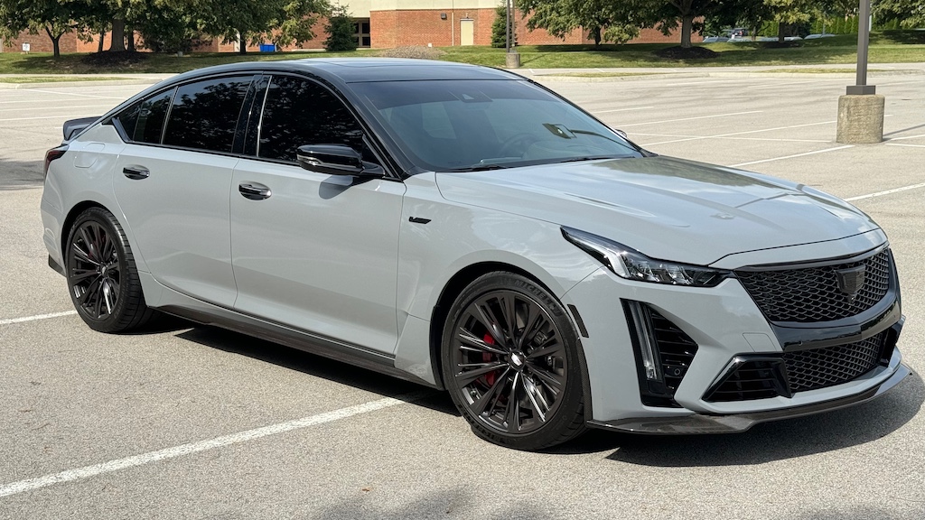

Just installed mine for the 5BW. I had the blackout film on the sidemarker lights before so it still looks the same when the light is off. But clearly, it looks different & better (IMHO) when the light is on.

Still can't decide between Amber and White. Does the white have the same color temp as the front DRL and/or headlights? I did black markers with white on my Mustang and it was more dirty white looking than the color of the DRLs.
My car is orange blaze at that, so the white would break that up a bit I think, too.
As you can see in the photos I posted, the color temp is near exact.

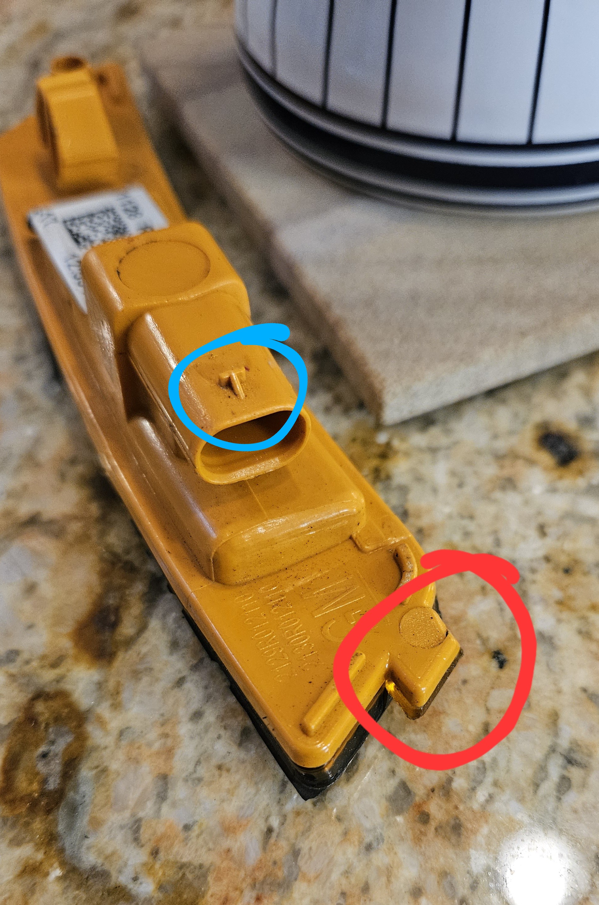

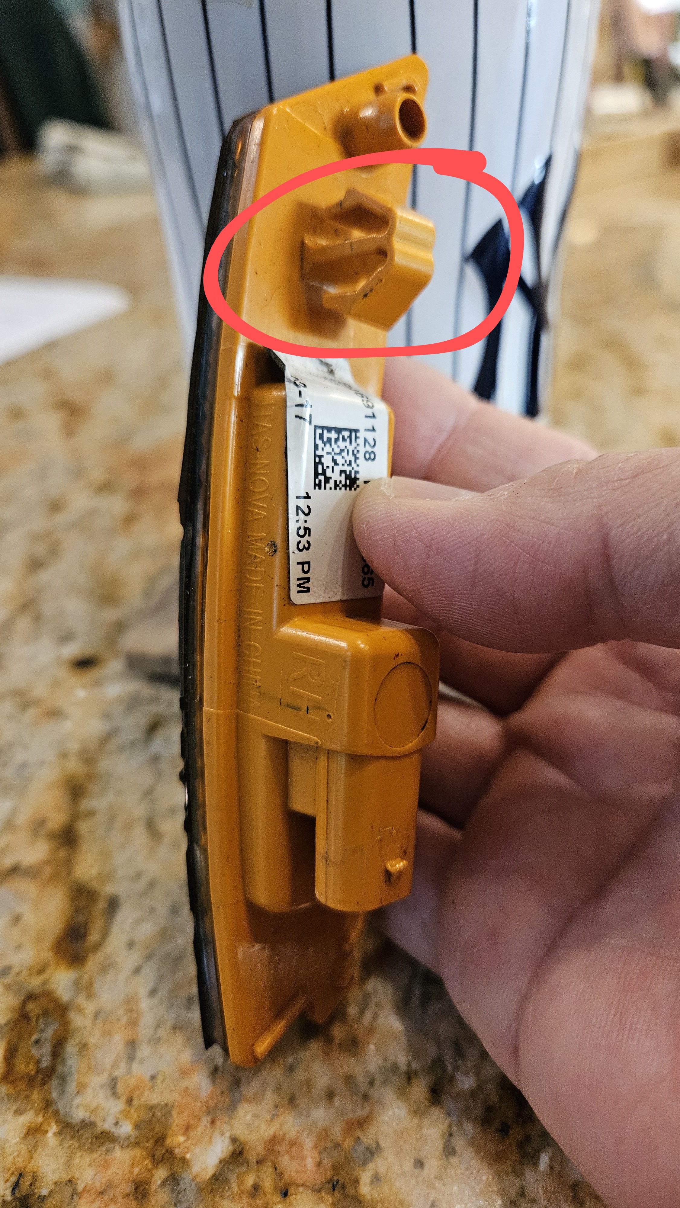

  • Turn the wheel all the way in to give yourself room to work on the inside of the fender well. (ie, If working on the px side, turn the whelel all the way to the LEFT.)
  • (at least on the 5BW), starting from the bottom of the fender liner, remove 4 of the screws holding the fender liner in. The screws take a T15 torx.
  • peel away the fender liner from the edge of the fender with a plastic gapping tool. A screwdriver will also work but gotta be careful with the paint on the edge of the fender.
  • Now this is the tricky part: The light is held in at the top by a clip & the bottom is held in by a little tab that sticks down further than the edge of the light. (Red circles.) Gotta squeeze the clip together as you push the top of the light OUT (not IN)
  • The wires for the light are very, very short so do not attempt to pull the light out any further than the wires will allow.
  • Once out, disconnect the harness by inserting a small screwdriver into the retainer to release the safety part & then just below that to lift up over the retainer tab. (Blue circle)
  • Install by reverse procedure but turn the car on to make sure you've got the harness seated correctly & the light working before pushing the light back into place in the fender.
Hope this helps!
(The light in the photos are the ones I removed but the ones installed are exactly alike in construction but black in color.)
