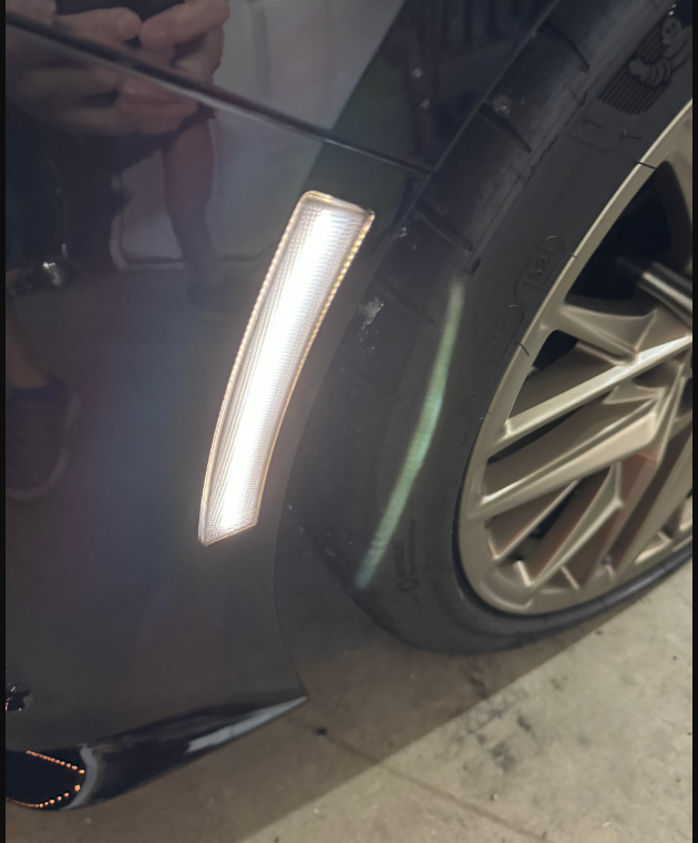

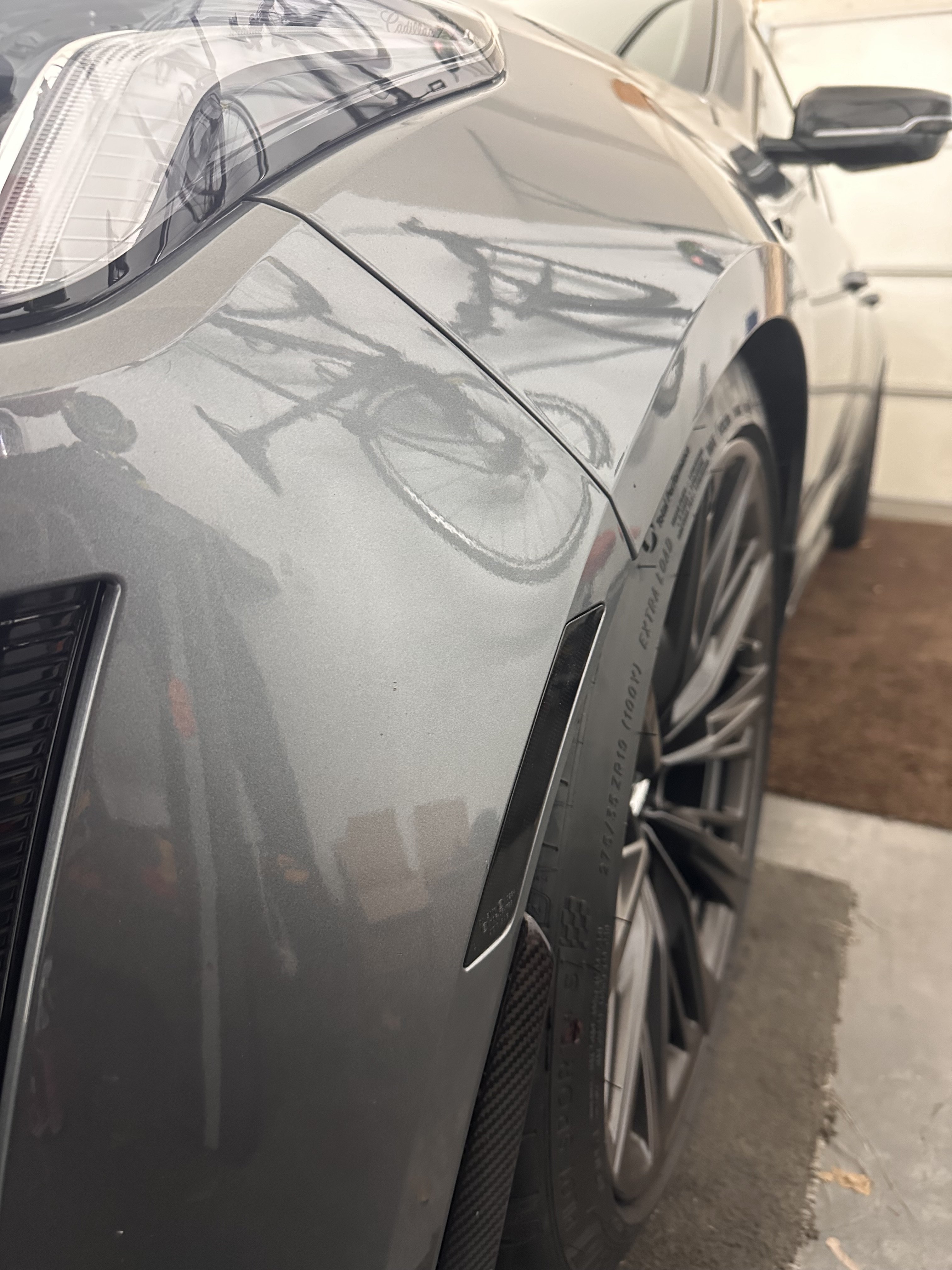

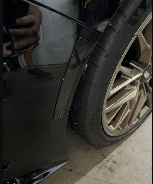

The savage Cadillac ones are legit, the lens plastic is tinted not some spray on or film and the amber light output is really nice. These things are worth twice what they are selling for. Get ‘‘em now while they last.
Pics

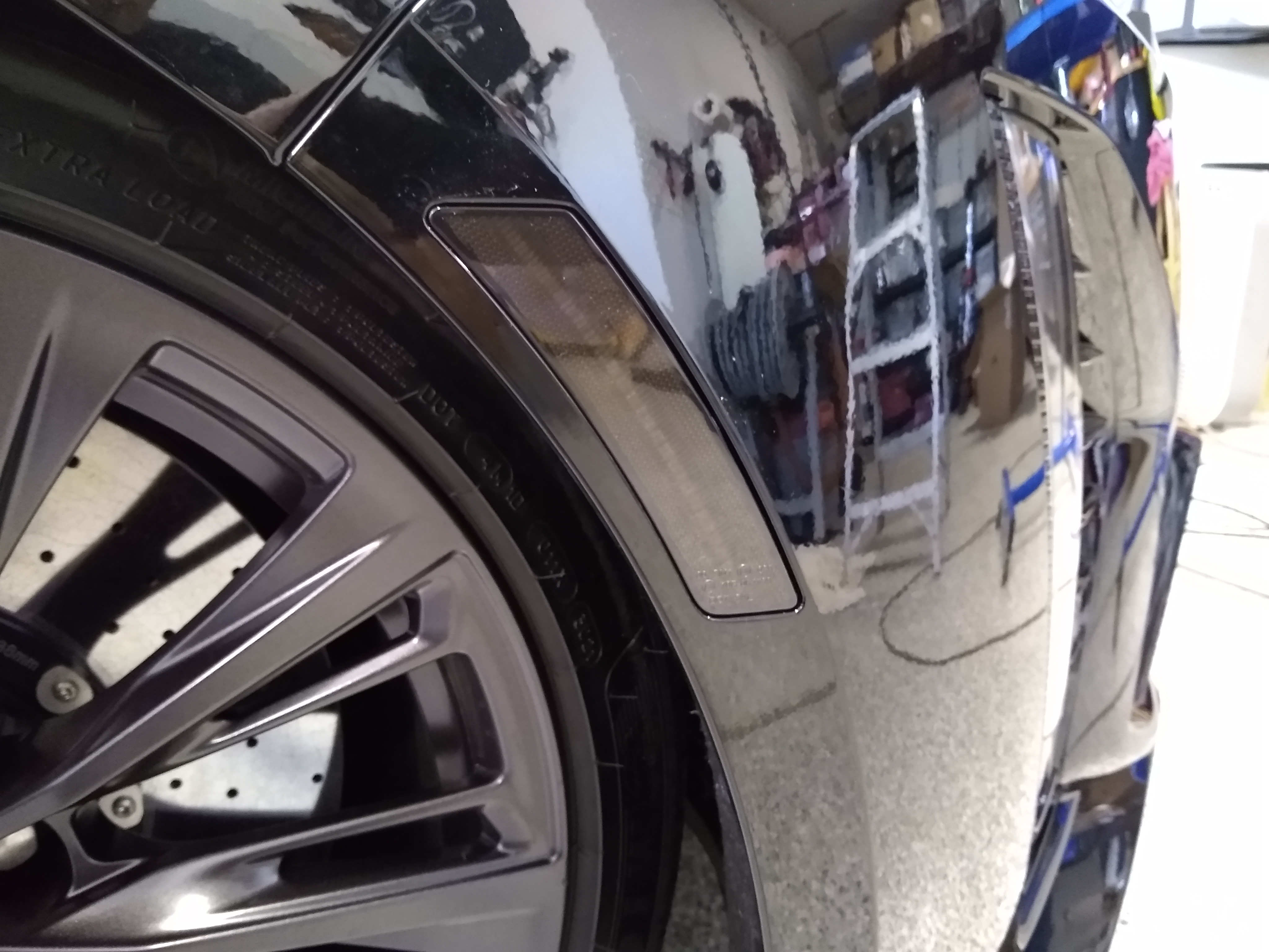

$15 eBay tint:
But I must admit, the ones from Savage really do look nice!

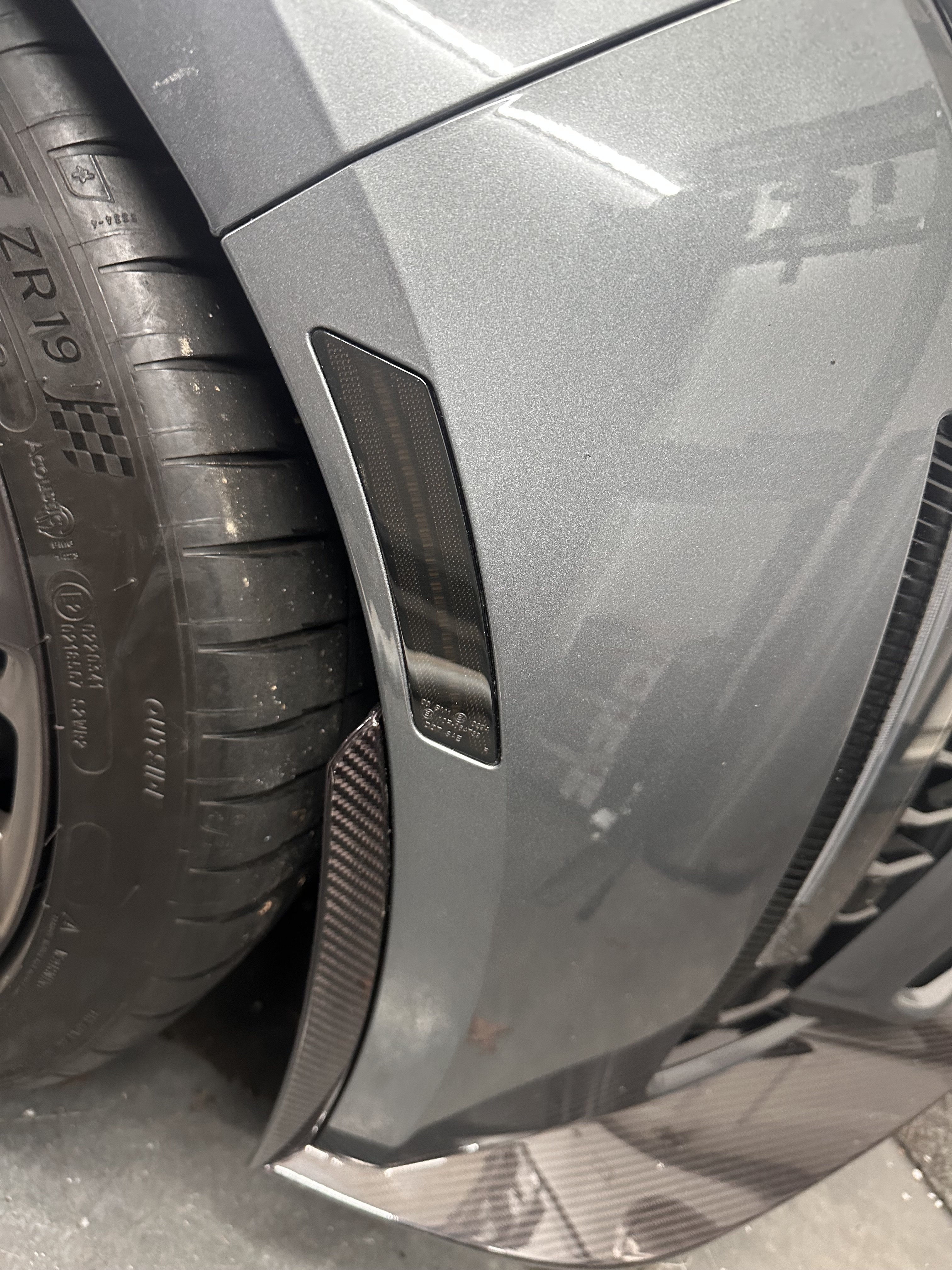

Best bet is take 1-2 clips off from the inner splash shield/liner so you can get behind the lamp. Get a pry tool to push on one side of the clip and you should be able to push the other side with your finger. When you look at the back of the lamp you can see how only the bottom clips in and the top has a tab

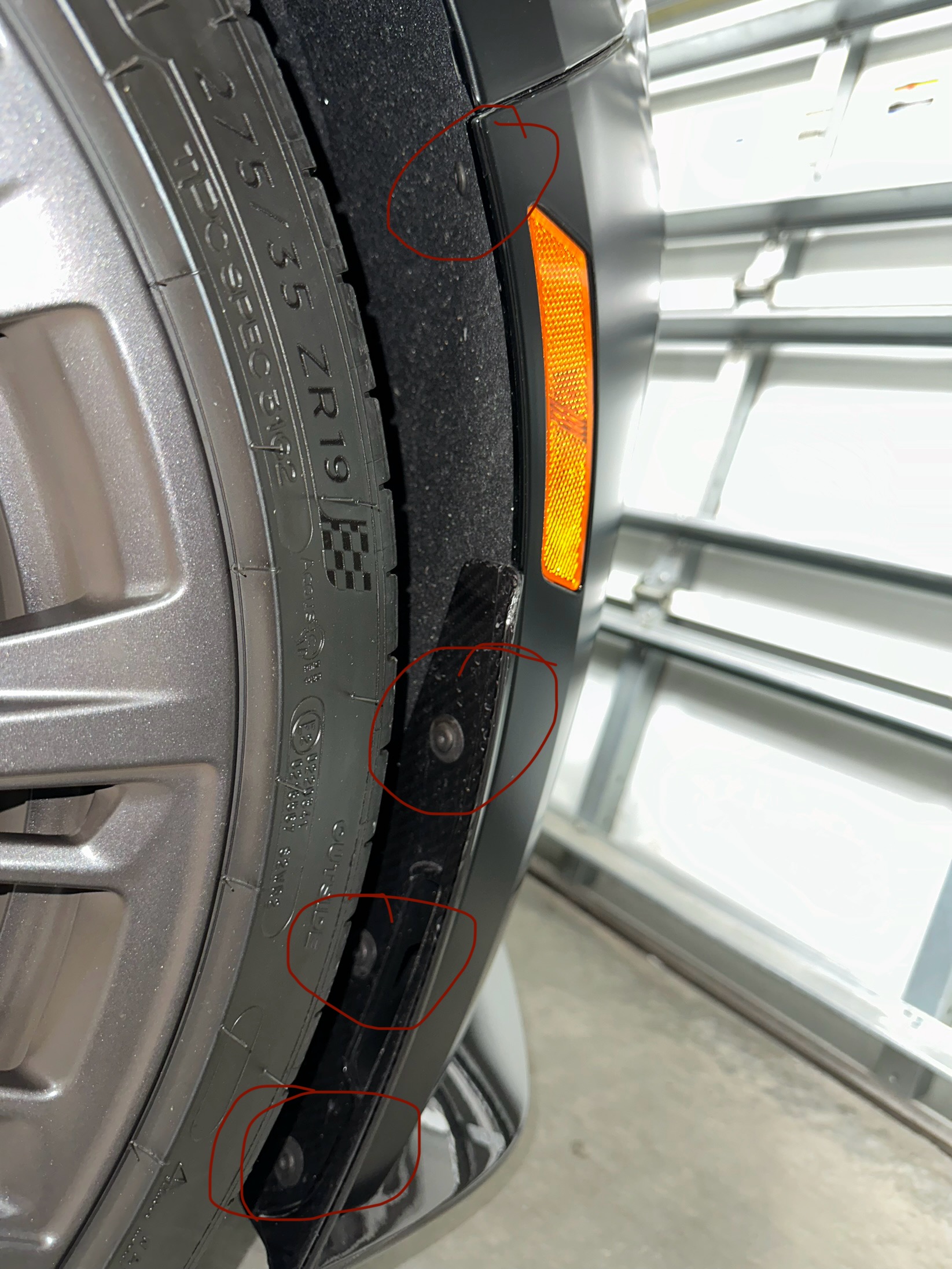

I think I bought the same ones and I’m ready to install. I see that you have the carbon fiber front lip, i do too but nit sure if I have to unscrew the bolts that’s holding the carbon fiber to get to the side marker. Did you have to unscrew the screws that’s holding the front splitter to get to the side markers?
Just did a CF splitter install. You need to remove the wickers (3 screws) and the screw above that on the fender liner.
Thanks these 4 screws correct? Then I should be able to replace the side marker?

Those are the ones. Once you pull the liner back use a flashlight and you’ll see what’s going on. The wiring harness is also attached with a plastic tab to a white piece. I pulled the harness free of that to get a little more slack in the wire. Then push the tabs on the light while pushing it outward. The light will come out barely with the harness still attached. Then you’ll see how the connector works. It’s a double catch. Disengage the red tab. Then insert a small screwdriver under the connector. It’s hard to explain and I didn’t take pictures of that step. Look at the new light you’re about to install and you can see how that secondary locking works.

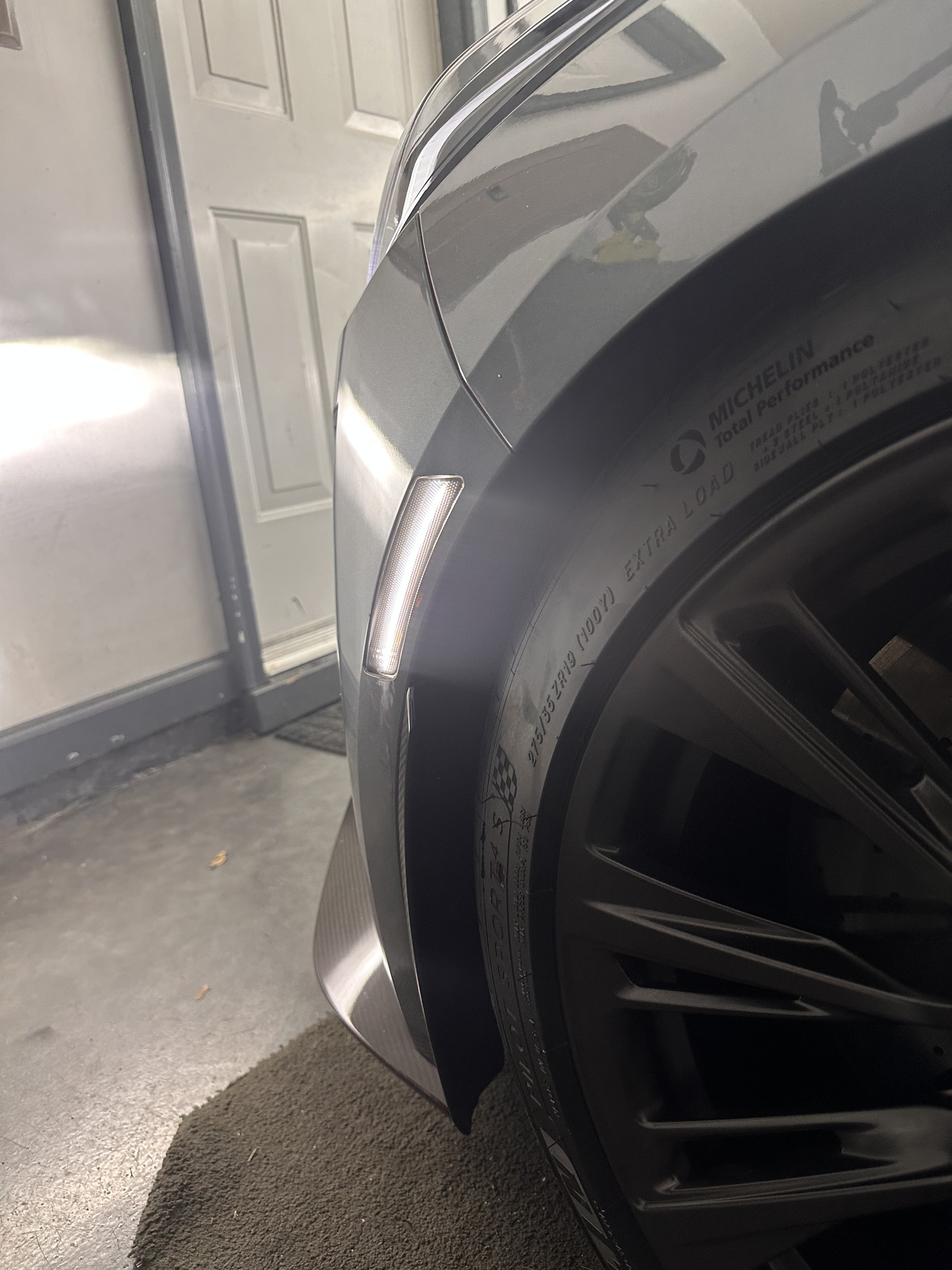

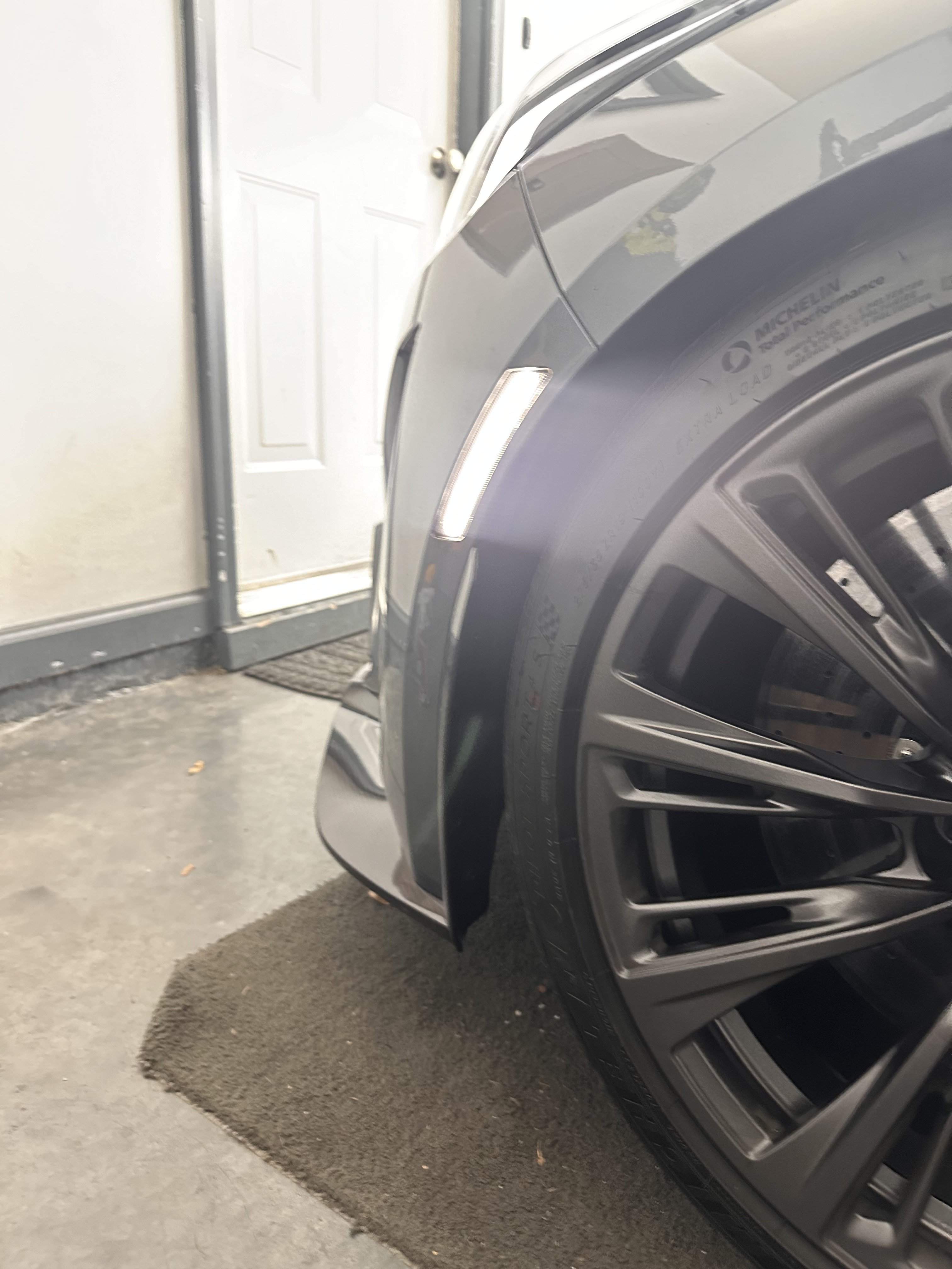

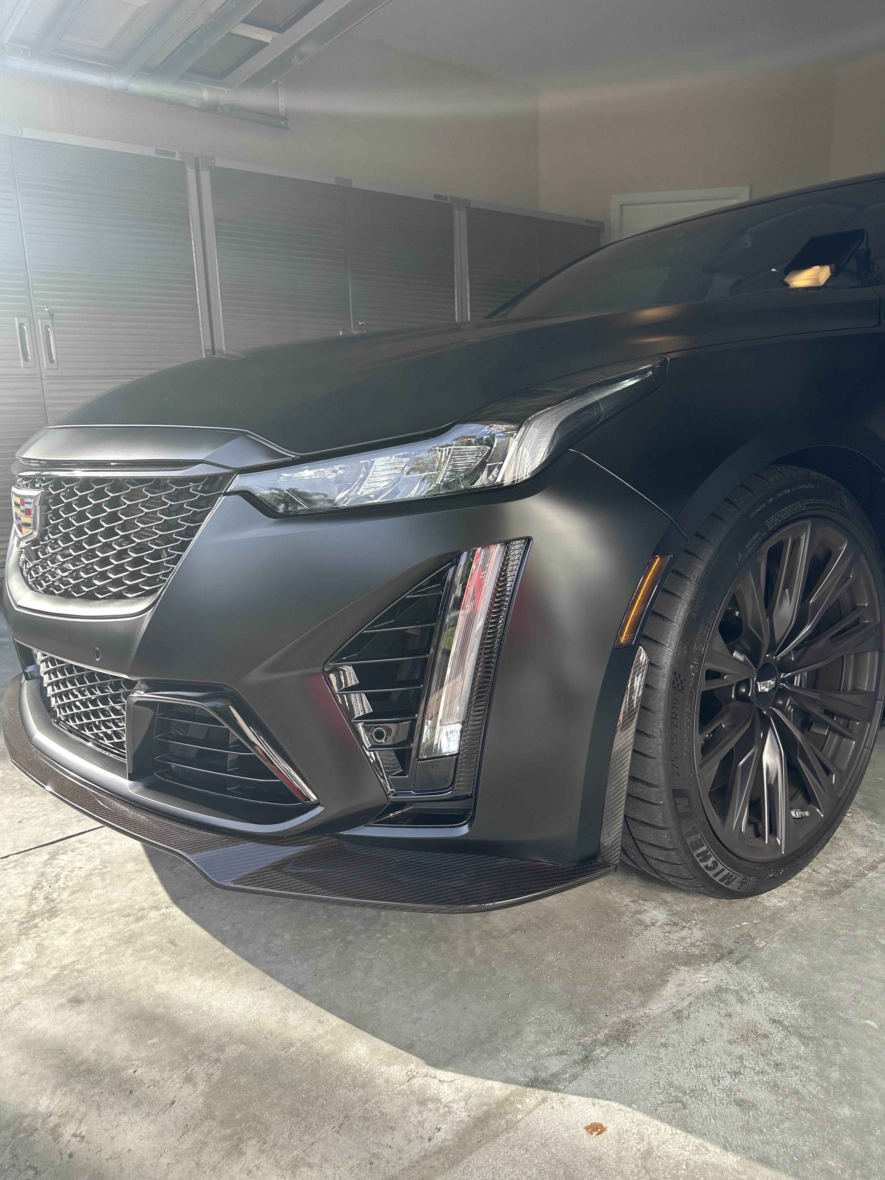

Thank you. I got it done 🙏🏼

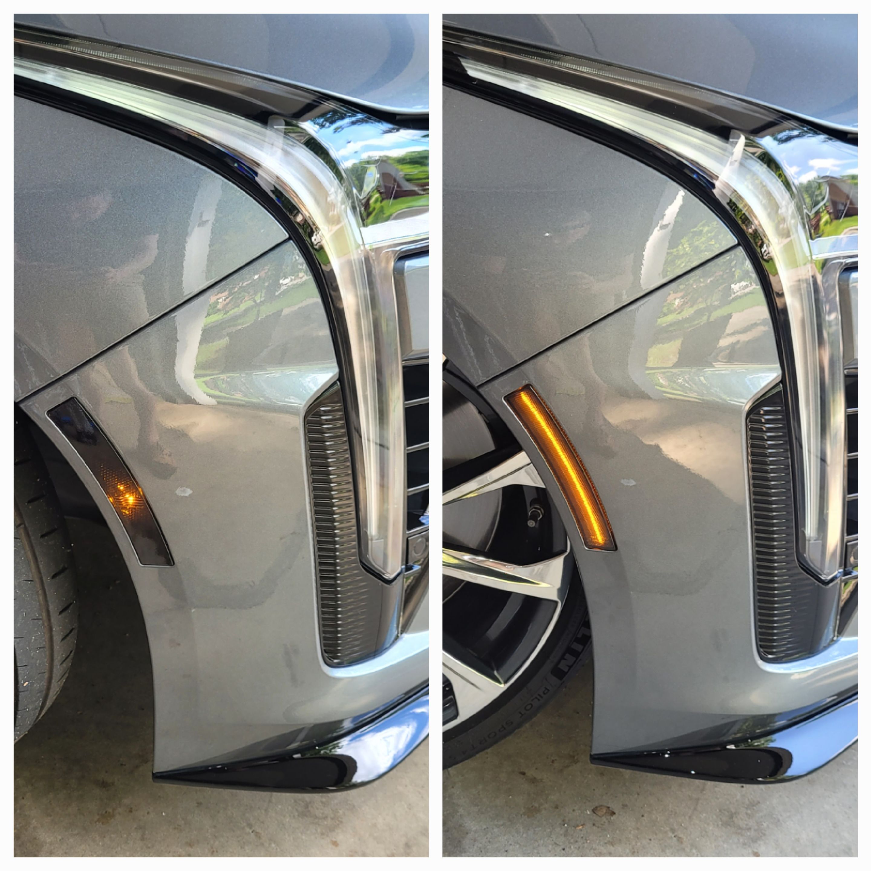

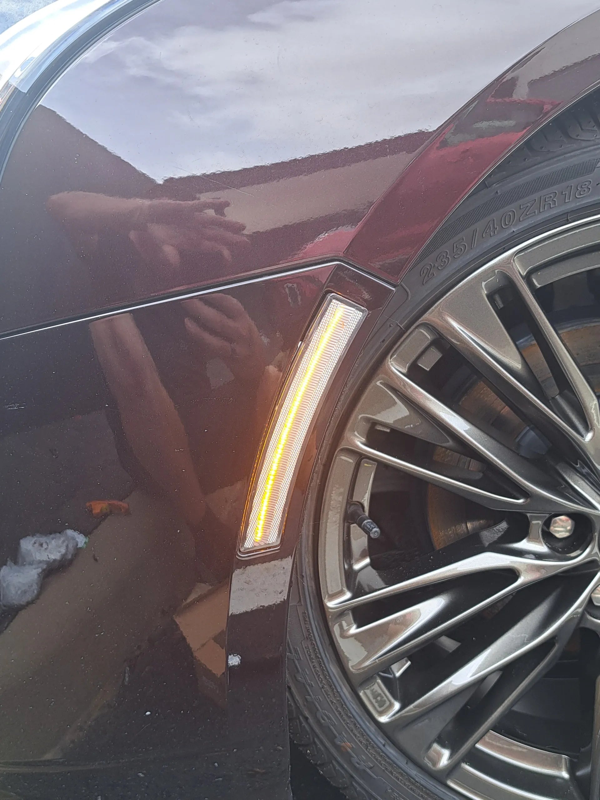

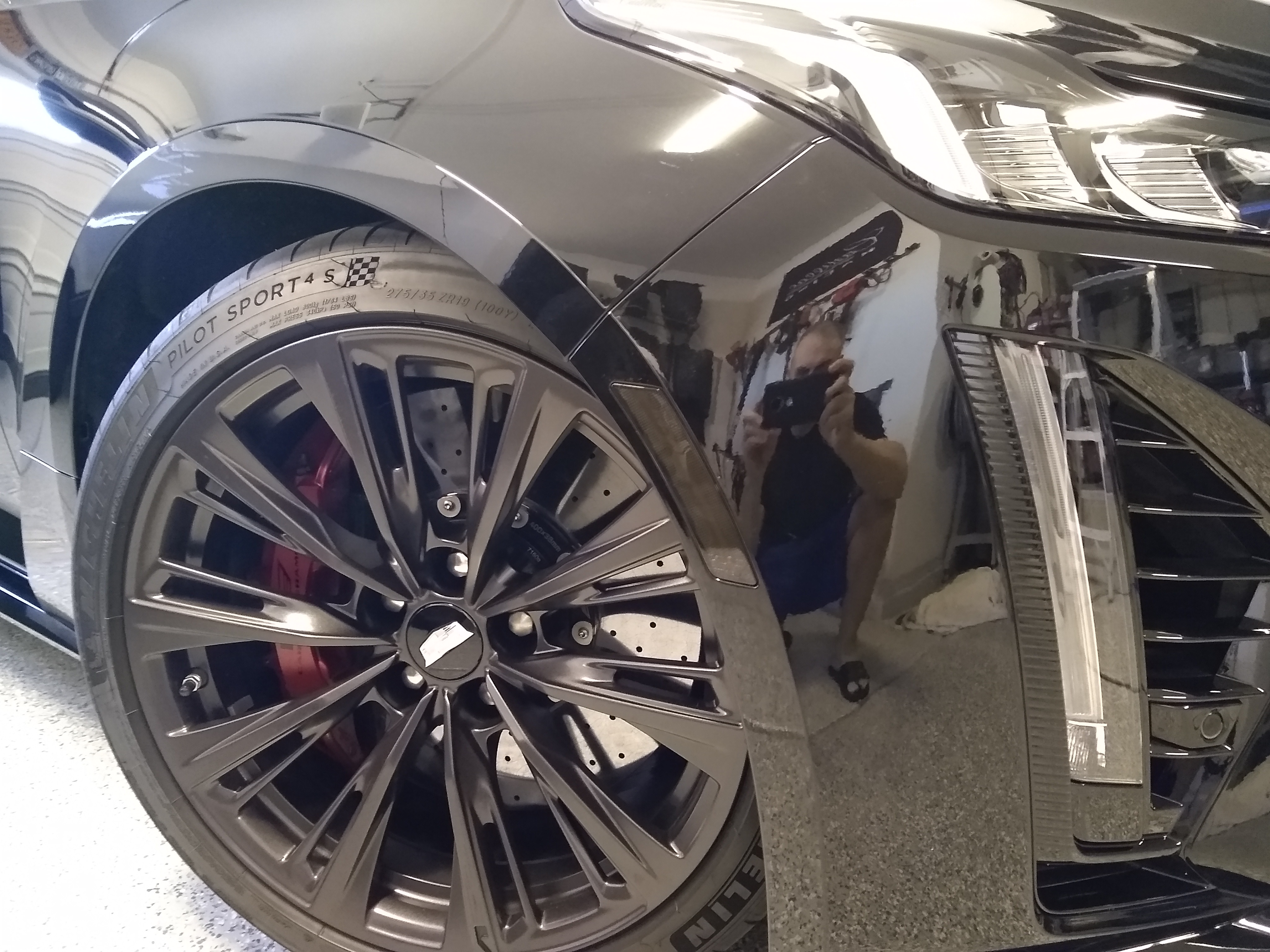

These seem to be identical to the Savage Cadillac part. I like it.
