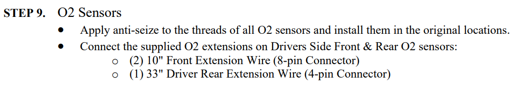

The one in the picture looks to be the O2 sensor that plugs into the sensor located in the cat or the rear most sensors. Here is a screen shot of the instructions for the Kooks headers. By looking at it, I'm guessing the extension is not needed for the passenger side rear, but should be used for the drivers side. Hopefully that helps.
