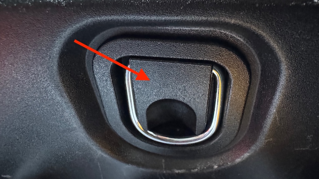

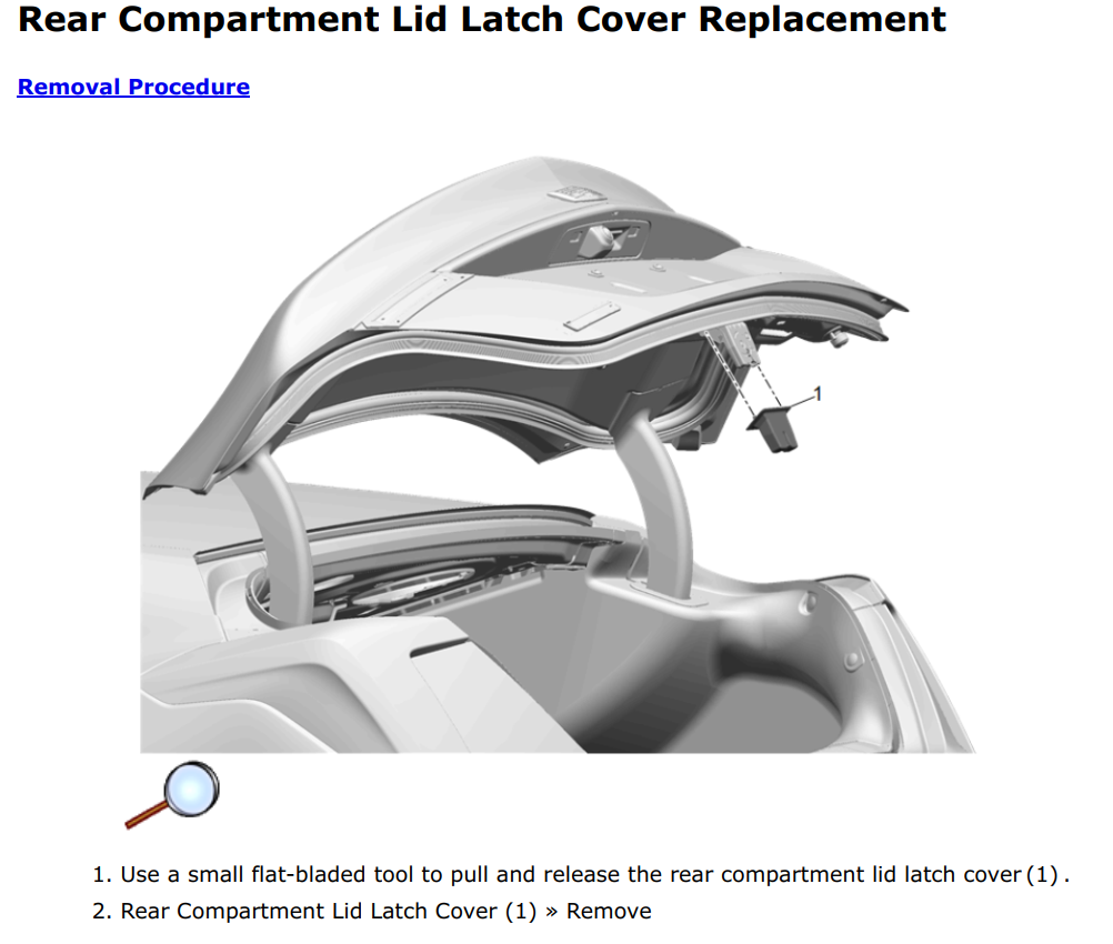

I took mine off last year when I installed the sequential brake/signal lights. I am pretty sure that you must pop off the square black cover where the latch is. You will see a very small notch. Then IIRC you will see some bolts. Also, you must pop off the covers where the cargo latches are for more bolts. Mine were tight as hell and the socket had to be hit with a hammer to break the torque, then you can pop the black long cover off.

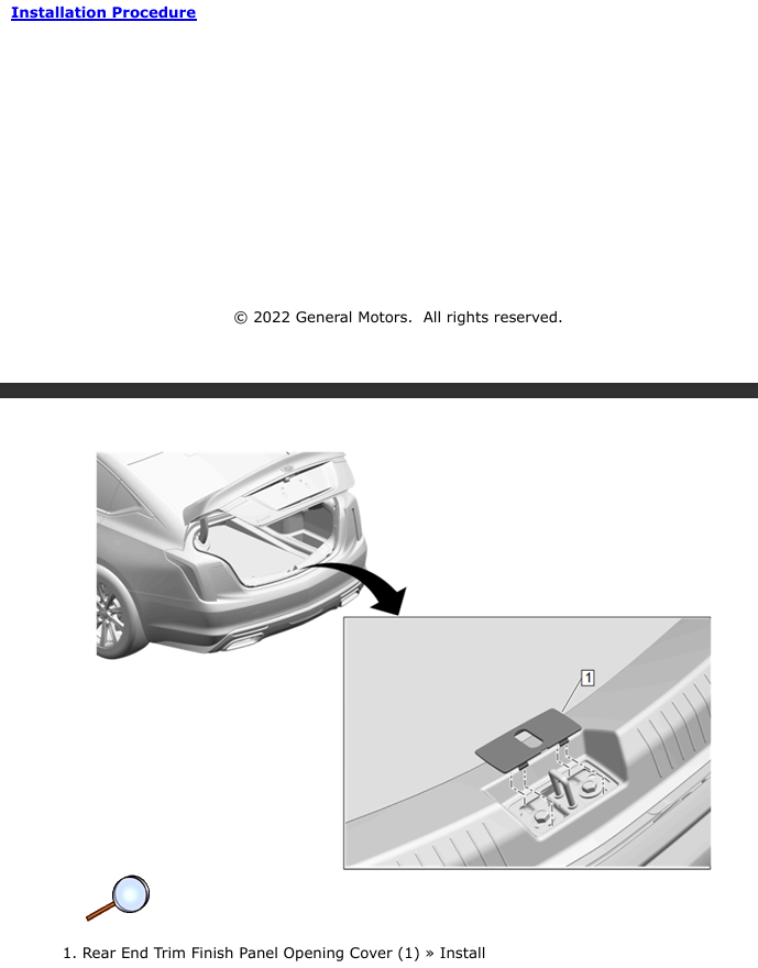

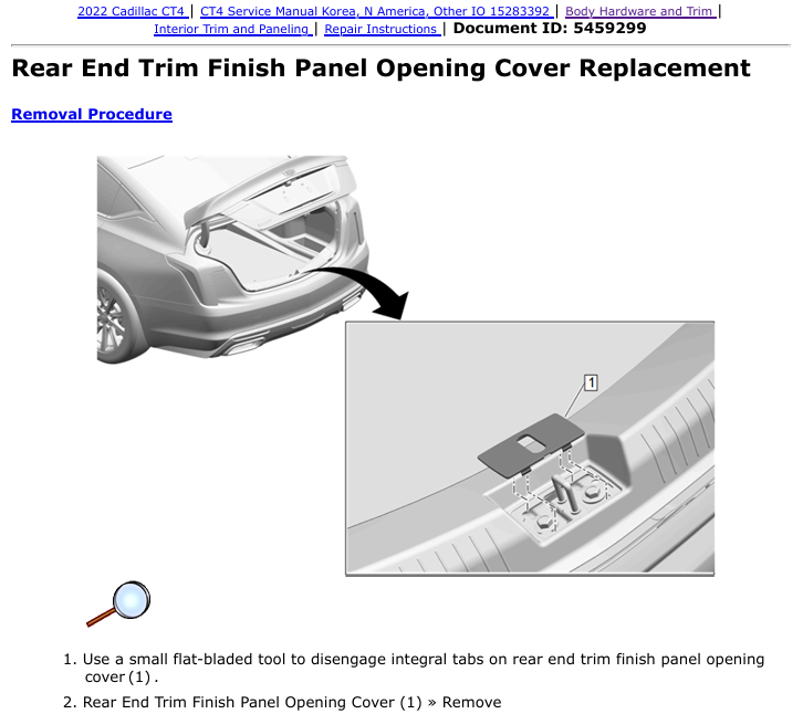

They should download when you select them. But here are image snapshots of those pdf files:

Squeeze the sides of the plastic cover and pry off with a small screwdriver or plastic trim tool. The bolt is a T40 torx I think. Then pull panel straight up. Clips hold it at the horizontal back edge.
Thank you. Your post helped me determine what plastic cover to pop off and yes it is a T40 Torx. I had to give both Torx bolts one heck of a yank to break them loose.
