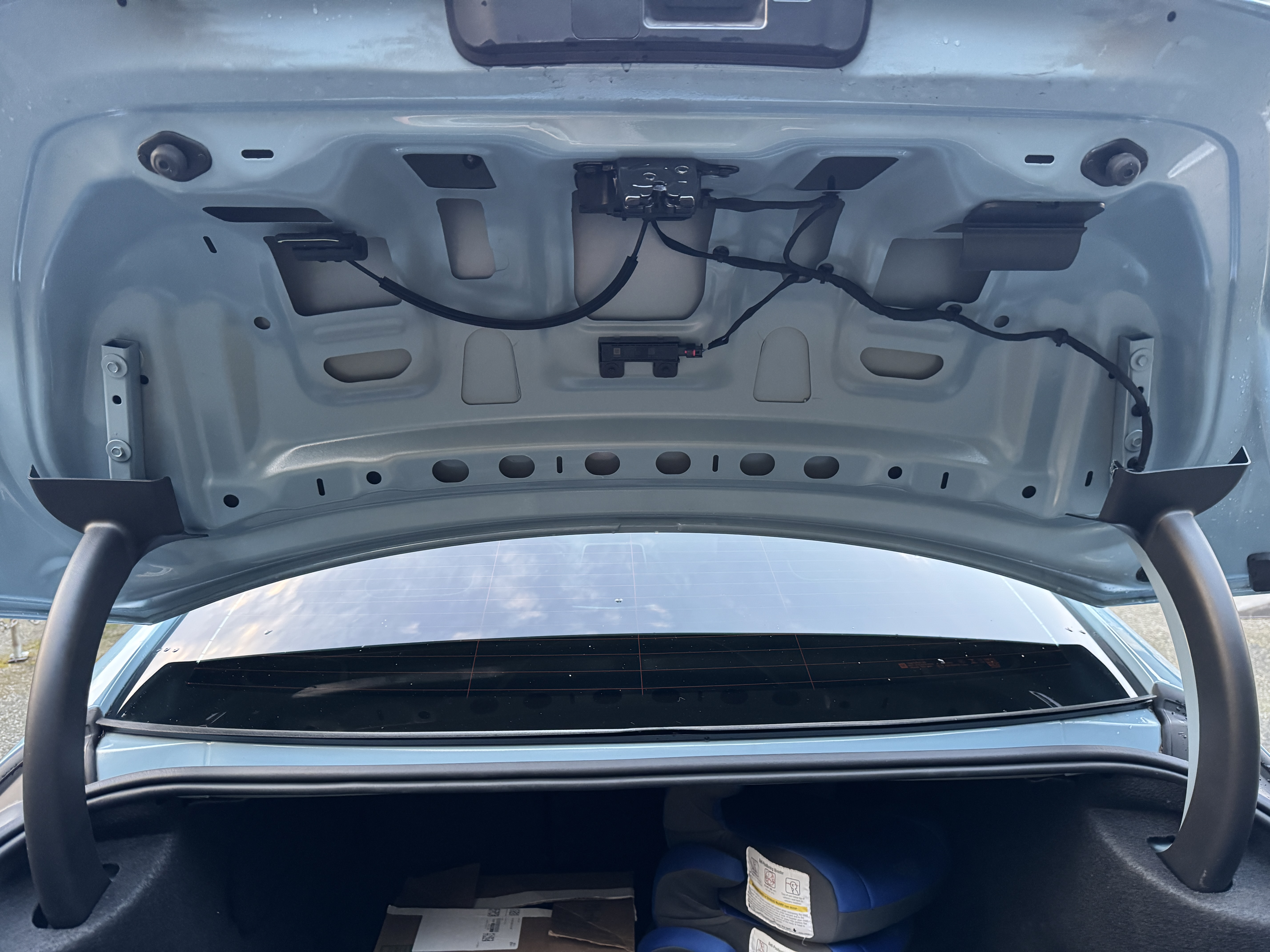

Rear emblem I believe requires removing the trunk liner. I didn’t try to do it without that step.

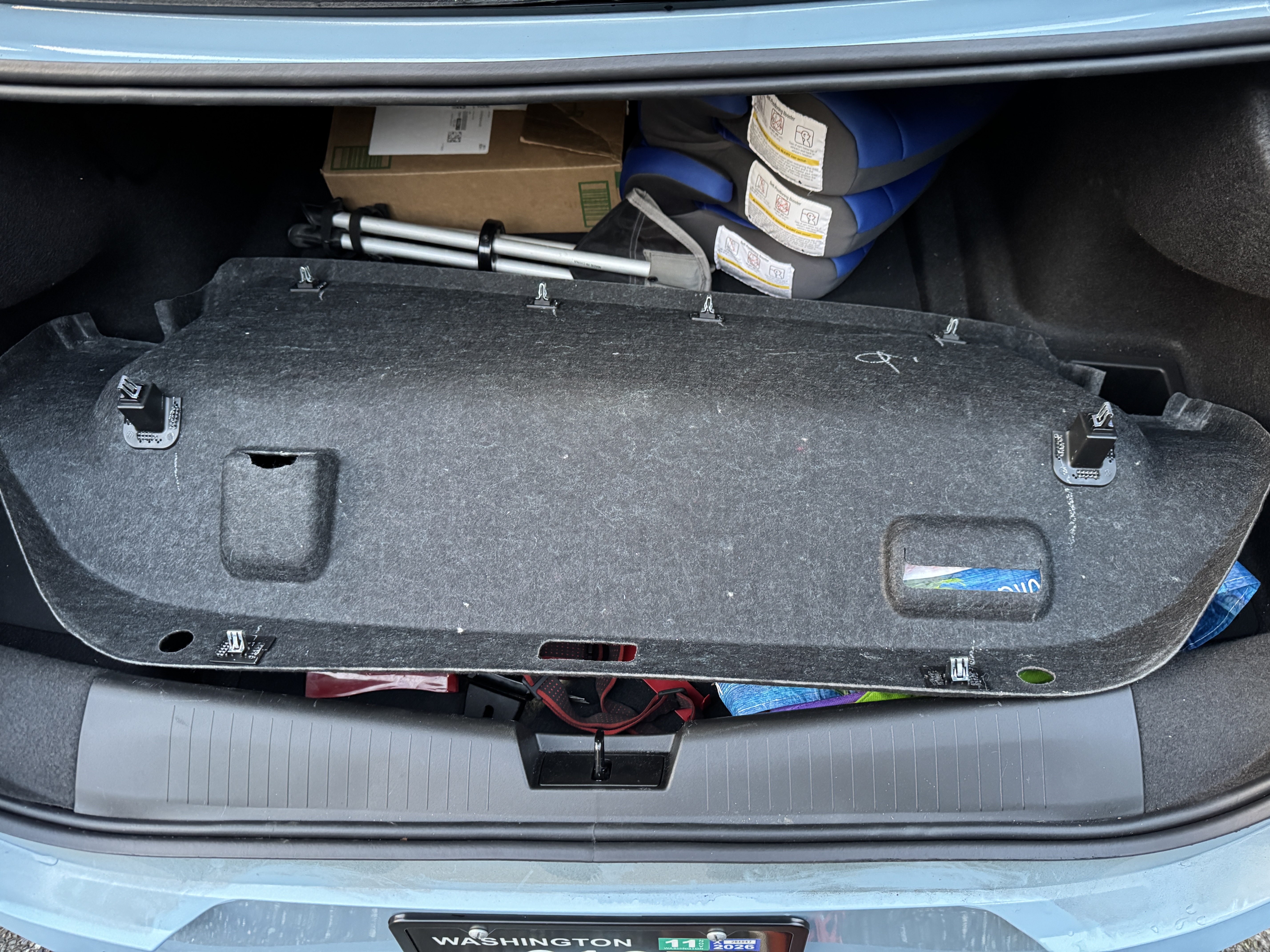

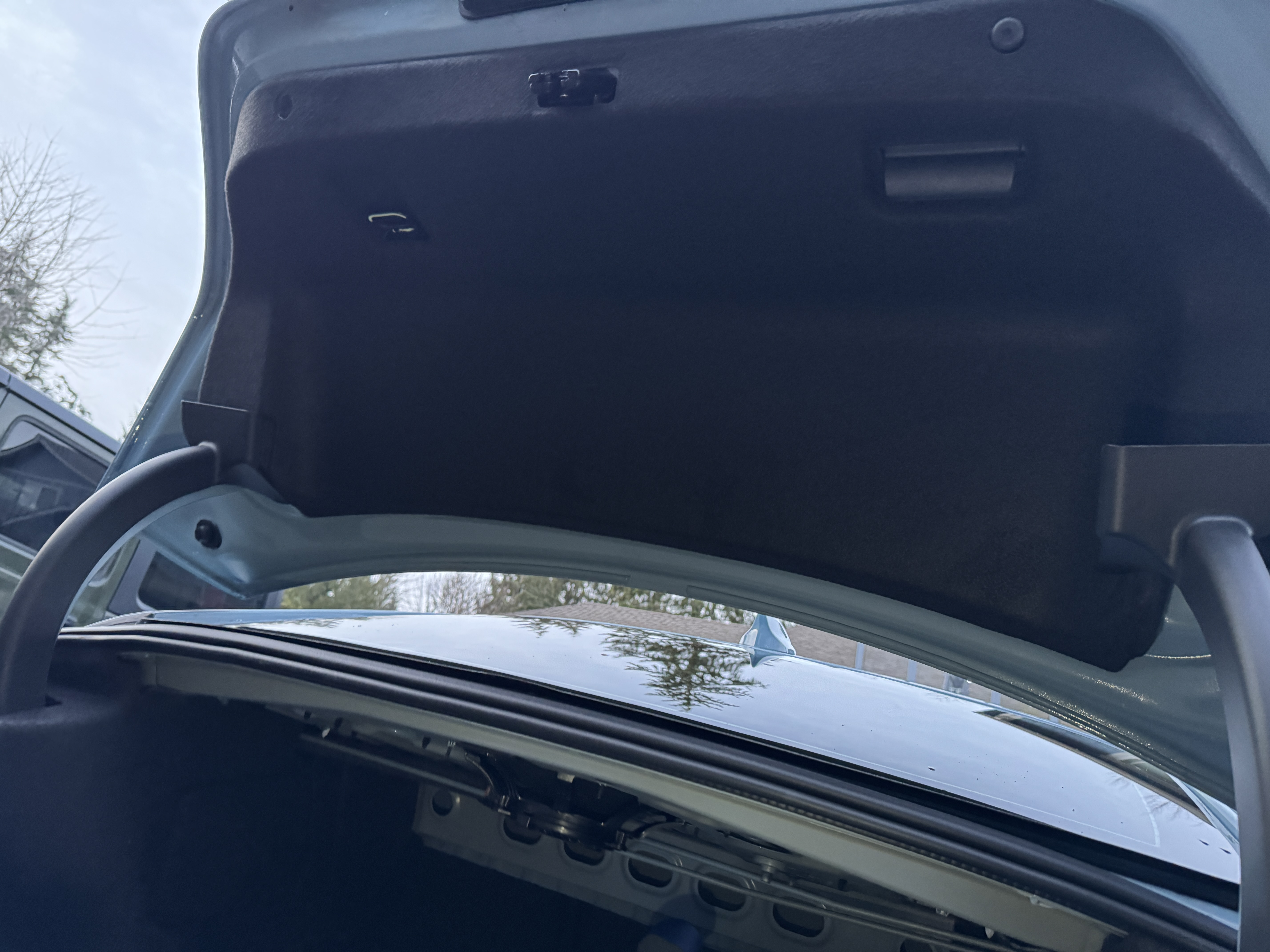

Here is a picture of the trunk liner to know where the snaps are. There are 8 snaps on the liner and 1 on each plastic hinge bar covers.
The trick to removing the liner without breaking the snaps off the liner is to reach your hand (or pry tool) in there and push/pull on the plastic shoulder and not on the fabric piece.

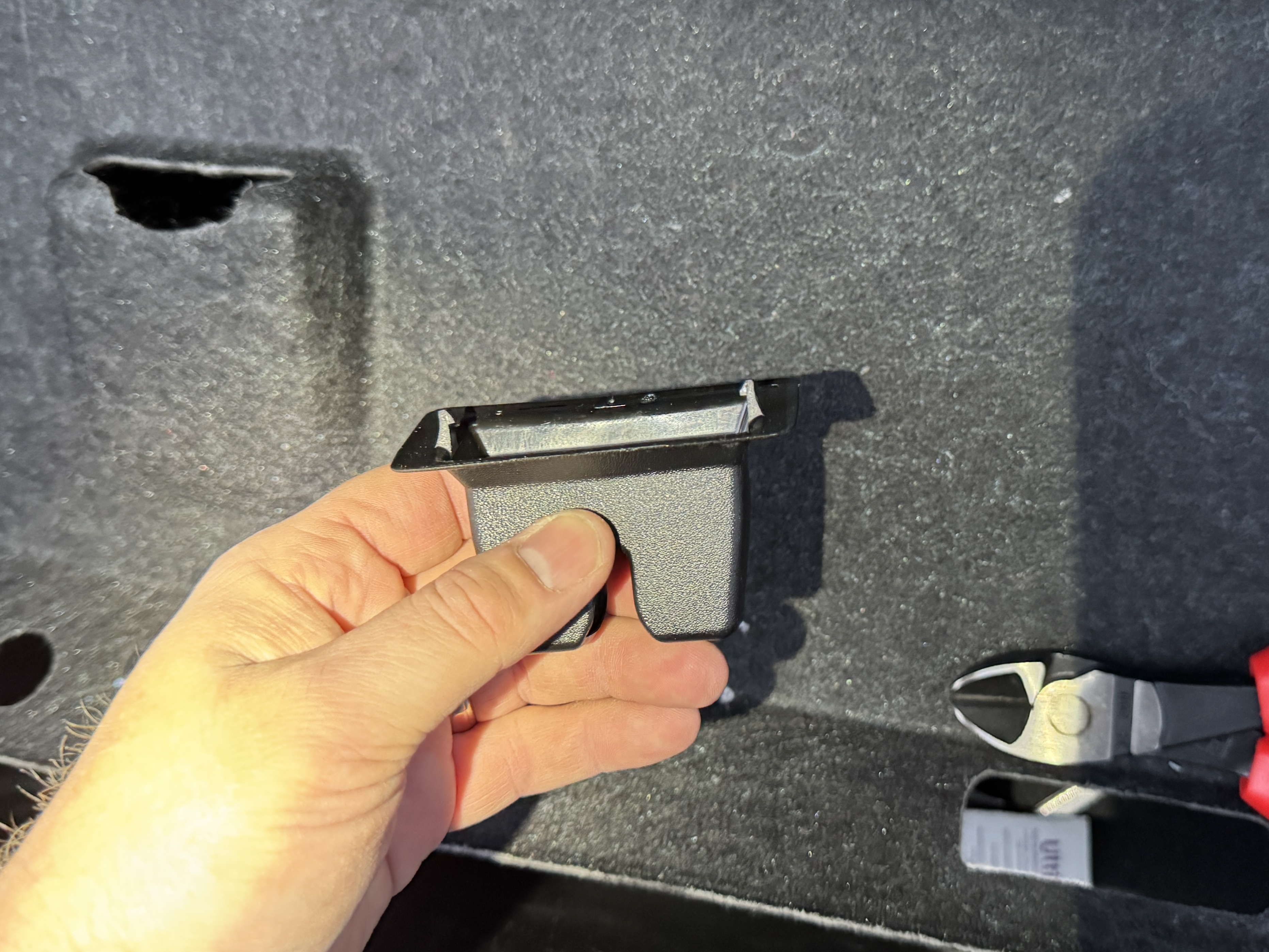

1st step is to remove plastic cover on the latch. I did this by slipping a trim tool under the liner pry the liner away and plastic cover snapped off without damaging the hooks.

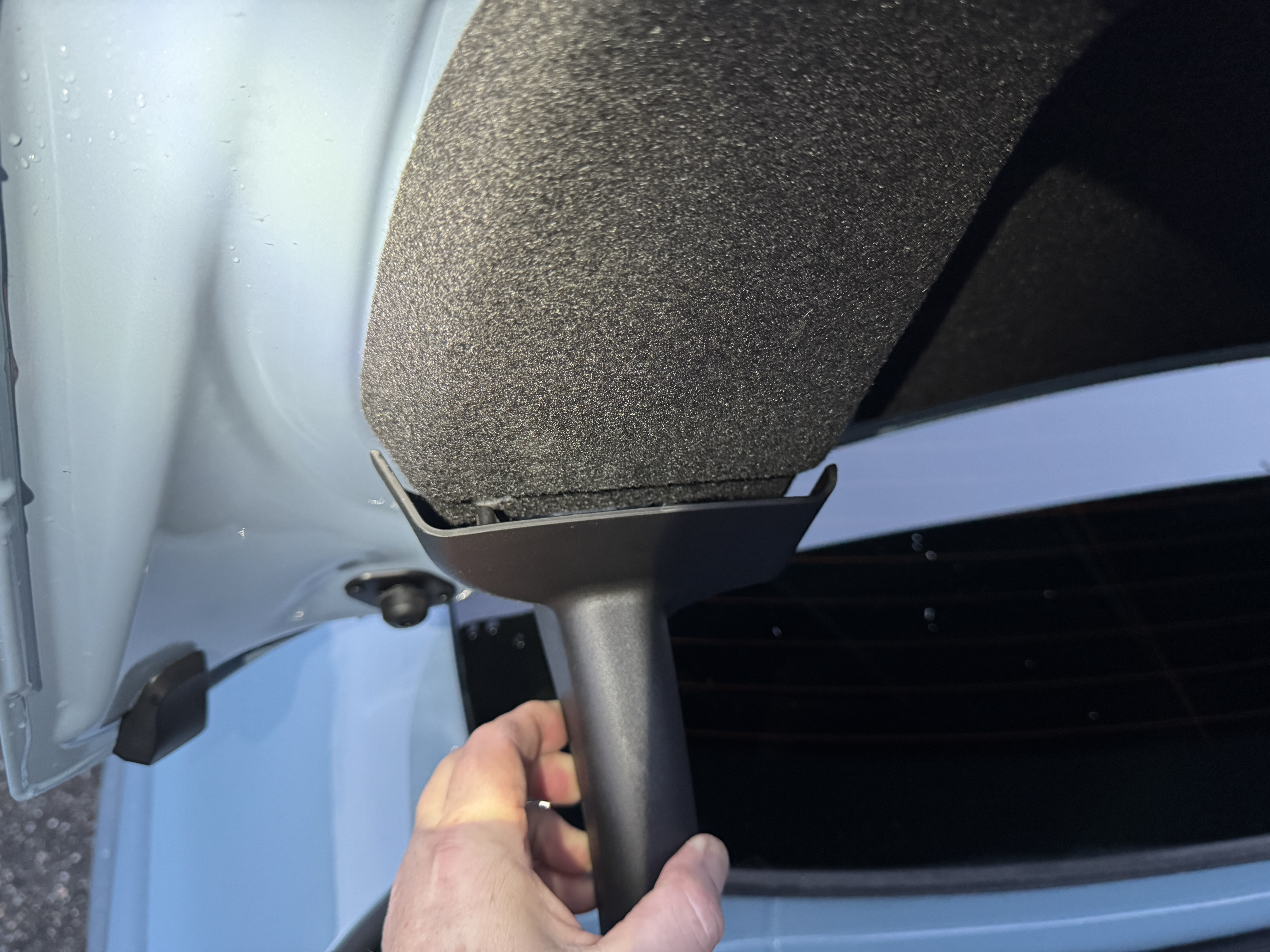

2nd is to pull liner down and pull the plastic covers back on the hinge bars. I did not have to remove the hinge bar covers fully, just pulled them back.

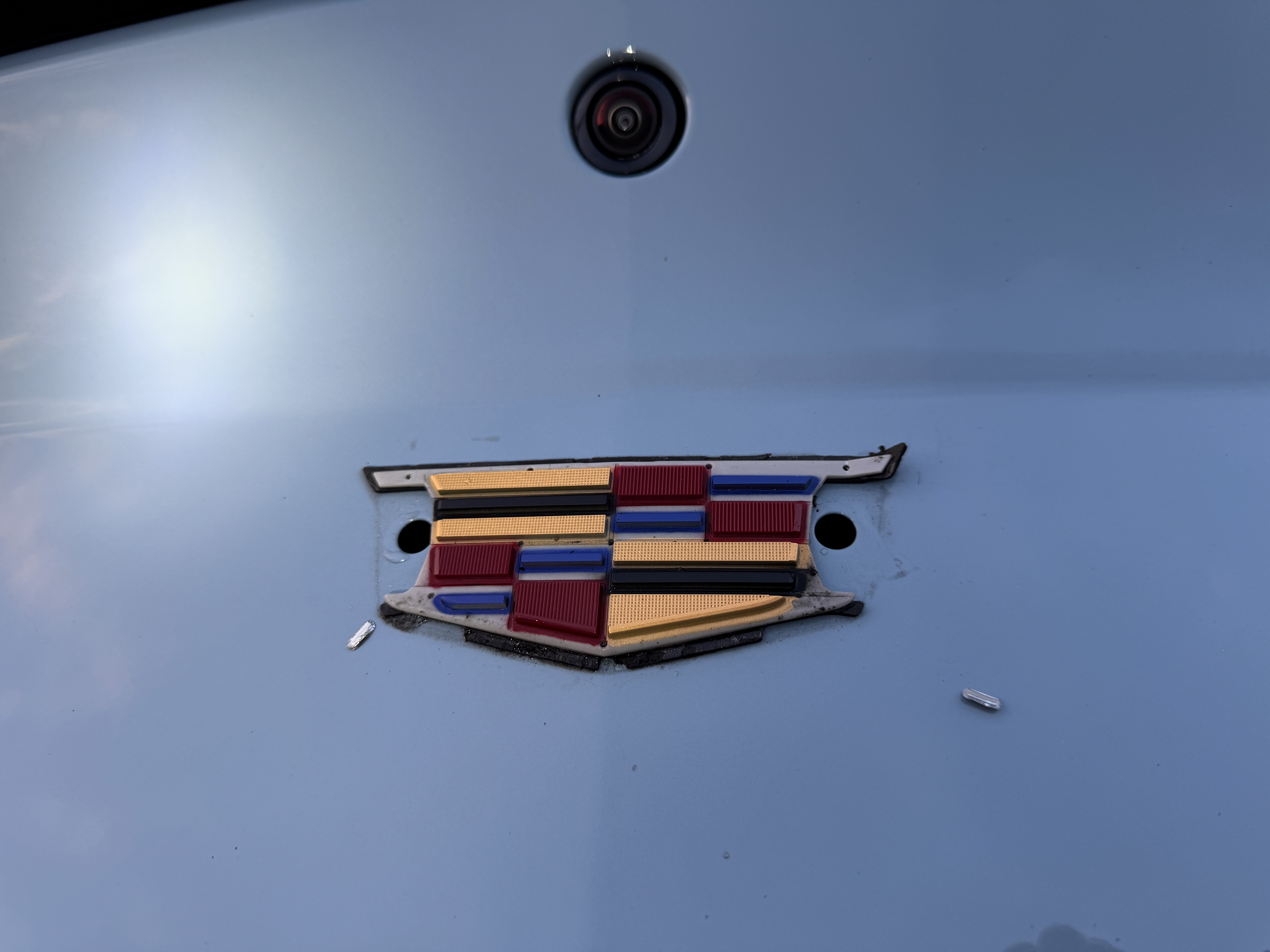

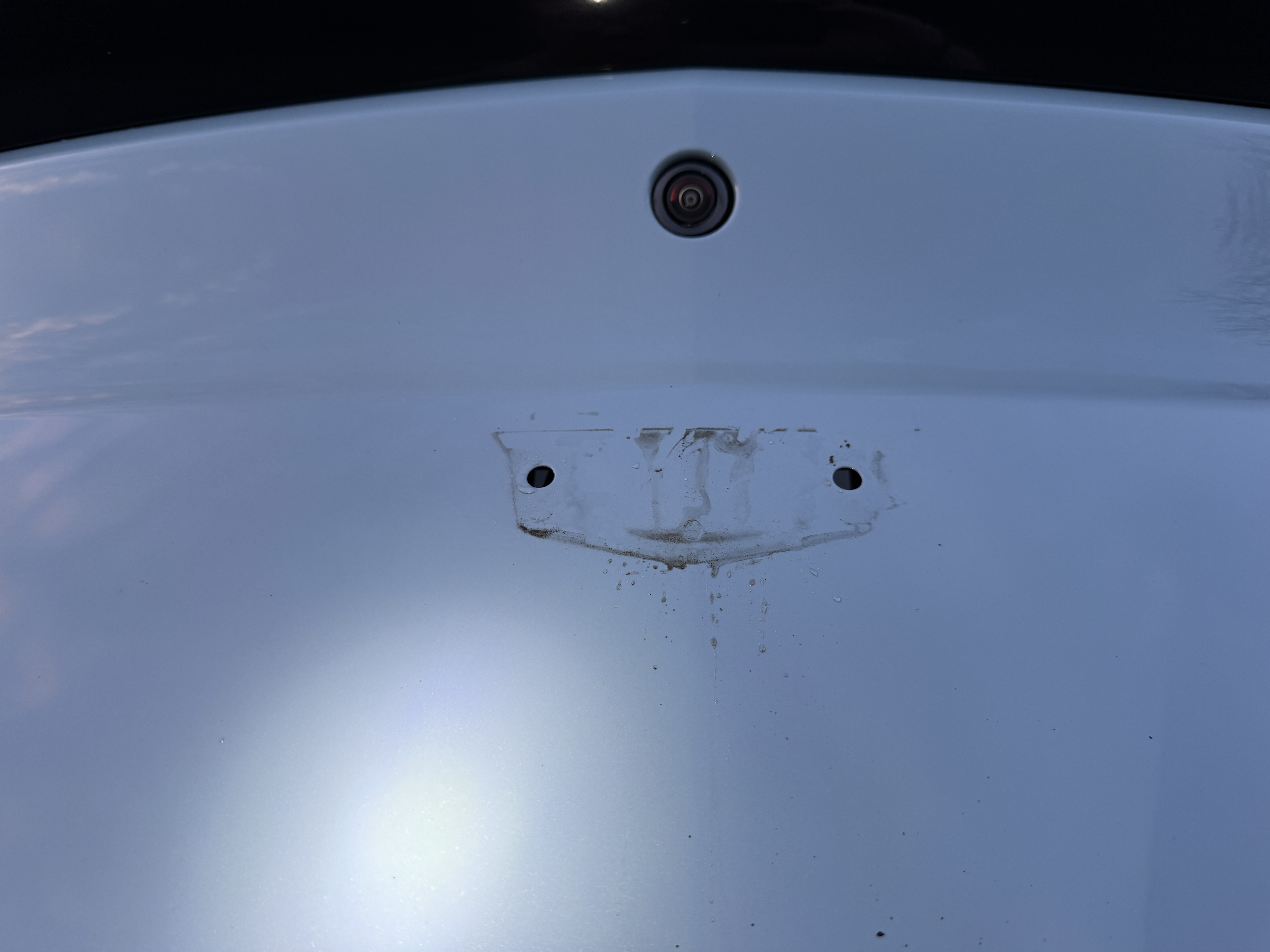

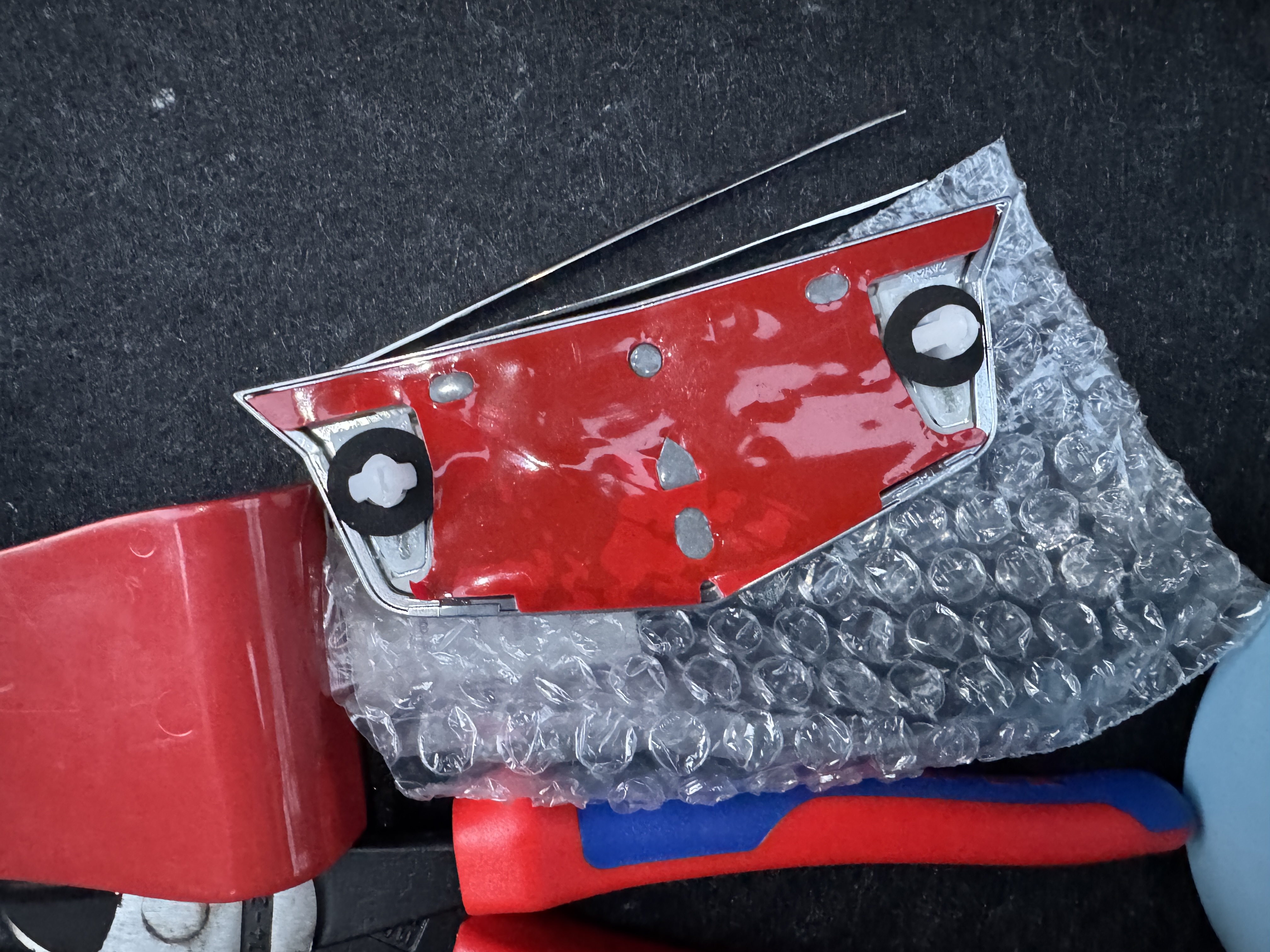

I didn’t care to save the original emblem so I cut the snaps from inside and then pulled on the chrome emblem from the outside to break it away. The emblem separated where the sticky and color inner parts stayed on the trunk. I pulled that off with my fingers too and no sticky residual was left on the car.
Cleaned the surface before adhering the Savage Cadillac black emblem.

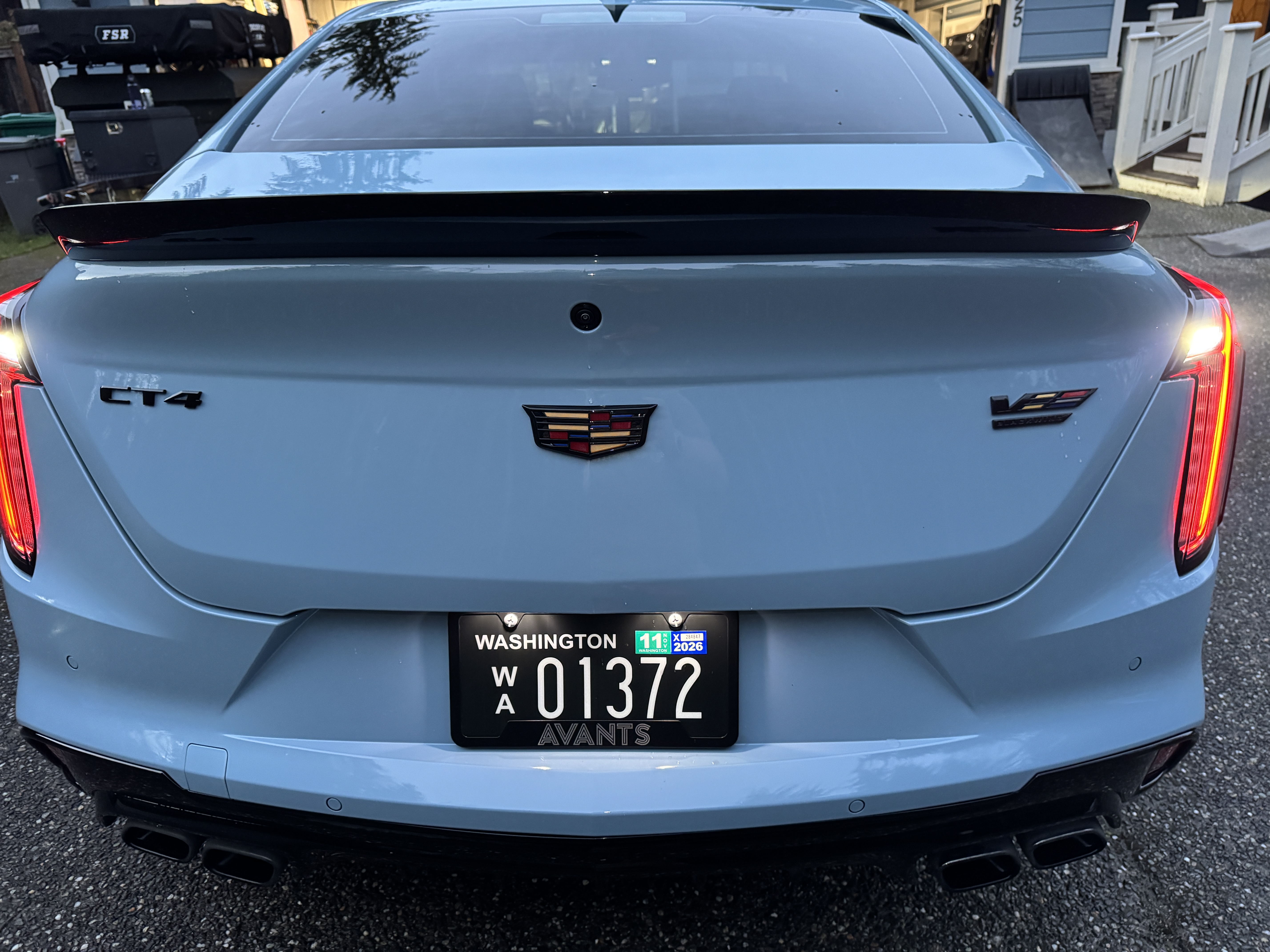

Rears done.

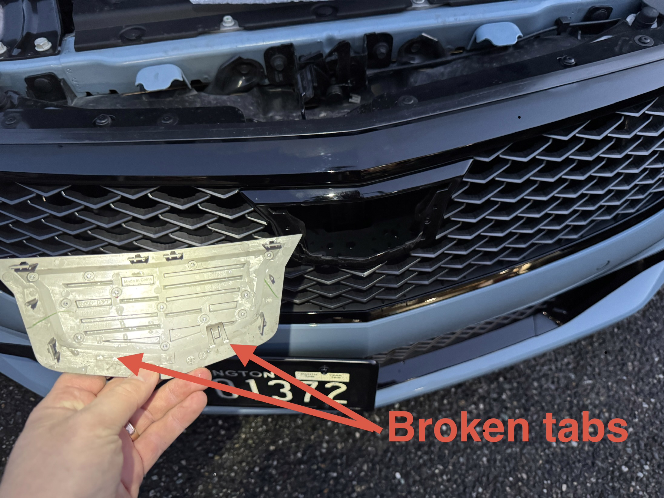

Front was super easy

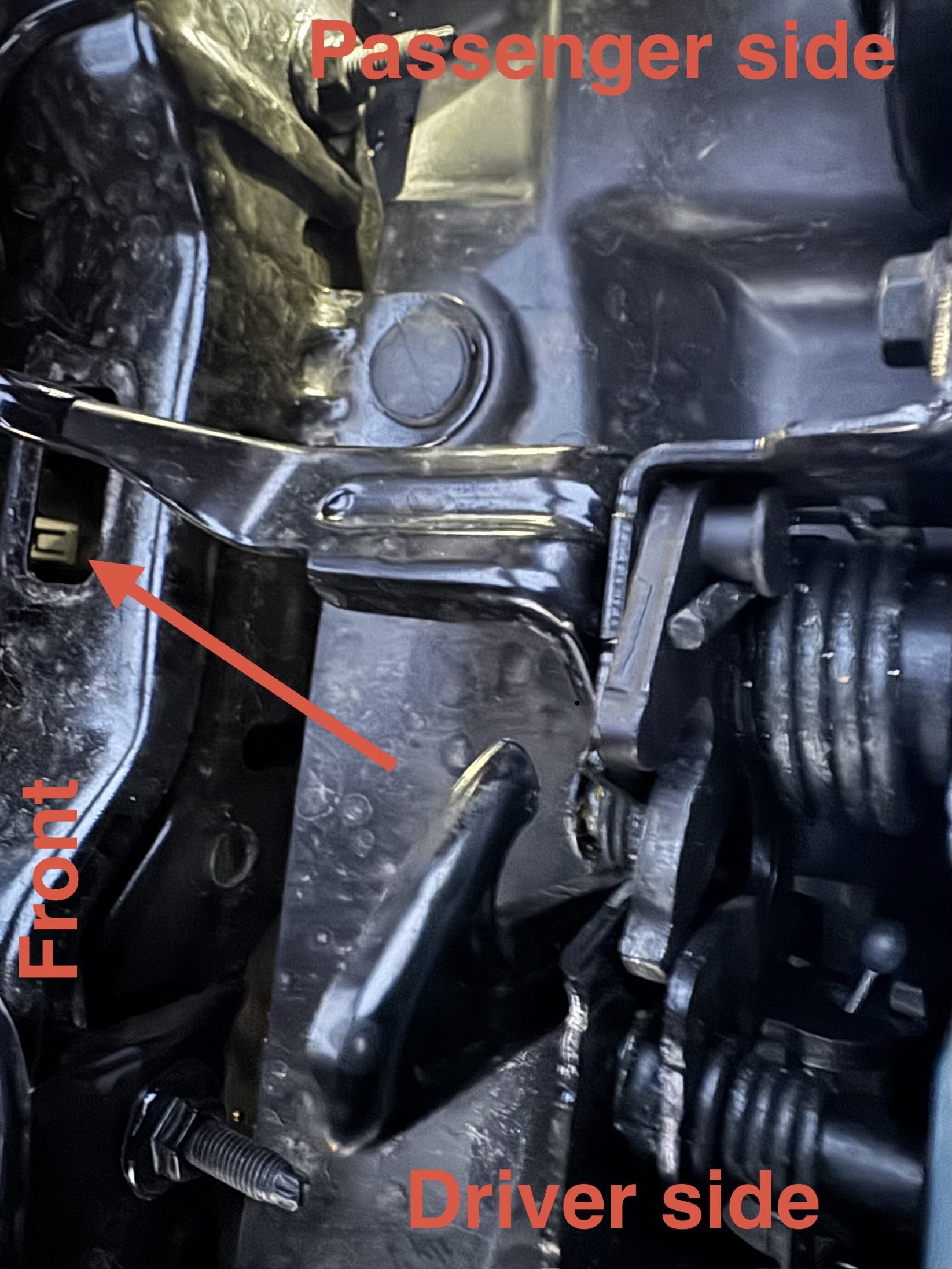

From what someone suggested I reached my fingers in thru the grill to break the tabs off the chrome stock emblem.
I broke the 2 bottom ones from reaching directly under the emblem and was able to push on the lower side ones which may not have done anything to help. This allowed me to pull on the bottom of the emblem to snap it off.

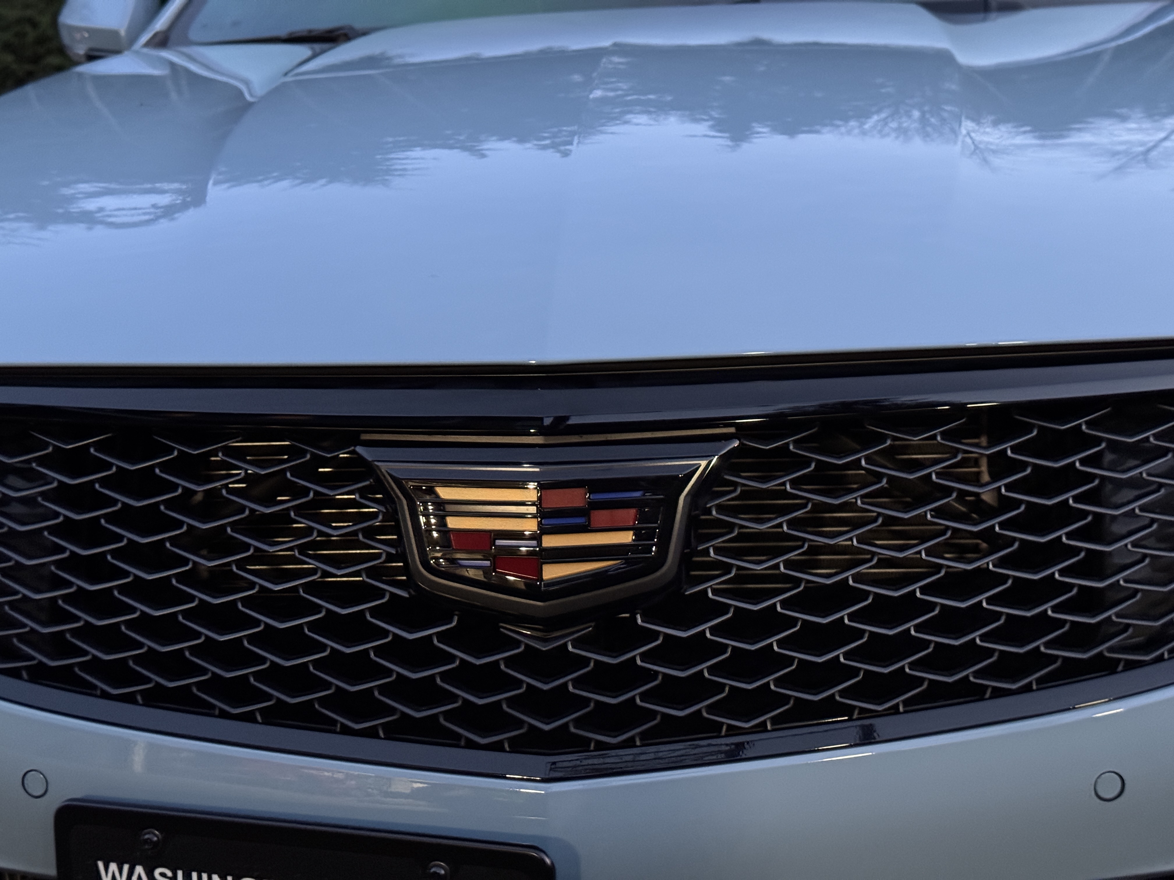

A quick wipe to clean the surface and snap on the black Savage Cadillac front emblem. I have a manual without front sensors in the emblem.
