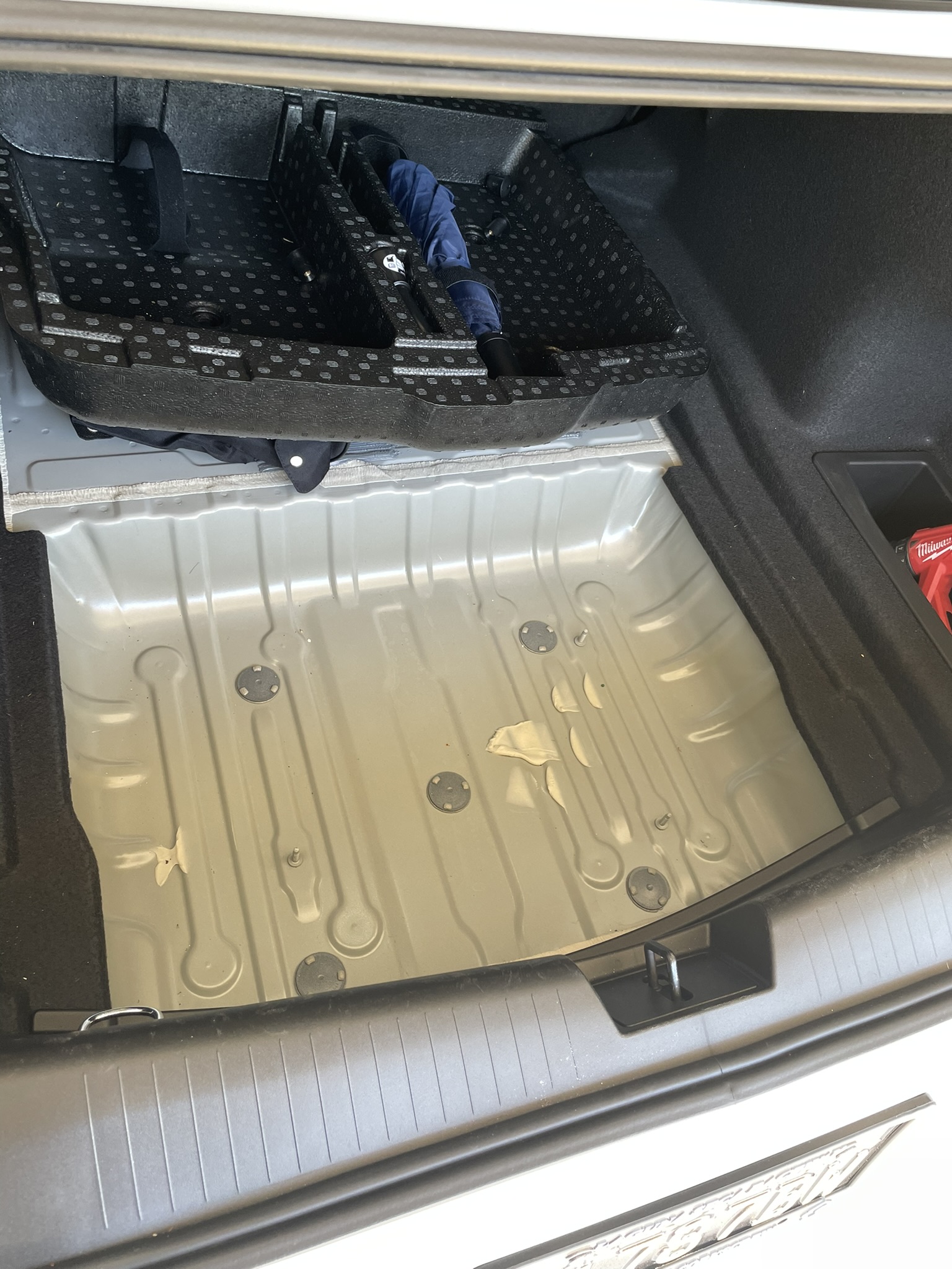

For those keeping score on the "where are my brake cooling ducts" saga, I removed the three Torx T40 nuts and pulled the styrafoam tray and there is nothing beneath it....

Check to make sure they aren't installed if you haven't already. Some dealers installed them, both right and wrong, on the cars when they came in. If you have an air scoop hanging down from your control arm on the rear then they installed them. Also, our cars do have cooling ducts on the front. Take off your front wheel and you'll see the scoop and the channel that provides it air.
The dealer managed to do it both right and wrong on mine :)
They didn't install the rear ducts, they left them in the trunk (right!)
They didn't install the air deflectors, they left them in the trunk (wrong!)

Thanks Mang. I looked under there but its hard to see. Maybe I'll pull a wheel this weekend...

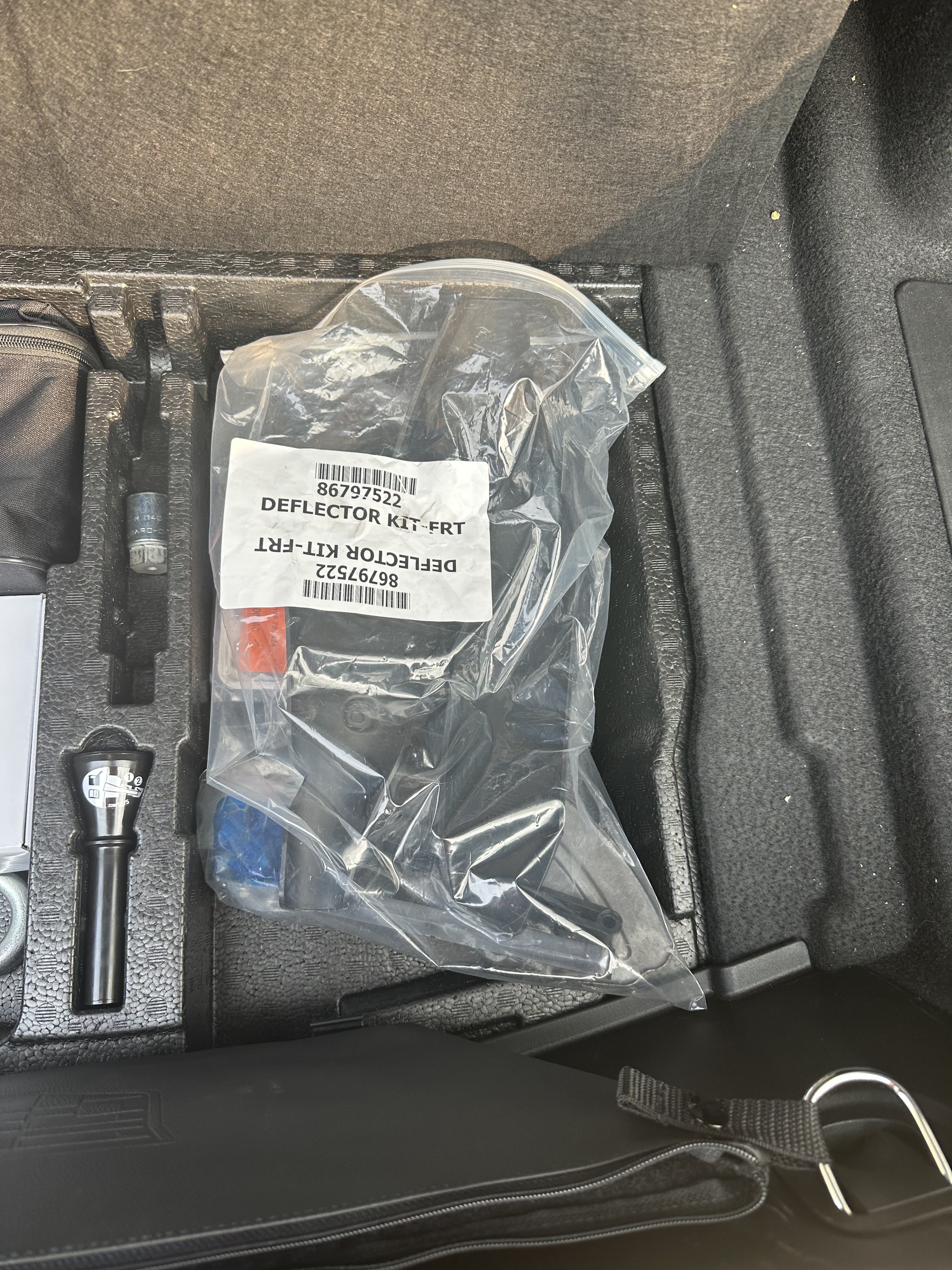

Any kinda pic that shows what they look like???
This is where mine was. I stumbled onto it when I was looking for the lug nut lock.

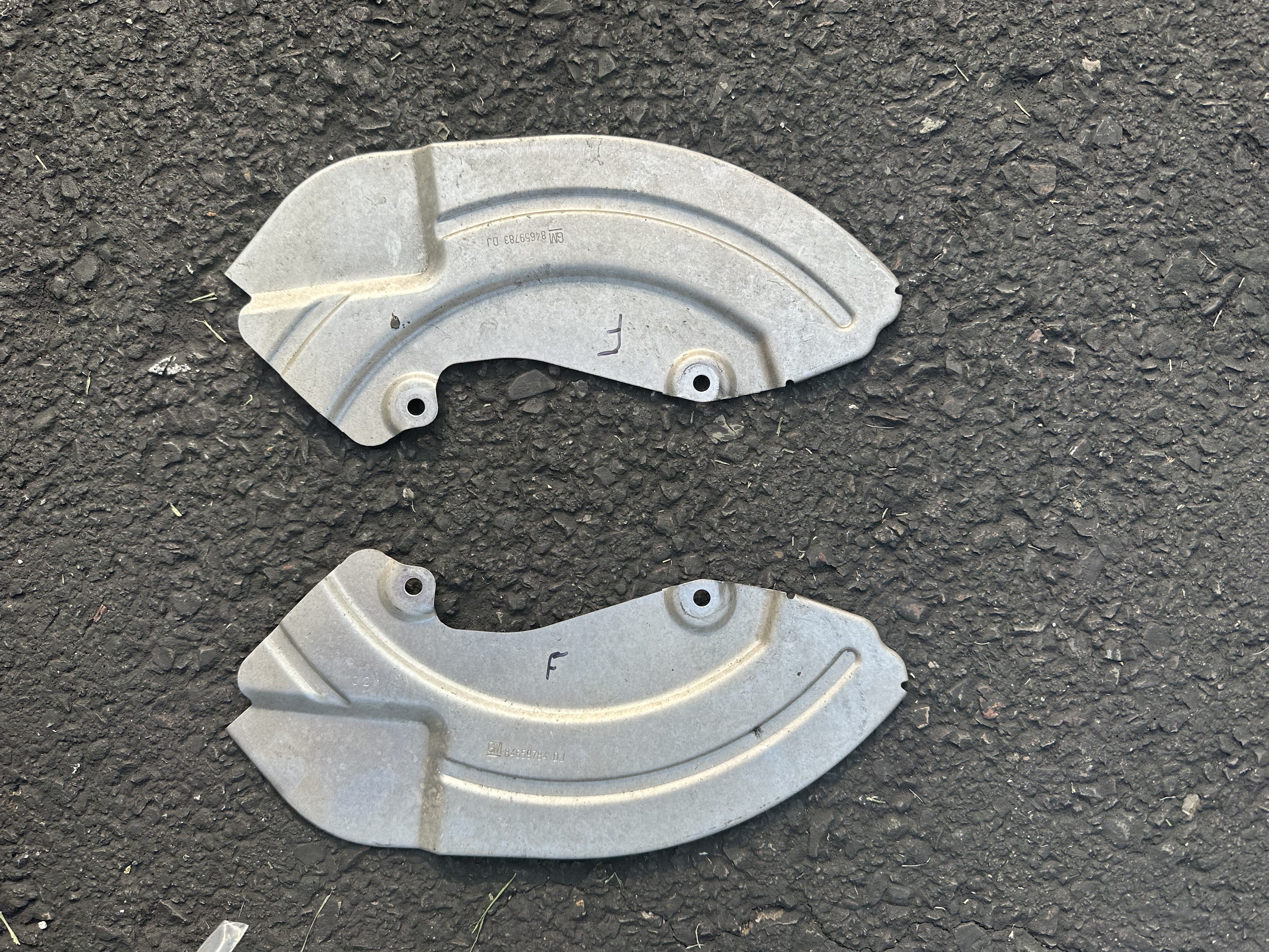

These are the removed front plates:

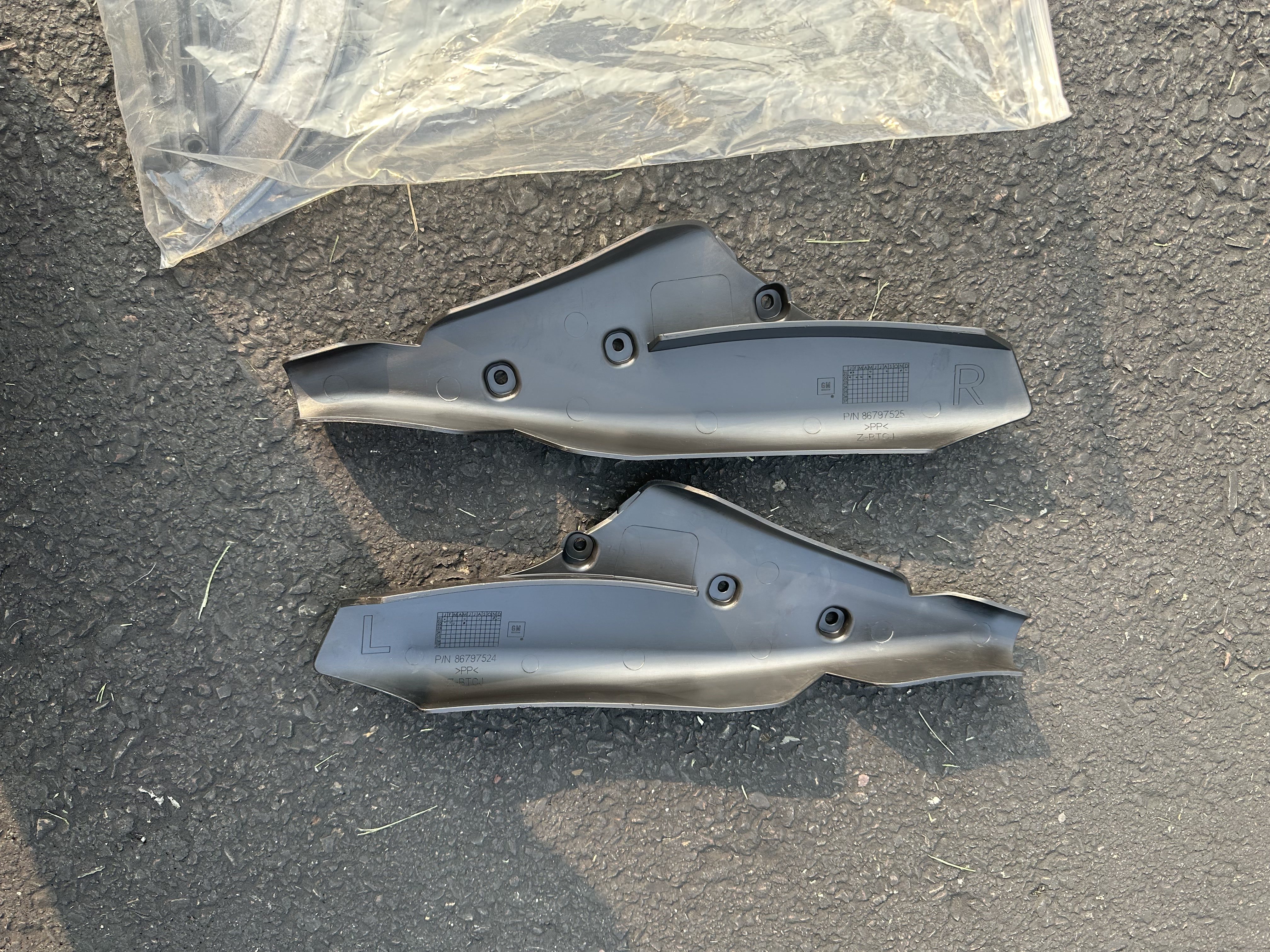

These are the rear ducts that did not get put on.
It is simple to tell it they are installed. If the is a plastic duct leading to the back of the rotor then you are good. If you see the flat metal plates, then you do not have the brake ducts installed.

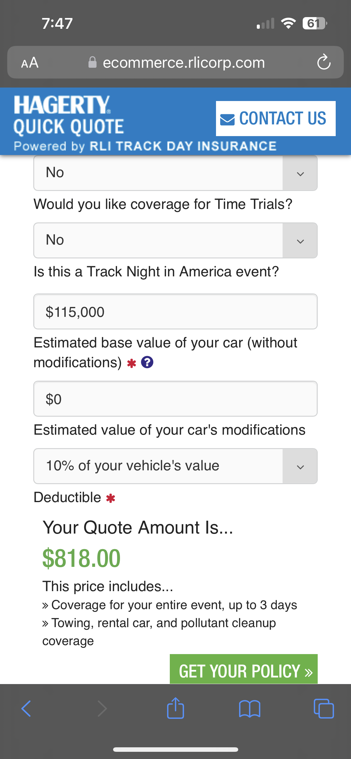

I went from $650 no track no liability to $780 for VIR no liability to $880 and then $950 for $1m and $2m liability with then
Hagerty has track insurance as well, it wouldn't hurt to get a quote
I am being told that CCB doesn’t get a track cooling kit, only the iron brakes
$818 no liability, $12k deductible
I insured mine through Hagerty for my loan payoff amount + 5k instead of 100% of replacement value/MSRP. Seems like overkill to me to max it out like that, but then again we all have different risk tolerances. Any SCCA events also include a 20% discount on the insurance premium.
I guess my formulation is slightly riskier, but I'm OK self-insuring for the remainder which in my case would just be a down payment on a new car.
