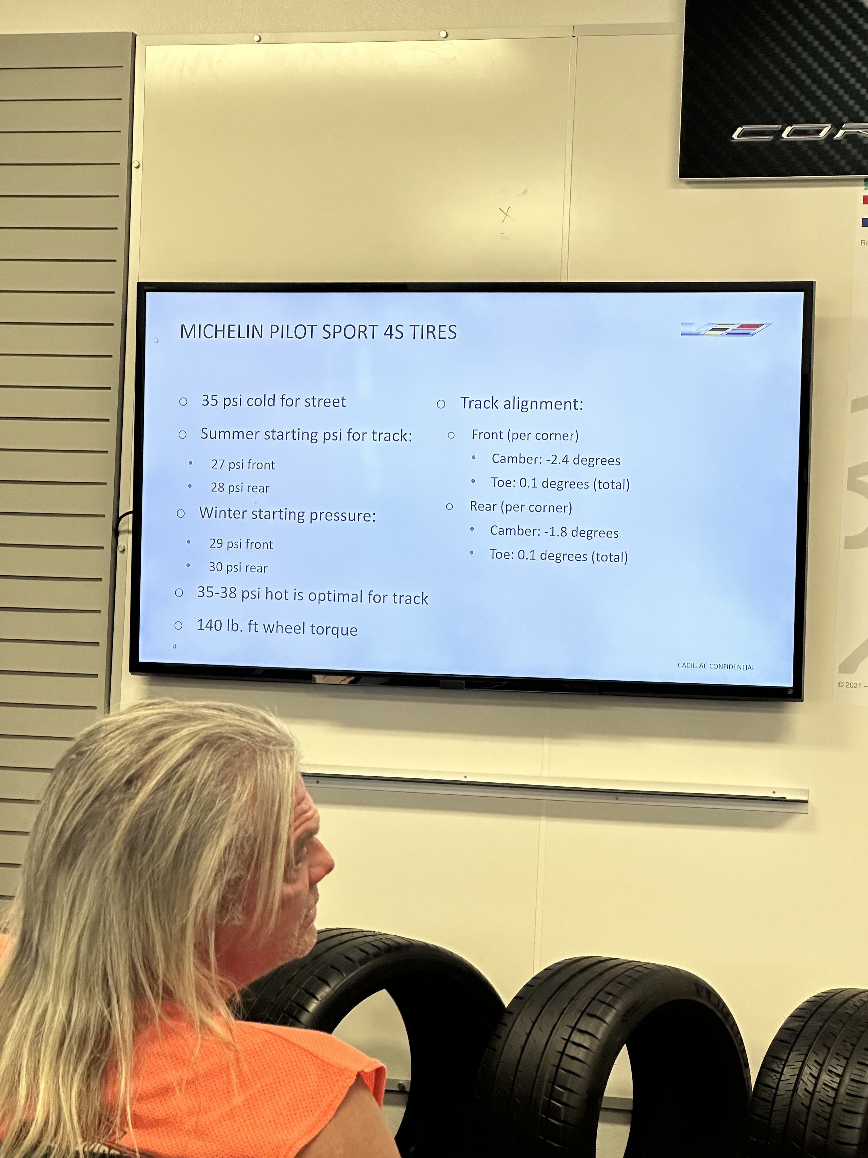

This is what setup spring mt had on their cars.
