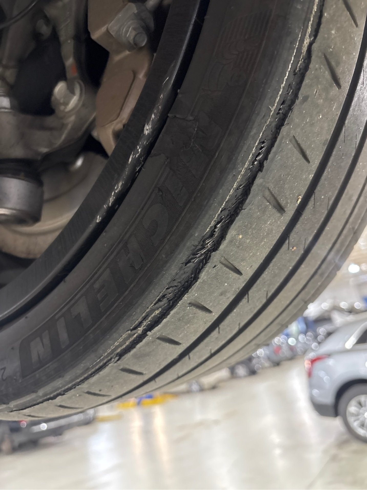

With 2 degrees negative camber you will definitely wear out the inside in less that 15K miles. I had about 8K miles before going to -1.8 front and -1.4 rear. Then did 4 track days and the tires were toast by 12K miles with the outsides being more worn more than the insides.
This year will be -2.4 front and -1.8 rear. Bought a second set of wheels and have a set of Michelin slicks ready to go for this season.
