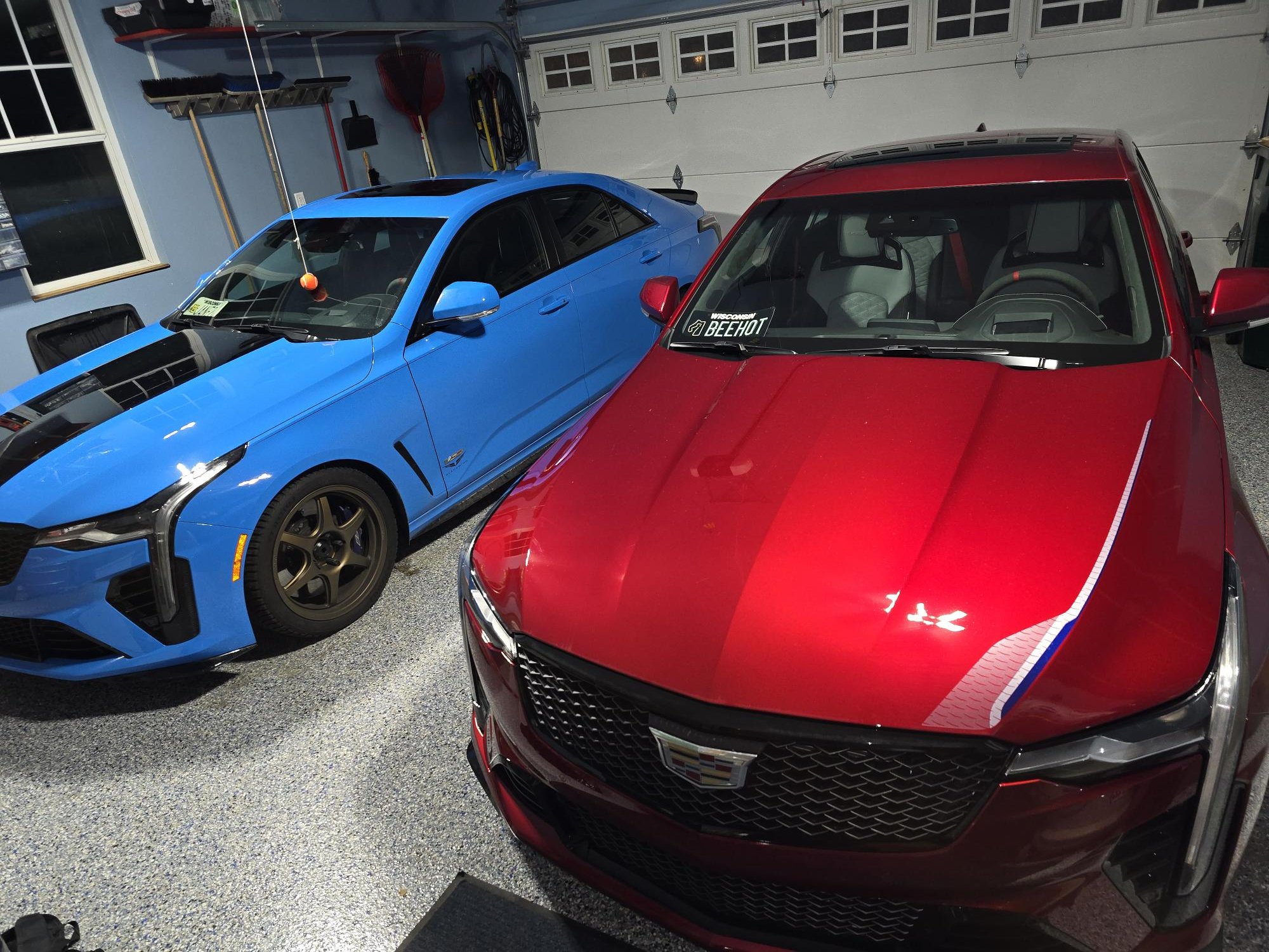

I just bought another CT4 BW, this time for me. The wife has the 23 blue one you see. About your question, no, the steering is right on both.
