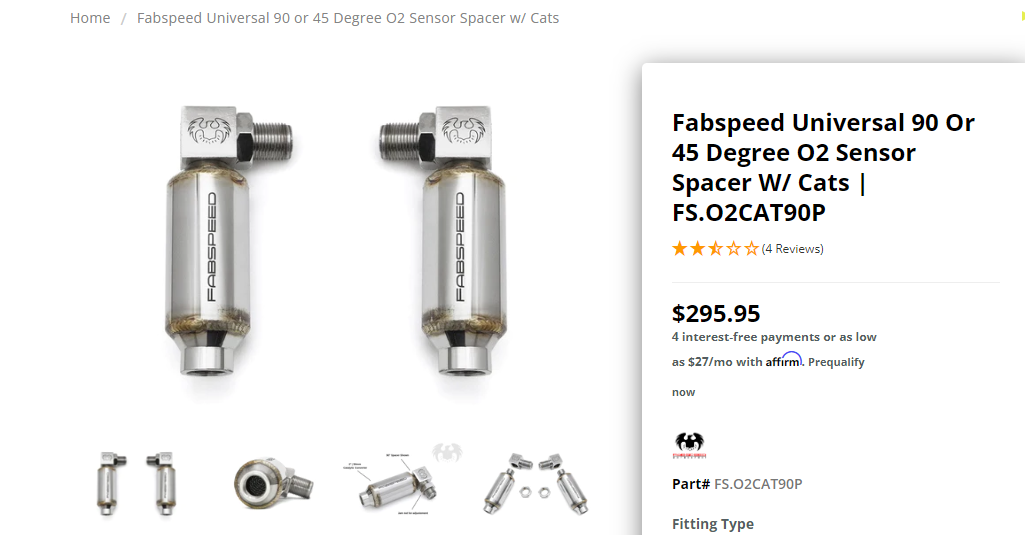

Wait, these are catless DPs and using spacers with cat material in them correct?
It threw the check light a hand full of times within the first 600 miles or so after putting them in, but it hasn't in about the last 1000 miles.

I'd bet more that the O2 spacer is touching something when the motor is torqued up? I had one of the spacers loosen and it made a weird buzzy type noise and threw a O2 heater code. Tightened it up and both went away.
