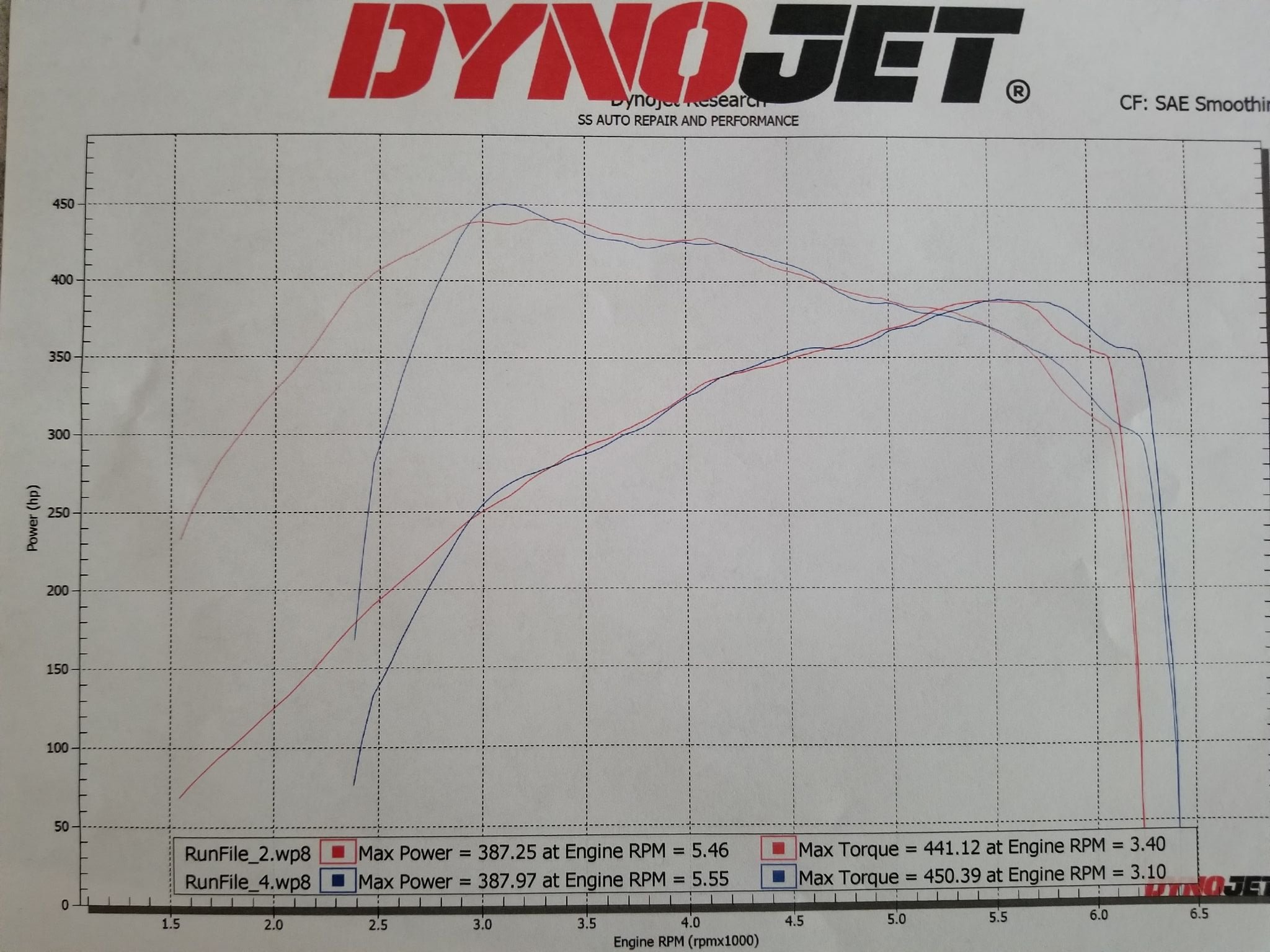

Well my CEL did come on when I went back onto the dyno. So here's the thing: the stock ecu looks for a tq target, and once it hits that tq target value, it starts pulling back boost pressure. I learned this after talking to Christopher Berube, GM performance division lead program engineering mgr. Originally, these cars make 15psi peak and taper off to about 9psi at fuel cut. With the extra airflow now it's hitting that tq value at 13psi and then tapering down to 6-7psi at fuel cut. It's down ~2psi across the powerband but still making roughly the same peak numbers. (shown in SAE) It still peaks out almost 10tq higher and carries an extra 15hp/15tq or so another 600rpms or so at the top. Figure now the pipes are mostly for sound but being able to control boost, oh man, it'll make a huge difference.
Well my CEL did come on when I went back onto the dyno. So here's the thing: the stock ecu looks for a tq target, and once it hits that tq target value, it starts pulling back boost pressure. I learned this after talking to Christopher Berube, GM performance division lead program engineering mgr. Originally, these cars make 15psi peak and taper off to about 9psi at fuel cut. With the extra airflow now it's hitting that tq value at 13psi and then tapering down to 6-7psi at fuel cut. It's down ~2psi across the powerband but still making roughly the same peak numbers. (shown in SAE) It still peaks out almost 10tq higher and carries an extra 15hp/15tq or so another 600rpms or so at the top. Figure now the pipes are mostly for sound but being able to control boost, oh man, it'll make a huge difference. View attachment 11323
What was the cause of the cell? Was it related to the catless downpipes or the reduced boost?
It's for the downpipes. I'm going to let the ecu see the code for a while and see if it learns and shuts it off. Nissan ECU's will throw codes with straight up cat deletes and then after a few hundred miles shut off when they readjust. with the mini cats on the BW it might do the same thing.
