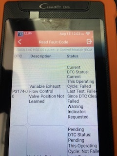

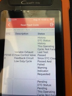

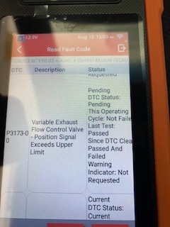

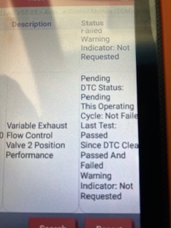

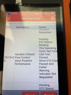

i pulled the 3 codes
P317F
P316E
P3173
All 3 are exhaust valve codes.

put it back on, and started the car and as i said they both 100% work as they should but still get check engine light, bought a scanner so did a full scan cleared the codes then did a relearn of the valves, shut it off cycle the key and fucking light pops back on? NOW what LOL

put it back on, and started the car and as i said they both 100% work as they should but still get check engine light, bought a scanner so did a full scan cleared the codes then did a relearn of the valves, shut it off cycle the key and fucking light pops back on? NOW what LOL View attachment 31695View attachment 31694View attachment 31696View attachment 31697View attachment 31698

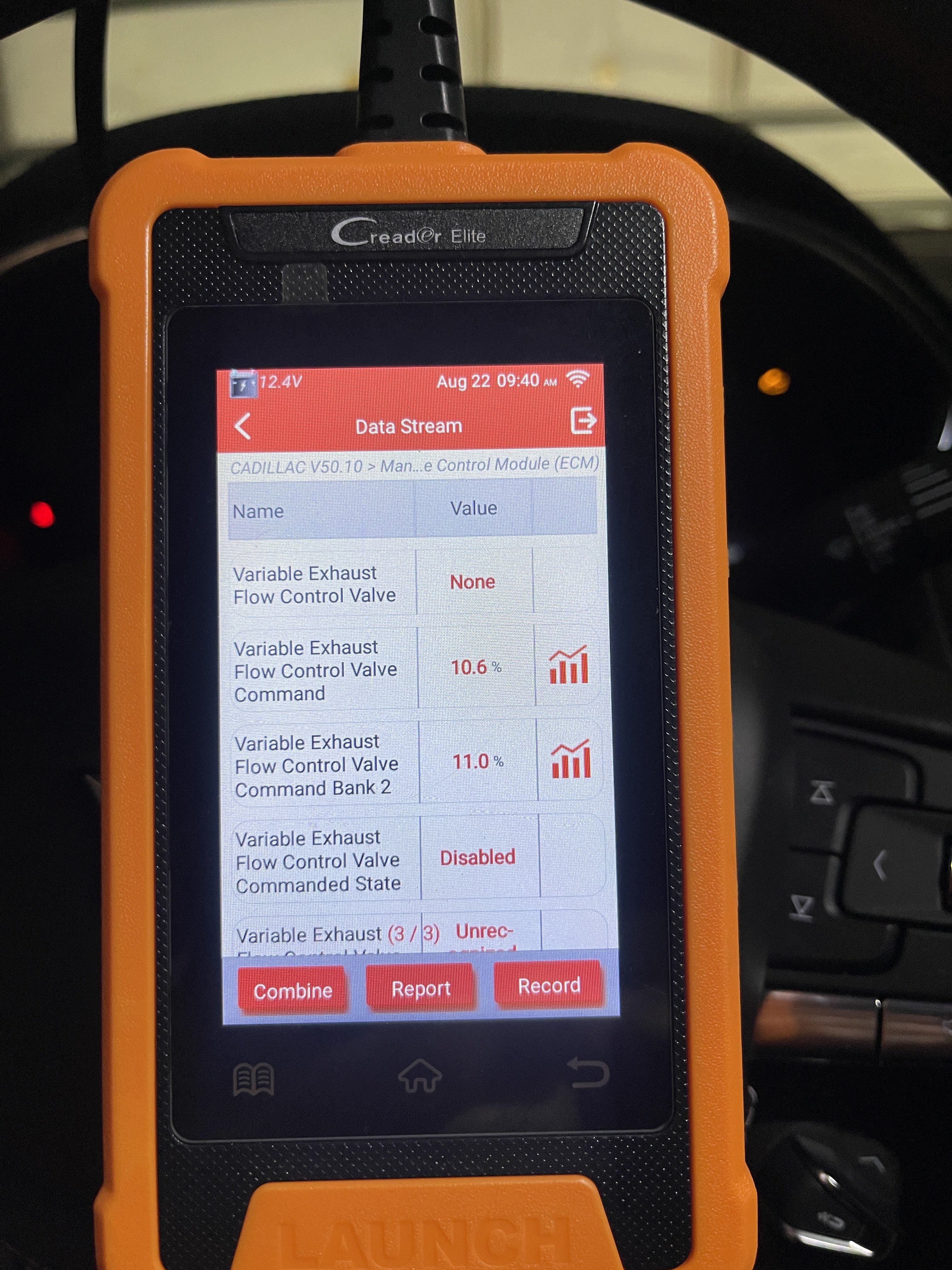

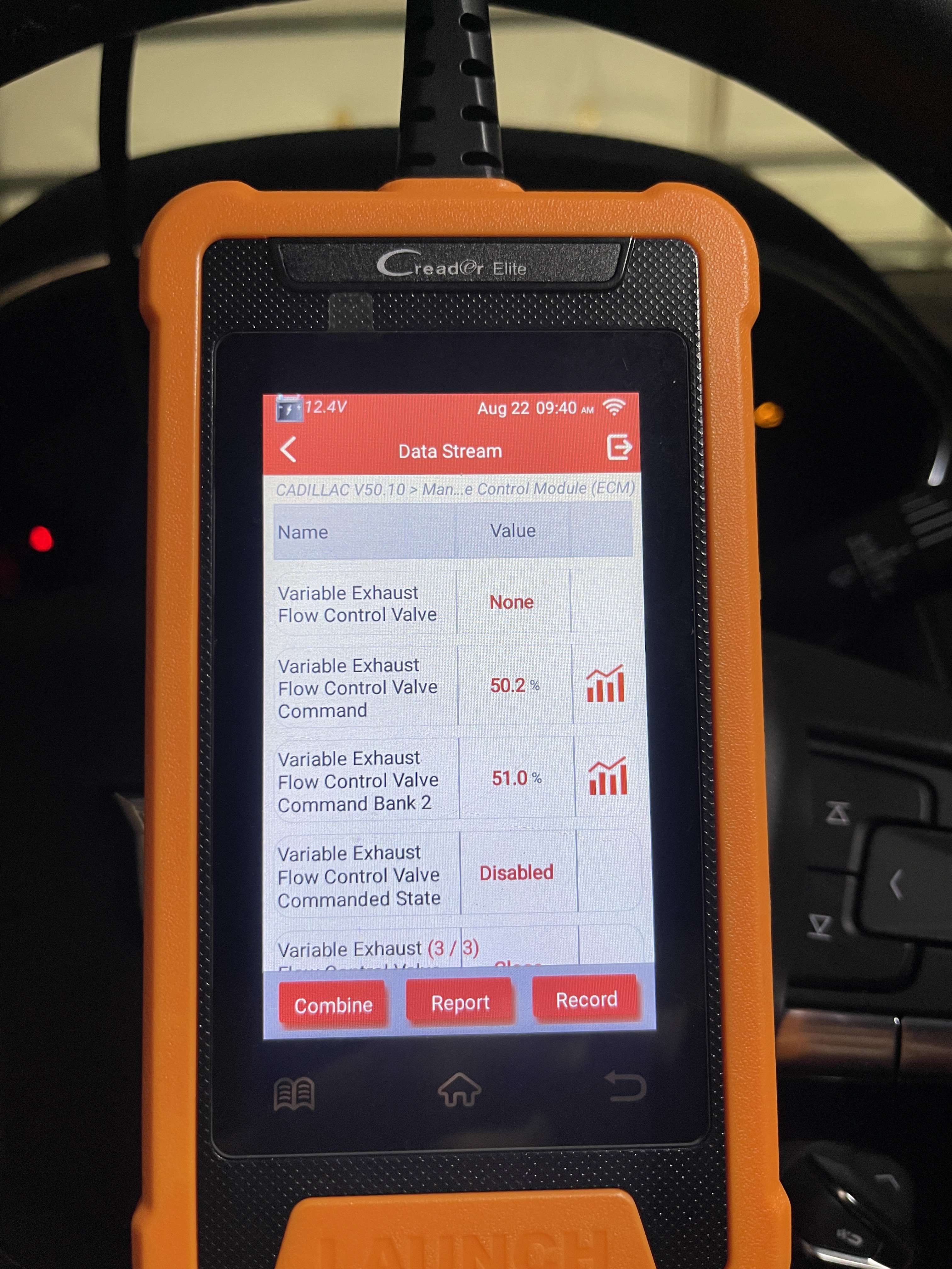

@BigBrett Working off alot of assumptions here but to level set, my assumption is 1) clock springs are correctly installed 2) the valve actuators are mechanically sound and 3) the valve springs in the Corsa valve are the correct spring weight (I've read that this may not always be the case)

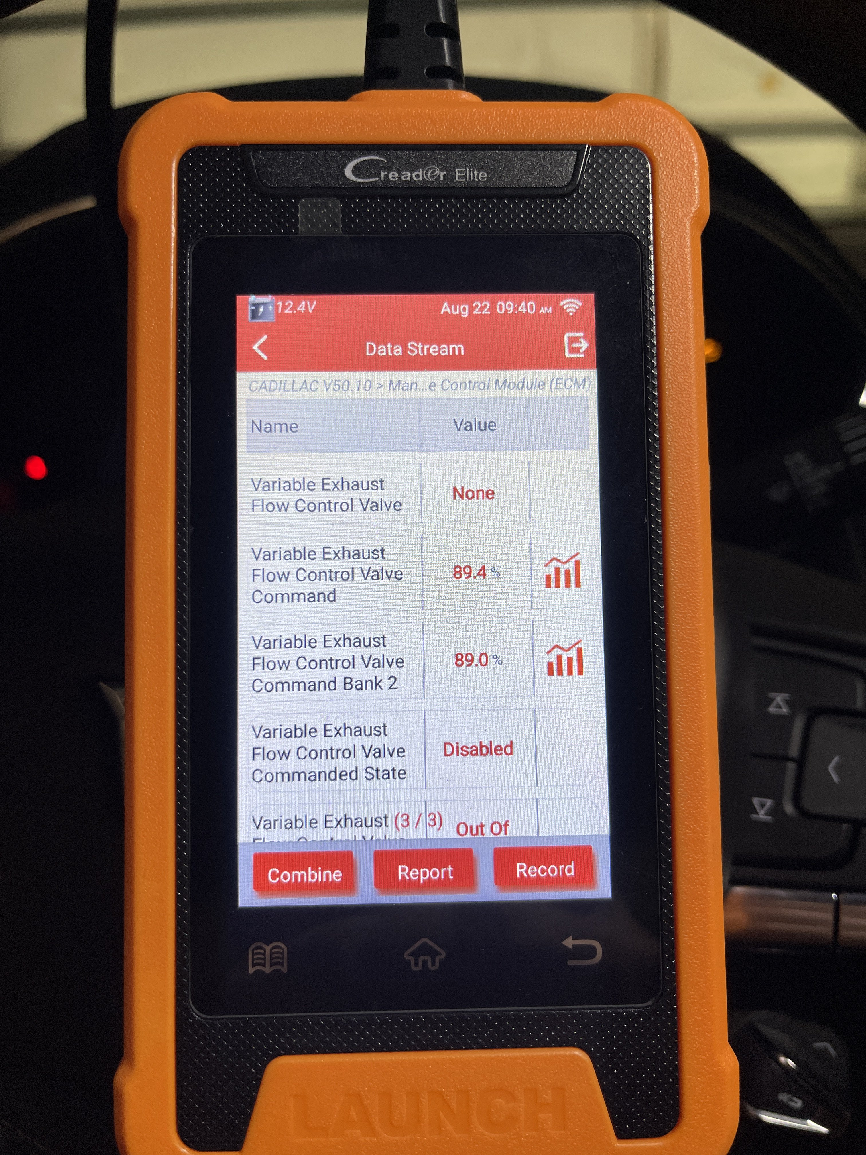

Put the BW in service mode (e.g. hold start button for about 8 seconds or so, feet off the pedal), I'd start by doing a live data review, with the Creader, go to ECM > Data Stream and scroll till you find Variable Exhaust Flow Control Valve Command & Variable Exhaust Flow Control Valve Command 2, there should be a % value to the right. Both of these values should be similar to each other (~ +/- 1%). (based on my observations)
Now, switch the drive mode while monitoring those values. The goal is to determine what values the ECM is obtaining which may help indicate if there's an issue and which valve actuator. The % values are what the ECM sees as the % of which the valve is closed. These % values will correlate to a voltage value received by the ECM, I won't go into that now.
Tour/Snow modes should read around ~89%
Sport mode should read around ~50%
Track/V mode should read around 10-11%
If these are the values you are seeing then its unclear to me why you are getting the codes unless there's something wrong with the mechanical valve springs, actuators, the extension cables, or something upstream. If the values do align with the above, I'd try clearing the codes, and then before starting, disconnect the battery and give it an hour or so. See if that can flush out any residual values which may be lingering in a temporal state.
Note: Be sure you've updated your reader before doing the above to ensure you have all the latest data elements.
I'll upload some pictures I took to help ya when I get a moment.
