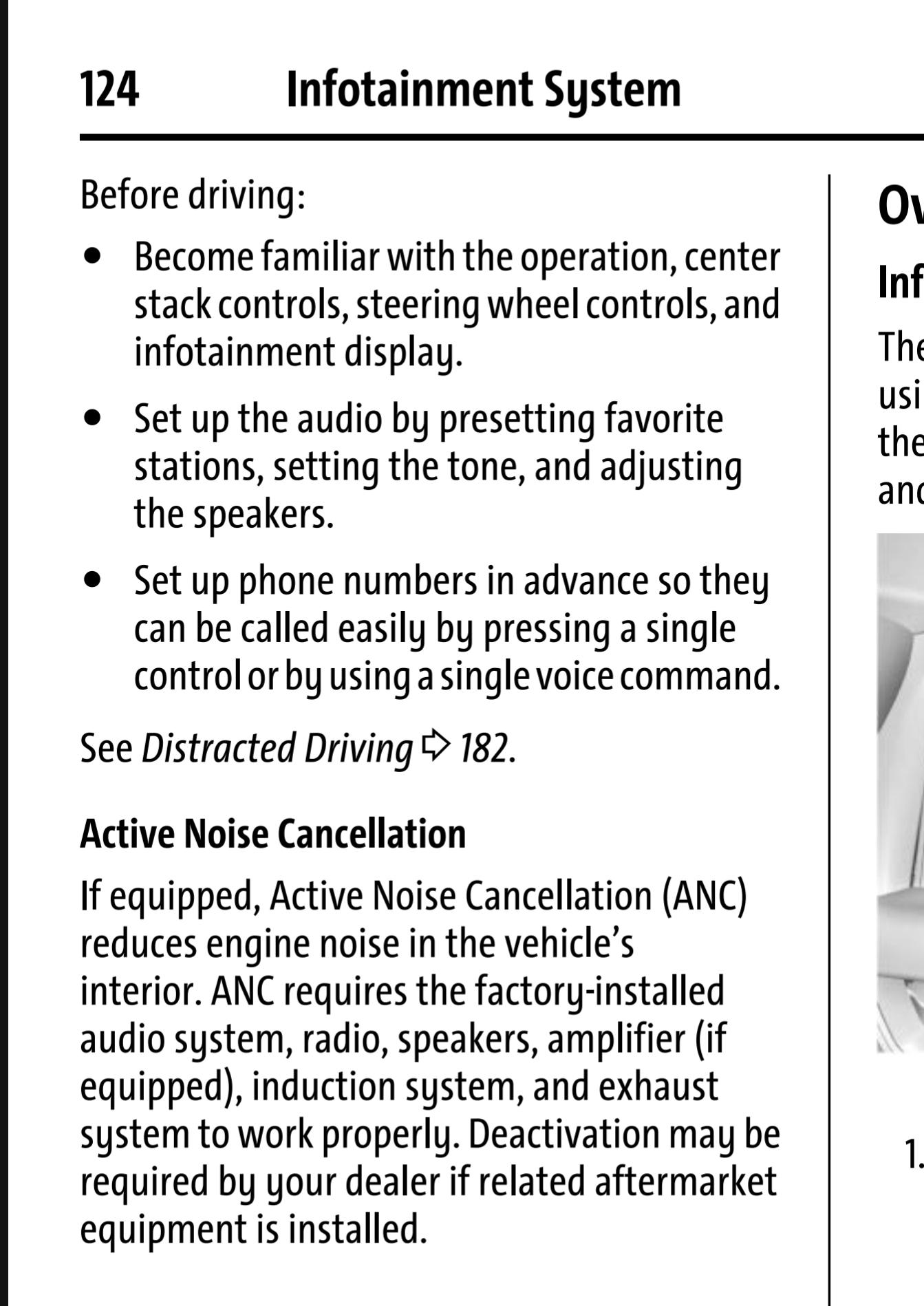

From the 2025 CT4 Owner's Manual:
There's a mention in another thread that the 4BW doesn't have ANC. Not sure if it's valid.
I think the discussion you linked was about fake engine noise being used, not ANC. When we toured Corsa I asked how their exhaust worked with ANC, and they did say that ANC would not be as effective because it had different tones than stock. That was specifically discussing the 4 BW.
Makes sense. Either way, it sounds like disabling it is the best option.

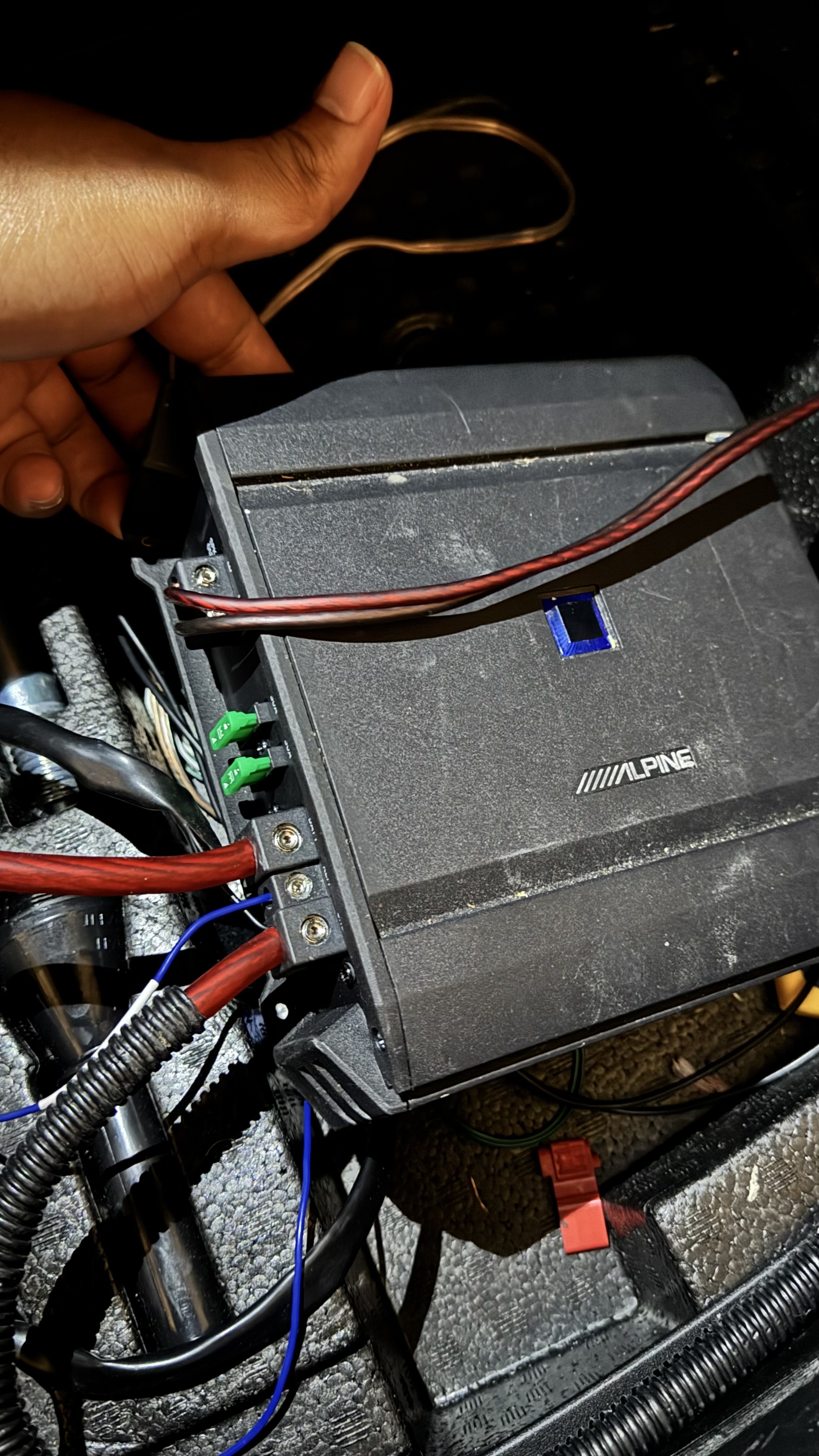

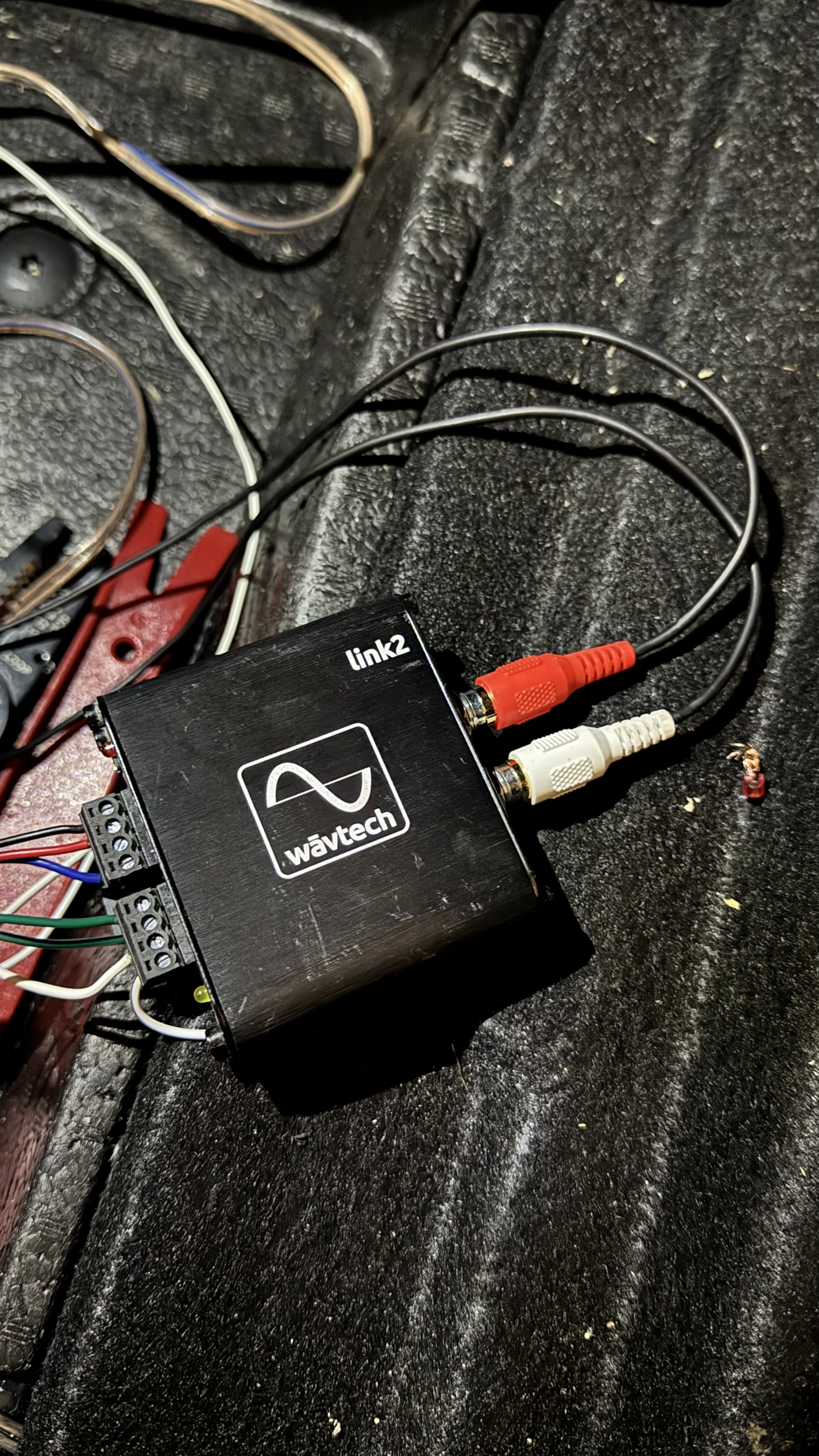

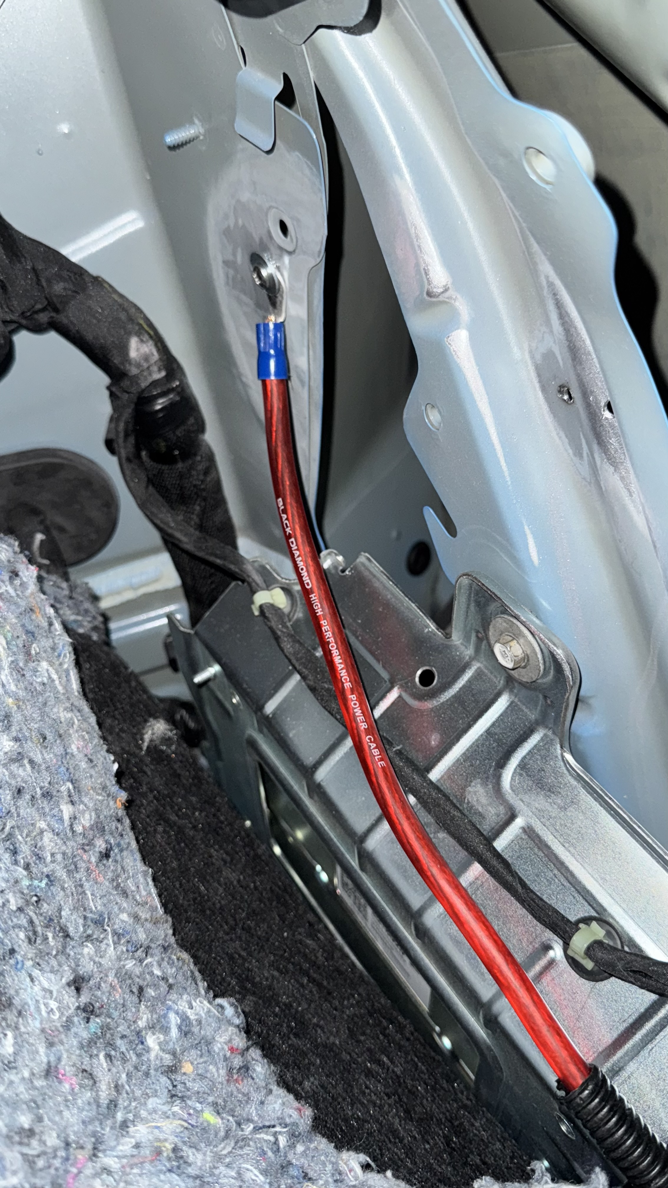

I ran new ground to body and direct to battery. No change for me as for as the sound goes. It sounds like it is the pumped in sound and not ground noise though. When I turn gains down it is greatly reduced. Here’s what I have with a 12 inch sub. I’m at a loss at this point on what is going on
It looks like the harness might be the best option. Where did you tap into for high level audio?

I will give it a try. I can’t believe I’m the only one having this issue. Thanks for the troubleshooting tips.
Removed pin #3 so far, had to cut as could not get it to depin, and left other 2 intact with a few test drives ANC feedback in subs seems to be resolved.

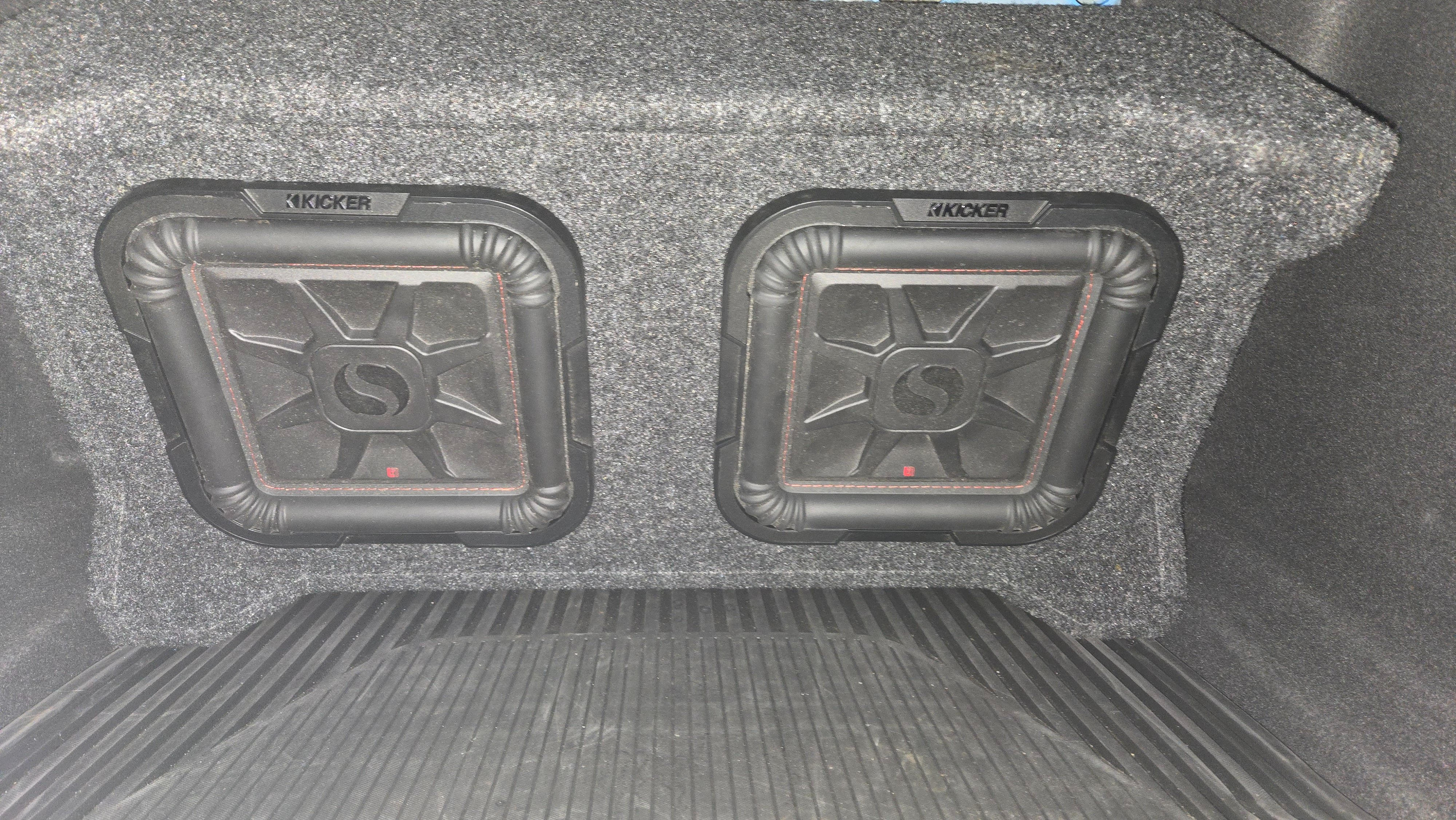

Been month since I removed mic #3 from the equation still no issue and all sounds good. Here is what was installed as well.
Looks great. Did you disconnect the factory sub? it might be different on the 5BW (I have a 4BW).

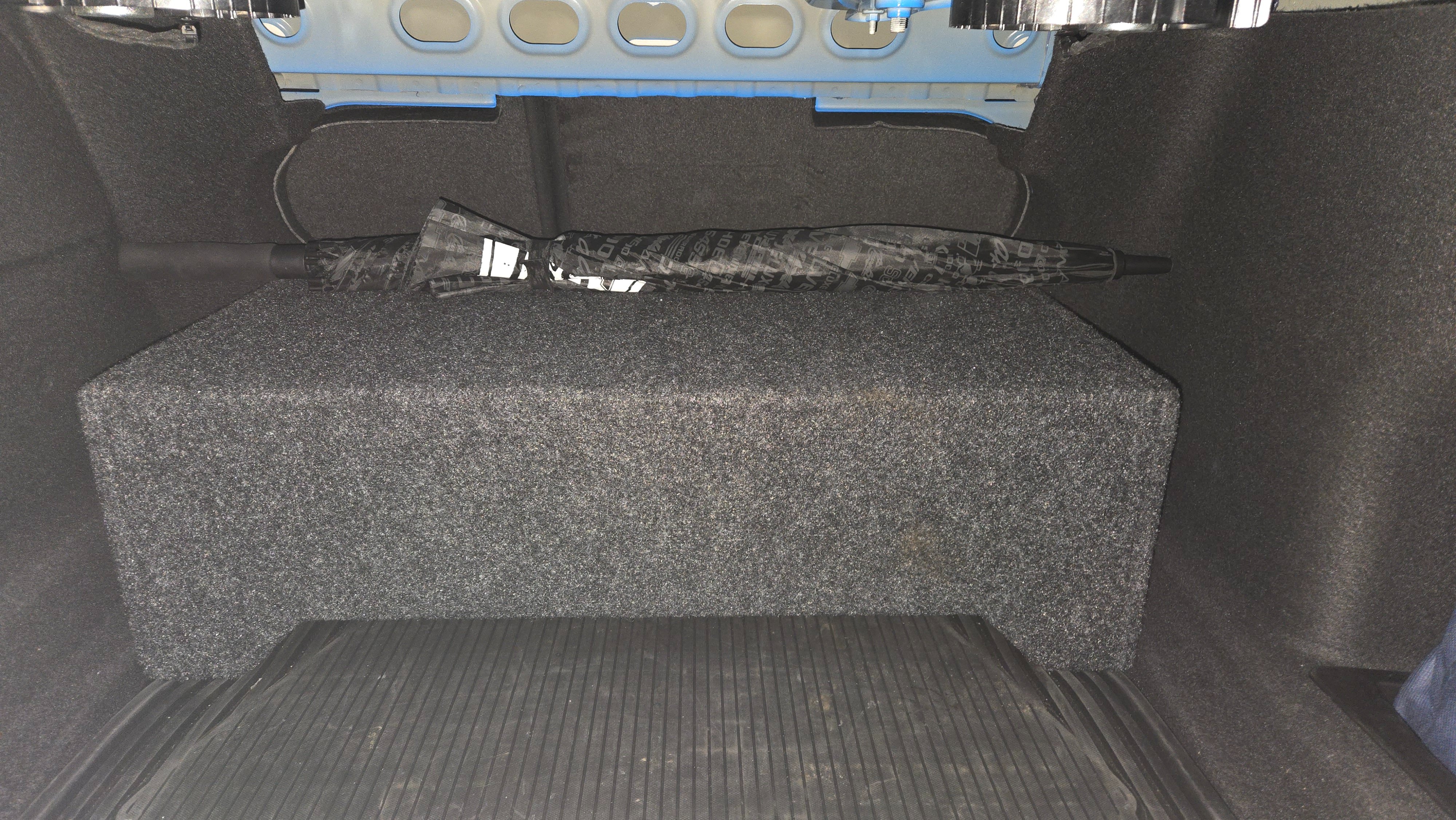

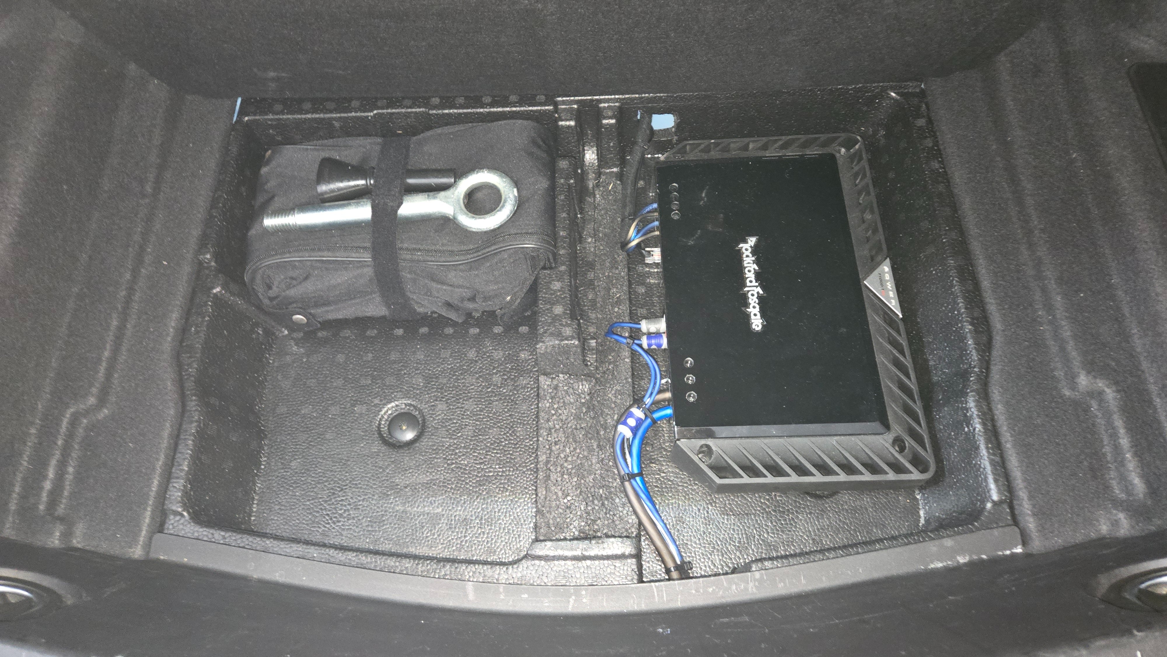

So I just got my sub installed today. I have a 10" sub, kicker 400w amp and used the LC2. I had the installer disconnect the factory sub and I did not use any anc bypass. He pulled the signal from the factory sub. Also had a bass knob installed.
I have no feedback from anc at all. I'm not sure if it's bc of the disconnect but I'm happy with the results. I now have bass at low volume compared to factory.
This is on a 4BW btw.
Just need to figure out how to secure the sub. I wasn't sure how I wanted it placed so they just placed the box flat as far back as possible. Amp and LC2 was mounted in the space below.
