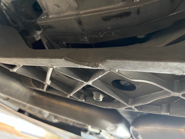

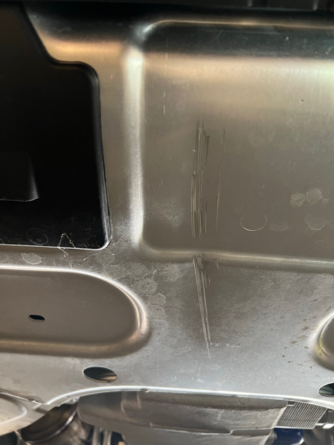

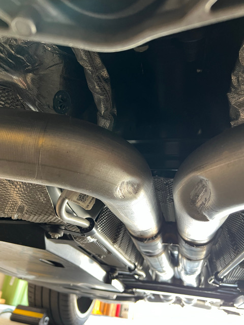

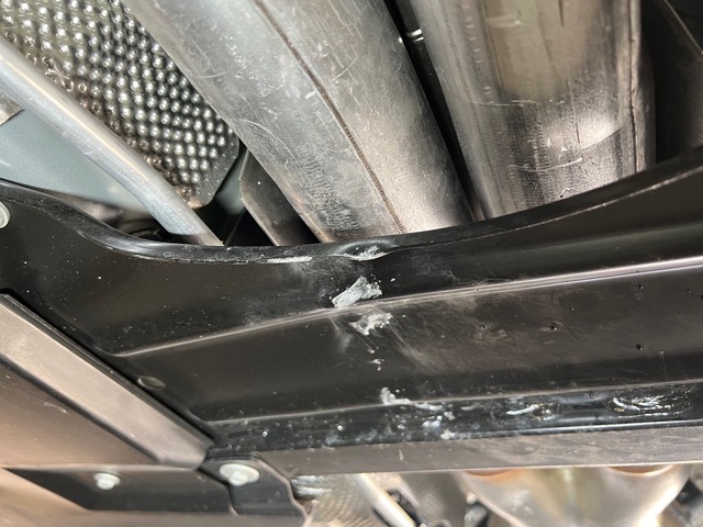

I was on a three day scenic driving vacation in the Central Arizona mountain regions and did a good job at avoiding most road obstacles, rocks, ice, deer. But alas my luck ran out and the undercarriage ingested a rock the size of a large grapefruit. It was exactly in the middle of the road and I knew there was a truck behind me that as far as I know had the potential to pass me or rear end me if I came to a complete stop (I was doing around 40mph at the time). The right shoulder was potentially icy and in a split second decided not to cross into the oncoming lane. So I centered up and took the hit. My initial thought was that it didn't look big enough to hit anything underneath. Boy was I wrong and with an incredibly loud serious of bangs the rock got injected from the rear in several pieces. It definitely could have been a lot worse, so I do feel pretty fortunate that it didn't take out the oil pan or any cooling lines leaving me stranded in the mountains.
So my question is simple. Should I repair some or all of these parts? I'm not that worried about the front aluminum skid plate, but more concerned about the transmission brace and the other steel brace toward the rear. Would having these big dents in the exhaust pipes be detrimental in any way? What would you do? I was thinking of taking it to the dealer and getting their opinion and cost estimate. They decide if I should contact my insurance company.

Nothing there concerns me except maybe the exhaust dent. But I am far from an expert on exhaust, maybe it is a non-factor. The other scrapes and dents, I can't imagine those having any detrimental effect on the car. Then again I drive a truck daily, if you don't have any undercarriage carnage, you ain't driving it hard enough ;-)

Can’t hurt to have it inspected. Doubt the exhaust is an issue.

I honestly believe the damage is more cosmetic and nothing you show is going to affect the car.

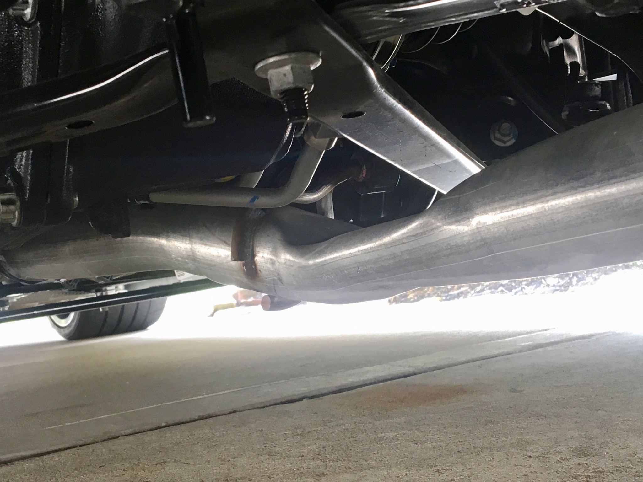

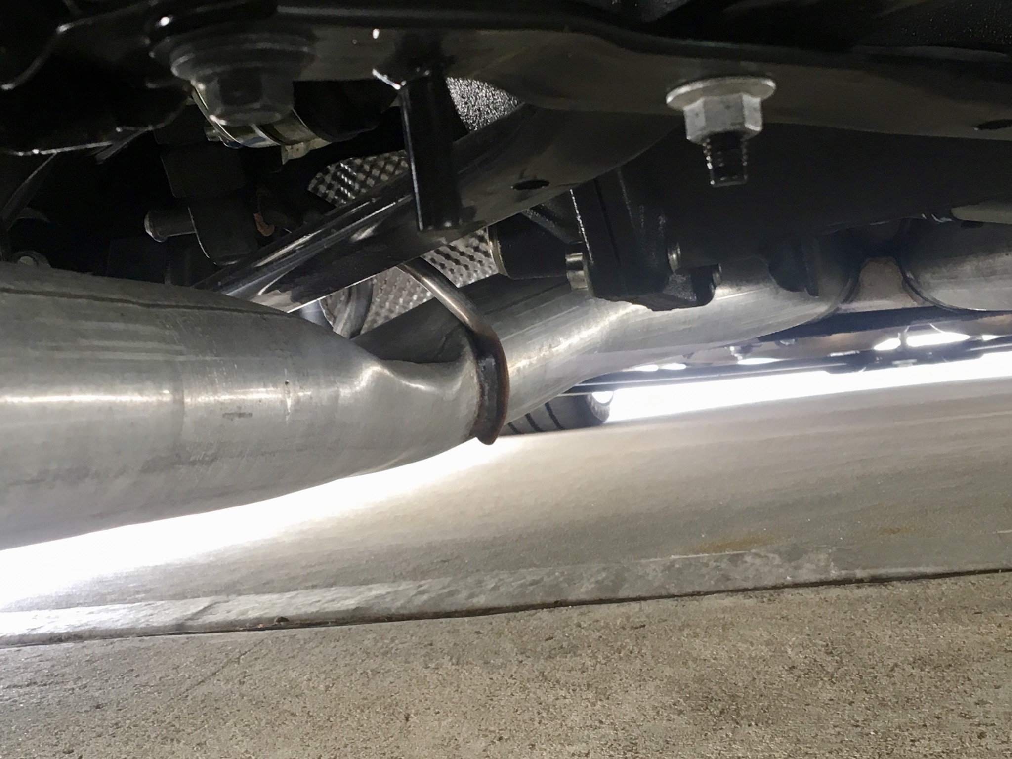

As for the exhaust, I have attached 2 pics I took from my 2017 ZL1 of course with LT4 of how GM bent/squeezed the factory exhaust both sides for ground clearance purposes basically in half. It caused many people to get excited. It was proven later by some exhaust company during testing after cutting those sections and installing non bent pipe replacements of no benefit. I don’t think yours are bent nearly as much to cause an issue. Trying to put your mind at ease about the exhaust portion.

I'd want the honeycombed piece checked for any possible stress cracks. The dents in the exhaust shouldn't cause any performance problems (though they look ugly, heh). I think it was Engine Masters that beat up a pair of headers and couldn't really tell any performance difference.

The aluminum skid plate seems well thought out. It seemed to have deflected the rock enough so that when it bounced back up it hit the honeycomb transmission mount/bracket and not the oil pan. Not hitting the diffy was just pure luck. But, yeah, overall it handled it quite well.
