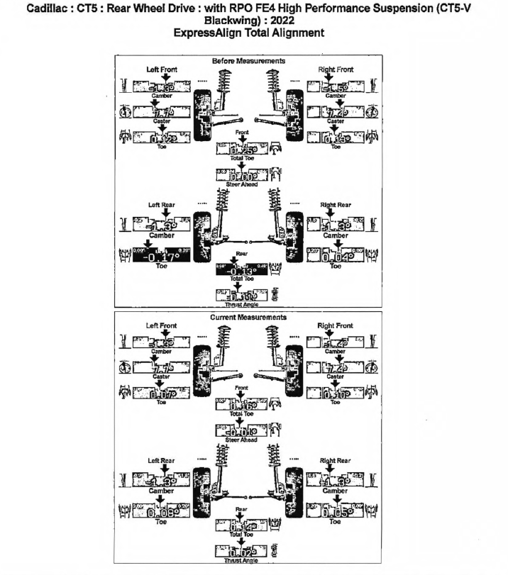

Sorry for the delay in posting. This is from 10/4/2025. Before this alignment and the service to fix the rattle which touched the steering, i had zero wander for over 4 years. After this alignment and the service, it now wanders both left and right sometimes very strongly.

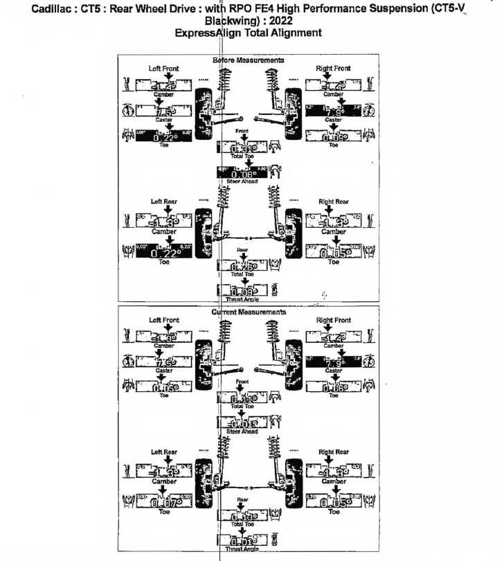

This is from 10/21/2025 when they did the re-alignment and said the rear-driver was done poorly which is odd because in a matter of a couple hundred miles it was off again. This didnt fix the wandering.

I suspect the castor adjustment they made is where your problem is. If the machine hasn't been calibrated in a while that only makes sloppy tech work even worse.
thanks for the feedback. Is there somewhere that lists all the specs for what i should have? I dont need anything other than stock specs (I dont track or anything like that). I think am going to take it to an alignment place that some of our lotus club members use.
