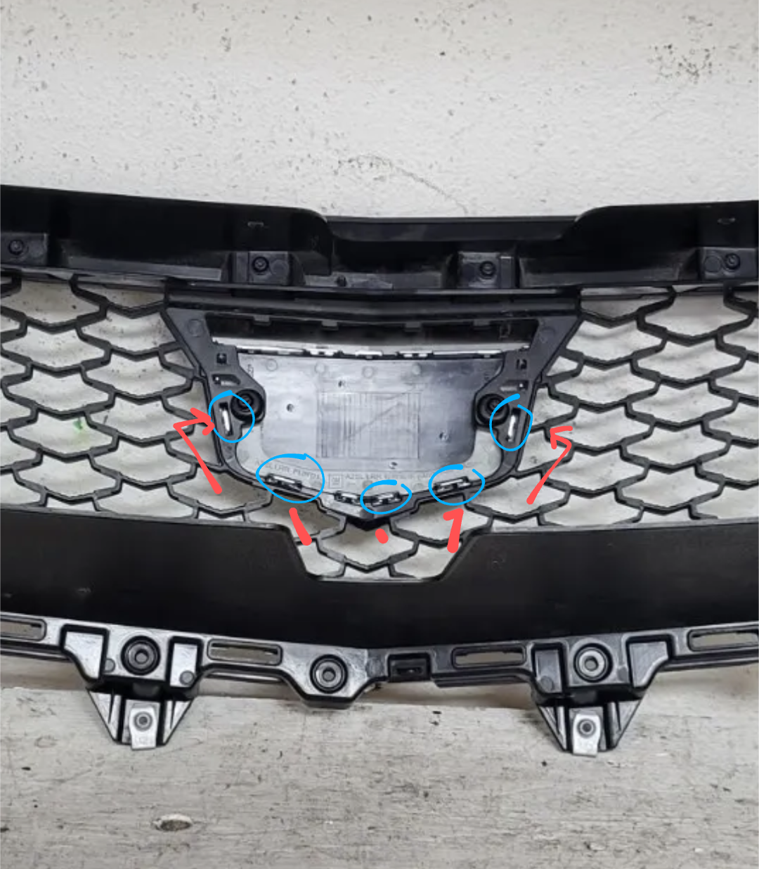

I poked my fingers through the grill holes to bend the tabs (if I remember correctly one on each corner, look at your replacement badge for reference). As you bend them pull back on the emblem to allow each corner to detach. Repeat the same procedure for each tab until the whole emblem comes off.
Took me about 3-5 minutes to do to get the front emblem off.

Sorry for the late response. See my attached picture from a photo I found of a CT4 BW grill I found on eBay.
It requires some dexterity, but I was able to poke my fingers through the grill and bend the tabs on the emblem to pry it off.
I did not have to undo the grille at all.

Well, tried to reach through and couldn't get to tabs. Just took a Vice Grip, grabbed the top center of the badge and pulled. Broke off the top of the badge, but it came right off. Tape around it if you're going to try it that way!!
