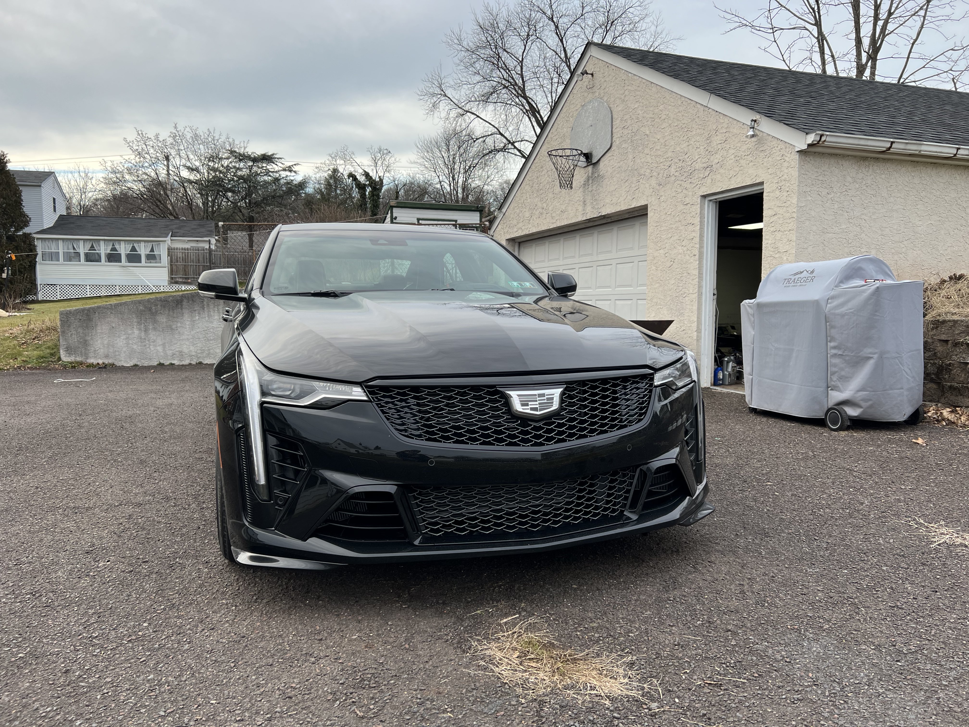

Finally got my monochromatic badges (using the 137$ GM gave me in rewards for a 70k car purchase!). Put the front one on quick today. Got kinda buzzed off wine and was able to do it without taking the bumper off. Broke the bottom 2 clips and the top 2 corner clips reaching my finger through the grill and was able to pop the old one off pretty easily.
I do not recommend this, it’s risky. Better pictures tomorrow after I wash the car and install the rear badge (and get rid of the dumb dealership emblem and maybe the CT4 emblem).

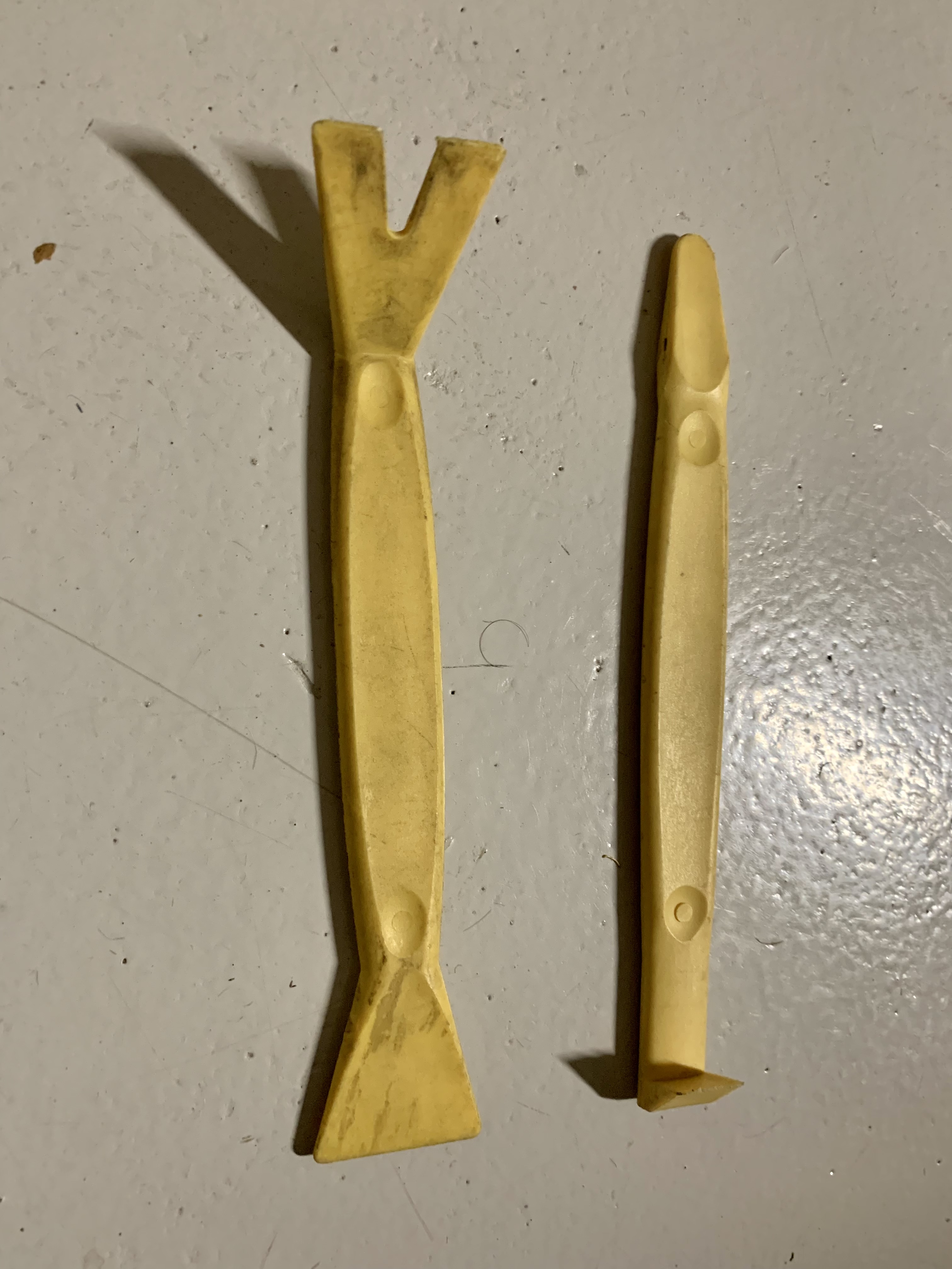

Here are the ones that I used. I’ve had them for over 10yrs and they are indispensable.
I use one to start prying to get some space until I can see the clip, then used my finger tips to hold pressure and one to pry against the actual clip. Sometimes I had to work the clip at different angles.
One clip did pull off the liner, which I hot glued back to the liner.
A head mounted headlight is recommended to see the clip better under the liner.

I got this kit for my CT4 and I noticed that there is small gap on the top of the front badge after installing.
I was able to reach my fingers through and around the grill to press out the original front emblem. It took some finagling, but eventually it popped out.
The CT4 Monochrome front emblem is slightly smaller than the original front emblem.
It fits and clips in but the top clips don't line up.
It works though.
