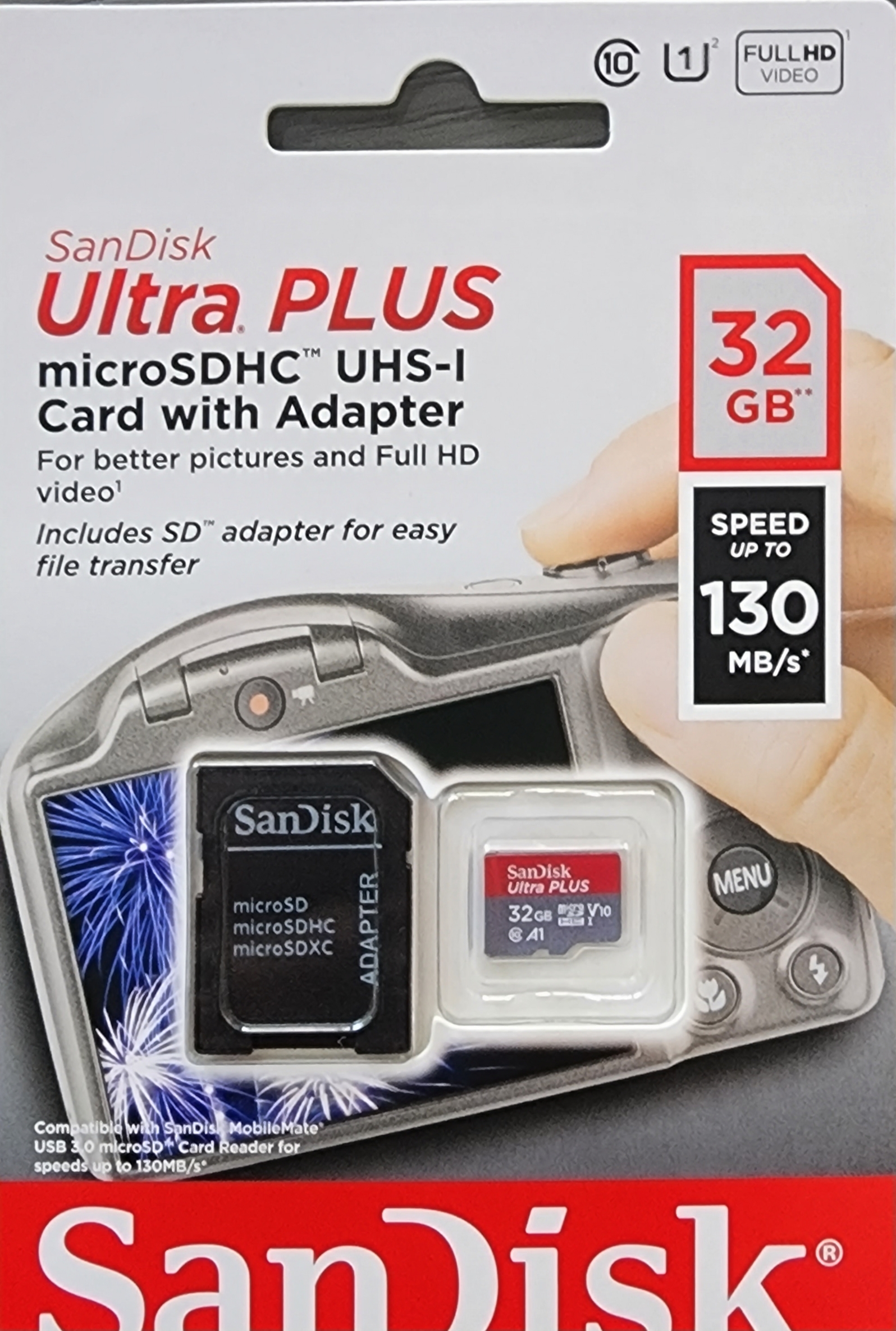

So today I went and picked this up for 13.99. I put it in the SVR SD slot in the trunk and it got recognized/worked right out of the box...no (additional) formatting needed... must be pre-formatted.
Yeah looks like the 32GB micro SDs work out if the box with SVR
32GB or smaller probably work out of the box because 32GB is the max efficiency size for FAT32. In reality FAT32 can go beyond that, but FAT32 is begins to become inefficient once you get beyond 32GB. basically its becomes slower to read/write than other file formats. However for a video recorder that should never be an issue. So it is possible format FAT32 beyond 32GB, but you will probably need a 3rd party program to do it. So most 32GB and smaller cards probably come preformatted in FAT32. Anything beyond 32GB would be exFAT if its preformatted.
