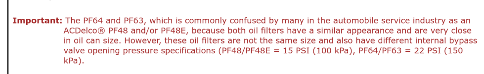

Anyone use the UPF46 ultraguard filter?
I wouldn't. Could you without any issue? Probably, but why not just use the proper part? Also, if you have an engine issue, no matter how unrelated, do you want the dealer to have any ammo to deny a warranty claim?
From GM Bulletin, I know it doesn't state UPF46 specifically, but what it does tell me is that there is more going on in the filter than whether or not it "fits"...

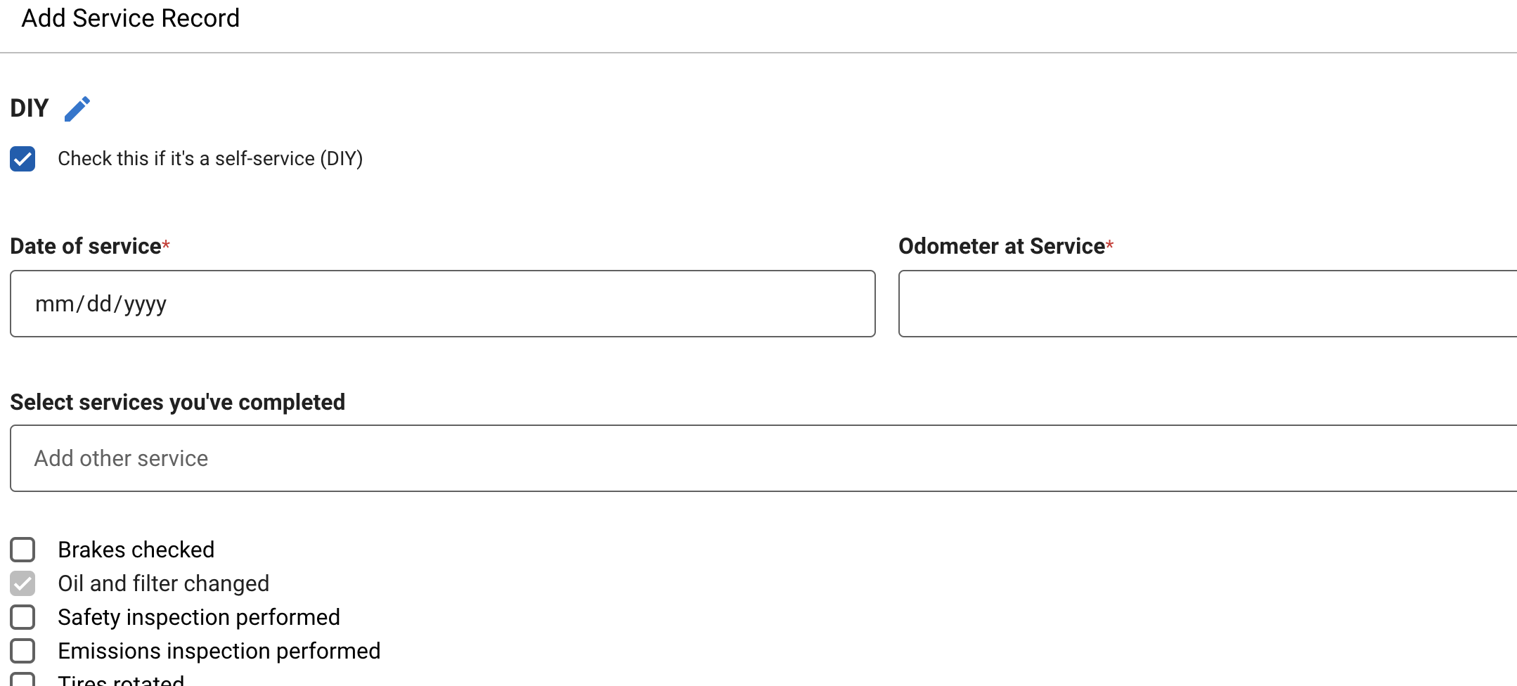

You can post your own service records on Carfax when you do your own work. Just keep your receipts.
Hmm, thats news to me. Now I gotta figure out how to do just that.
You can go to the link below. Create an account if you don't have one. Then go to the "Track your Maintenance" section and you can add you VIN. Once you do you will see the service history on the car, basically the PDI from you dealer. You can enter your own records for oil changes, tire rotations, etc.
I've been using that for my GLI for a while. Probably ought to figure out if the data can be kept offline in case Carfax goes under someday in the future and your records die with it.
